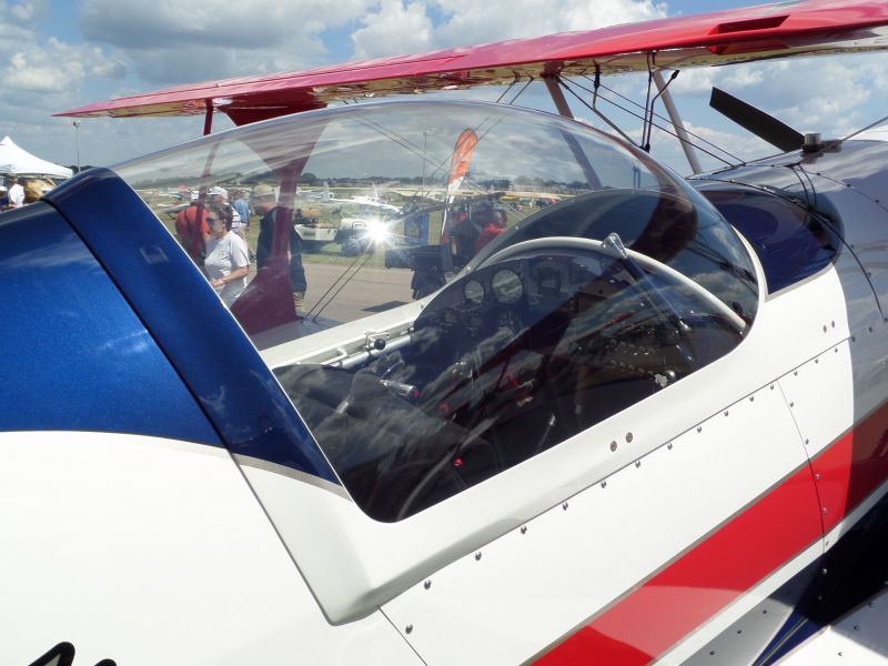

Not entirely. Canopy is still not installed.

Technically, the full scale whose scheme you modeled "Miss Maggie" is a two place Model 12 with a single place canopy. Therefore it has the shorter panel, like the one you installed. Instruments are different, but I personally like the big screen you picked better!
Thank you. This is the one I referred to mostly. I've been trying to keep it as close to the full scale as possible. Maybe I should just leave well enough alone?

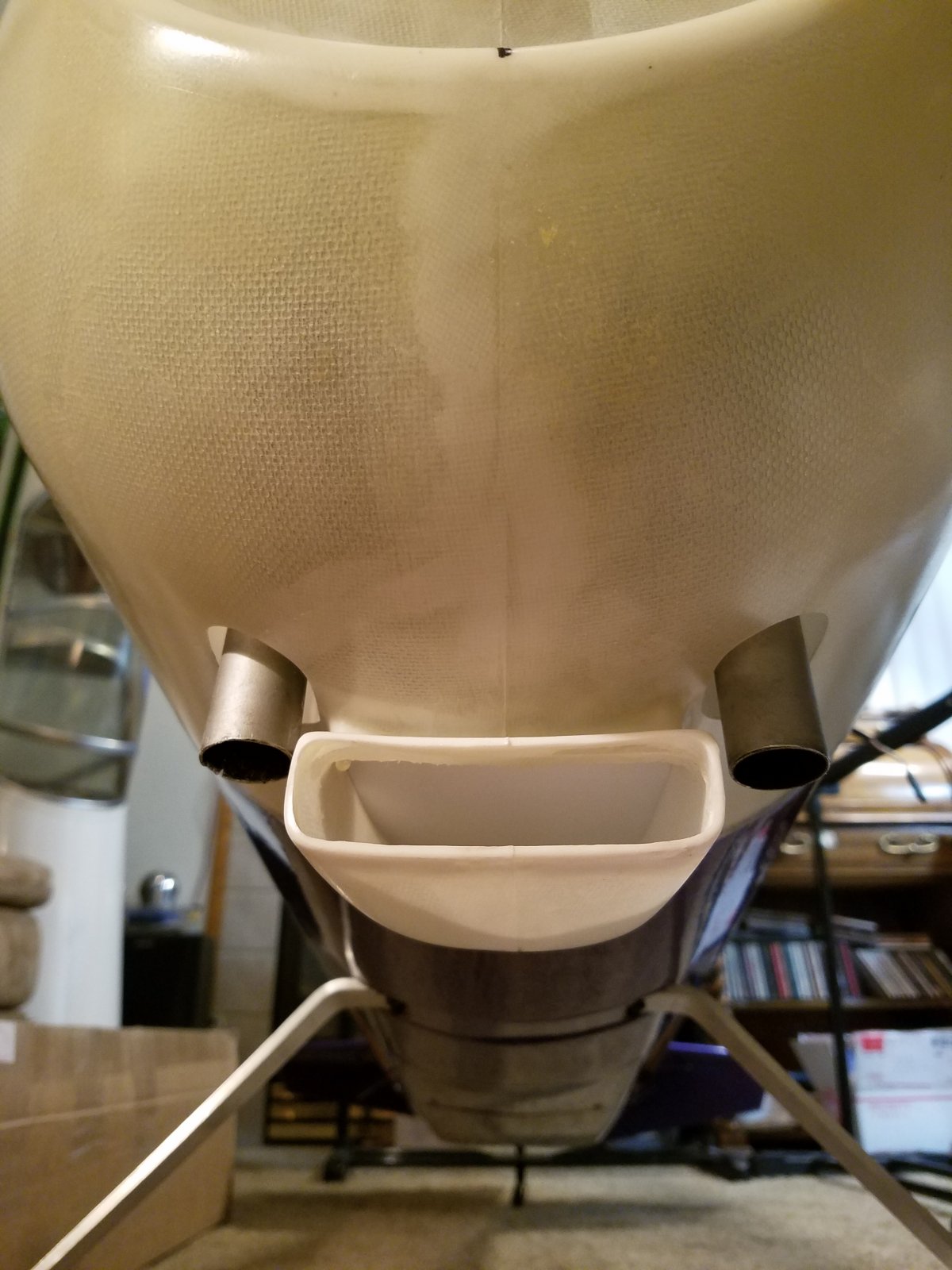

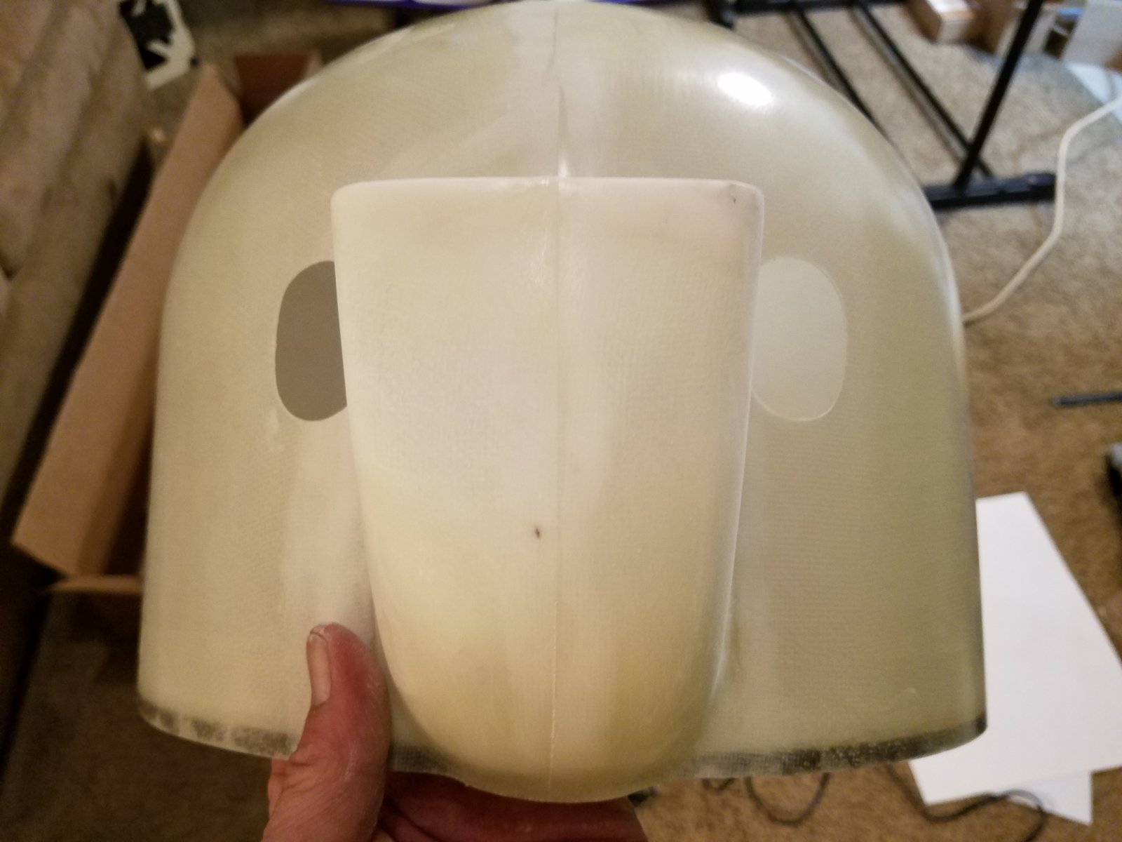

Ok, back to the Pitts. I've not gotten a lot accomplished on the cowl. But I did get the exhaust openings cut. I have two things that I really stall on when it comes to projects like this. The canopy and the cowl. Ah but they have to be done.

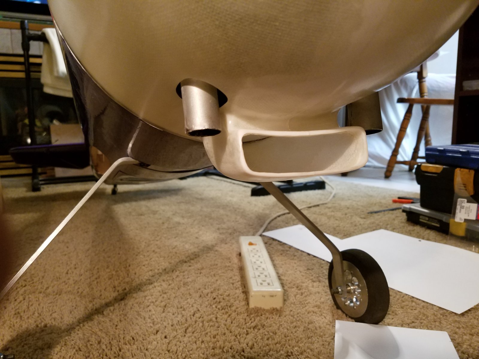

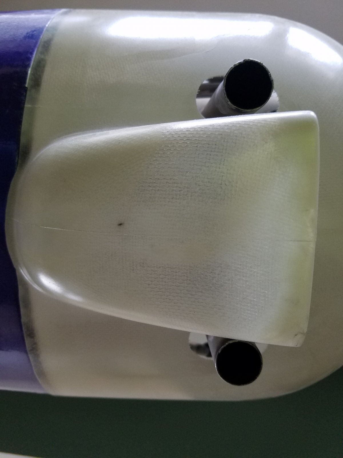

The openings for the down stacks on the exhaust were actually much easier on the Pitts than previous planes. Two little alignment marks on the inside of the cowl and success. I had to elongate both openings just a tad to get the cowl on. It has to go on at an angle and so it was necessary to accommodate the stacks. They turned out quite evenly spaced and very uniform in shape. Fortunately they didn't interfere with the scoop on the bottom. Or is that vice versa? At any rate they look pretty good. They are not perfect like the full scale. But pretty close.

I have blocked off the scoop and will be adding a screen to the front once the cowl is painted. On the bottom of the scoop I will be adding a TDRC vent to relieve the air and allow it to pass through and back out. I don't know if the opened scoop will create any drag but I can't allow the air pressure to blow air into the cowl. It would really defeat any attempts to get the hot air from the engine out. I will probably also add some vents to the sides of the cowl near each cylinder head. Maybe replicate the full scale look a little closer to original.
