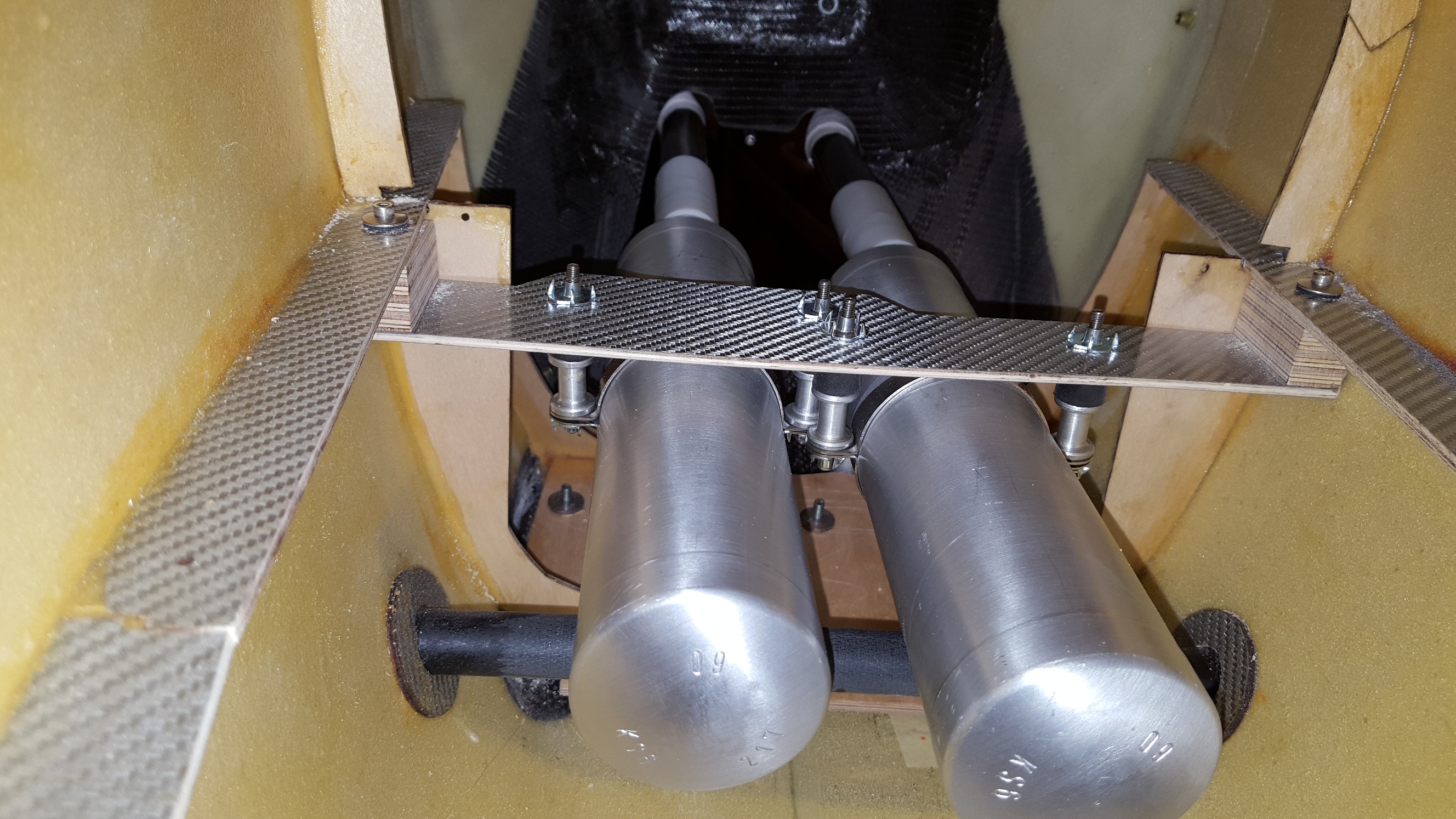

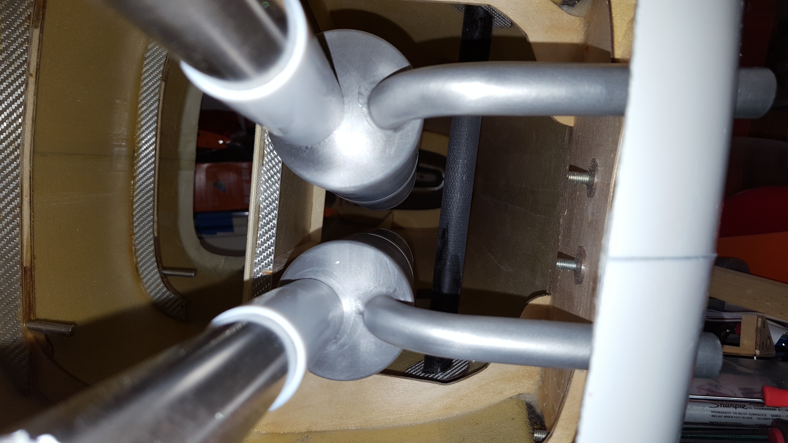

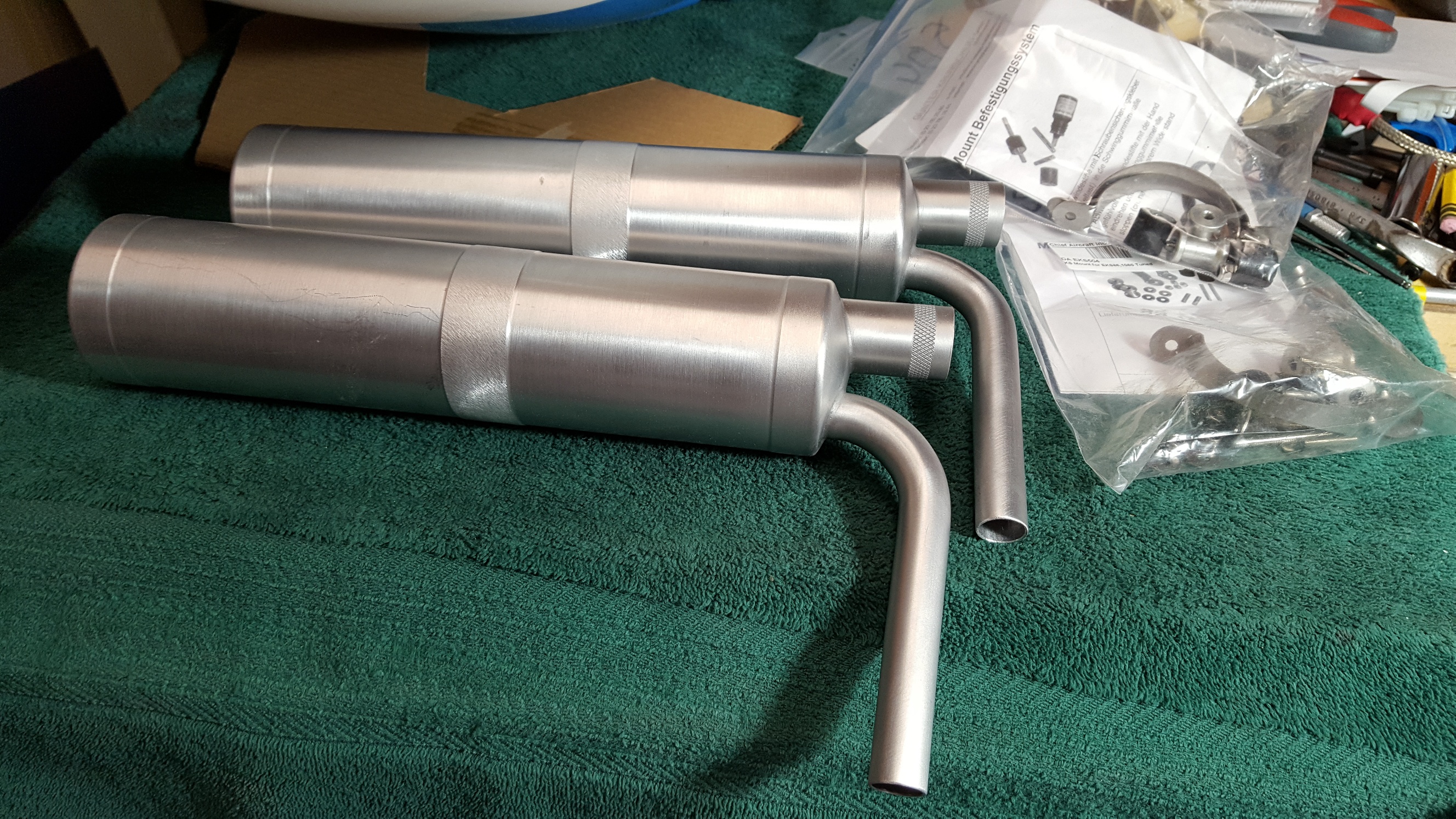

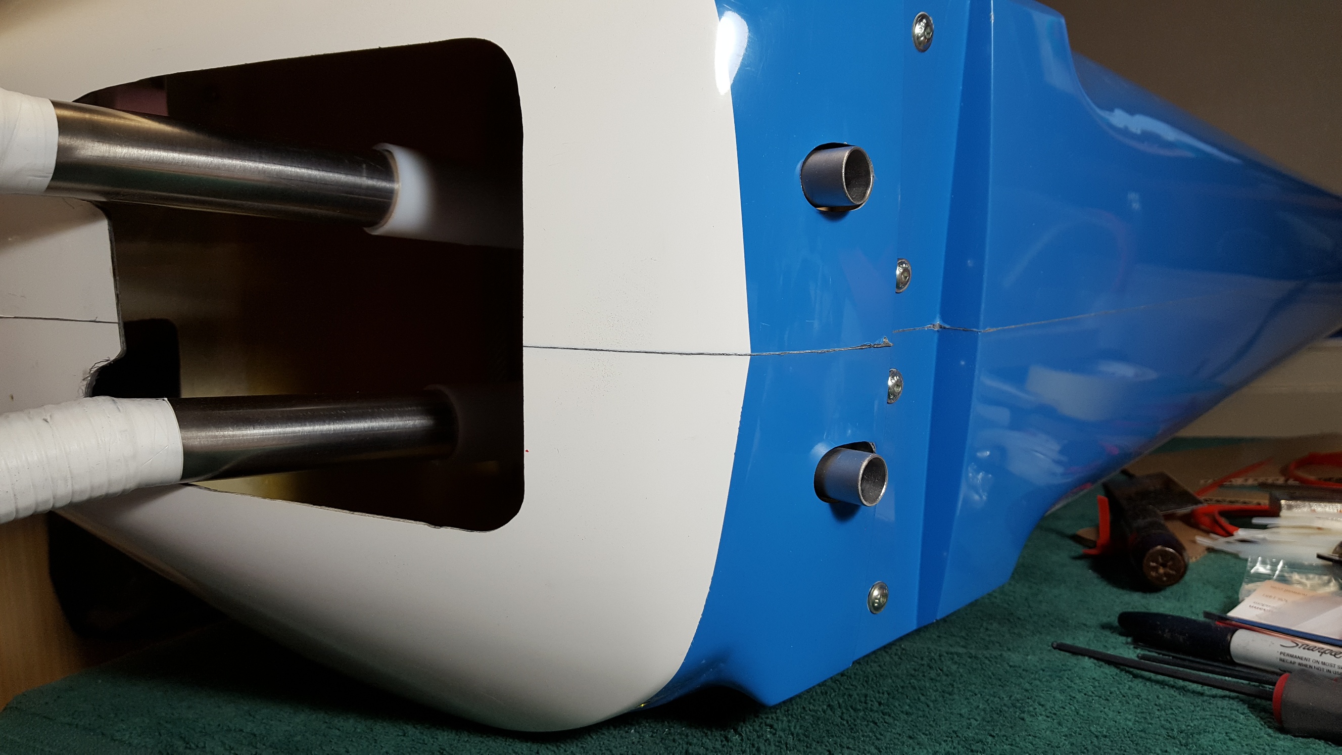

    The canisters and mounts are here so I did some test fitting. Now I need to make a bracket to hold the mounts.

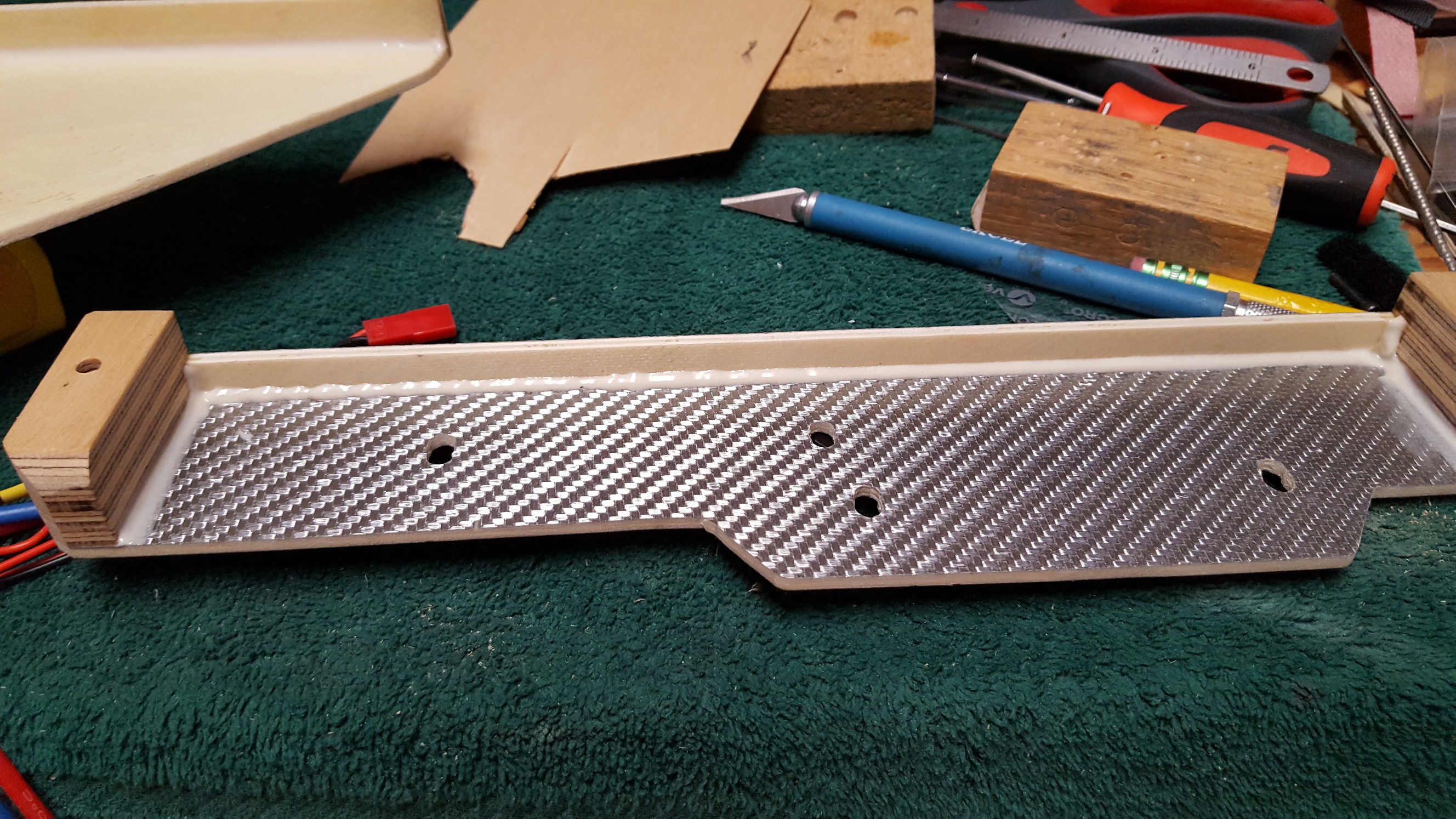

  3. Jetpainter
    Jetpainter 640cc Uber Pimp

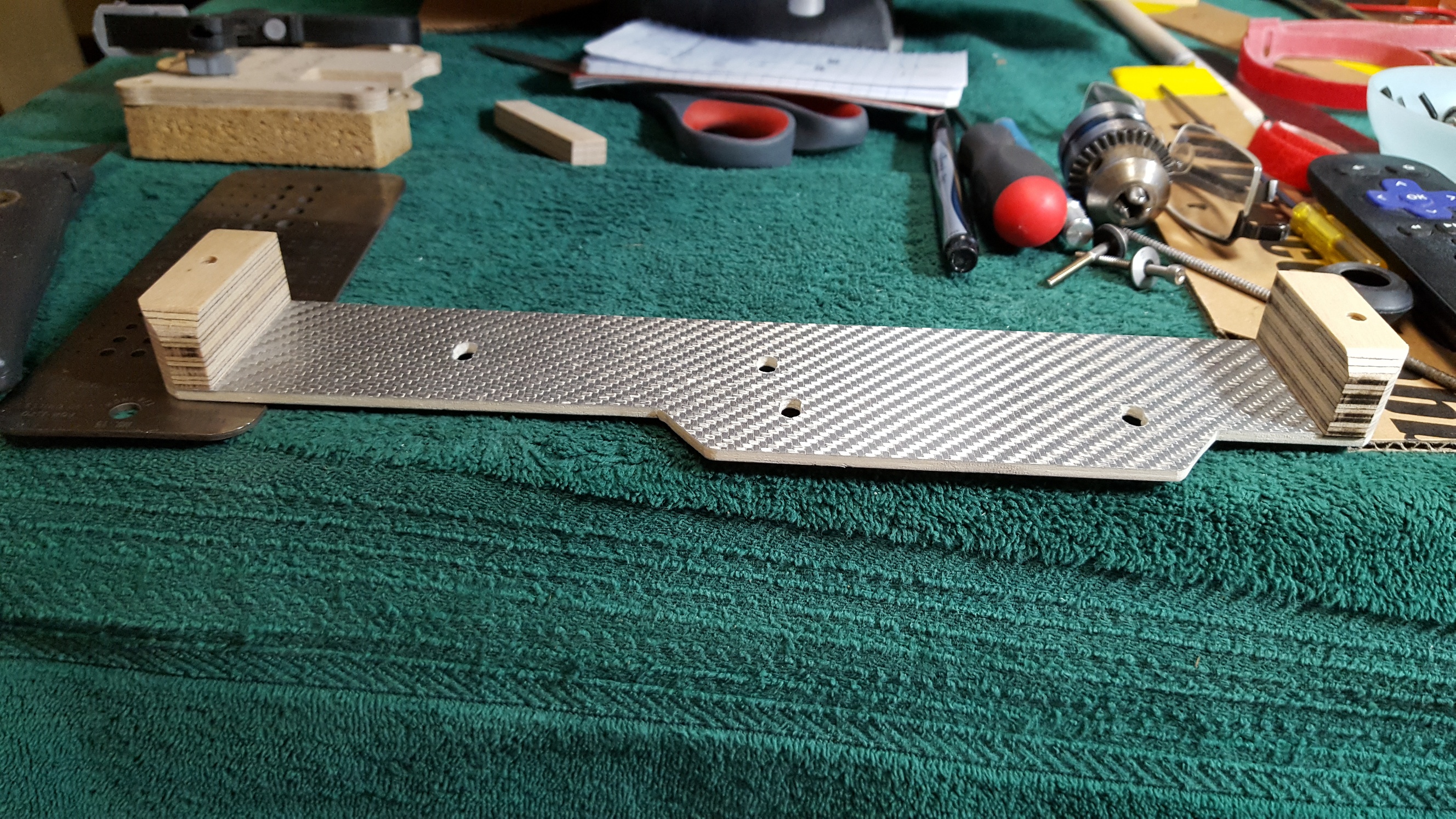

    After much testing and trial fitting, I finally have a mount for the canisters. I used what Krill calls Alutex, which is a fiberglass and liteply sandwich. You'll notice I used blind nuts spun on upside down while test fitting. That made it simple to spin them on and off for the 20 plus times I had the piece in and out.;) It will get Nyloks on final assembly.
    I still need to add a strengthener along the width of the back edge to keep it from flexing too much.
    20190211_213725_resized.jpg 20190210_180415_resized.jpg 20190211_222154_resized.jpg

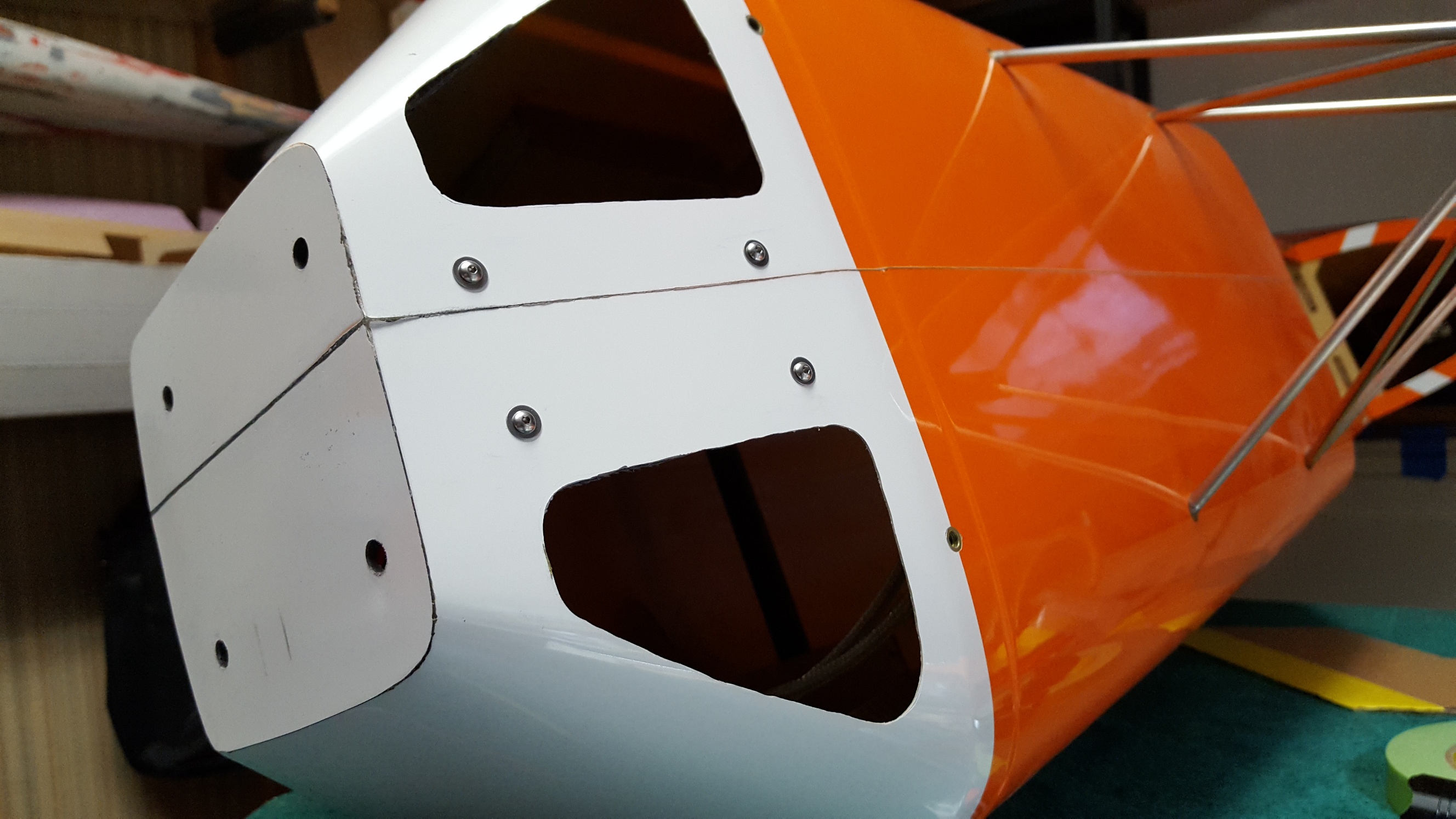

    Hey guys, the engine is in! 3w110ib2 ... anyone experience with it? and maybe tips for drilling holes? since this is my first composite aircraft ... once I have installed the engine, I will continue with the inside of the fuselage and also post pictures again. Thanks in advance for any tips!
