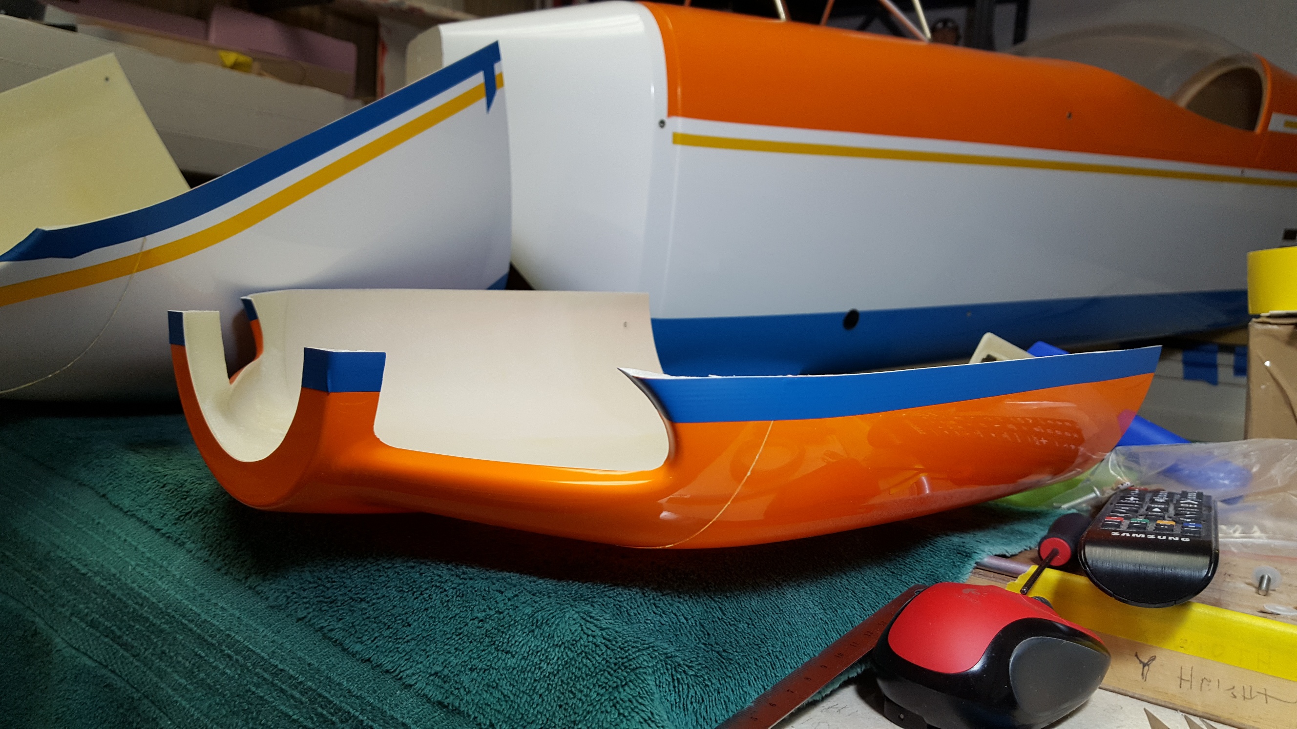

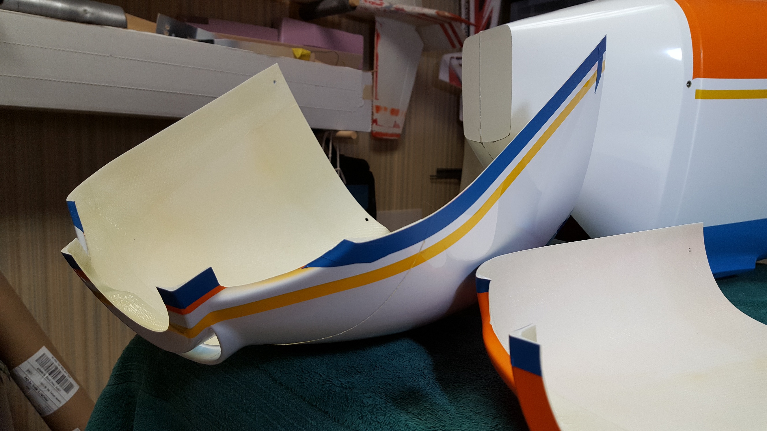

I do mine different because I'm cheap, and I use the materials I have on hand.;) I'll post my process as I go.
Yup terry originally showed the zona saw trick. I used it when I split the cowl on a buddy’s 33% hangar 9 Edge. Threw away my xacto was afterwords as I was so sold on how the zona did.

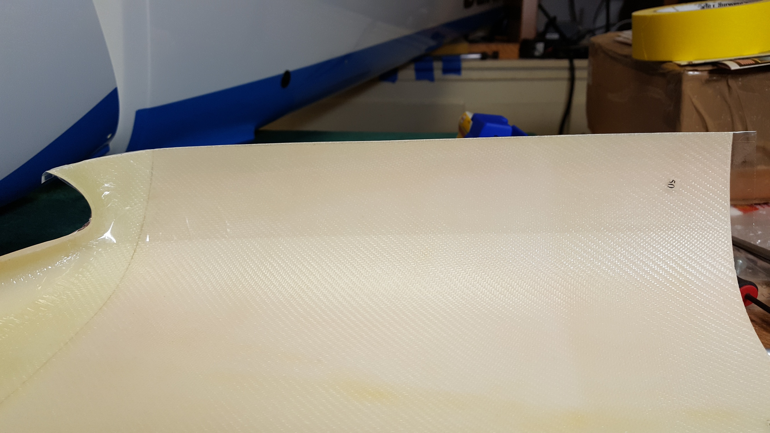

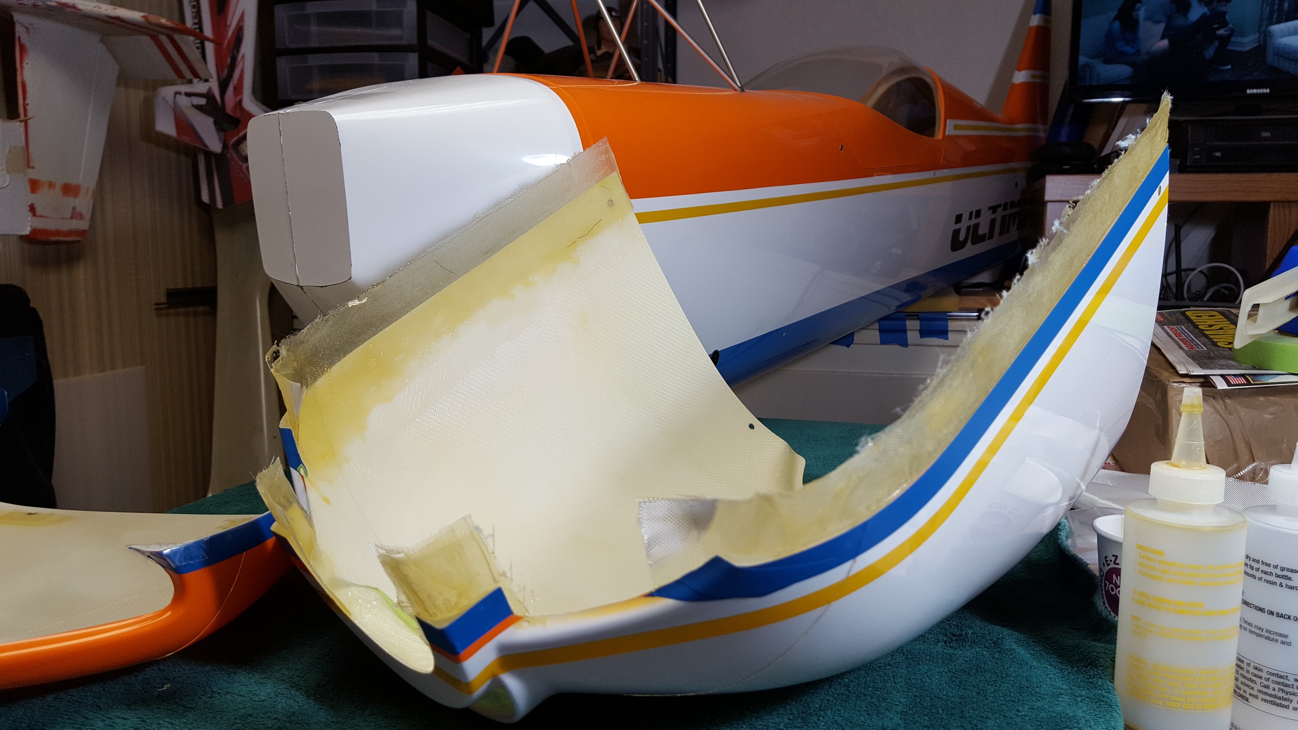

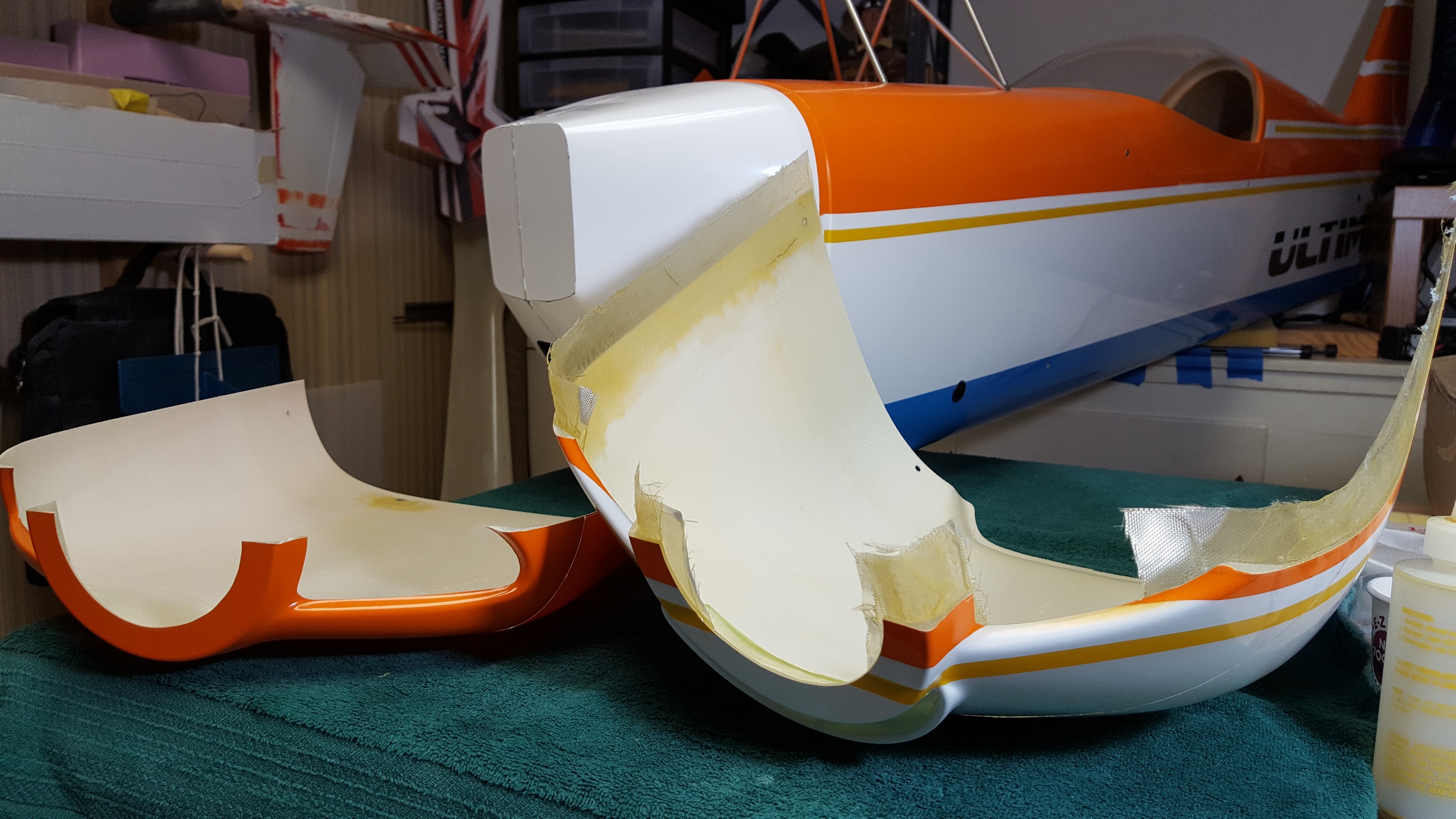

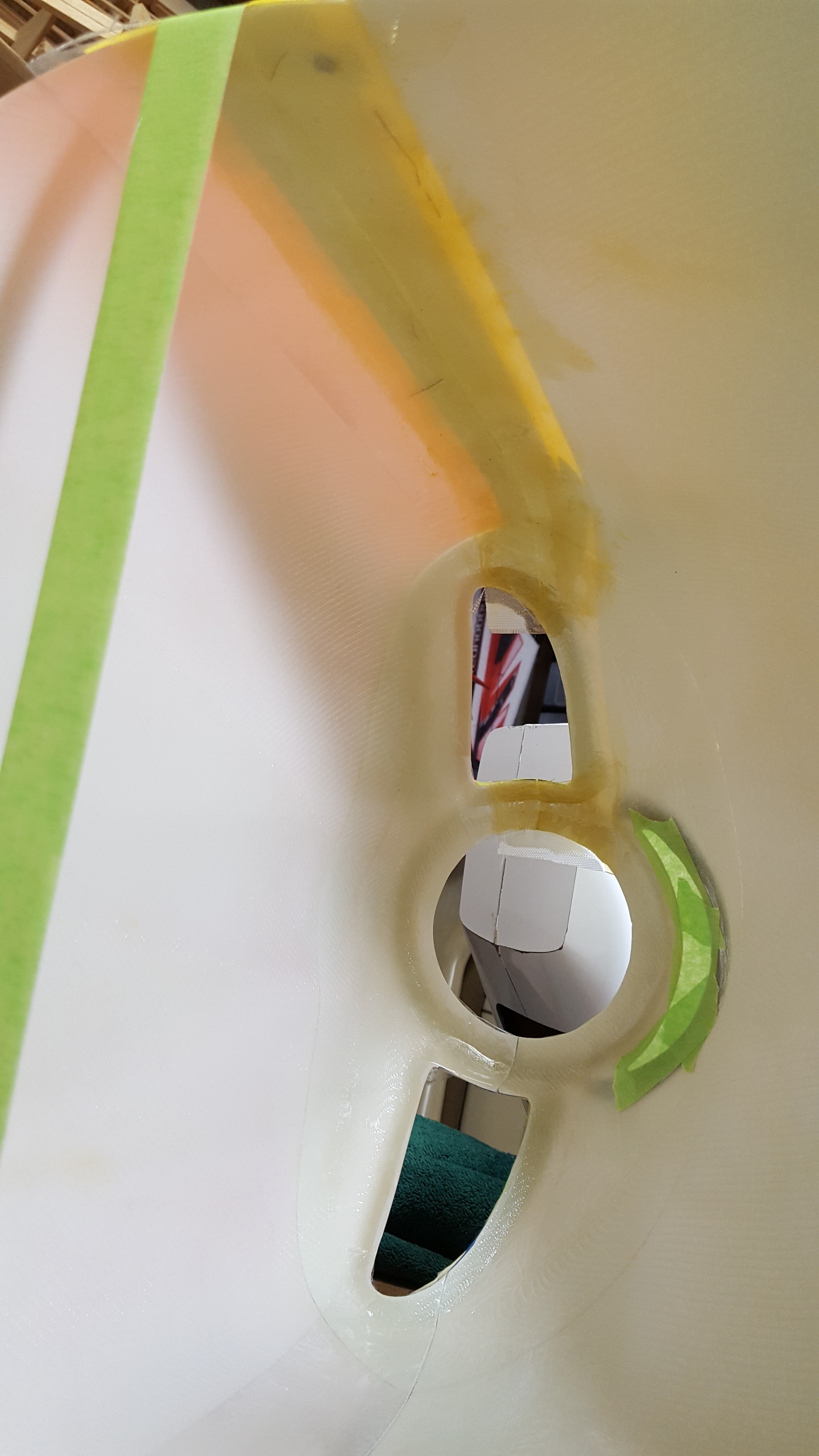

Tonight I laid down the glass cloth in the cowl for the lip. I started by masking the outside right to the edge with blue vinyl "Finelines" Masking tape. I then used clear package tape on the inside of the top section and let it wrap around the edges onto the outside. Then I smeared Vaseline on the clear tape, then taped the two halves back together as flat and tight as possible.
The glass cloth I used is 4 ounce I'm fairly sure. I put down two layers on the sides and three at the spinner. Tomorrow night I'll cross my fingers and pop it apart. :omg:
Looks good . I have done it once and as you said cross your fingers that it comes apart. Lucky mine came apart but still had work at it a little. But I wound do it again in an instant., especially if it is a twin. Just makes life so easy. Nice job.
