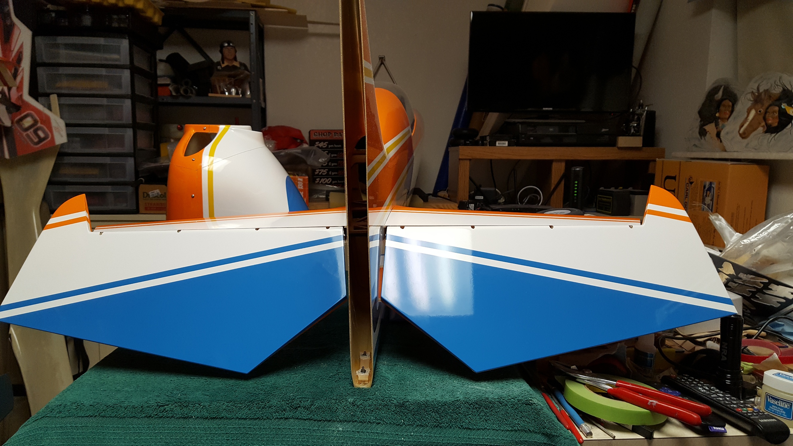

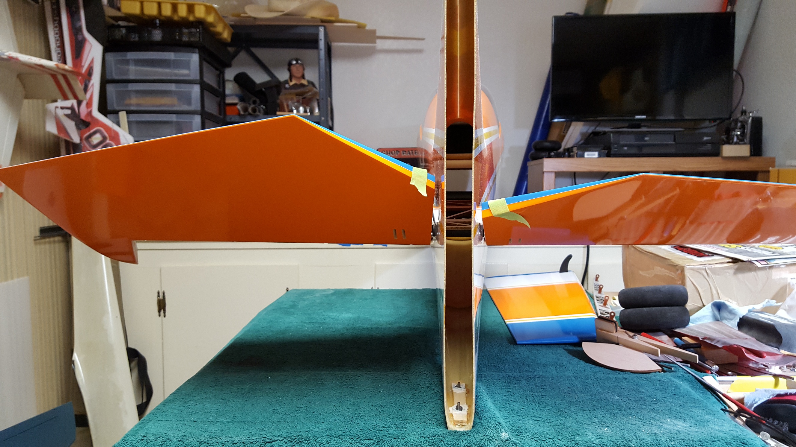

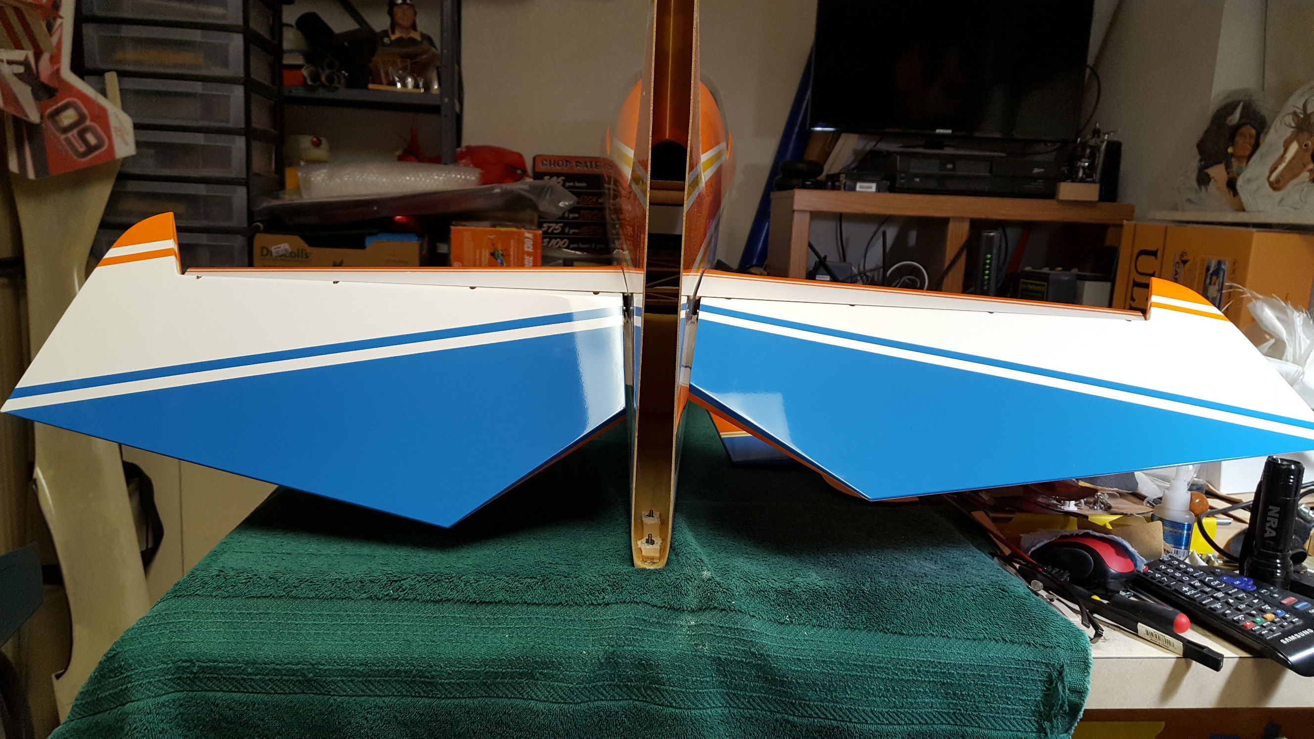

Since the rudder post is on hold, last night I worked on other things. One thing I did was remove some material in the hinge pockets to increase the travel on one of the elevators. I got it to about 45 now, and it has a little more left in it.
View attachment 106447 View attachment 106448

I was able to get the elevator throw to 45 degrees each way from the 22 it started at. That will certainly do for Tony's kind of flying. It can go more, but I would need to lengthen the slots in the elevators and it wouldn't look as clean. Plus, much more and they would hit the vertical stab at full deflection.
