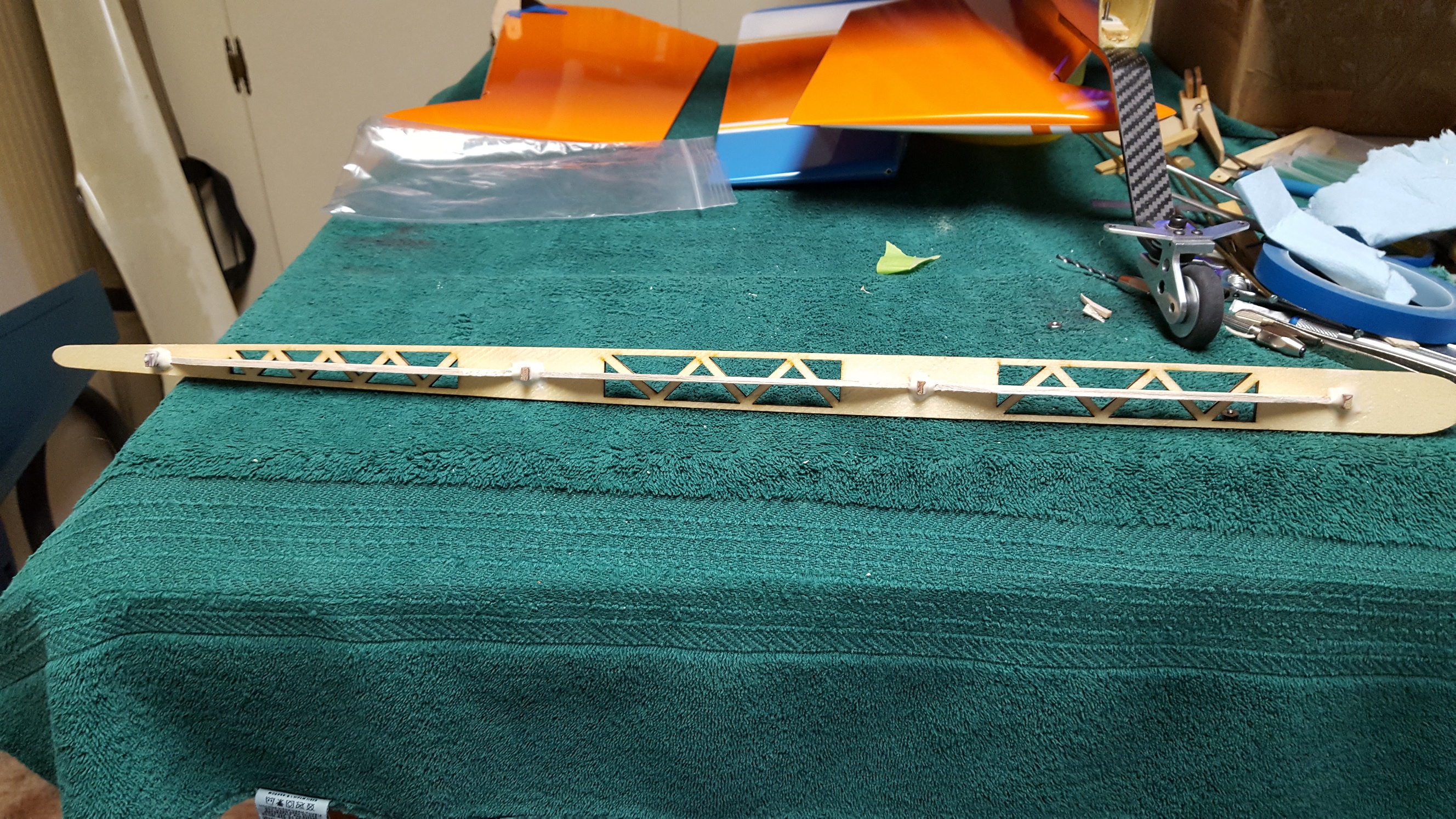

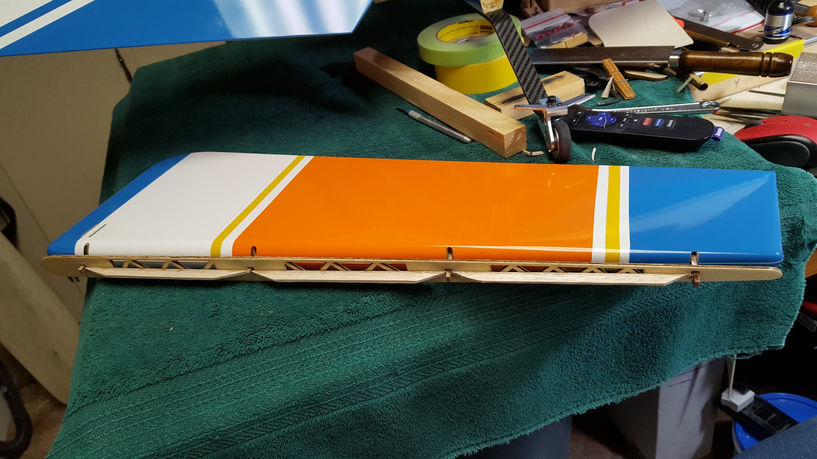

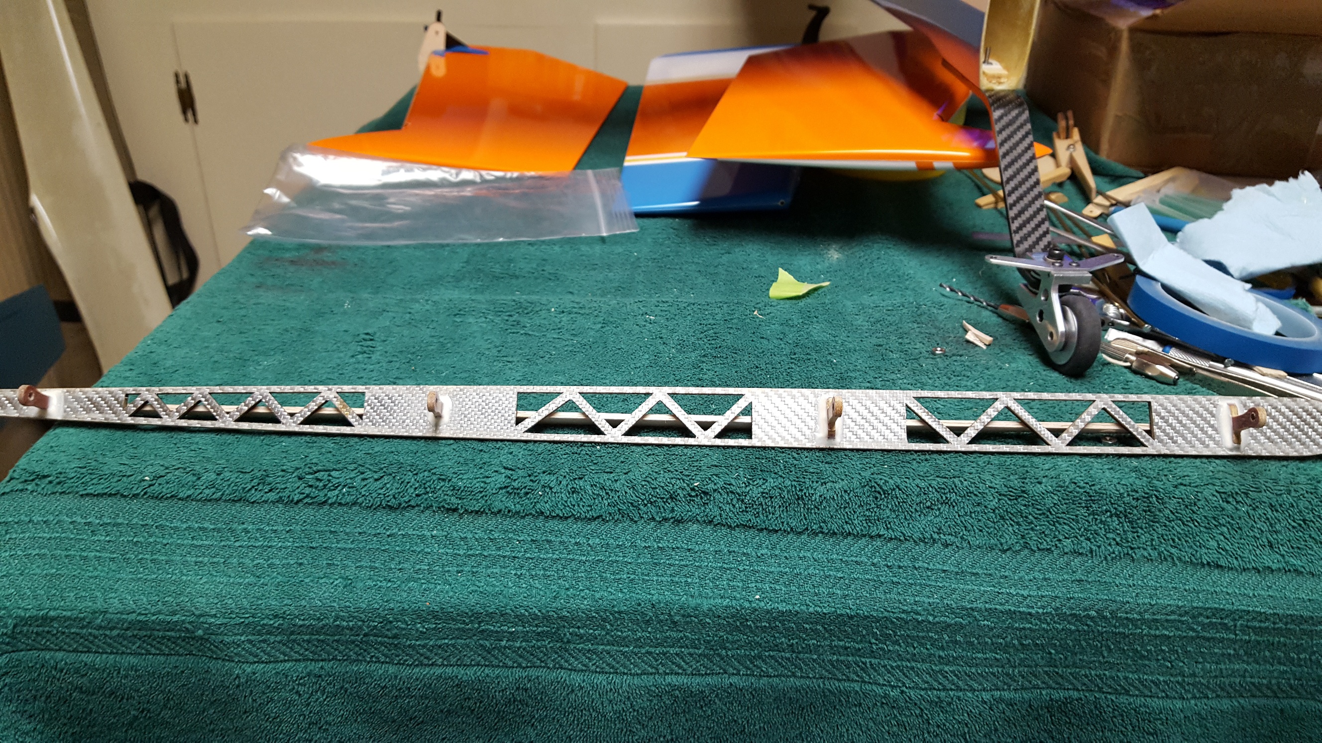

I added some balsa to the back side of the rudder post so it would hold it's shape and make getting the hinge alignment correct a little easier.
Also the Hysol finally arrived, so I glued the hinges in the post permanently.

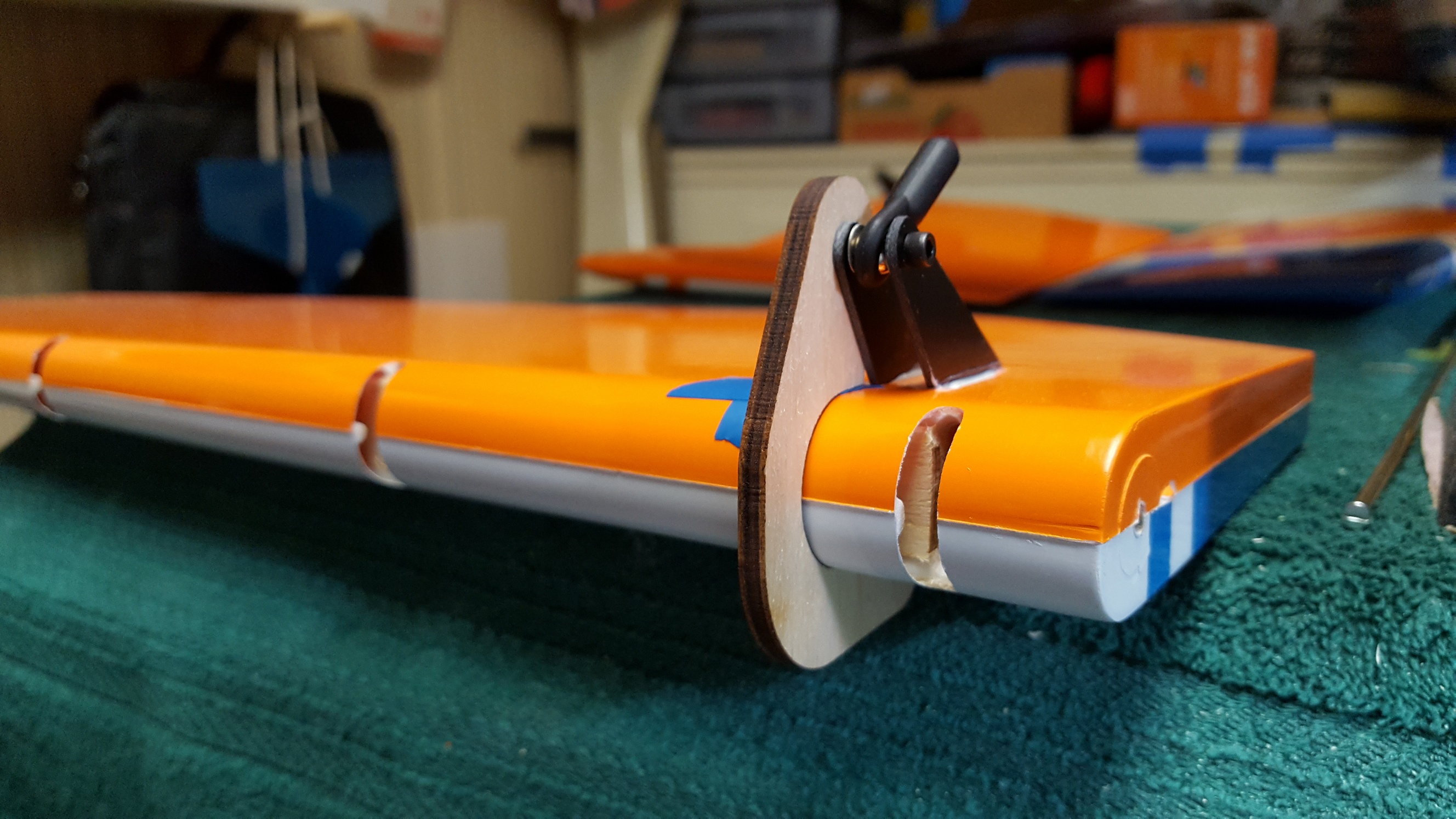

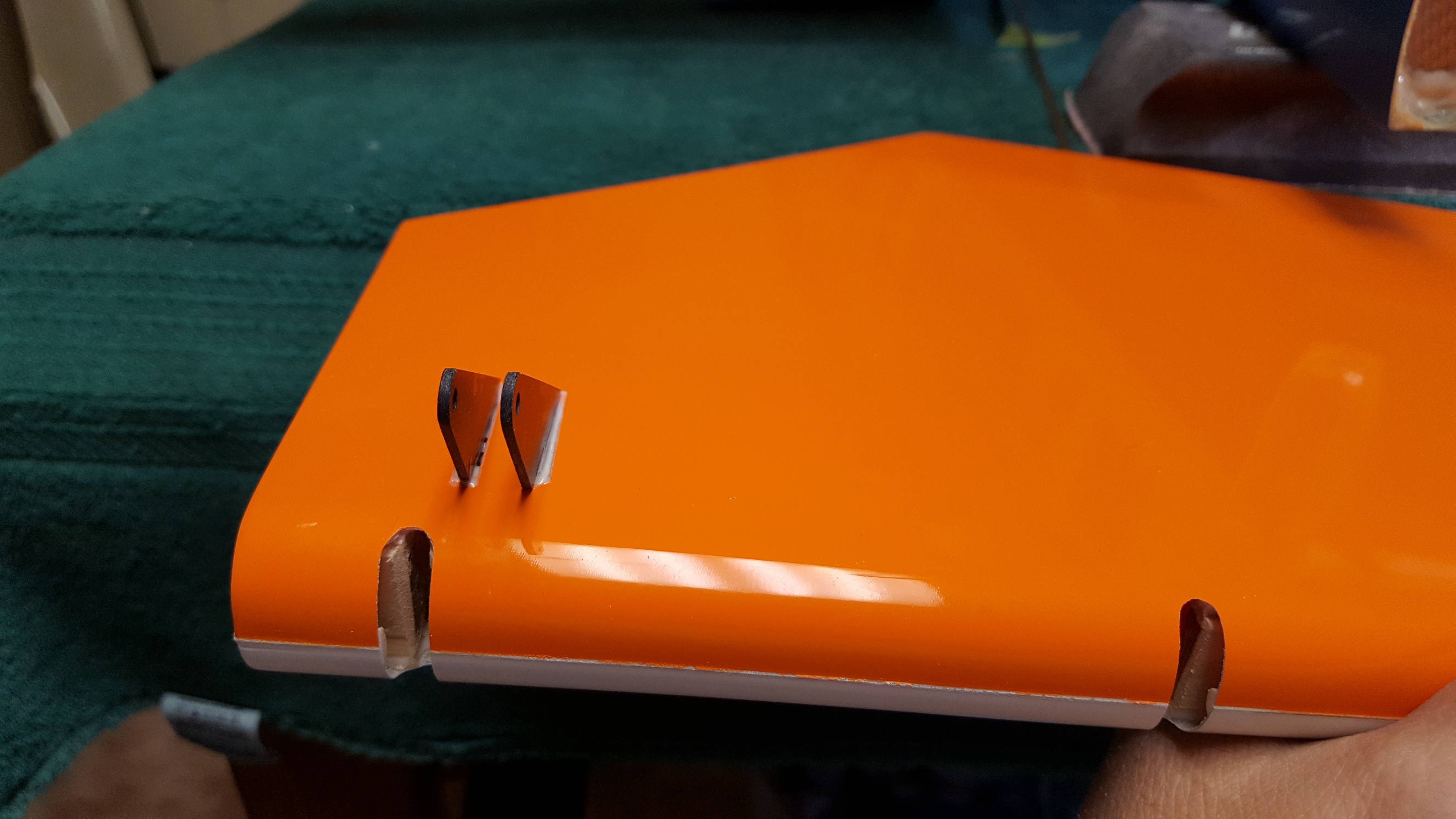

Yes, that's why I like to have several things ready to glue at once. Last night while doing the rudder hinges I also did the control horns in the elevators and rudder. With the long 55 minute work time you don't have to rush, and the glue stays just where you put it, it doesn't run all over.

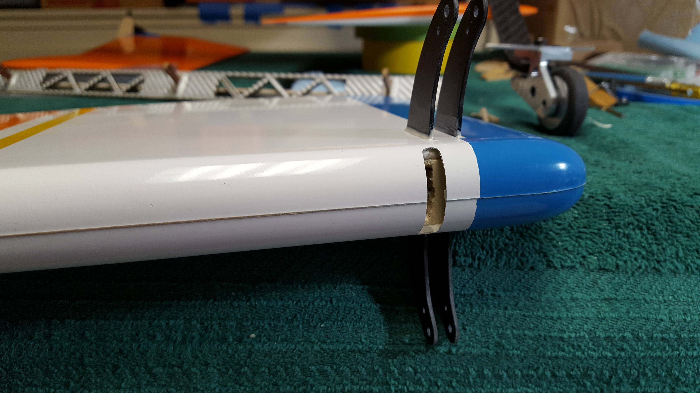

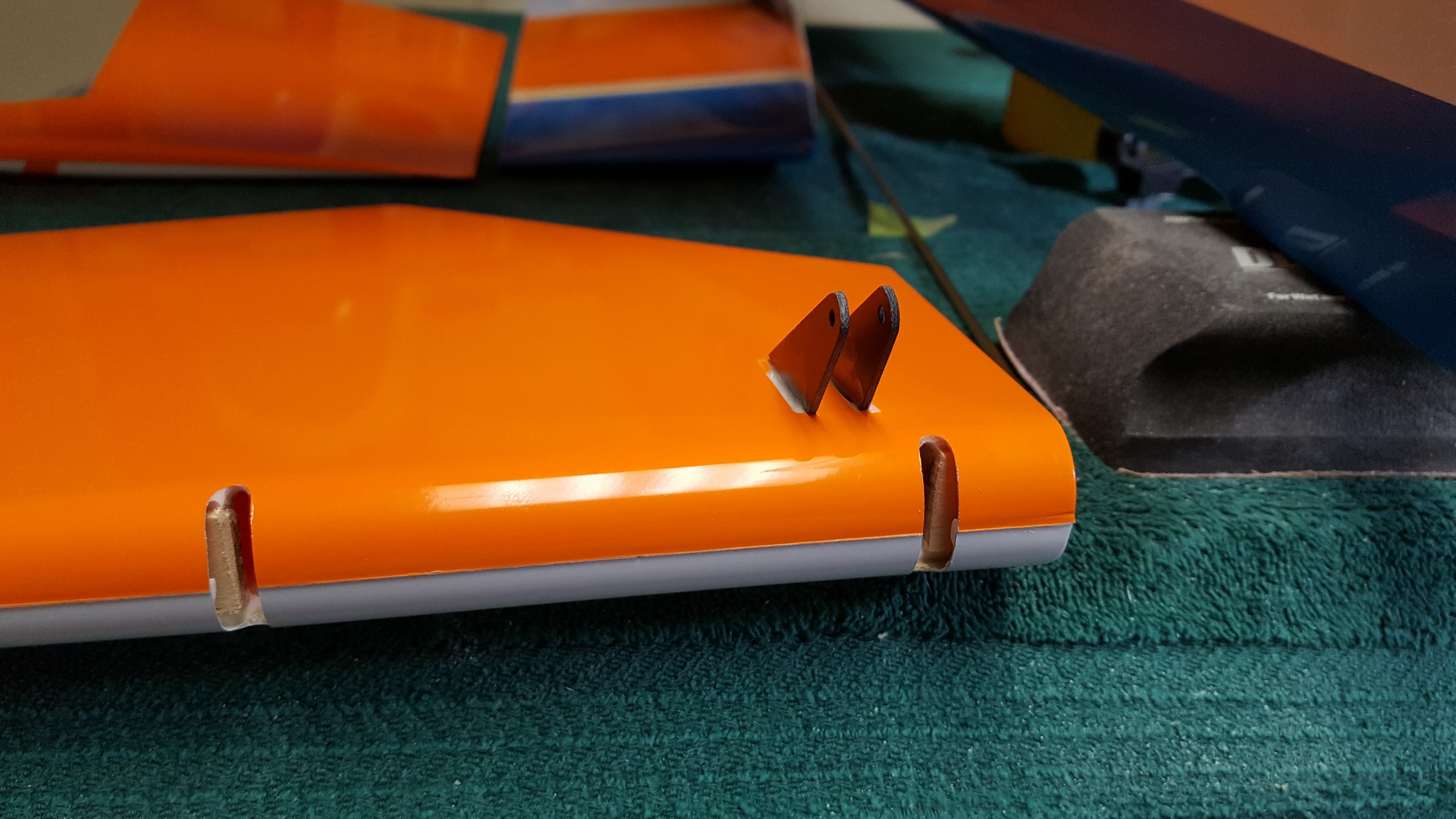

The other night when I was gluing the rudder hinges in I also glued the rudder and elevator horns in. The elevators came with laser cut plywood fixtures to locate the horns.

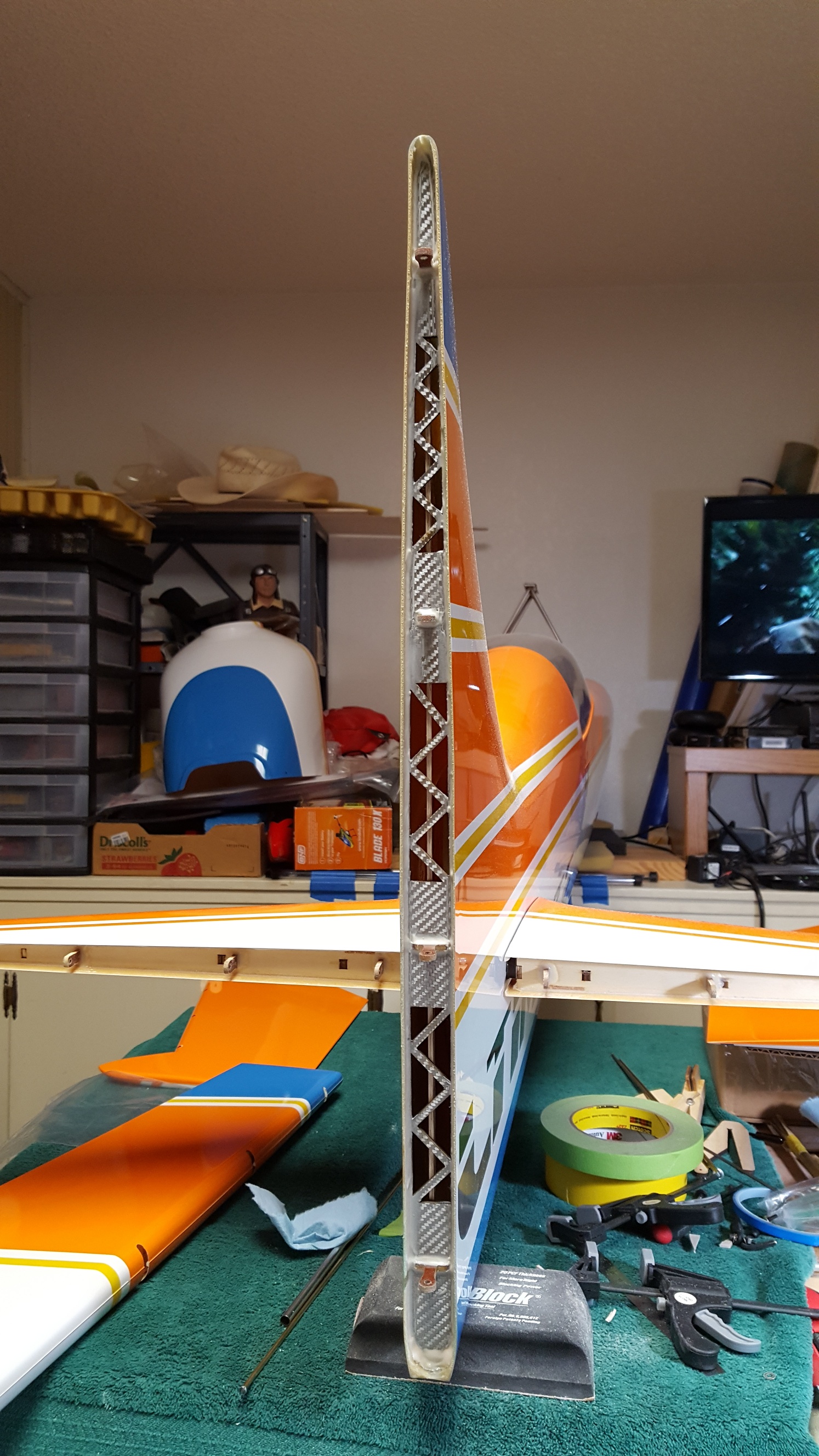

Last night I tackled the thing I've been dreading most, gluing in the rudder post. It took several tries to get it tacked in with CA right where I wanted it, but I was able to get it so the pin would slide in and the fit was as good as I could make it. After that I ran a bead of Hysol around the edges. Hopefully after it cures the rudder will still fit.
