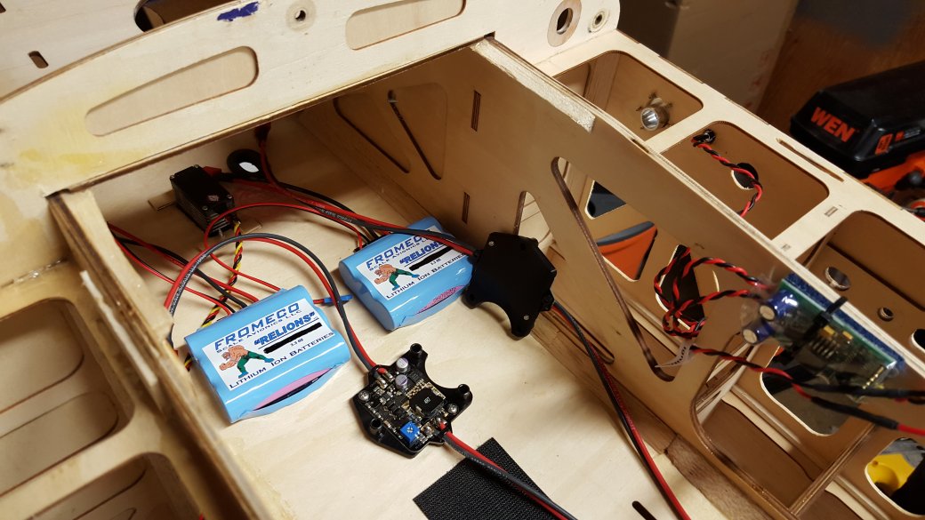

I just started doing my wire mounting the same way. Works great!
Did the electronics and the fuel tanks.
I know it's not furetitude but I've ordered the V2 so till they'll come I'm going to use these.
The extensions for the Ele are 59".
Attached them with Velcro, it's handy and it's very easy to install and take off when needed.
Like I've said no switches at all.
For the ignition I've ordered the ignition cut off from SF.
I love it to be plain and simple.

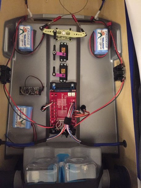

Looks CLEAN, Taz! Fromeco does have one new product that you might like... they are doing a 3cell setup that regulates to 8.2volts constant. I was talking to them about maybe having it adjustable down to, lets say, 7.4volts constant, as well. That way most all servos would be happy with it. It uses a switching regulator for efficiency.
Here is like I would like it to look like.
It's not fixed yet so...
Fromeco got a hall of fame on my planes they make very good products.
Too bad they're not making some new innovative stuff any more.

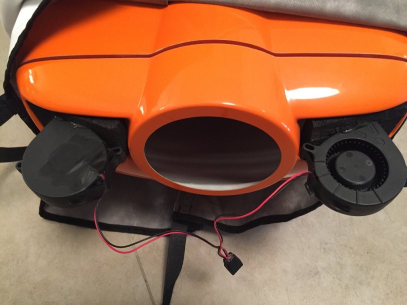

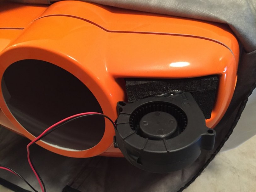

No cooling fans I'm a NACA ducts fan.
If I'll see that the regs will need an extra cooling then ill cut them and install them in the fuse.

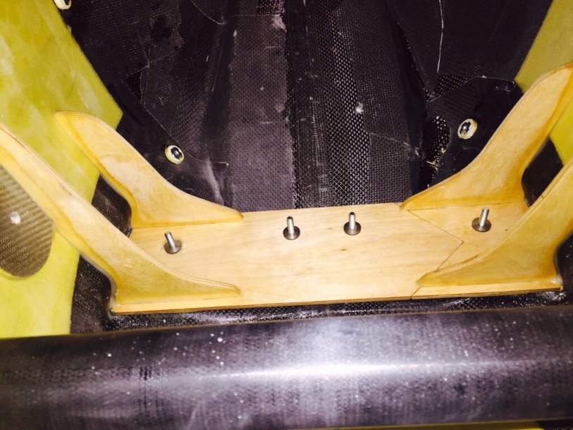

After talking with a friend that fly the LX I'm going to make some modifications to the gear block like using reinforcements with some carbon and epoxy.
It seems the split landing gear is making a lot of stress on the entire gear block structure so there are really three solutions,
1. Buying some high end carbon gear from chief for about 160$ with shipping
2. Reinforce the gear block structure and modify the landing gear.
3. Do 1&2.
Suggestions and comments are most welcome.
Yeah, that landing gear plate look like it was designed more for flying than for landing. haha
