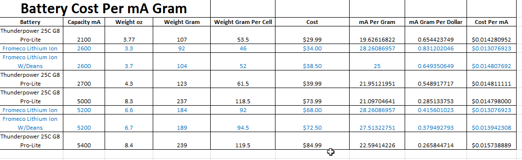

Ok, let's compare a Tesla to a ThunderPower 2S 2200. Thunderpower is an American company and all packs are assembled and tested here in the states.
A ThunderPower Prolite G8 2S 25C 2100mah pack is listed at 29.99. It weighs 3.77 oz. (~.5 oz heaver, ~$9 cheaper, and ~20C more powerful)
The Thunderpower pack is still cheaper, assembled here in the US, is .5 oz heaver, and much more powerful. If there is any American company that I trust C ratings and durability from, it's Thunderpower.

Moose, didn't you mean to compare identical capacities? The Fromeco ReLion packs are 2600mah, and thus the 2100mah Thunderpower wouldn't be equivalent... however the Thunderpower G8 2s 2700mah (much closer in size at 100mah difference in capacity, instead of 500mah) specs are as from: http://www.thunderpowerrc.com/2700-mAh_2/TP2700-2SPP25
The 2s 2700mah G8 pack is 123g, compared to 93g for the ReLion 2600mah, and the price is 39.99 compared to the ReLion at $38.00 with deans and balance tap. Not sure I see a weight or price advantage here, however as you correctly state, the Thunderpower are more powerfully rated.

I was going by Fromeco's "Usable Capacity" rating of their 2600 which is 2300. But, I'll agree.
It costs two dollars more, weighs 1.4oz more, and has ~20C more power.
I will trade 1.4oz (more like 3oz in a 50-60cc plane) and $2 for ~20C more power.

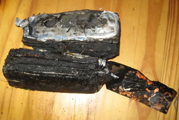

Nowhere in my post did I state that Polymers were unsafe .Well whats this say ?
I personally added that picture when I promoted Kurt's post to an article. (all the pictures, actually). I did this because:
1- I felt it was coherent to that paragraph about how Li-Ions vent fire in a controlled manner after the other fail-safe protections are exhausted, whereas LiPos don't have any safety features and burn more violently.
2- articles full of text with no pictures aren't as interesting.
Sorry that gave you the wrong impression.
