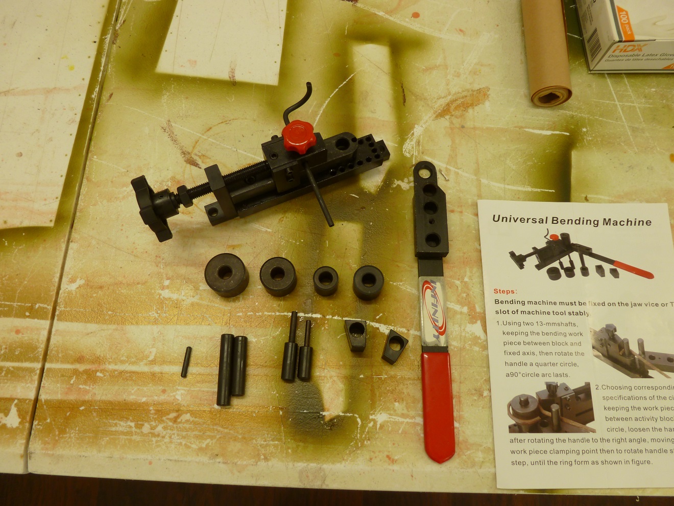

Ok Fella's, the Universal bender showed up. First impressions was when I picked the box up and thought wholly crap. I figured by the low price it might be a very light weight and low grade piece of equipment, no where near capable of bending 5/16 piano wire. After opening I see why it is heavy, this is one nice tool. The design kind of reminds me of a mechanical bender I used many years ago. It has a number of sized circular blanks as well as a couple angled blanks. I have no doubt this little tool will bend anything I throw it's way. Thanks @49dimes for finding and sharing it with us.
Forgive the hideous paint table used to photo on but all my others are over flowing.
