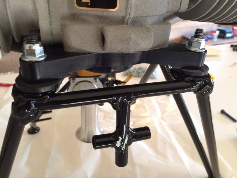

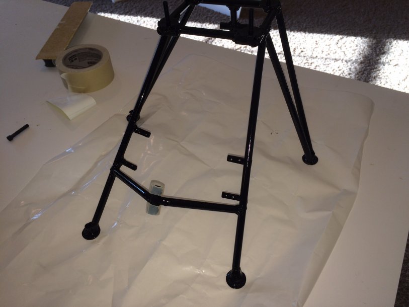

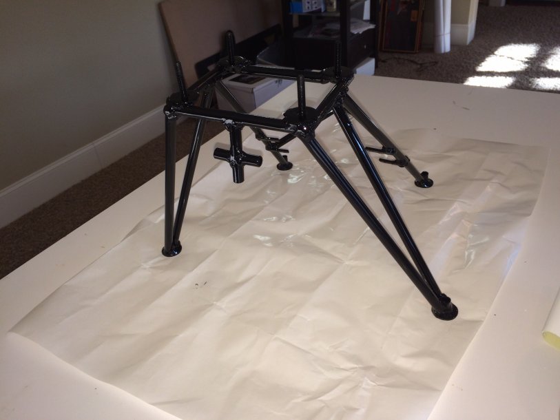

Yes, MIG'ed. It's 3/8 .035 mild steel tubing.
Look farther back in the thread, and you'll see it go together.

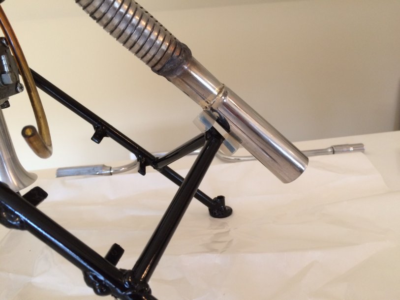

Yesterday, I prepoed and painted the motor mount. As you can see, between the engine and the steel mount, I made Delrin bushings, and also between the mount pads and the firewall. I can change the thrust and position of the engine just by changing the thickness of the bushing thickness.
Also, I am using silicon tubing as a bushing between the exhaust and the collector Y.
I'll final asseble the mount/engine, and get it ready for the test stand.
View attachment 14192 View attachment 14193 View attachment 14194 View attachment 14195

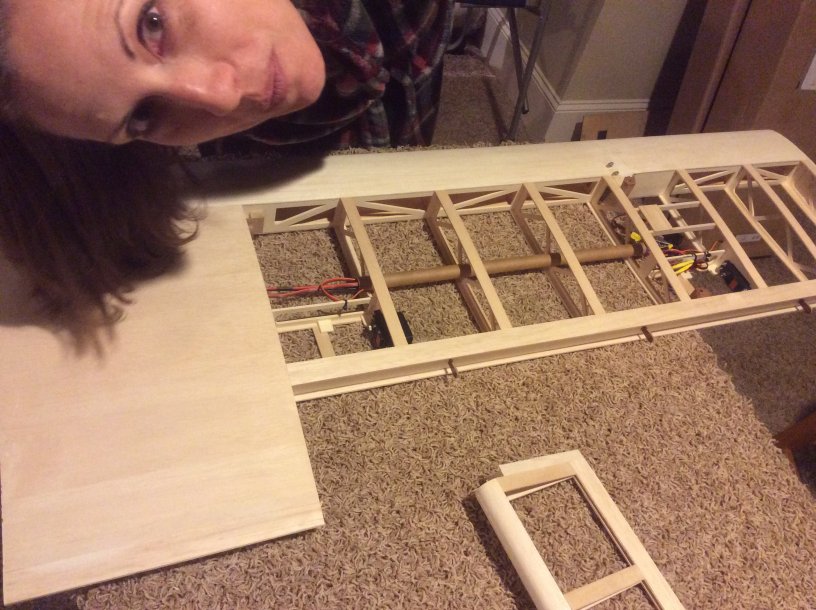

The covering came in from Balsa USA.... Sooooo..... Back to covering wings!
Next is the bottom right wing.

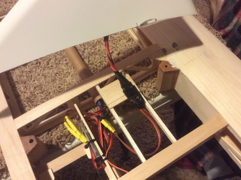

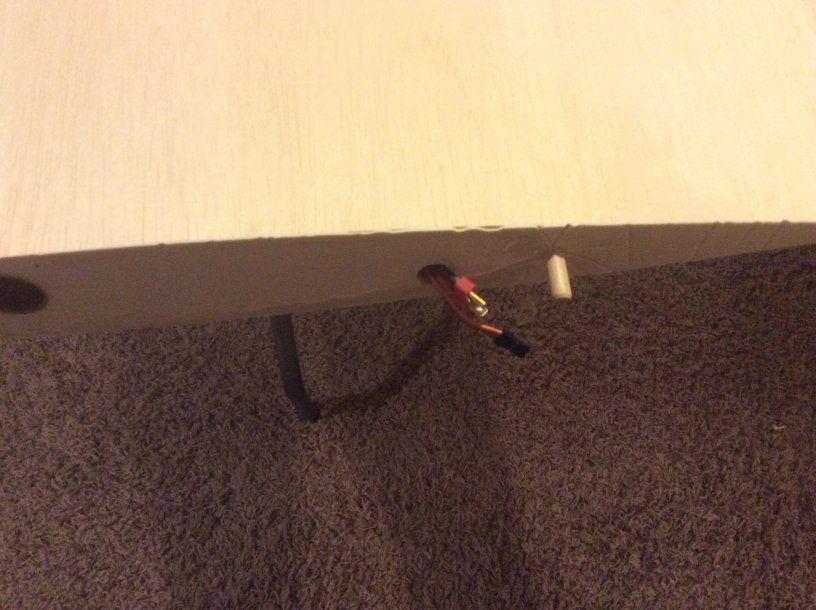

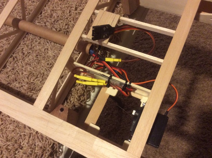

I already went through and wired the wings and installed the XBus PC-4 PWM harness. The great thing is that I will have one deans and one signal connector on the bottom wings. This will power the two bottom servos and the two top servos per wing halfs. I have molex connectors (like ashloc), 6 pin connectors with the wire running through the interplanetary strut. This way all the wiring is hidden.

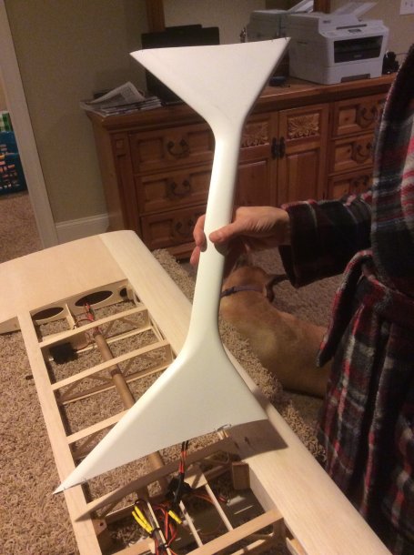

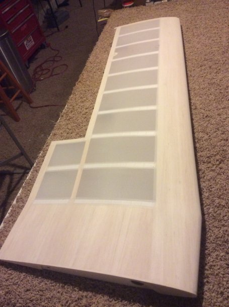

MattyMatt
Worked like a mad man today. Finished the bottom right wing, and covered, stitched, and got about 75% of the pinking done on the top two wings.
I didn't calculate the pinking and ran short.
