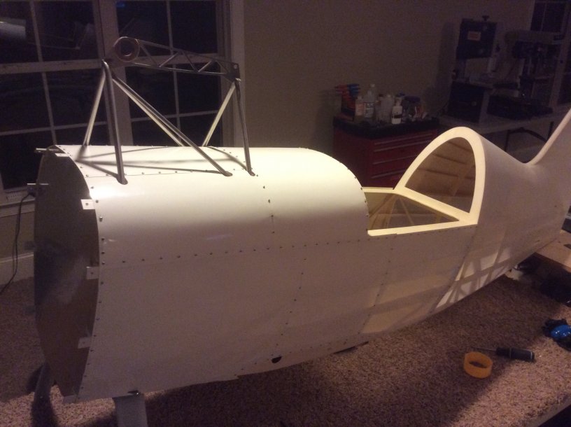

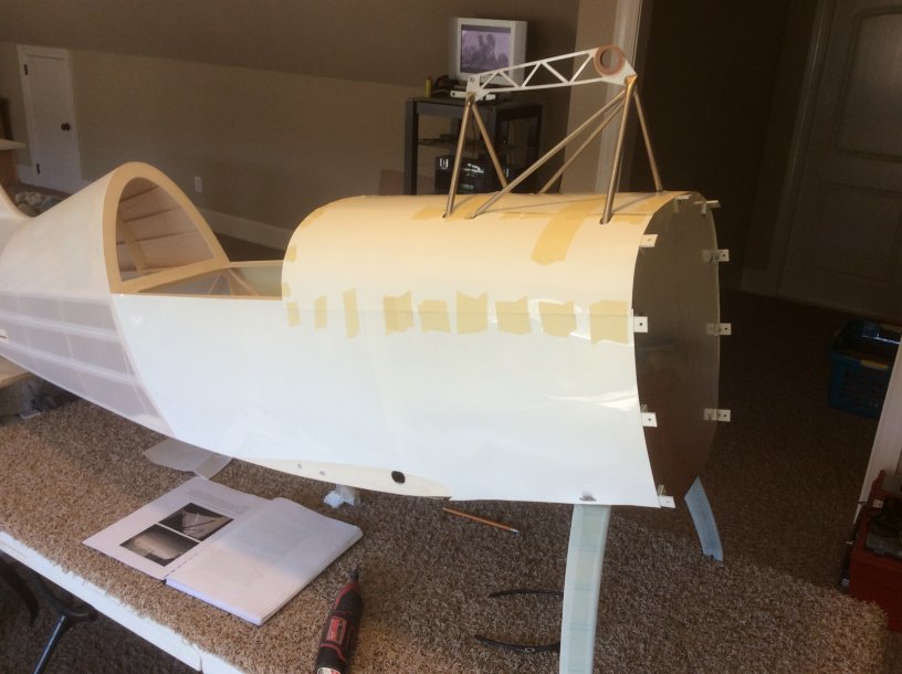

Ok, all the panels and screws are done. Next is to trim the panels in the cockpit area.
Then, canopy area.

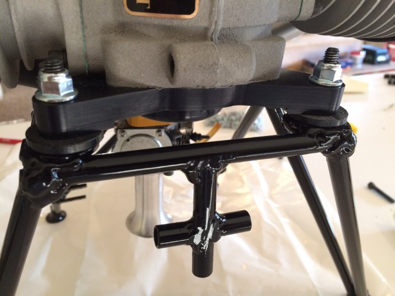

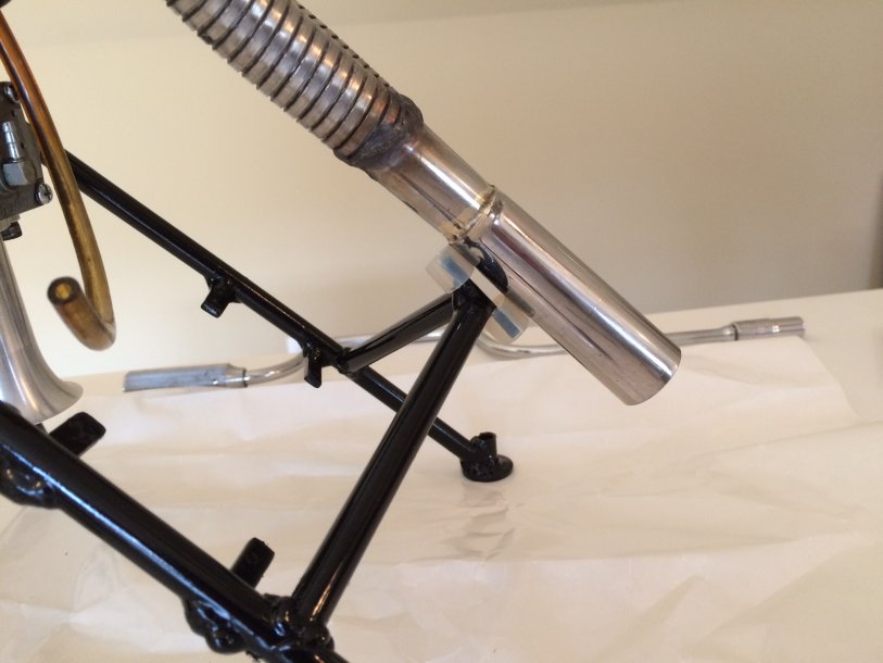

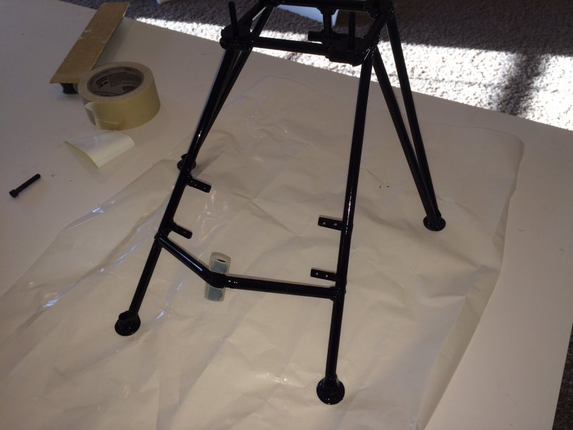

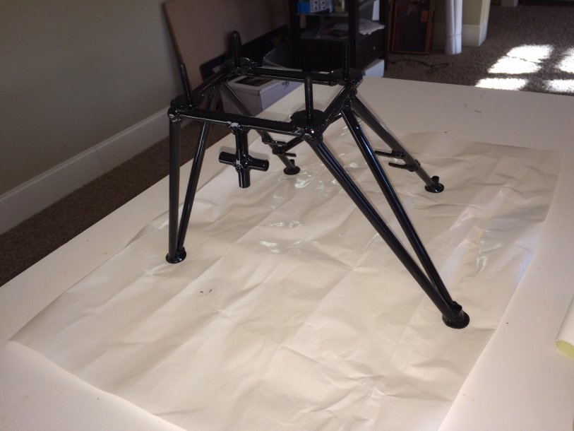

Yesterday, I prepoed and painted the motor mount. As you can see, between the engine and the steel mount, I made Delrin bushings, and also between the mount pads and the firewall. I can change the thrust and position of the engine just by changing the thickness of the bushing thickness.
Also, I am using silicon tubing as a bushing between the exhaust and the collector Y.
I'll final asseble the mount/engine, and get it ready for the test stand.

are the tubes actually welded? tig? or maybe brazed?
do tell (please)
