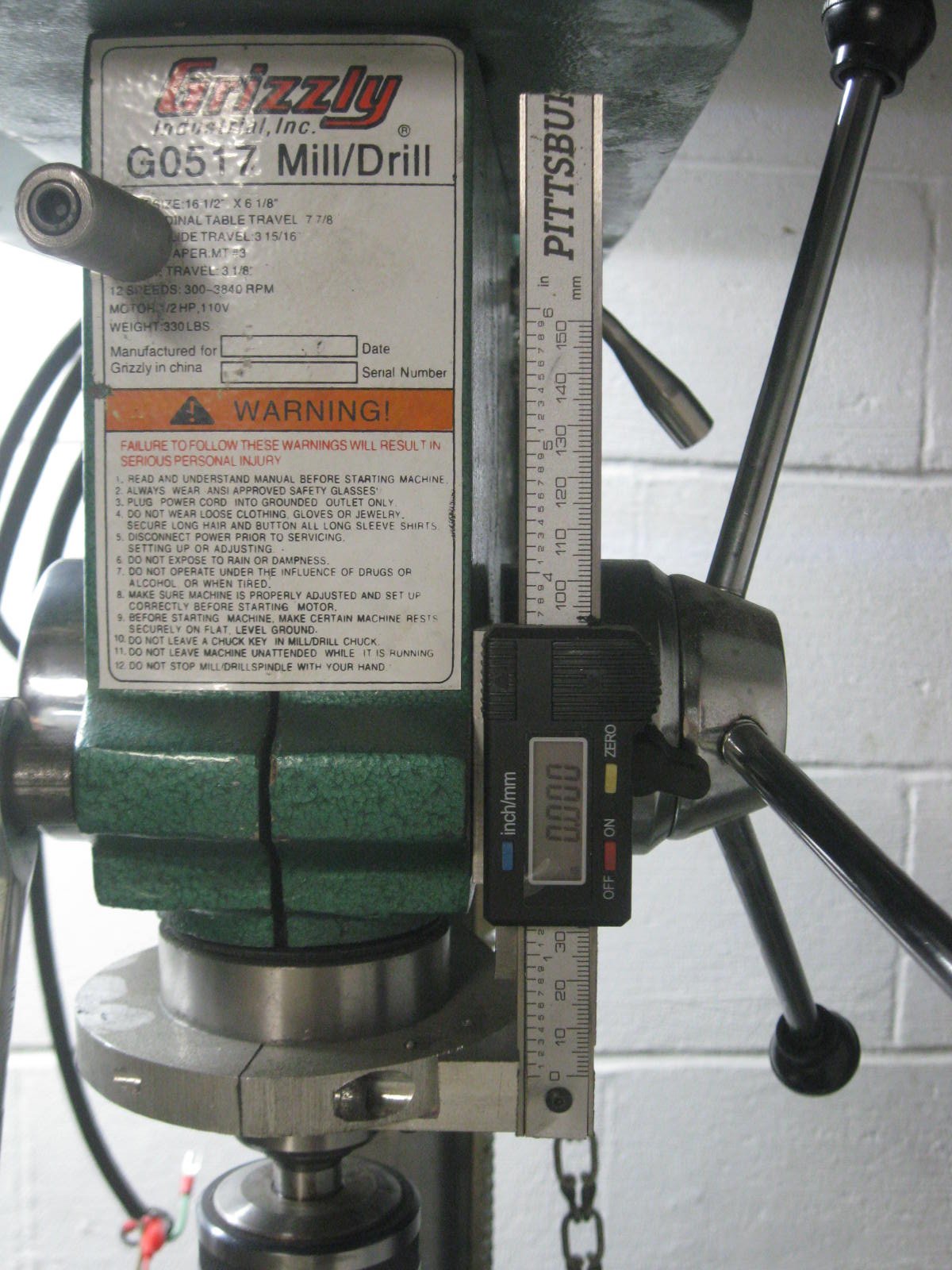

Here is a photo of a Harbor Freight 6" digital caliper mounted on the Z feed on my mill. I fiddled around for a day or so getting this mounted. Sawed the unnecessary fittings off and cut to length, works great. Touch the part, hit the zero and off you go.
The $500 may be well spent, of course it is easy when spending others money!!!View attachment 112976
Nicely done like the idea. Will keeping my eye out for a cheap digital calliper. Will do the same thing thanks for the idea.
