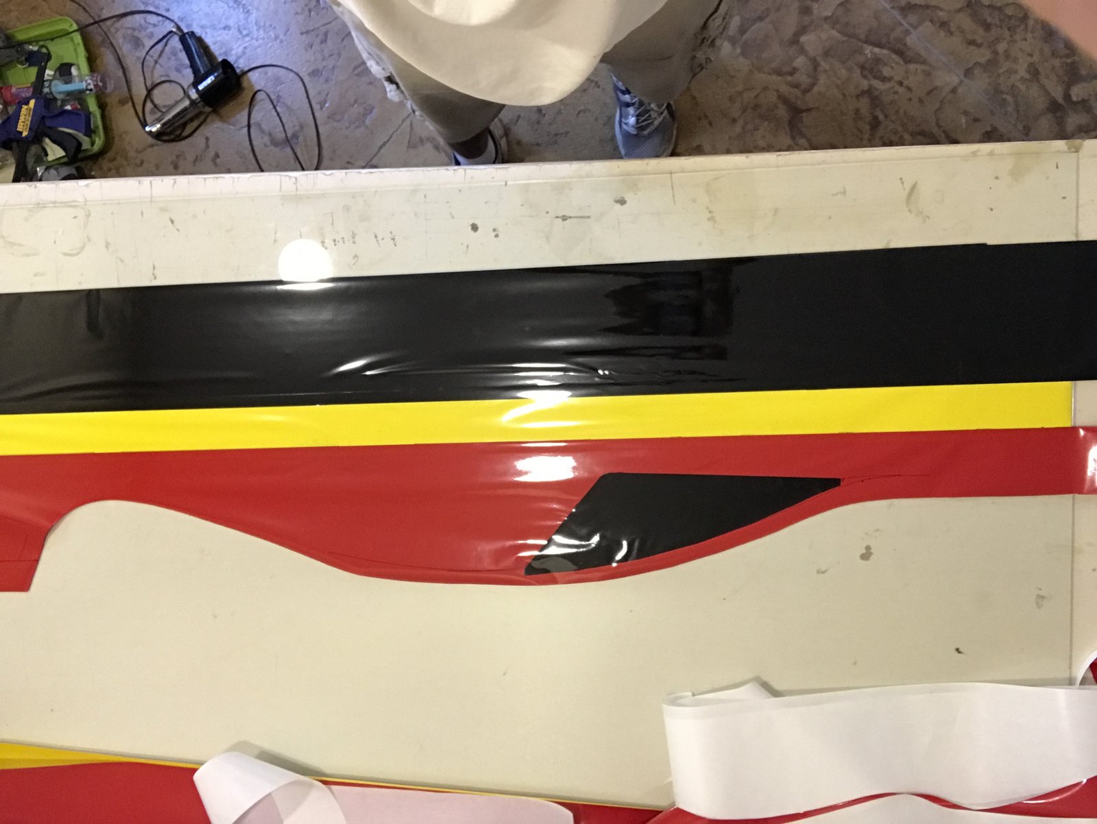

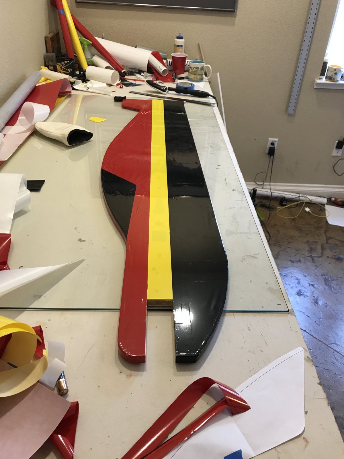

Right wing is complete (except for hinging and finishing the black trim stripe on the aileron). Left wing needs the aileron covered and the trip piece on the wing tip. Can't say enough about laying the stuff up on glass first.
View attachment 97733 View attachment 97734
