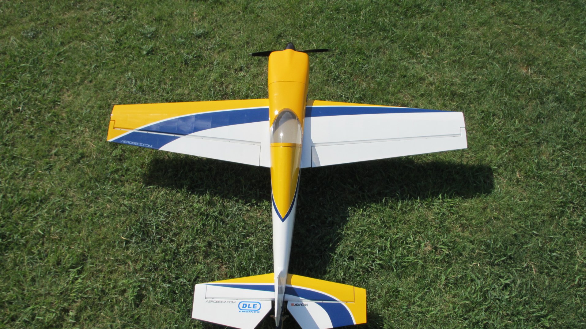

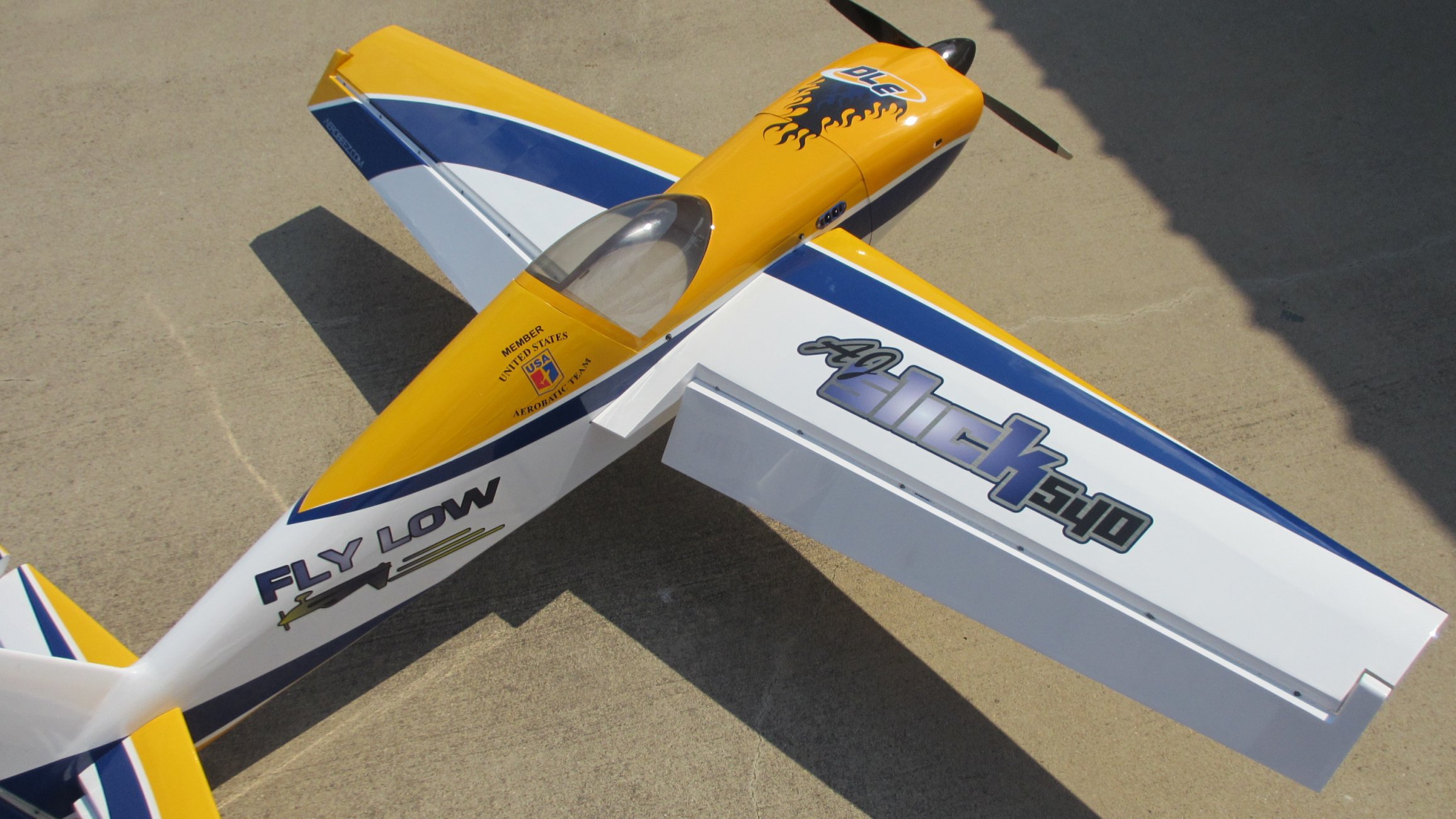

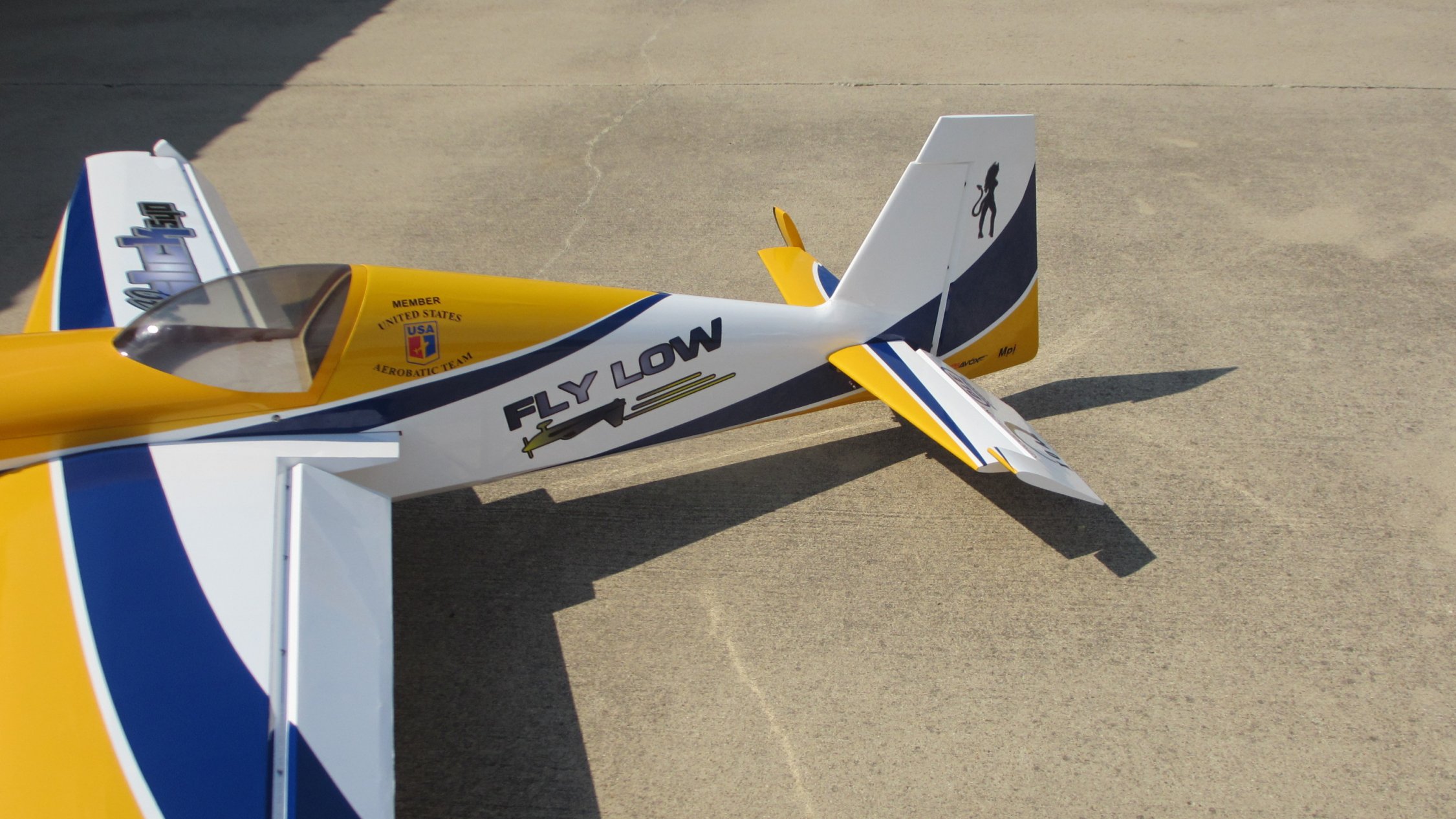

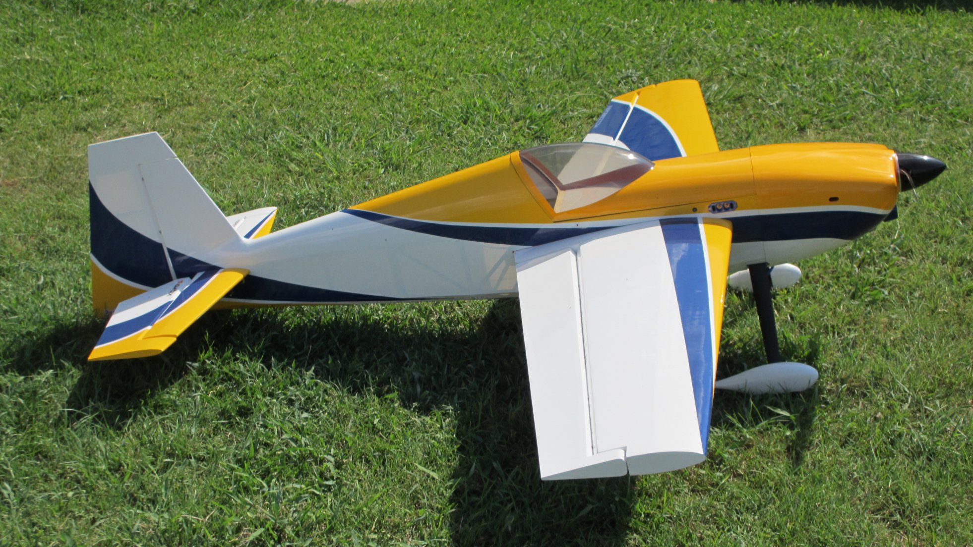

Well as promised here are some pix of my slick with my custom designed graphix
The graphix turned out great to me,, the guys at the field really liked them too, made the plane POP!! does not look so plain now. THANKS B&E I have one more graphic coming from another guys who does awesome work also, it is my clubs logo in black, gonna put it on the rudder where all the white is..
SO HERE IT IS FELLAS feel free to let me know how much you like it, and if you don't,,,,,,,,,,POUND SAND JACK!!! just kiddin everyones opinion is welcome..

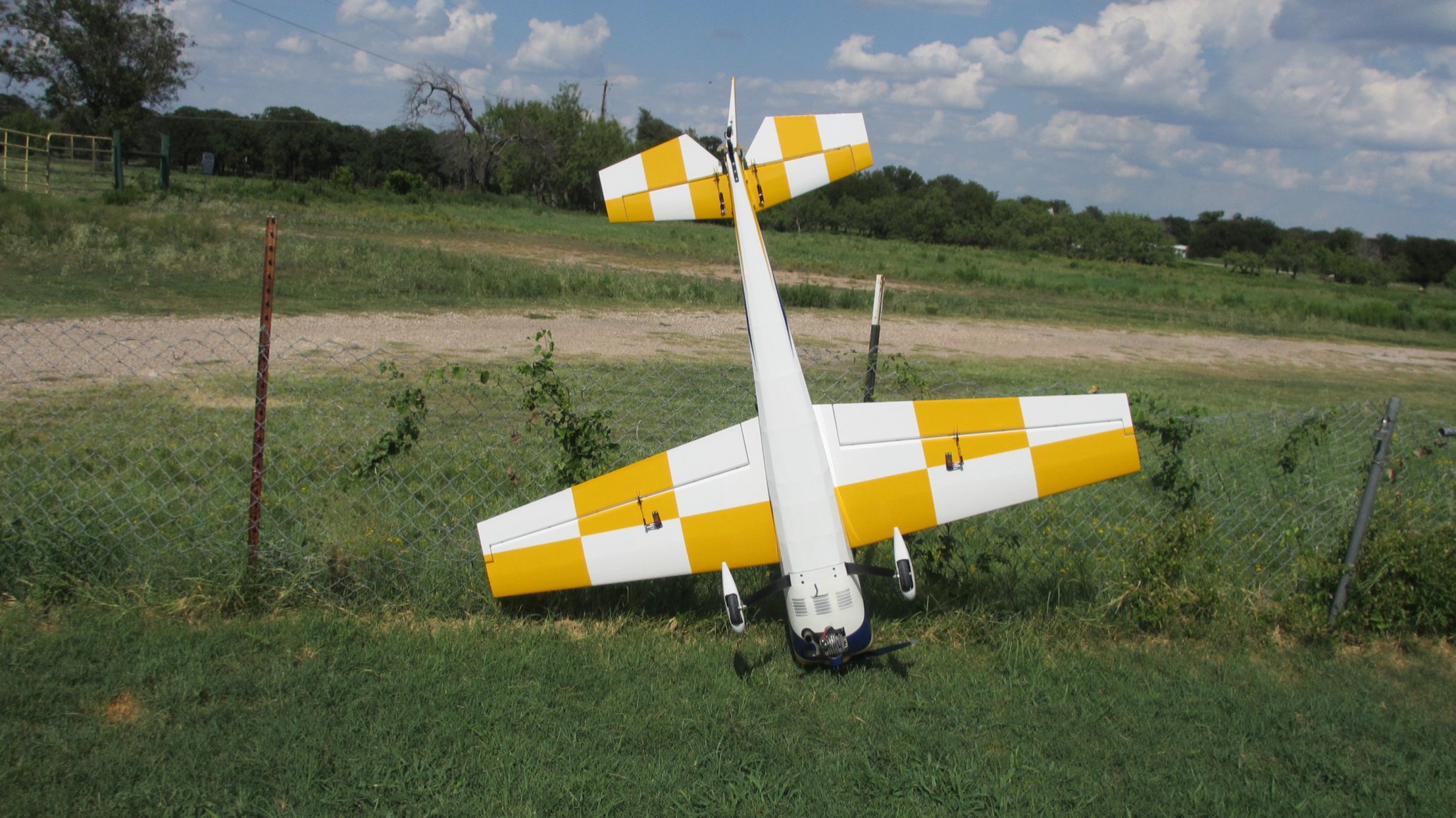

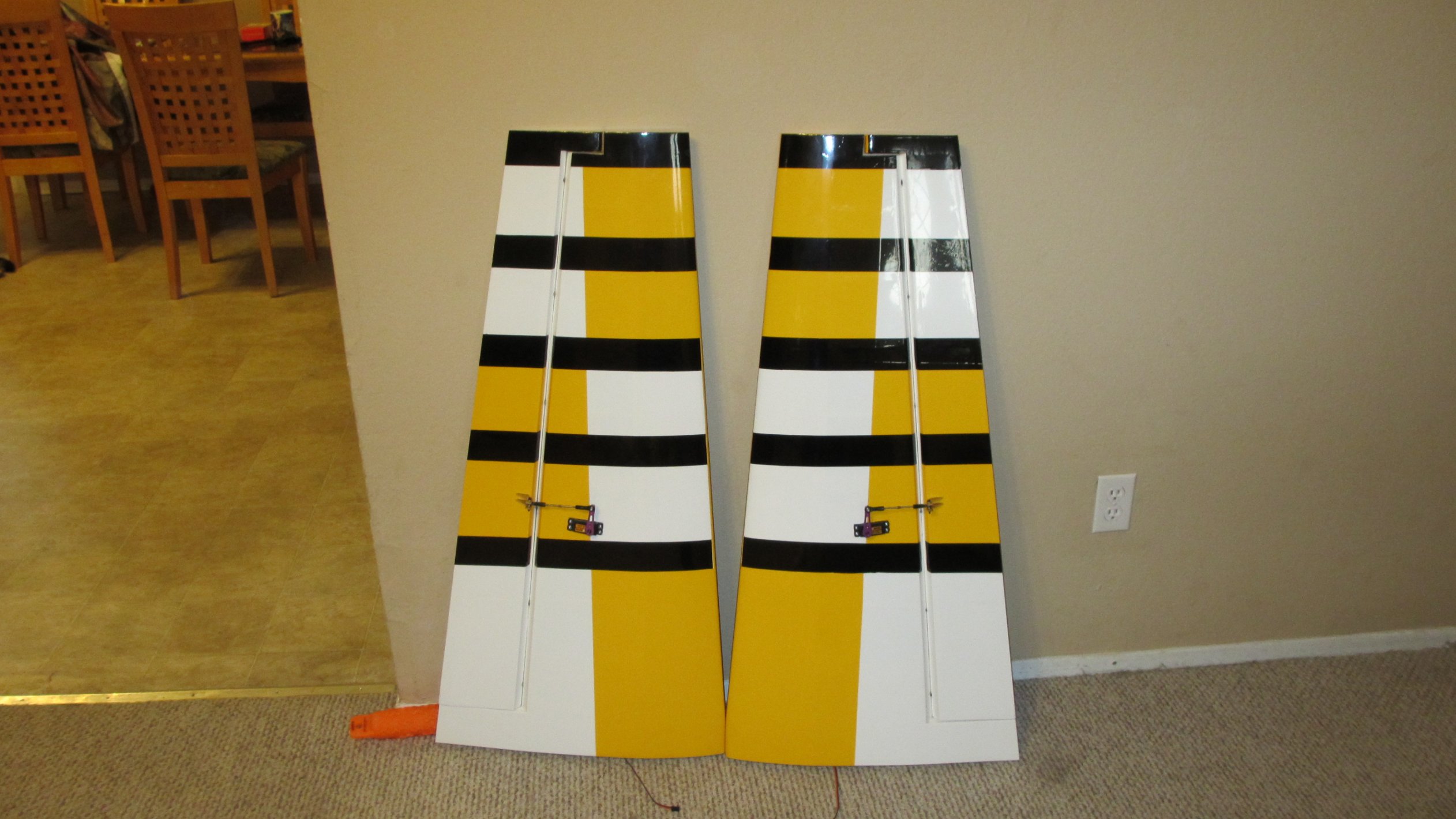

I also wanted to put some stripes on the bottom of my wings and elevators as I was really struggling to see the bottom of the plane during high maneuvers, the yellow and white just kind of blended into the sky,,I used some black ultrakote that I had in the closet, I laid out the stripes and then ironed them on,, would have liked to make them wider but I used what I had, and it didn't cost me a dime,,,
It made a world of difference, plane is much easier to see, and orientation is clear to me now,, Happy with the way it turned out..

Ronnie, aside from the fact it's not technically an AJ Slick 540, since I believe AJ only consulted on the 3DHS design, I really like the graphics! B&E does some awesome work :)
Adding the stripes on the underside of wings really helped with the contrast. I'm contemplating something similar on the 73" Yak we just got... There is the beautiful green on both the top and the bottom.
