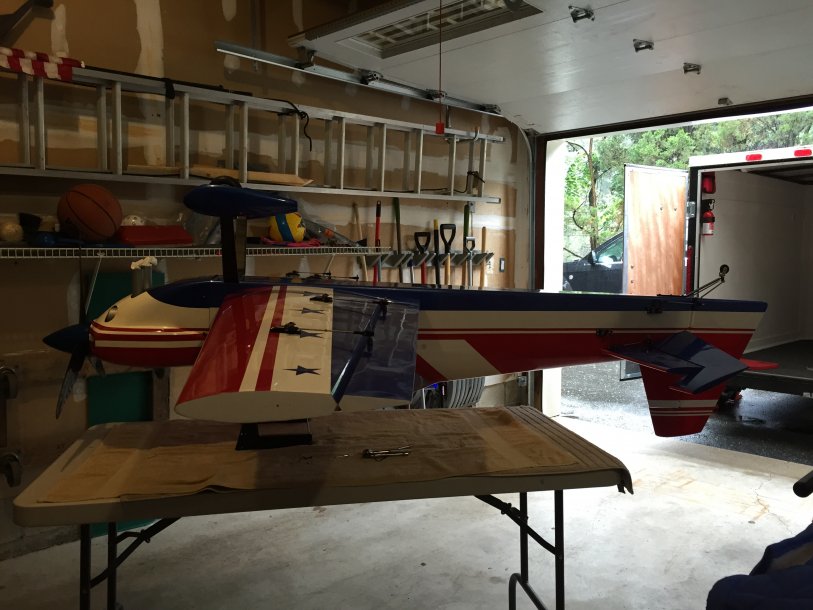

I followed the steps, I've flown mostly Caps and Sukhois, so I agree with the comments related to the tendencies/characteristics related to the design. I still love Caps, it's part of the allure to the model. I've flown light ones, heavy ones, some that tumbled like nothing else and others which were a bear to land. I currently have a smaller Cap which I have spent a lot of time trimming and is a pleasure to land. I just can't avoid drilling down through all of the possible variables until I am certain there is no more tuning I can do in order to improve negative tendencies.
The rationale for the thread was to avoid making unnecessary changes, like thrust angles, when potentially CG might be the issue. Even though I was within range, and in-flight tests appeared ok. I decided to pause where I was and poke around on the site and solicit the crew's thoughts and consideration. I was looking for troubleshooting inspiration in case I might have missed anything in my initial testing and assessment. As expected, the fellows on the site have been great, and I'm very thankful.
Thanks guys...
sc
Let us know what ends up working
Will do, I made a CG adjustment, will test on Friday.
oh yes, I had to pull out the old GP CG machine to test inverted on my own, worked quite well... ;)
sc
