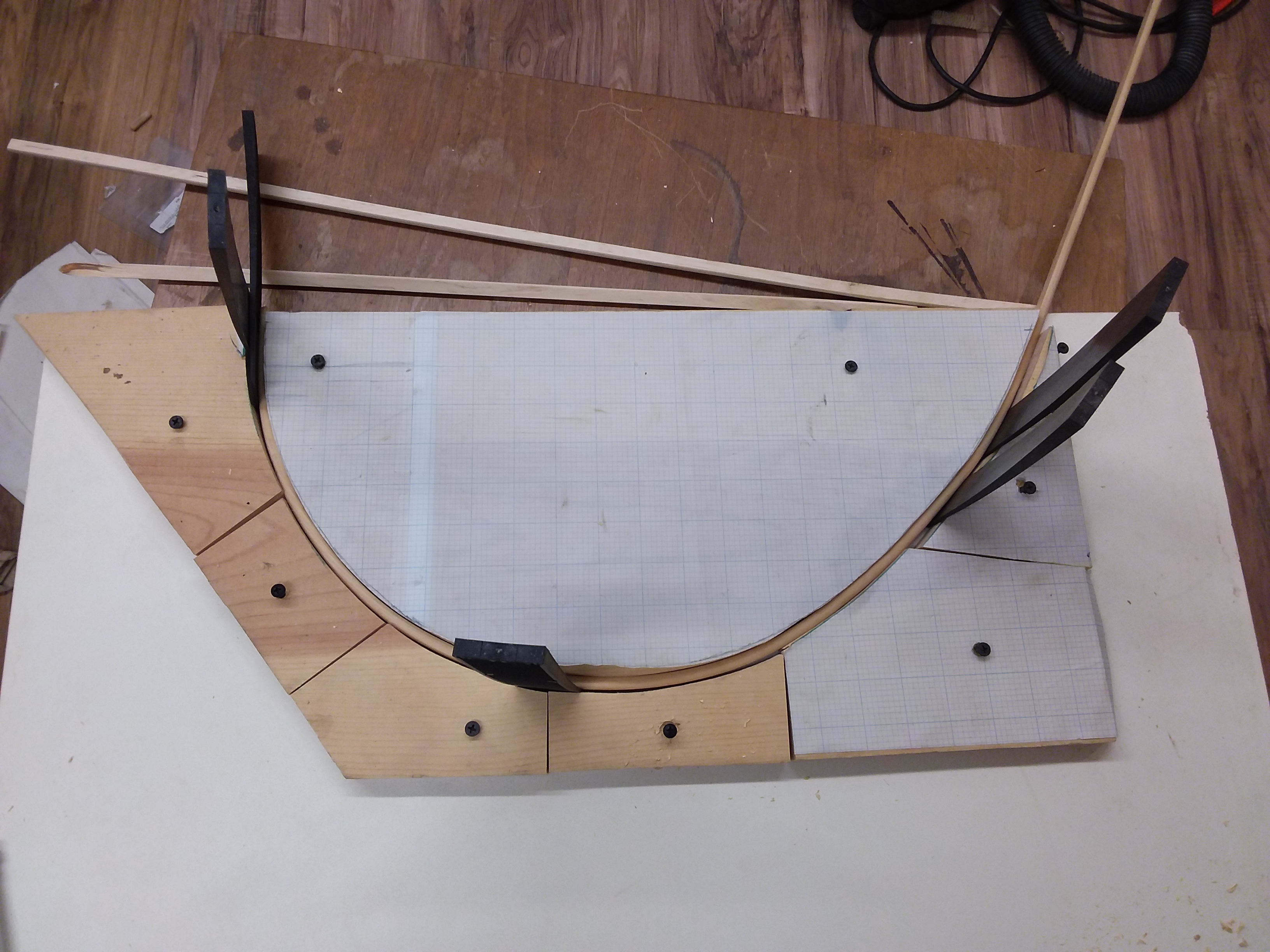

    Know what you are talking about. The back bone on the 50cc profile I am building I did the same thing it takes a little practice and knowing when it is wet enough. It took me a few try’s before it worked. I had to keep reducing the thickness off the wood and kept making wetter until it conformed the shape I needed. But once it is done man is it strong and shape resistant. Looking good keep up the good work, nice to follow somebody do a kit build.

    I had an older club member tell me about using the original Windex (with ammonia) to warp wood, it apparently softens the wood/glue temporary to let it curve better. I have not tried it. Being from Alaska, you use what you have lying around. You could probably pick up ammonia in a 5 gal bucket down in the con US for 2cents...

    yes windex works better for bending the wood.

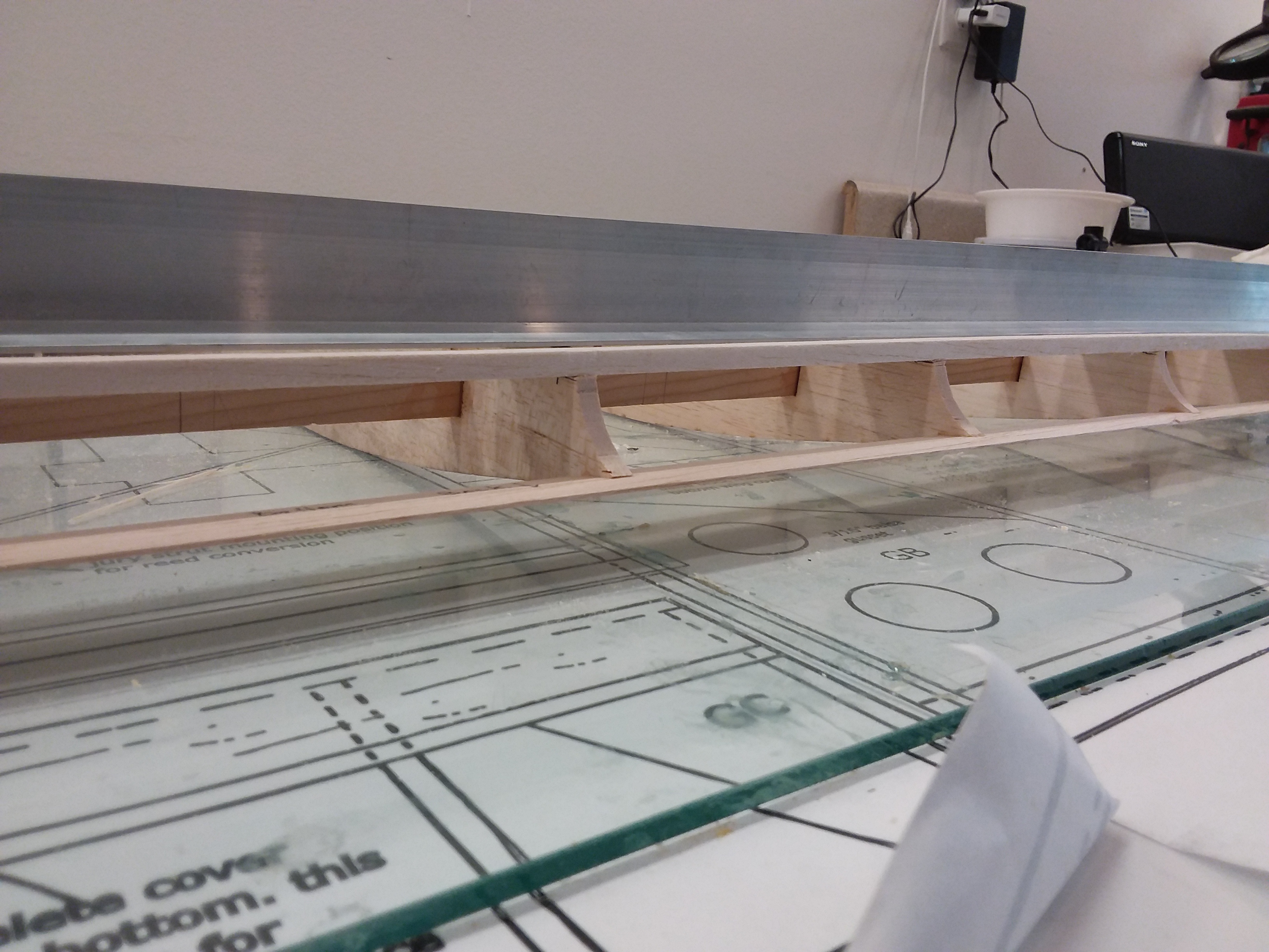

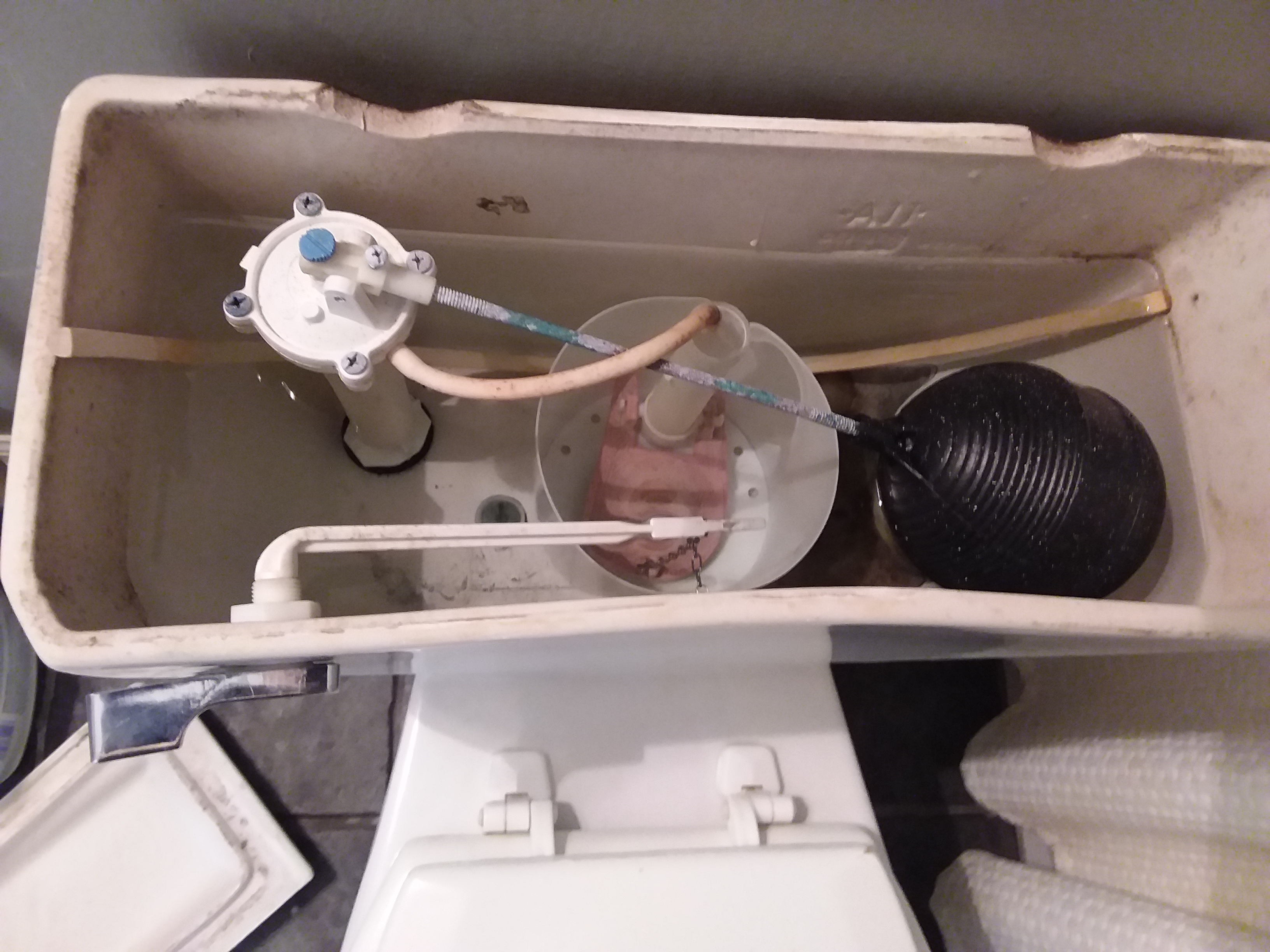

    The curvature of the wing tip is not right at the leading edge so I tried soaking just the end. I found the rest of the curve straightening up on me while I soaked the end but how to keep the entire curve wet? I found a way.

    Trust a plumber to think of that one. I like it and it works.

    Yeah, and I got a failing flapper in that tank. One of my basement bathrooms so I haven't looked inside the toilet in years.

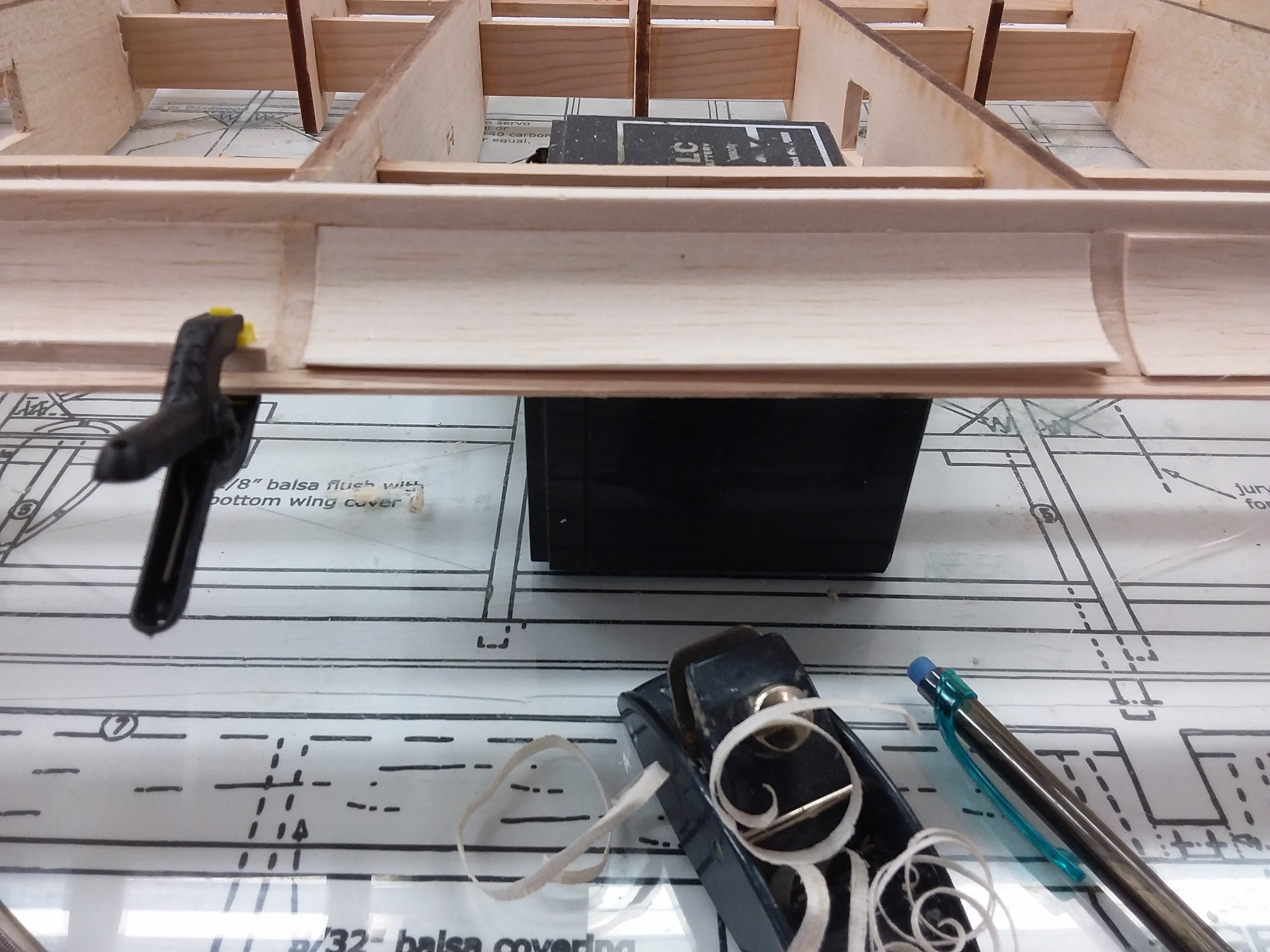

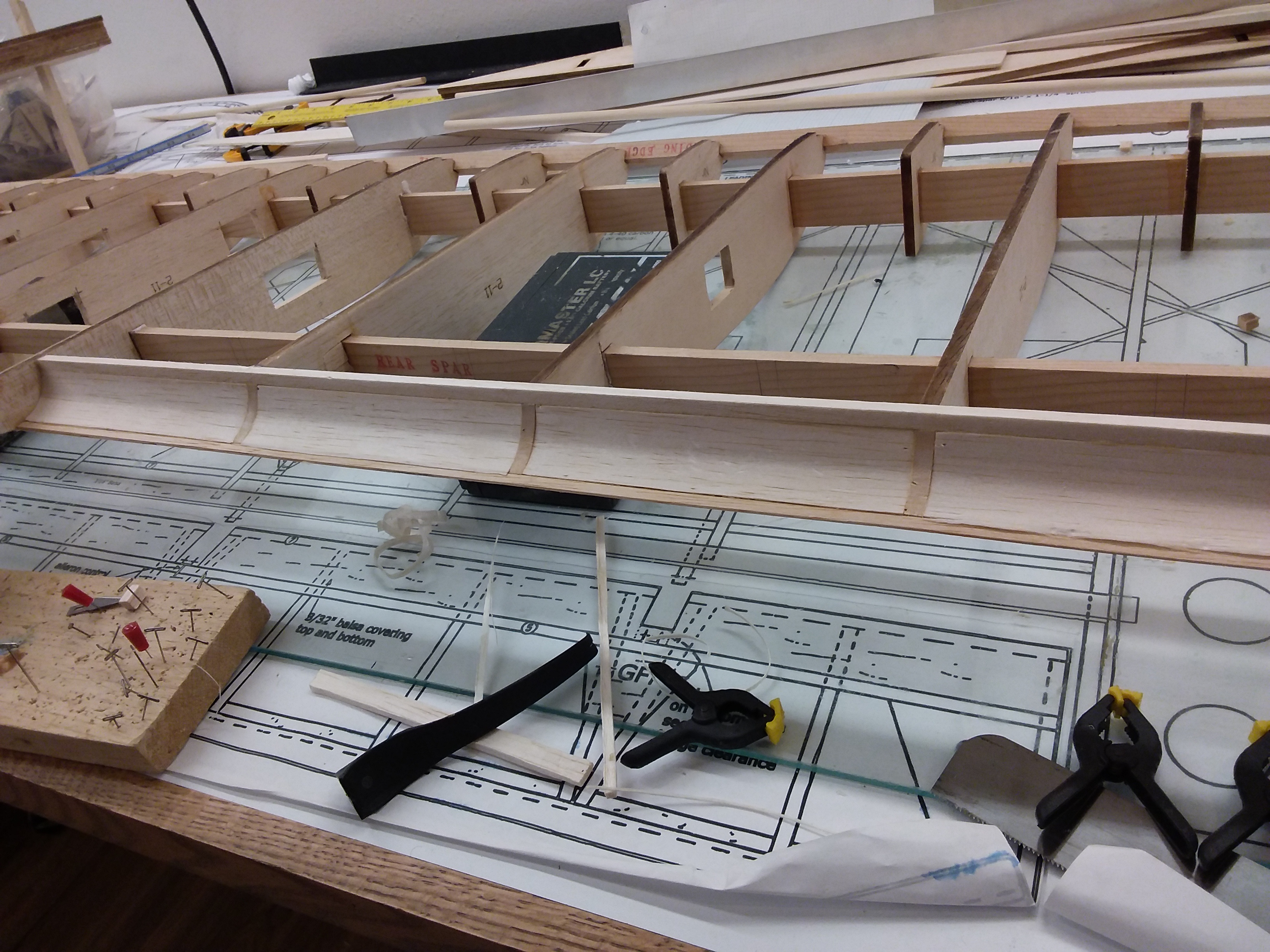

    Lower trailing edge piece is wavy so cutting loose and repairing.

    More trailing-edge work.
