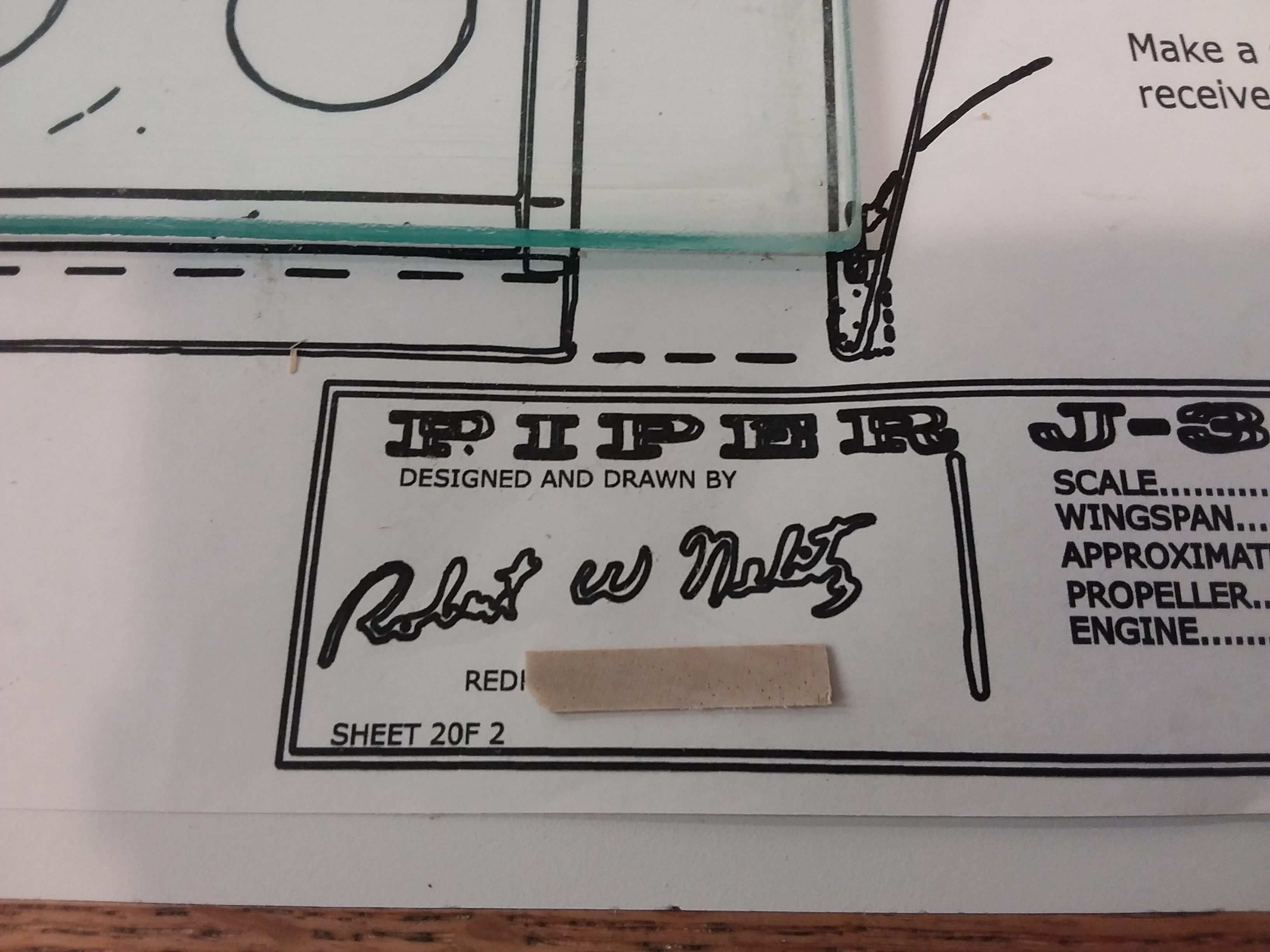

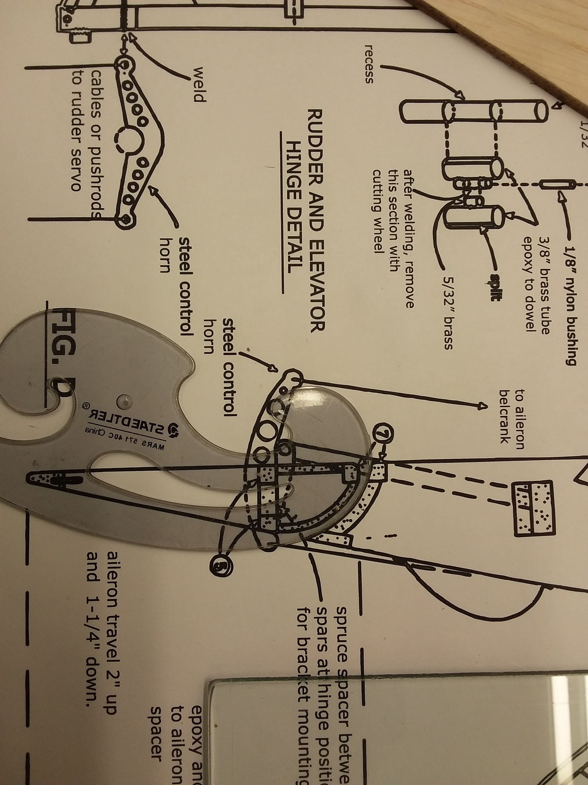

  3. dhal22
    dhal22 GSN Sponsor Tier 1

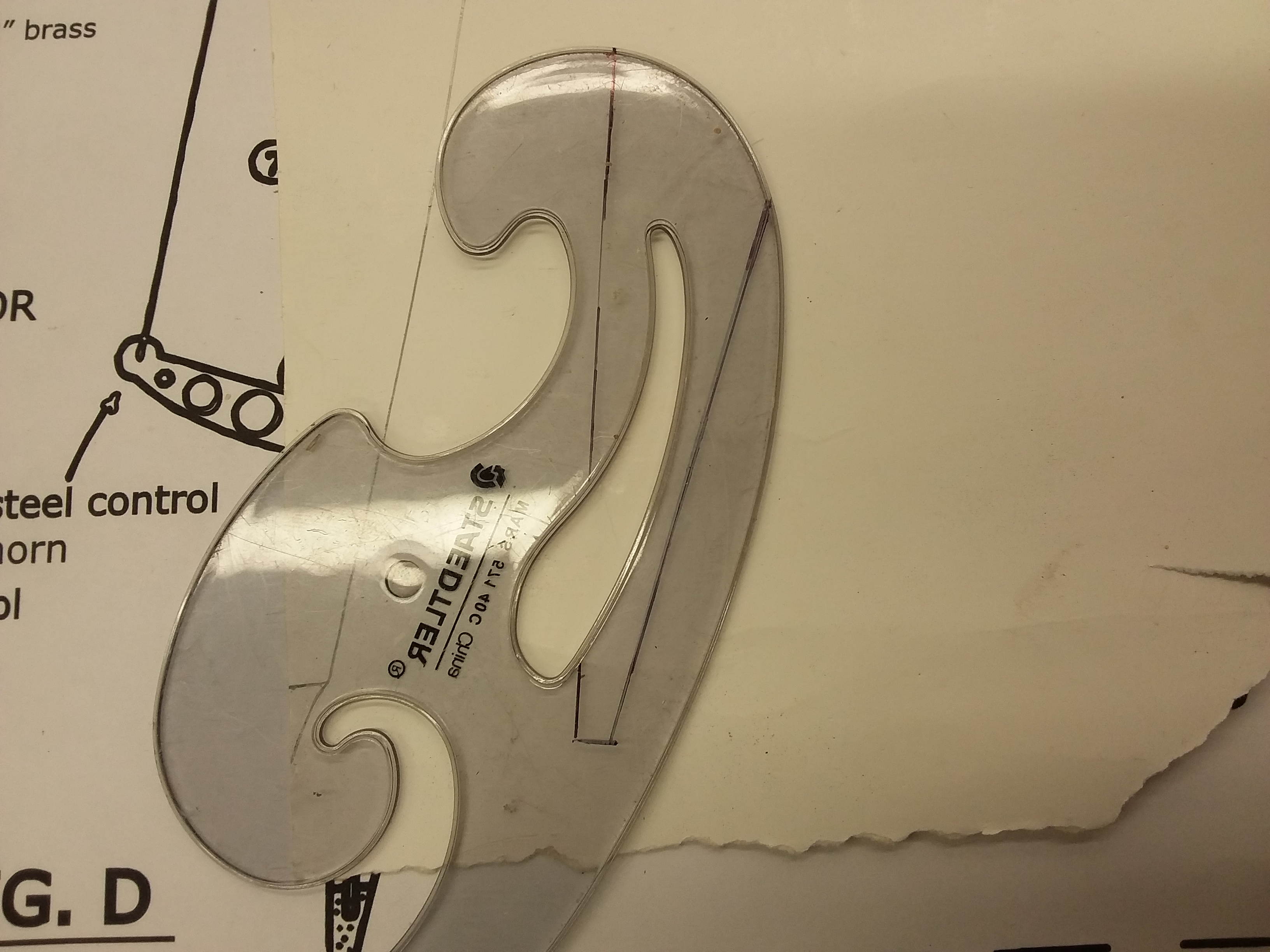

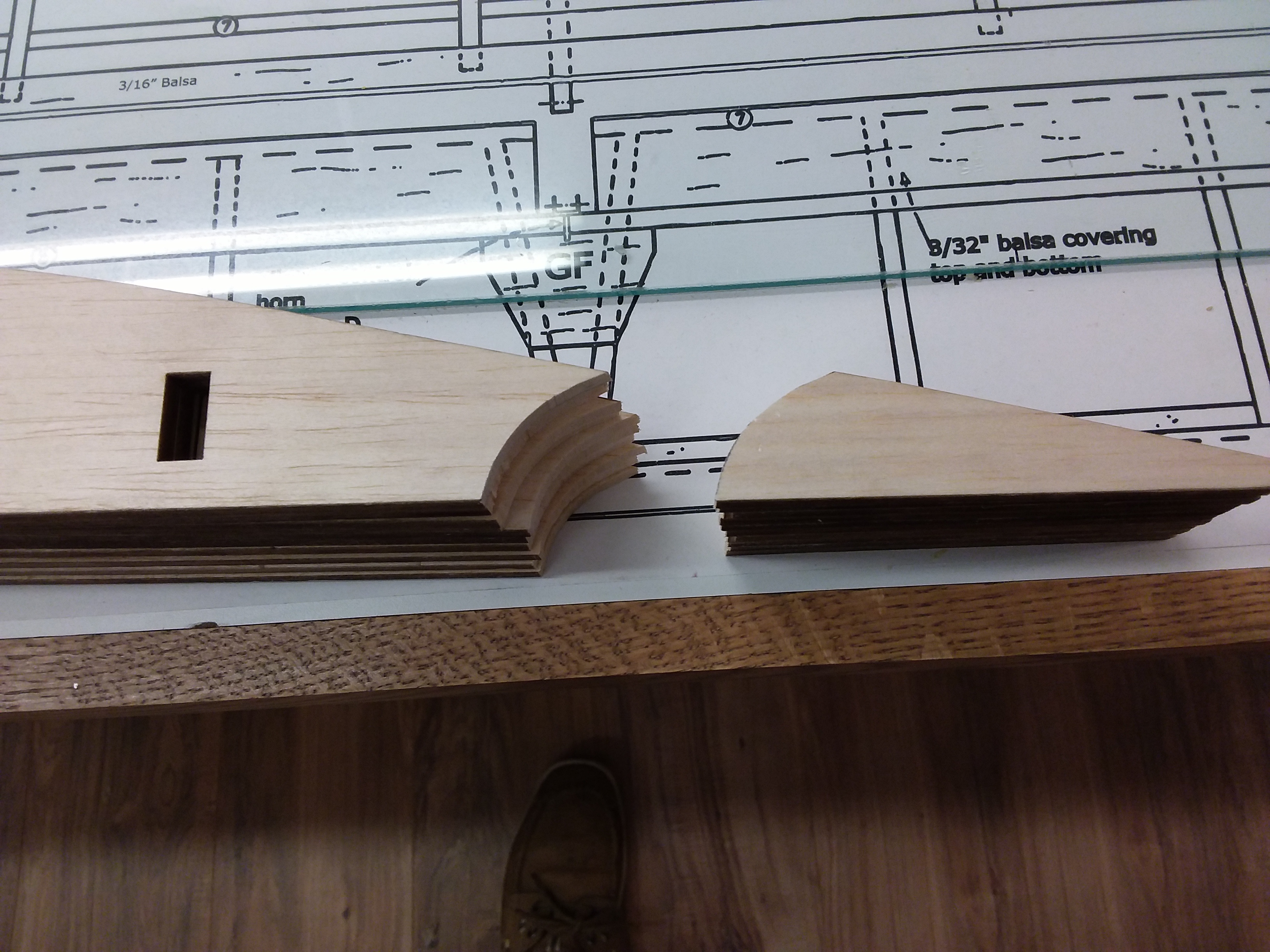

    Time to cut the ailerons out of the ribs. Used a French curve to find the curve then marked the curve with a Sharpie.

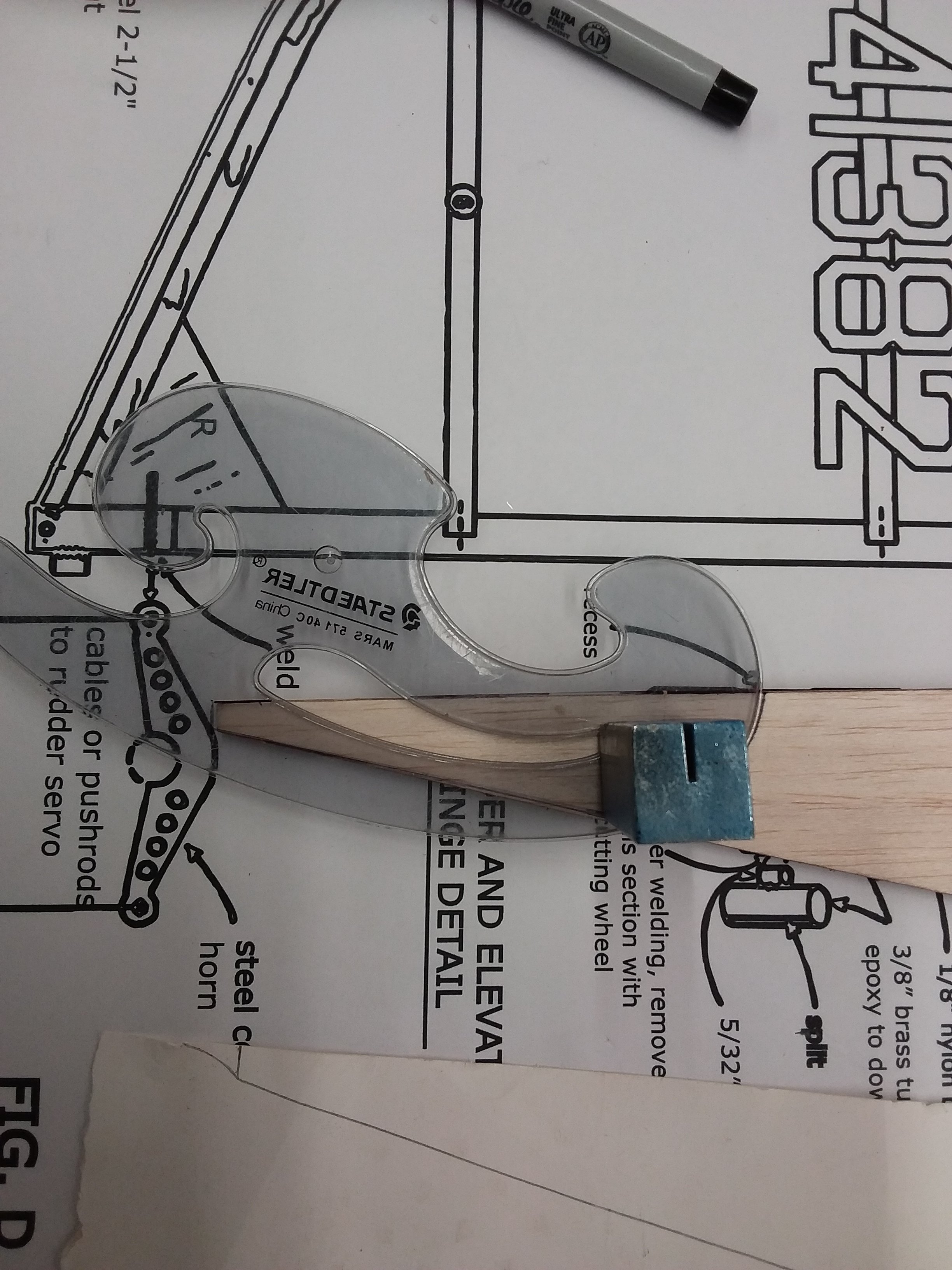

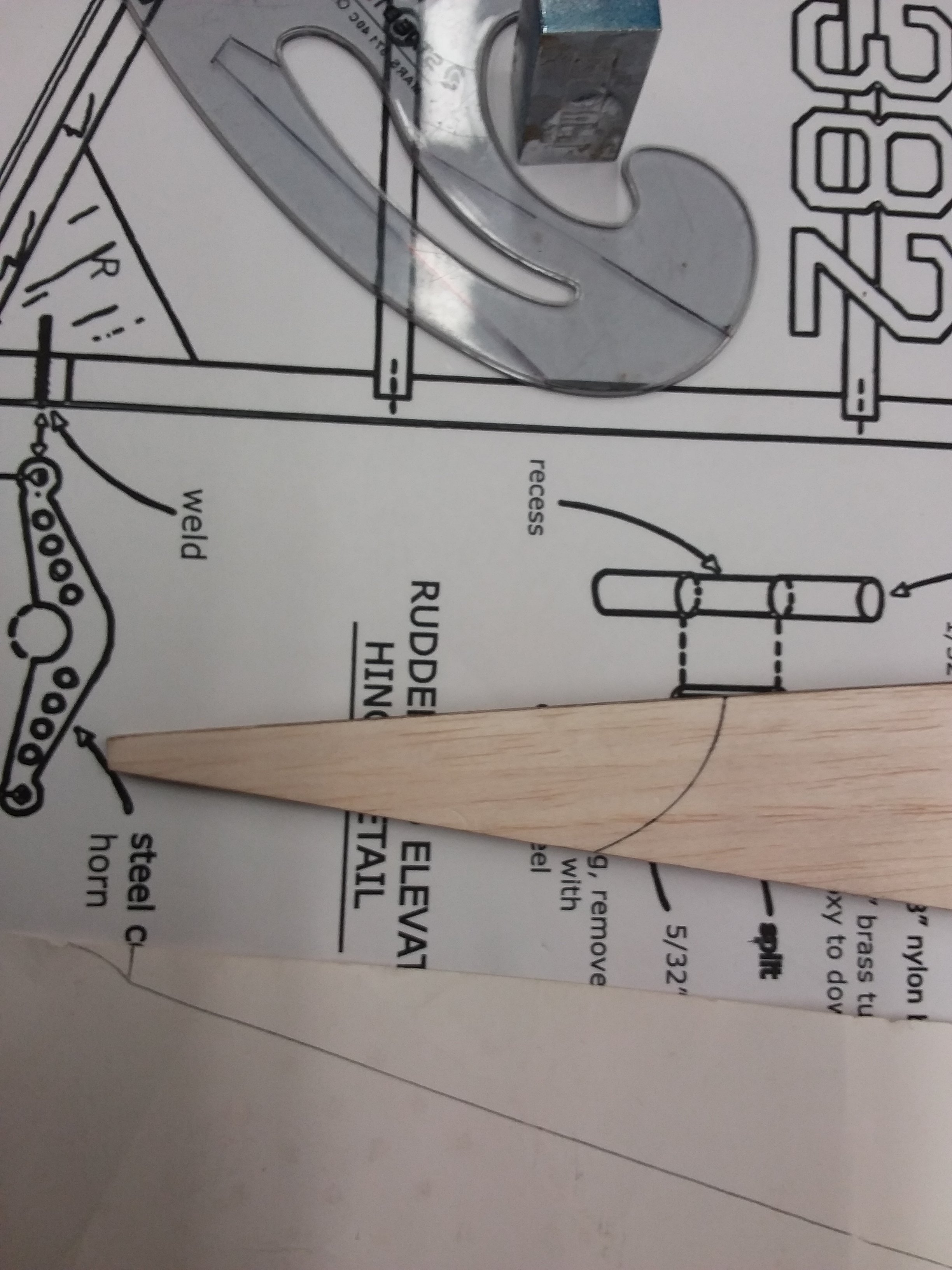

  4. dhal22

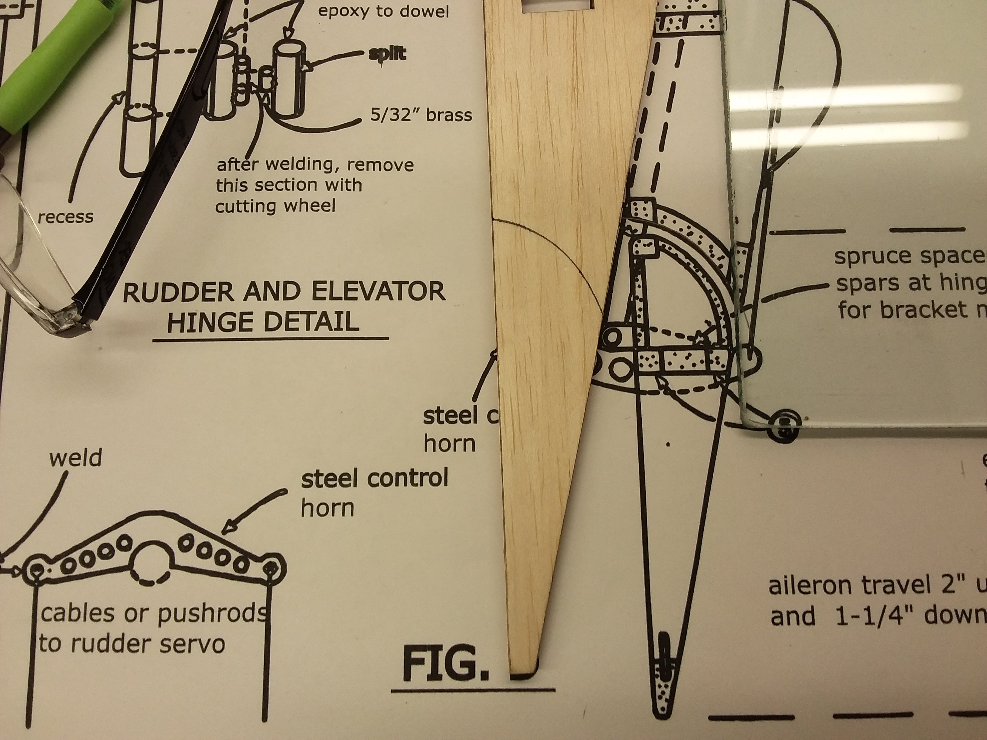

    transferring the curve.

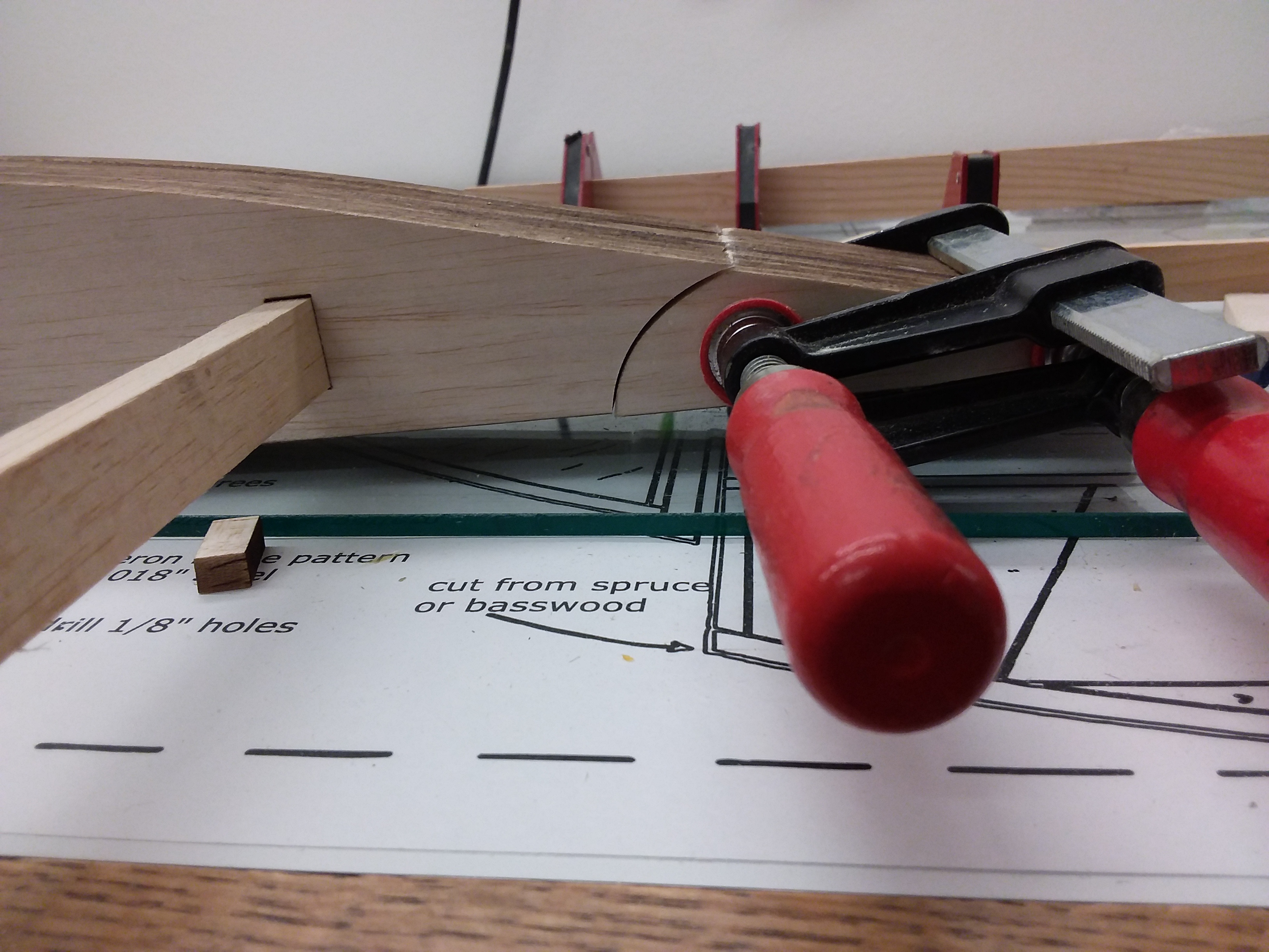

  5. dhal22

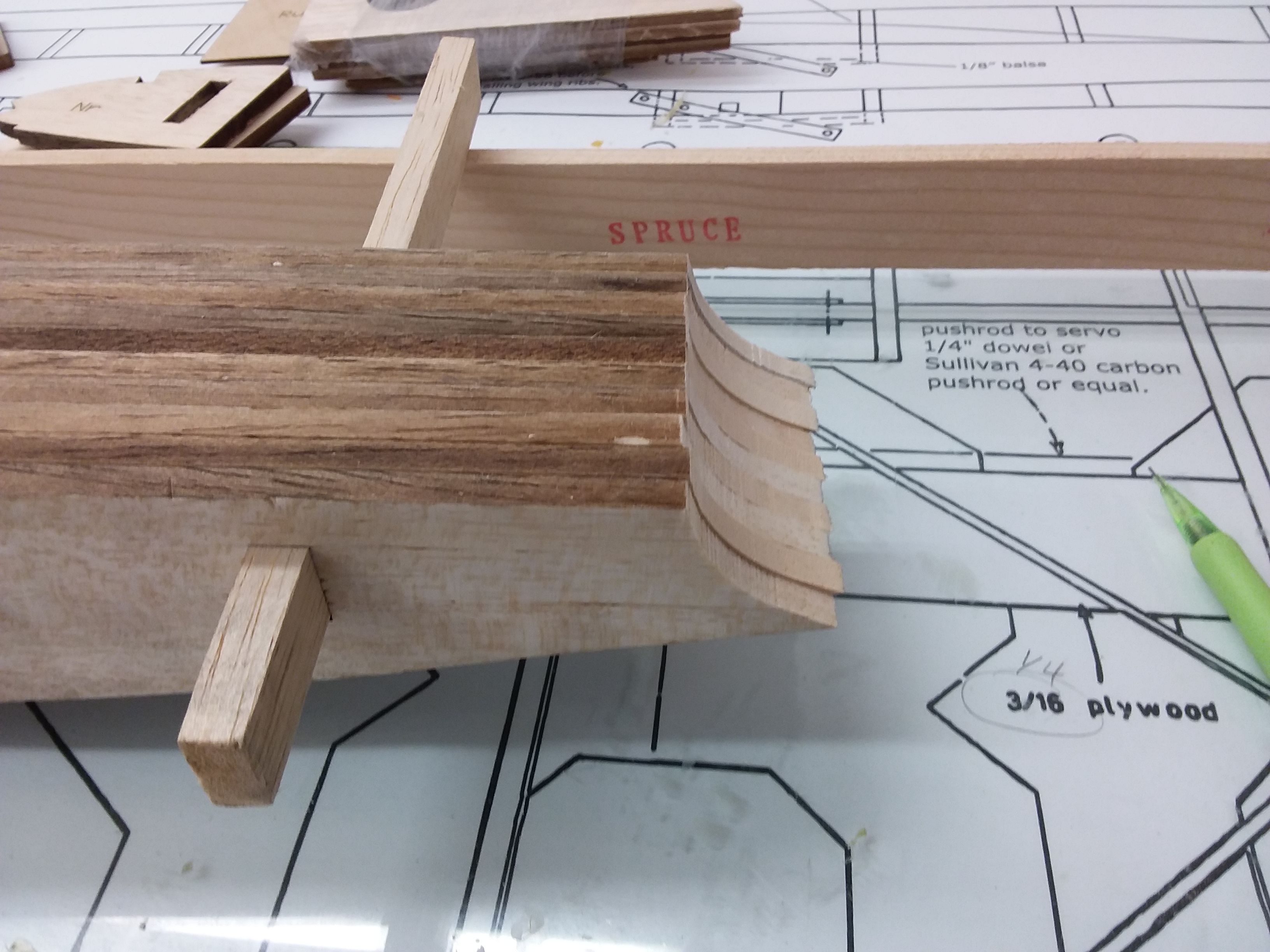

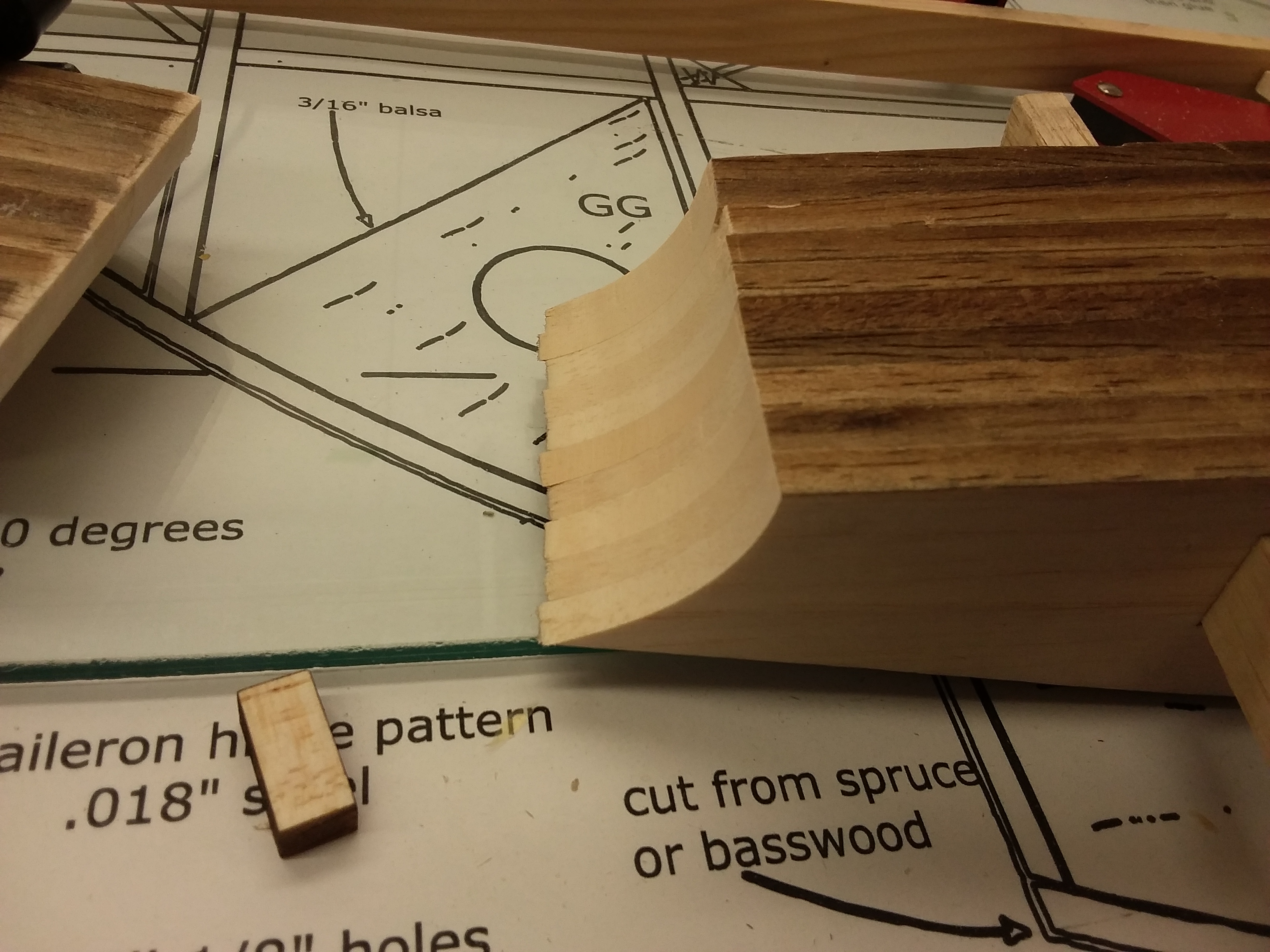

    time to sand the ribs. 20180210_131624.jpg 20180210_131632.jpg 20180210_131951.jpg

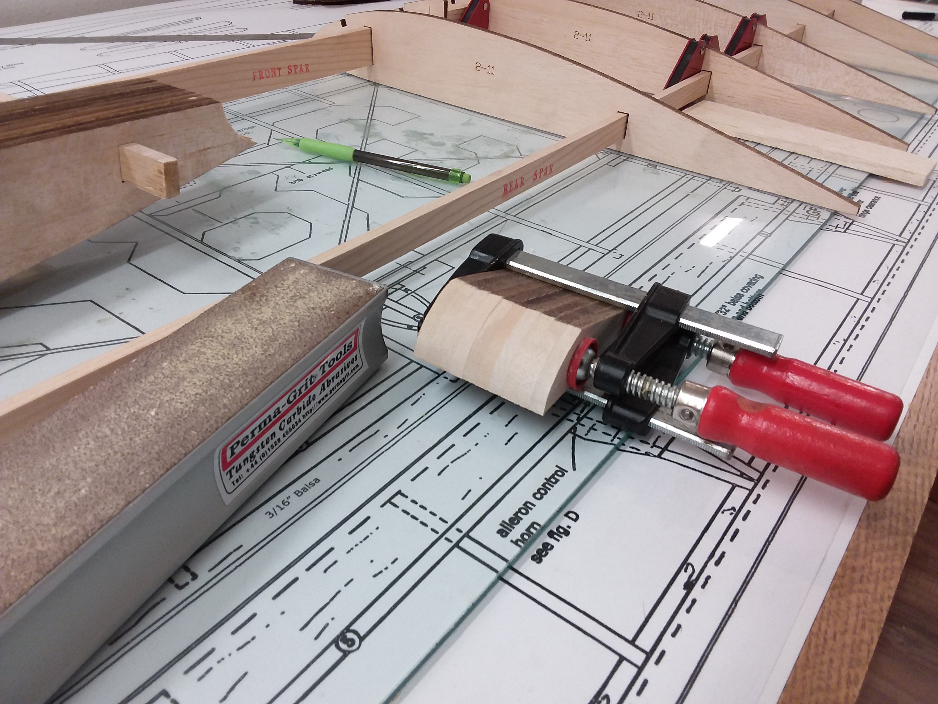

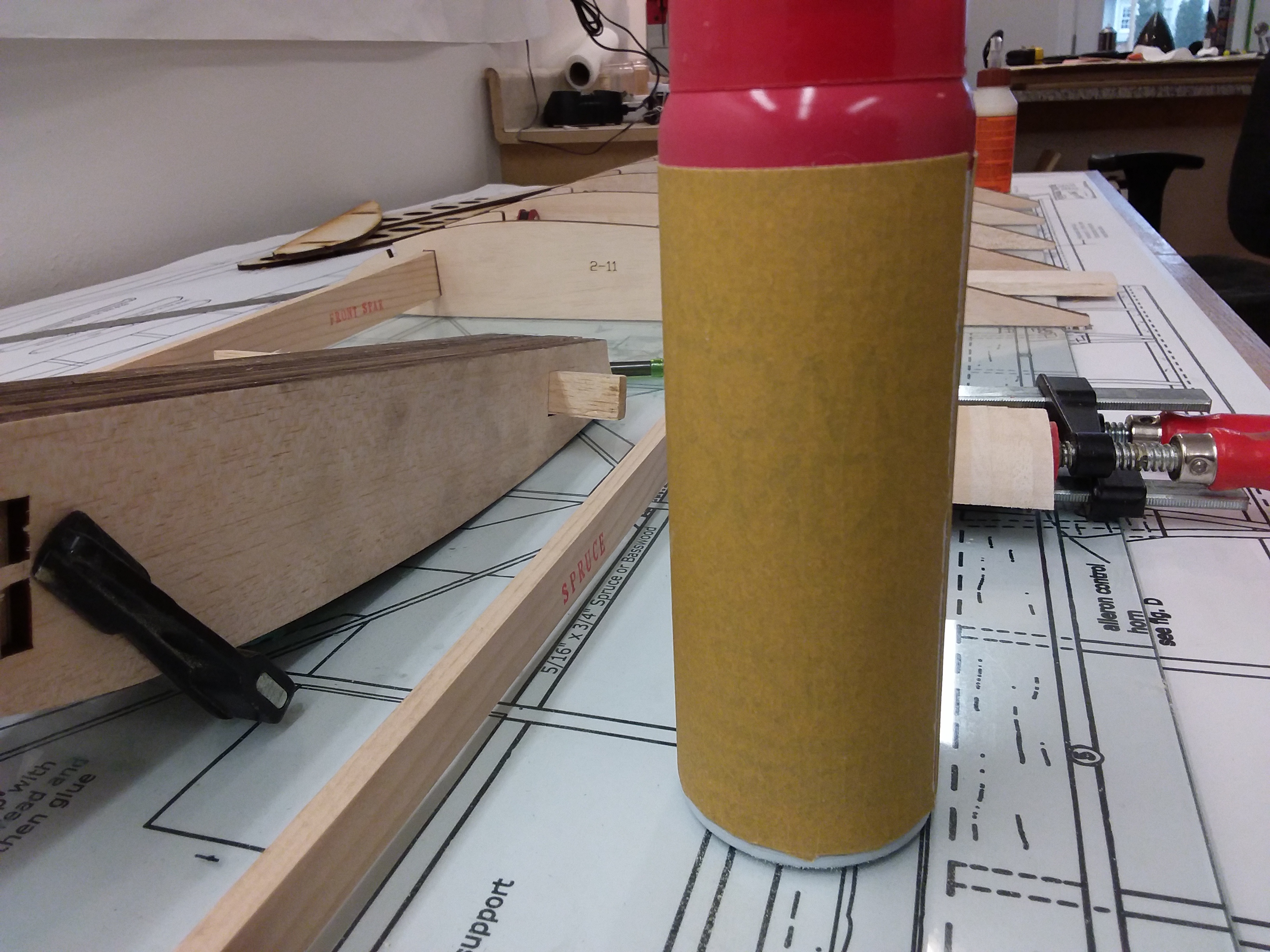

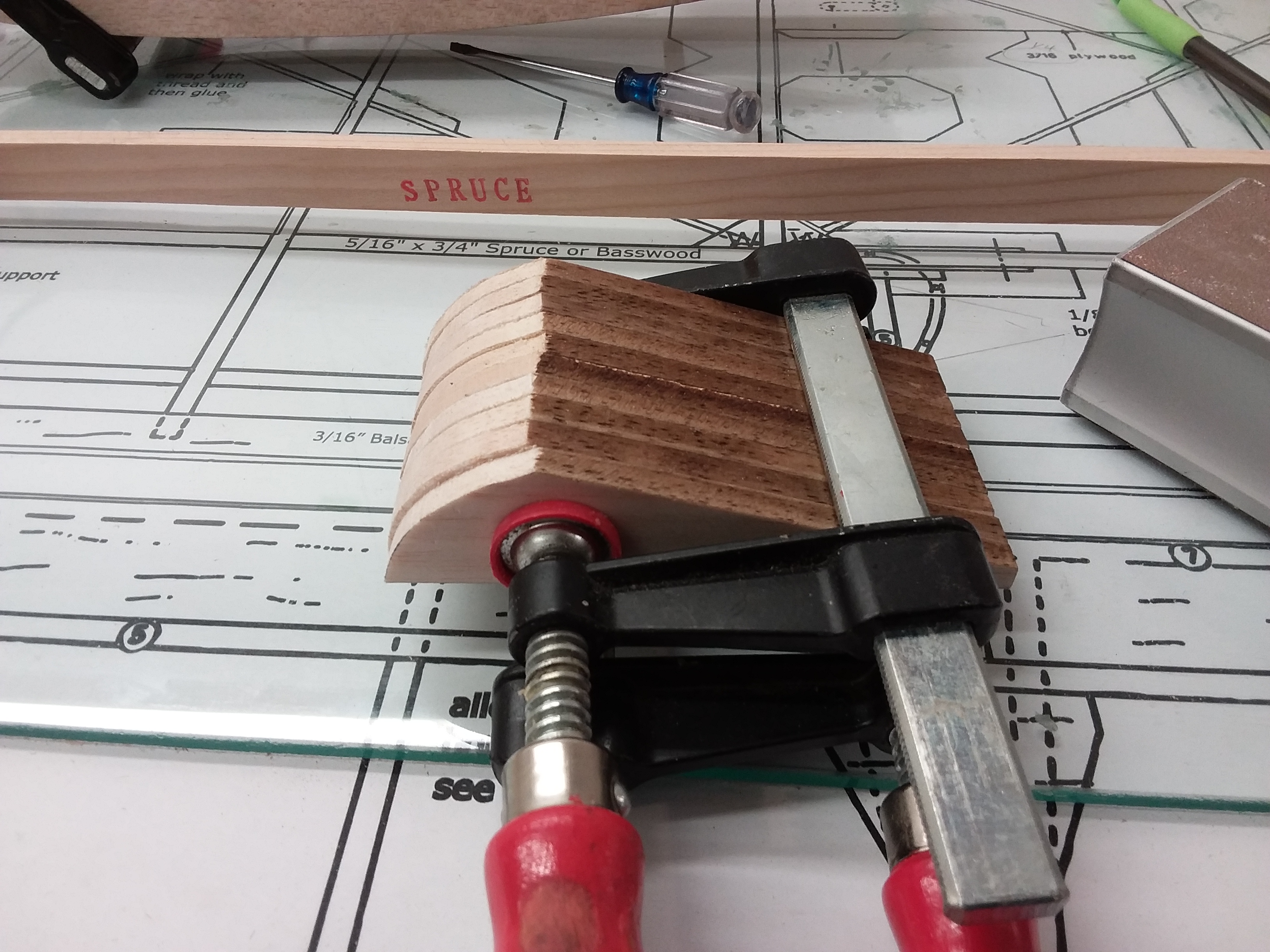

  7. dhal22
    Found a random aerosol can (grill cleaner?) that fit the curve. Some 3M contact spray and sandpaper and presto, a round sander. 20180210_132711.jpg 20180210_133056.jpg
    49dimes, stangflyer and pawnshopmike like this.
  8. dhal22
