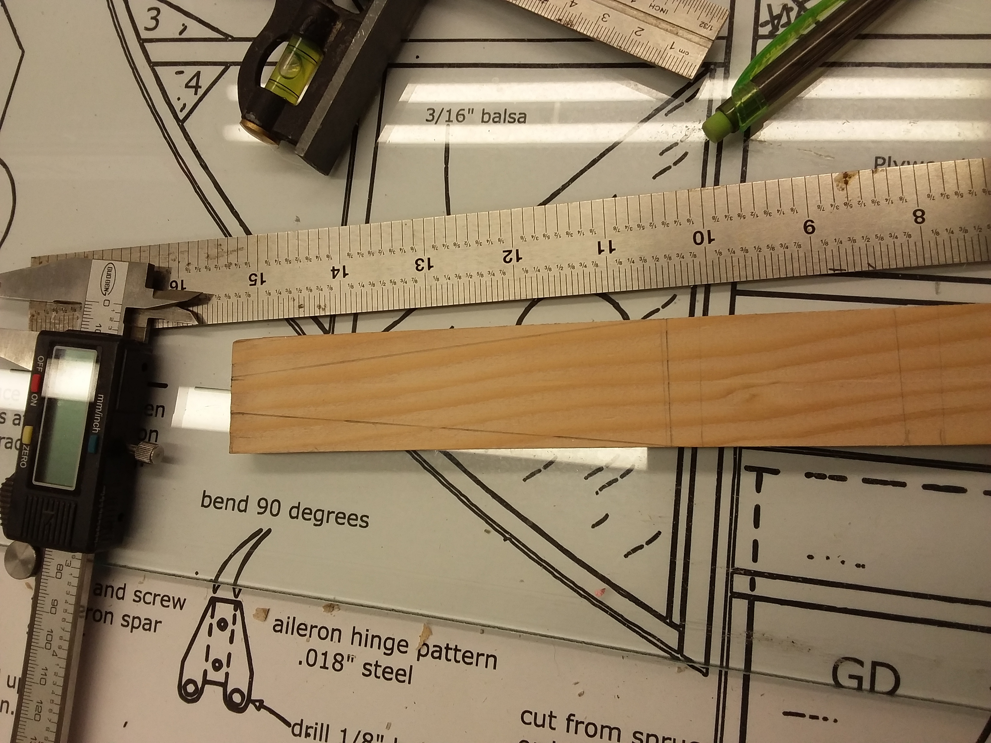

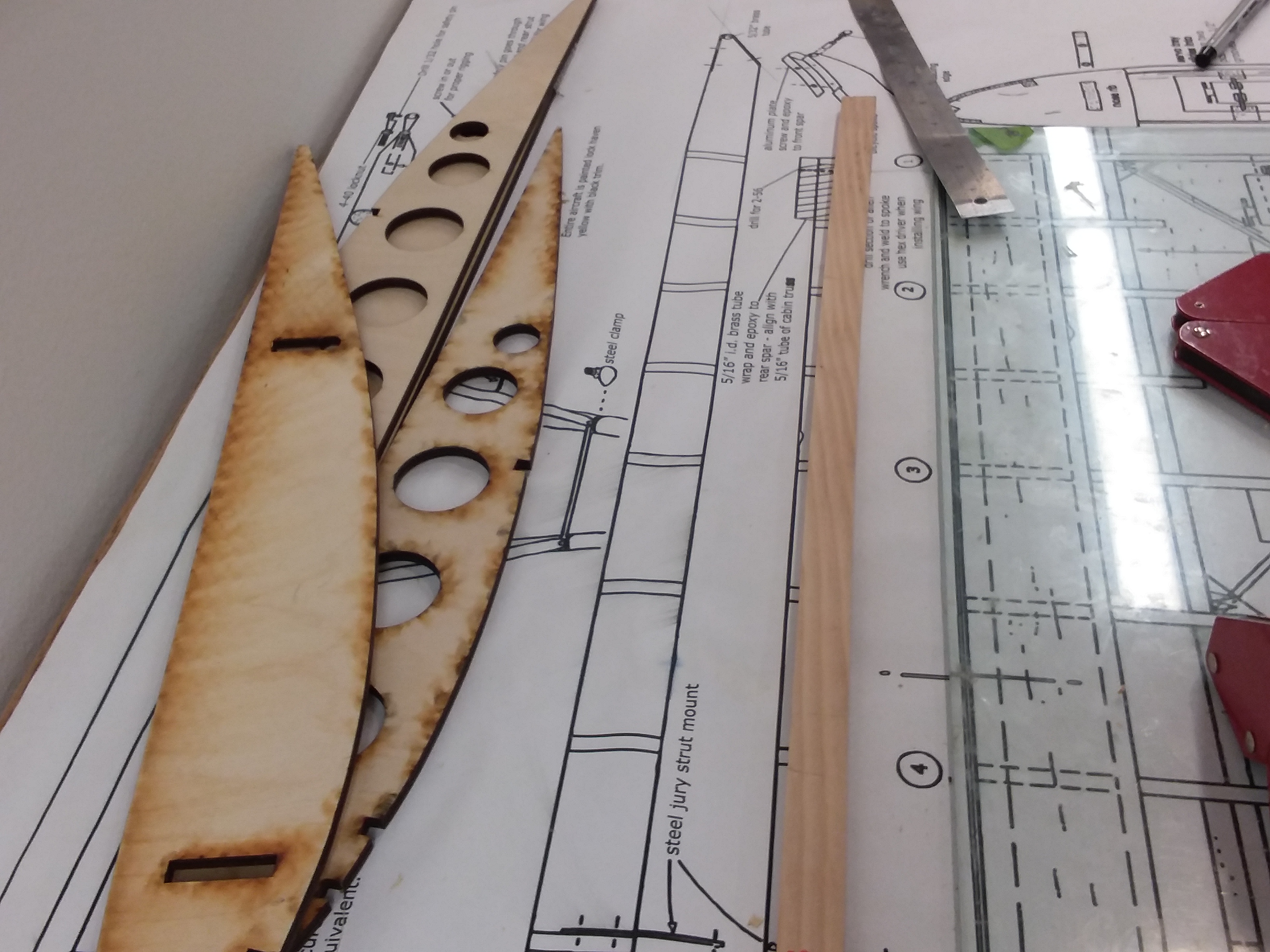

    Rib markings on main and rear spar. Cutting the angles at the spar ends as well.

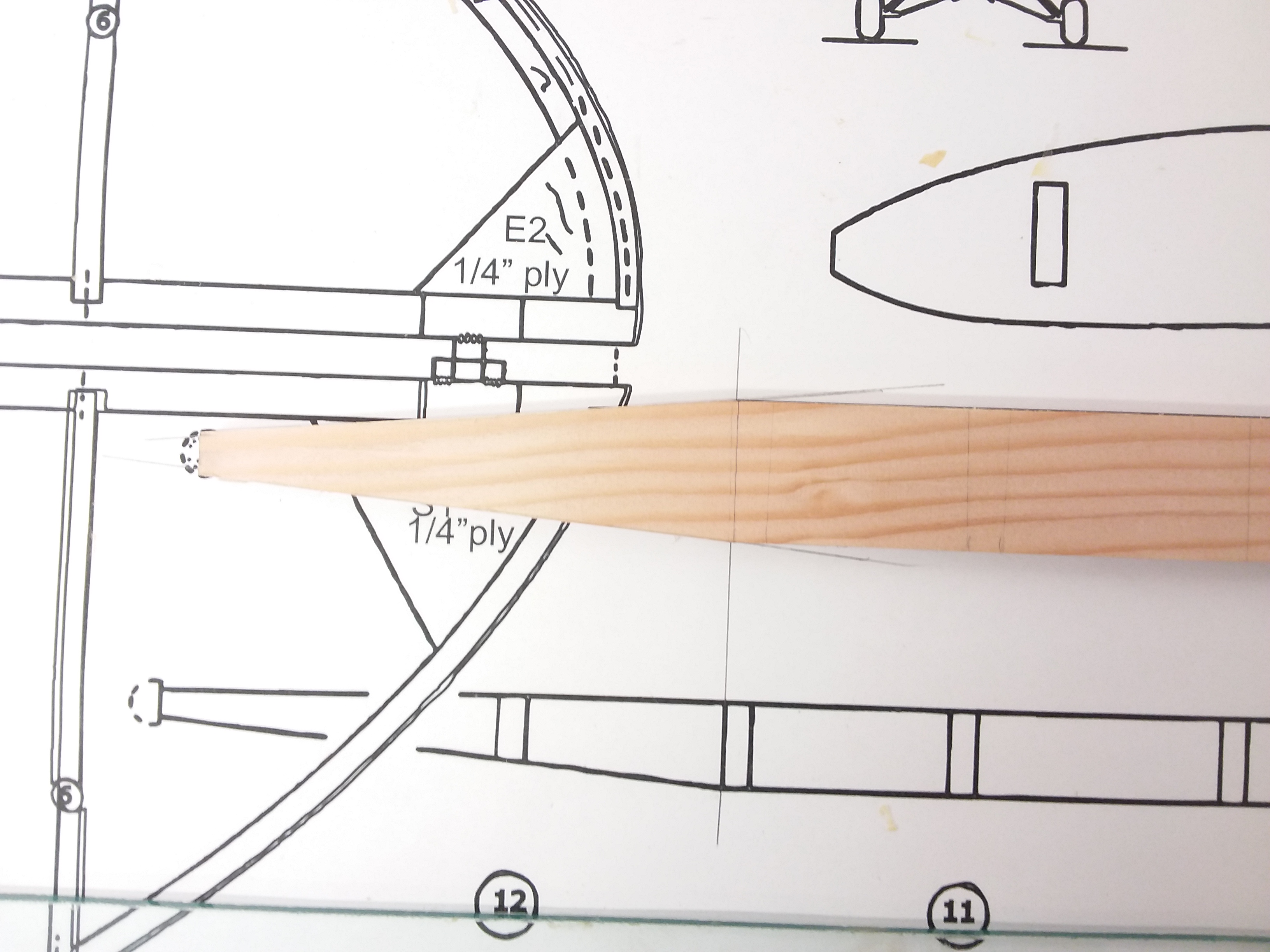

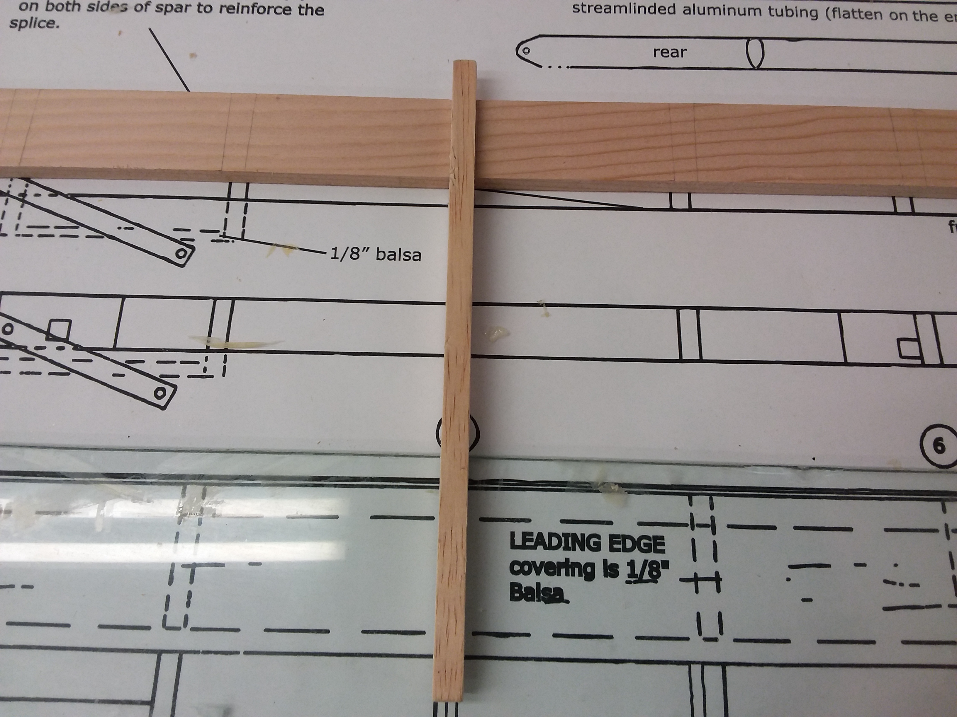

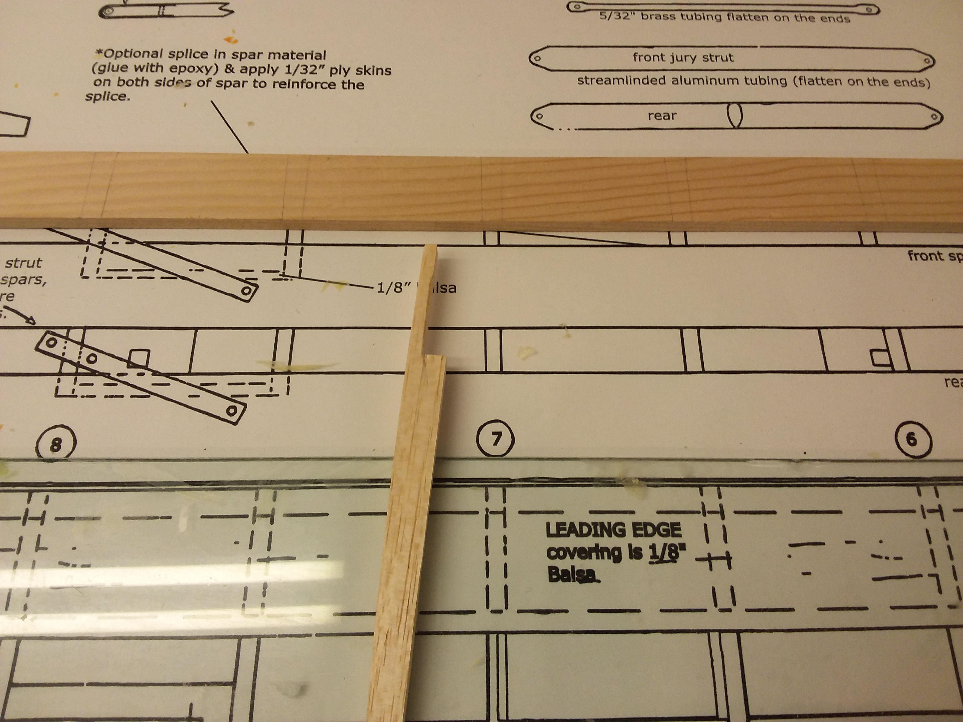

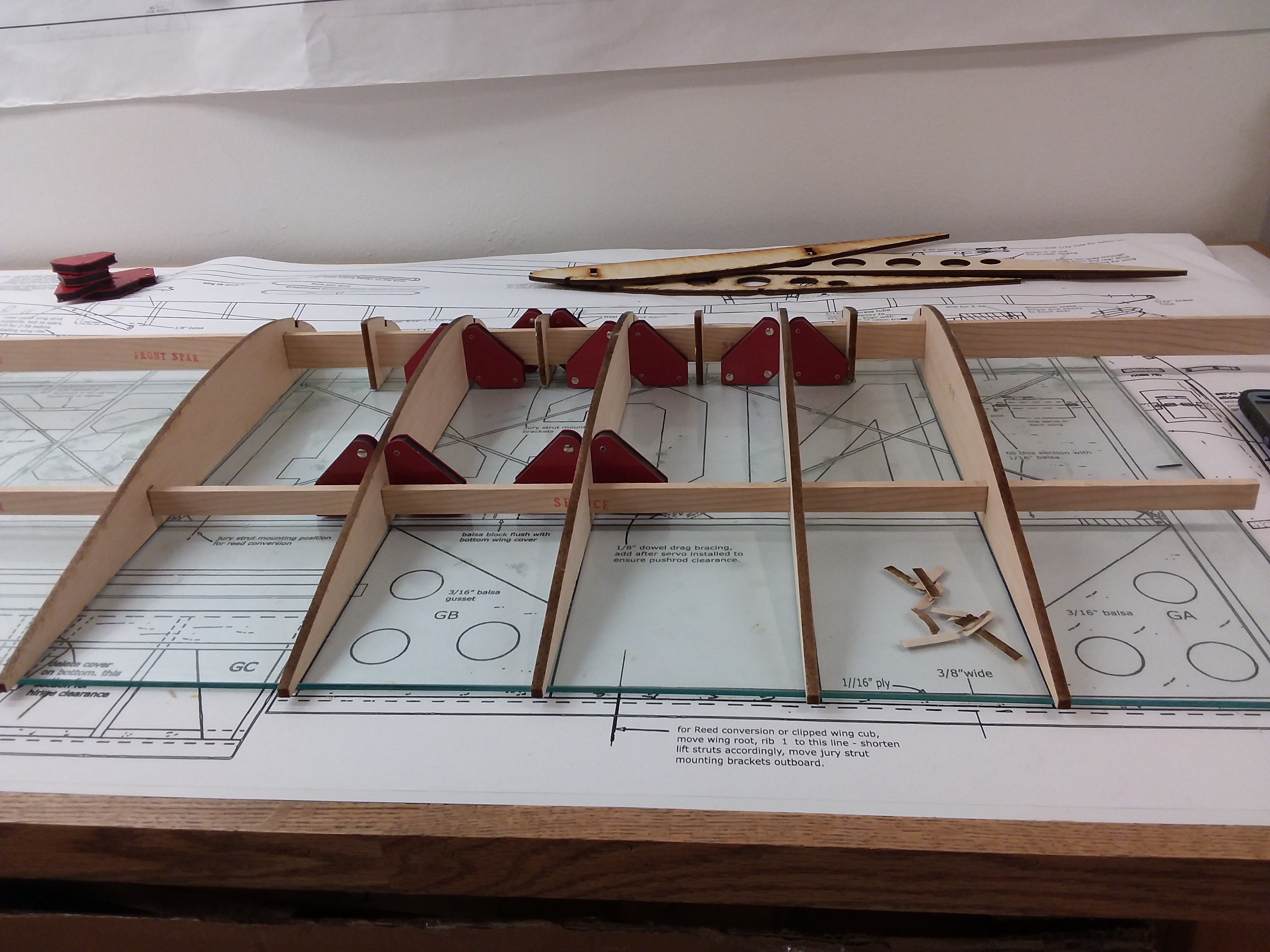

    One rear spar is warped but building on glass means that will go away. More tomorrow. 20180210_164913.jpg

  6. Looks almost exactly the way a full scale Cub wing is built (I literally just watched my dad build one this fall).
    This is going to be really interesting to watch.

    I do like this idea of building on glass.
