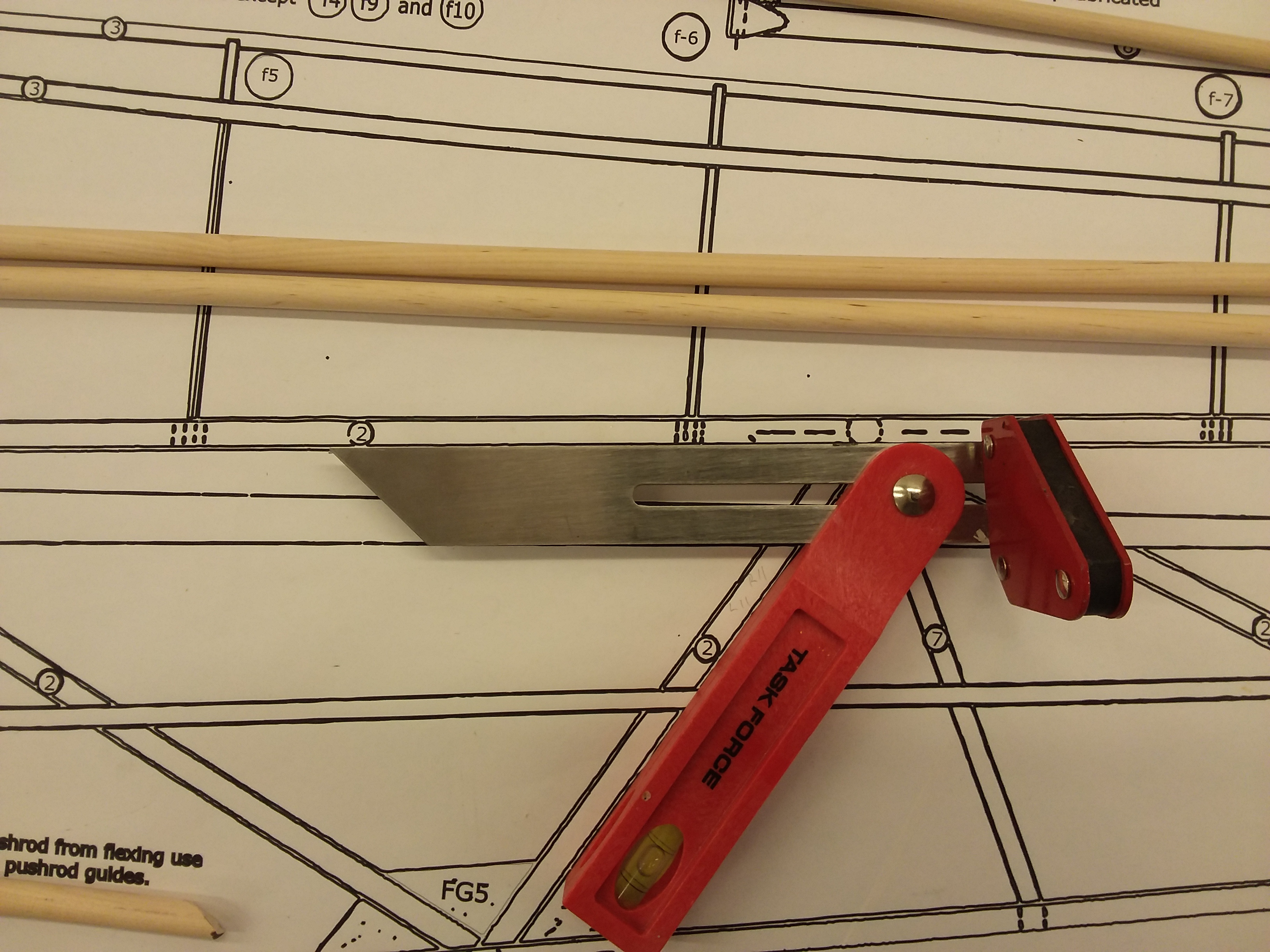

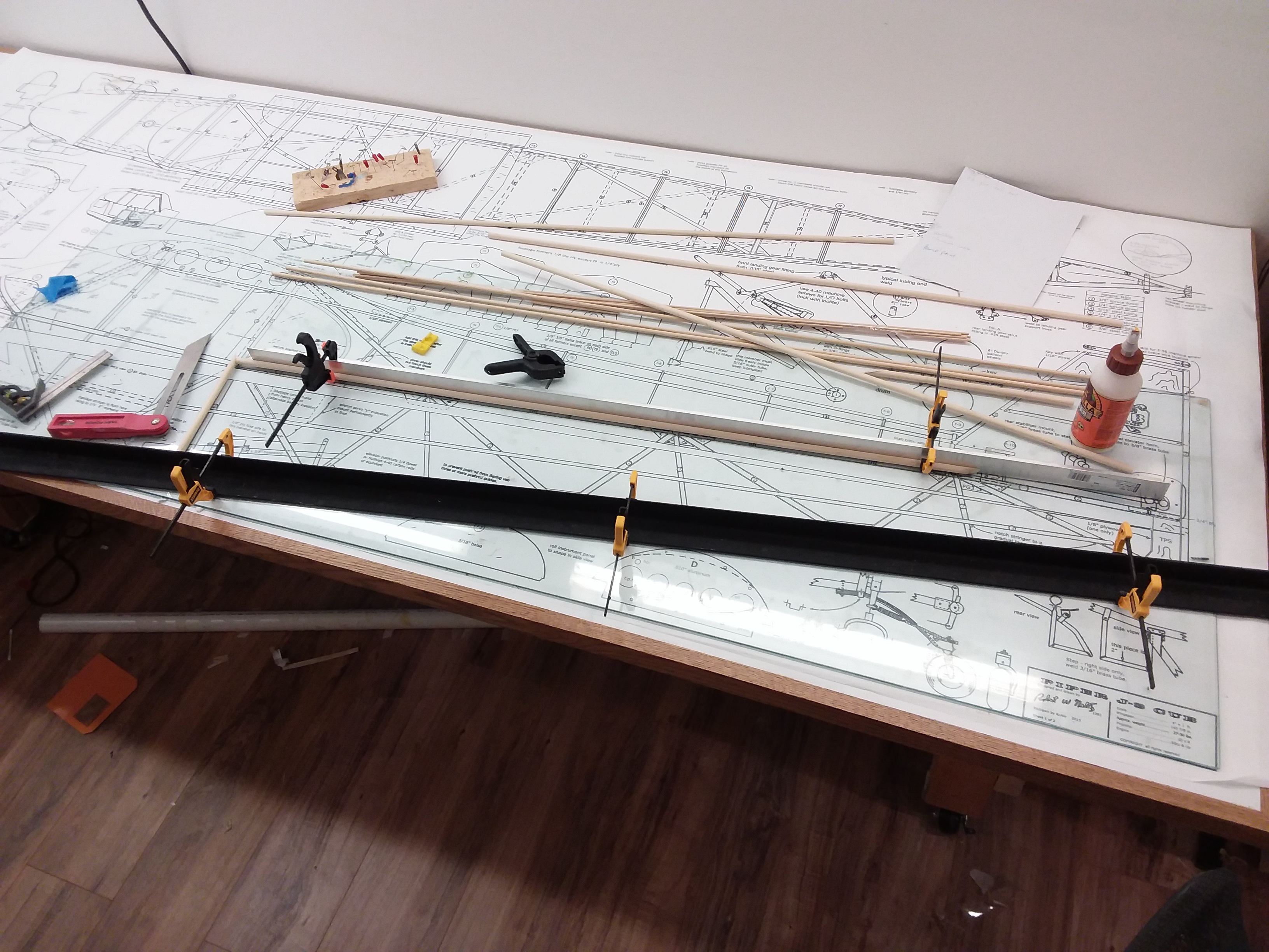

    Started the fuse this weekend. Waiting on a new glass top but figured out cutting and sizing dowels is probably easier directly on the plans.

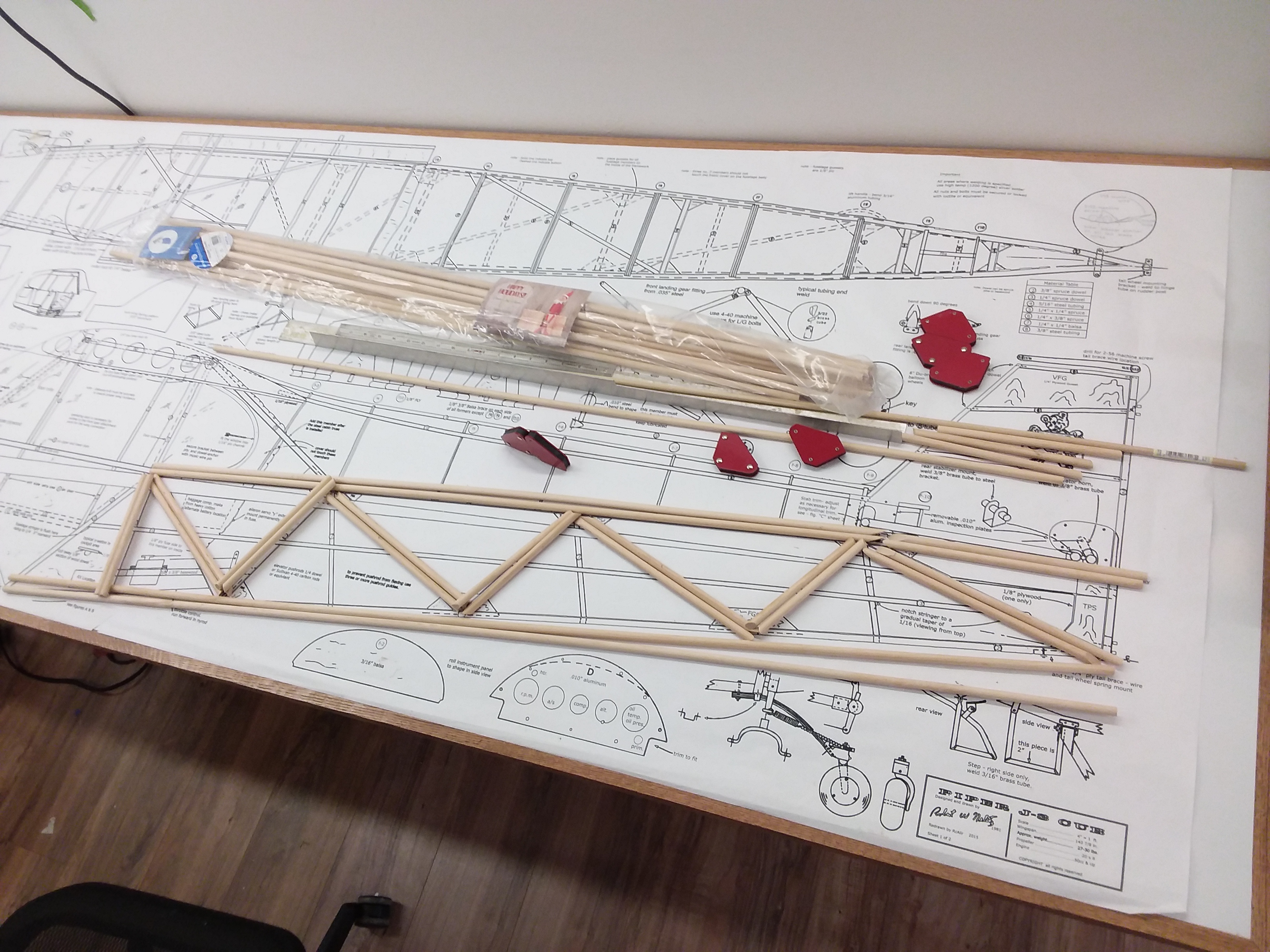

    More.

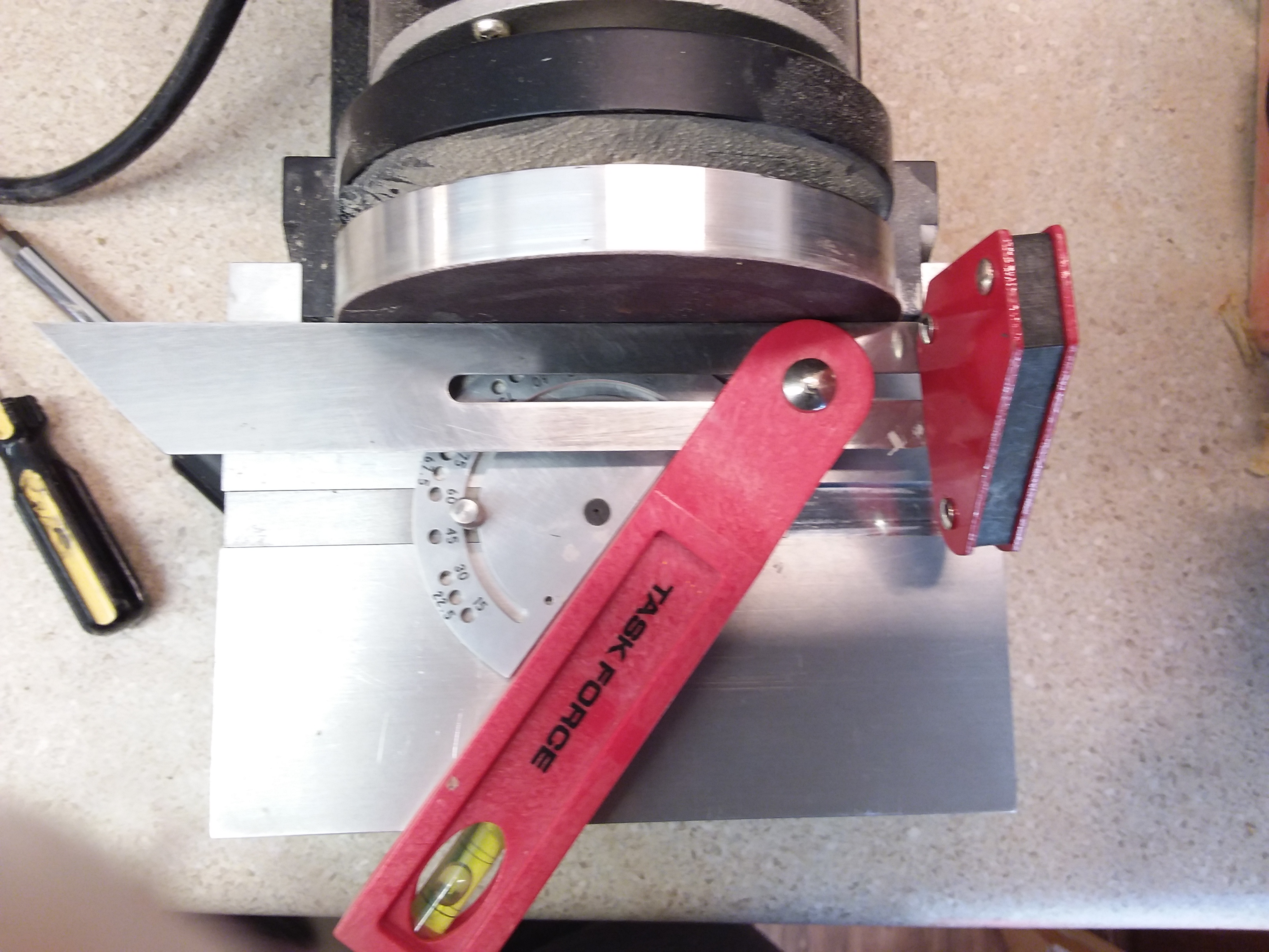

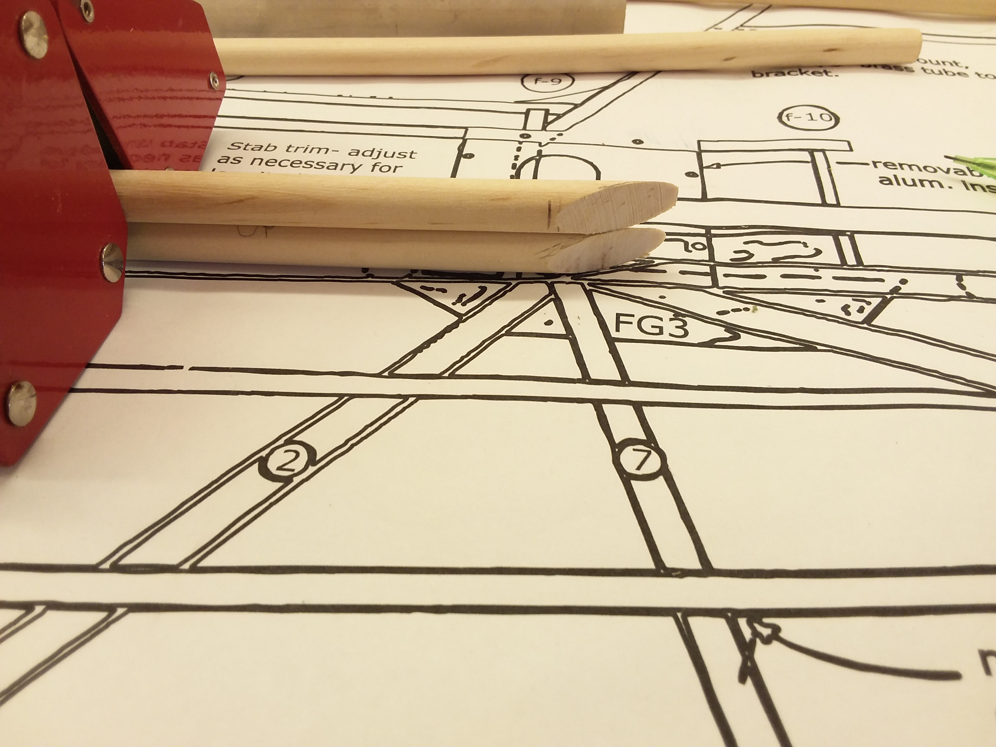

    What type of dowels are you using? Do you cope the joints or just sand to the correct angle?
  9. dhal22
    dhal22 GSN Sponsor Tier 1
    Spruce dowels, yes on coping. Kinda, trying to sand the cope with drill press and little sanding drum. I will not just butt joint the connections.

  10. Snoopy1
    Snoopy1 640cc Uber Pimp
    4,870
    7,002
    Canada
    Man you are going all out coping all the connection is a lot of work but it will make the connection solid. That is tedious work . But will look good when all done and then we cover it and nobody can see all the work you did.
