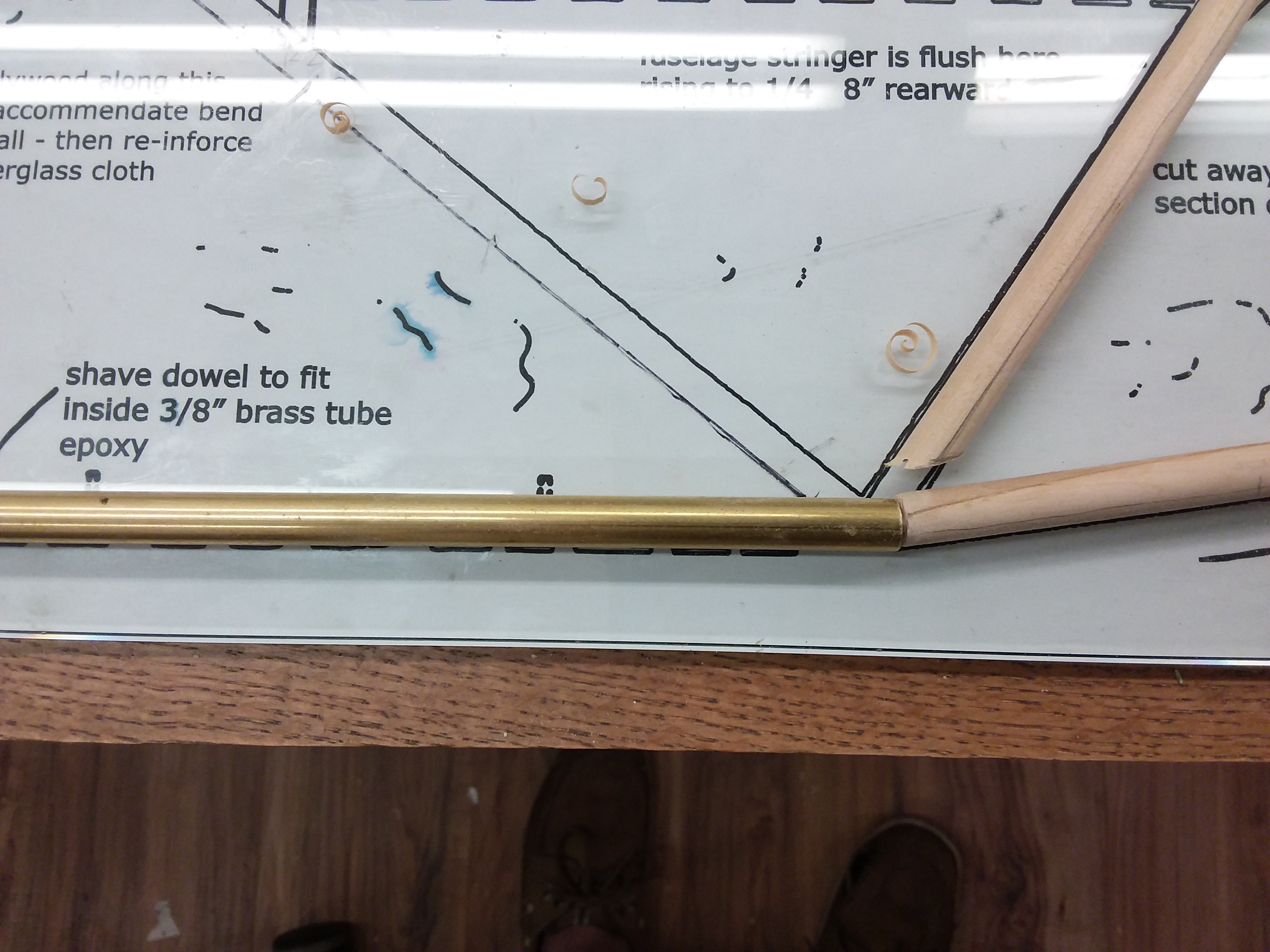

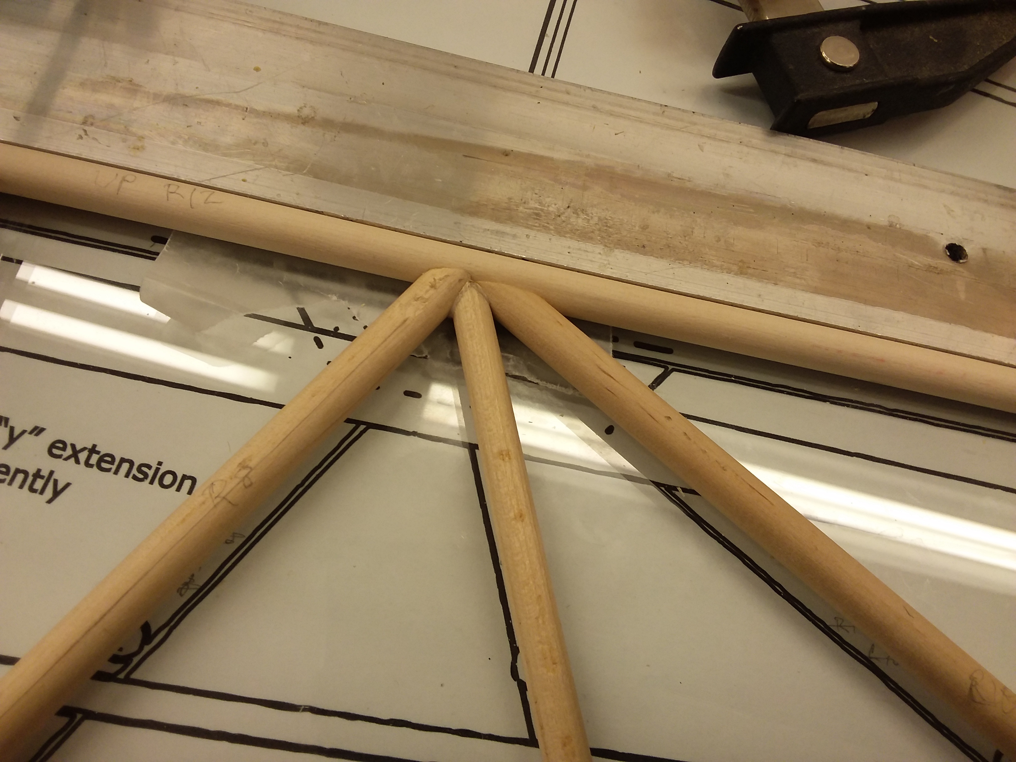

    Still coping away. Not worried about perfect joints but definitely glad I'm not butt joining.
  2. dhal22
    dhal22 GSN Sponsor Tier 1

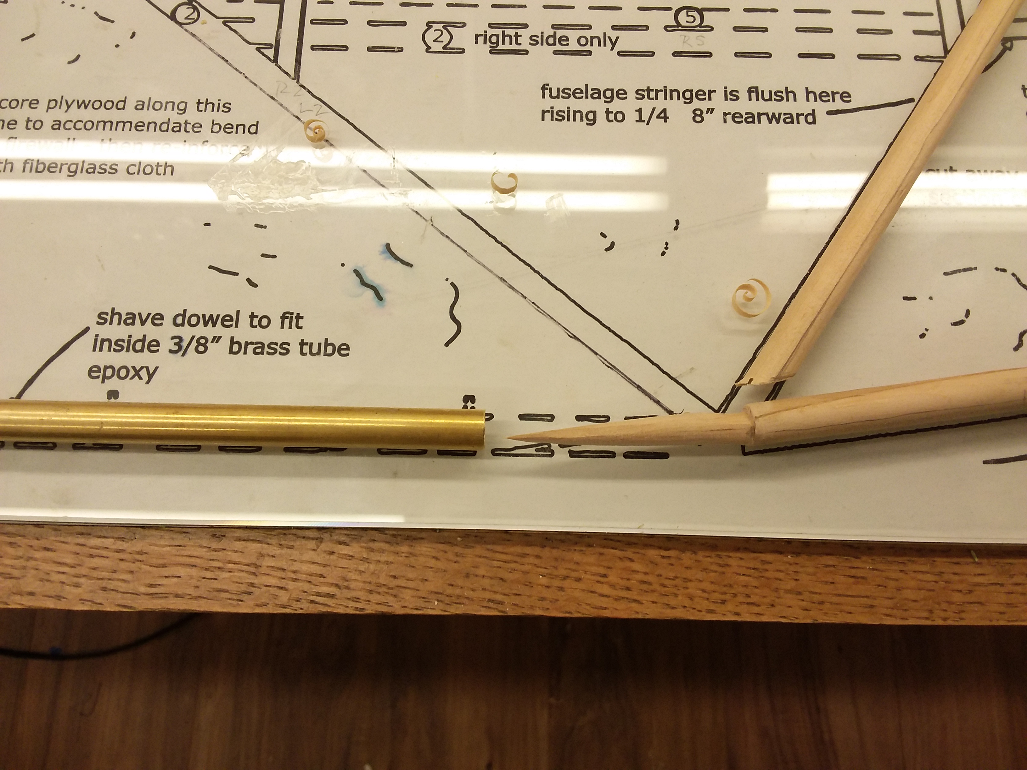

    Says here to transition to 3/8" brass tube, probably will use steel tubing.

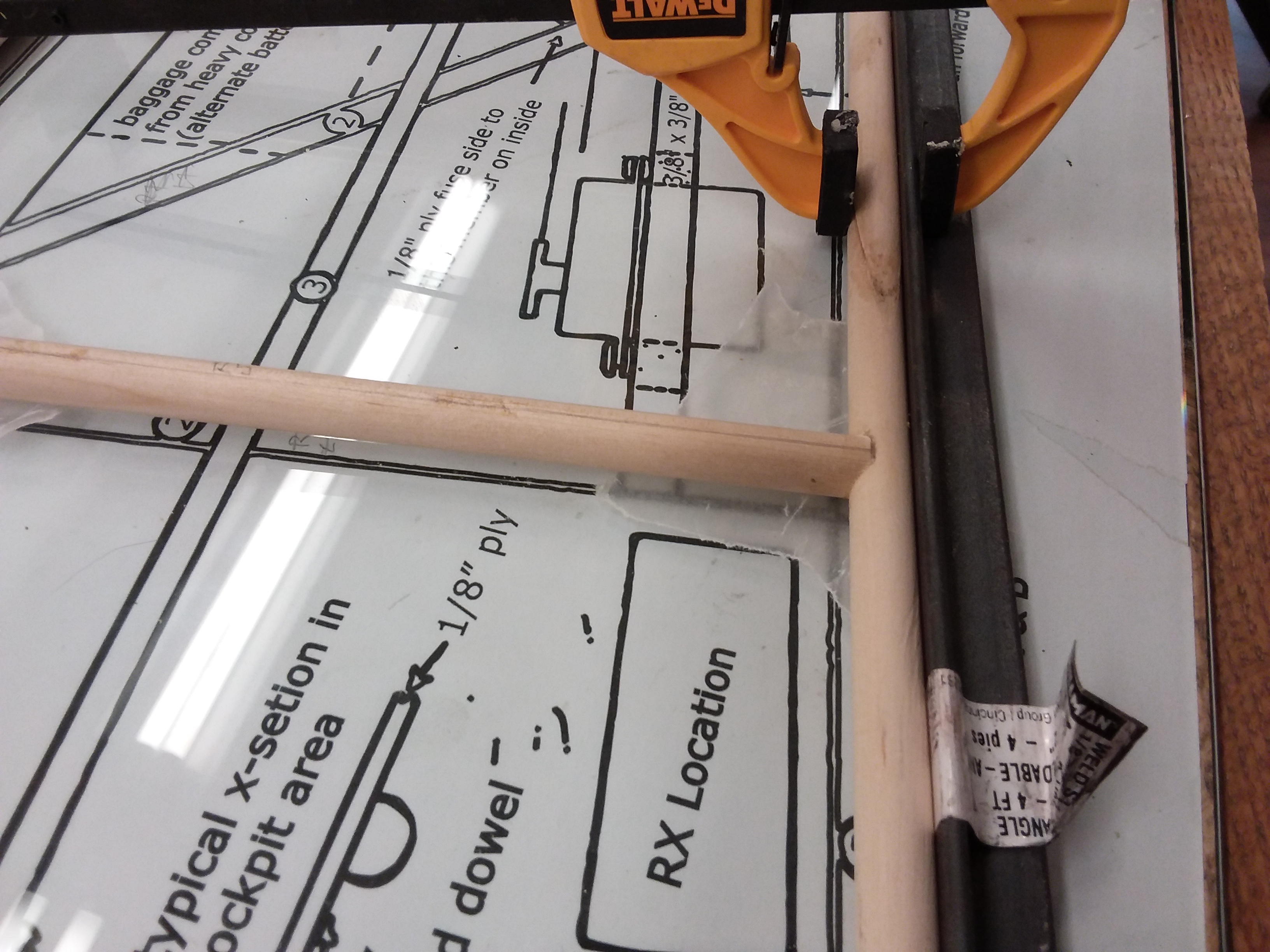

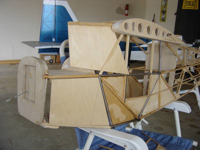

  7. dhal22
    Considering steel tubing in the cabin area vs. Spruce dowels for added strength. Similar to this build. It's a cub not an edge 540 but still worth considering. Thoughts? Thanks.
    49dimes and pawnshopmike like this.
  8. Snoopy1
    Snoopy1 640cc Uber Pimp
    5,230
    7,414
    Canada
    Looking at the pictures I agree with the steel you have made luges on the steel tubing so that you can connect the struts nice work.

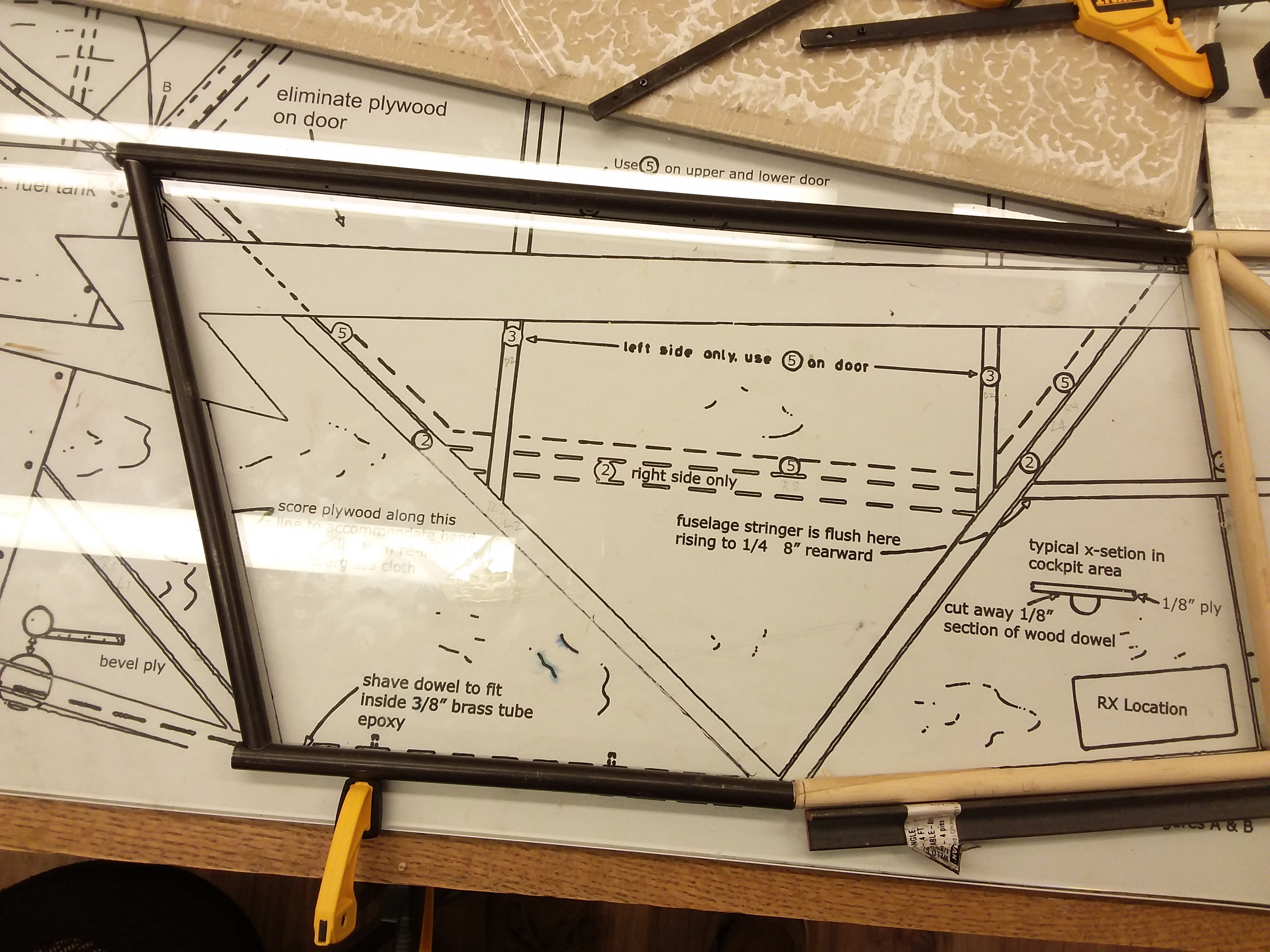

  9. dhal22
    Trying the idea of steel tubing in the cabin area. Might extend it to the firewall.

  10. Snoopy1
    5,230
    7,414
    Canada
    How are you making the connections between the steel tubing.
