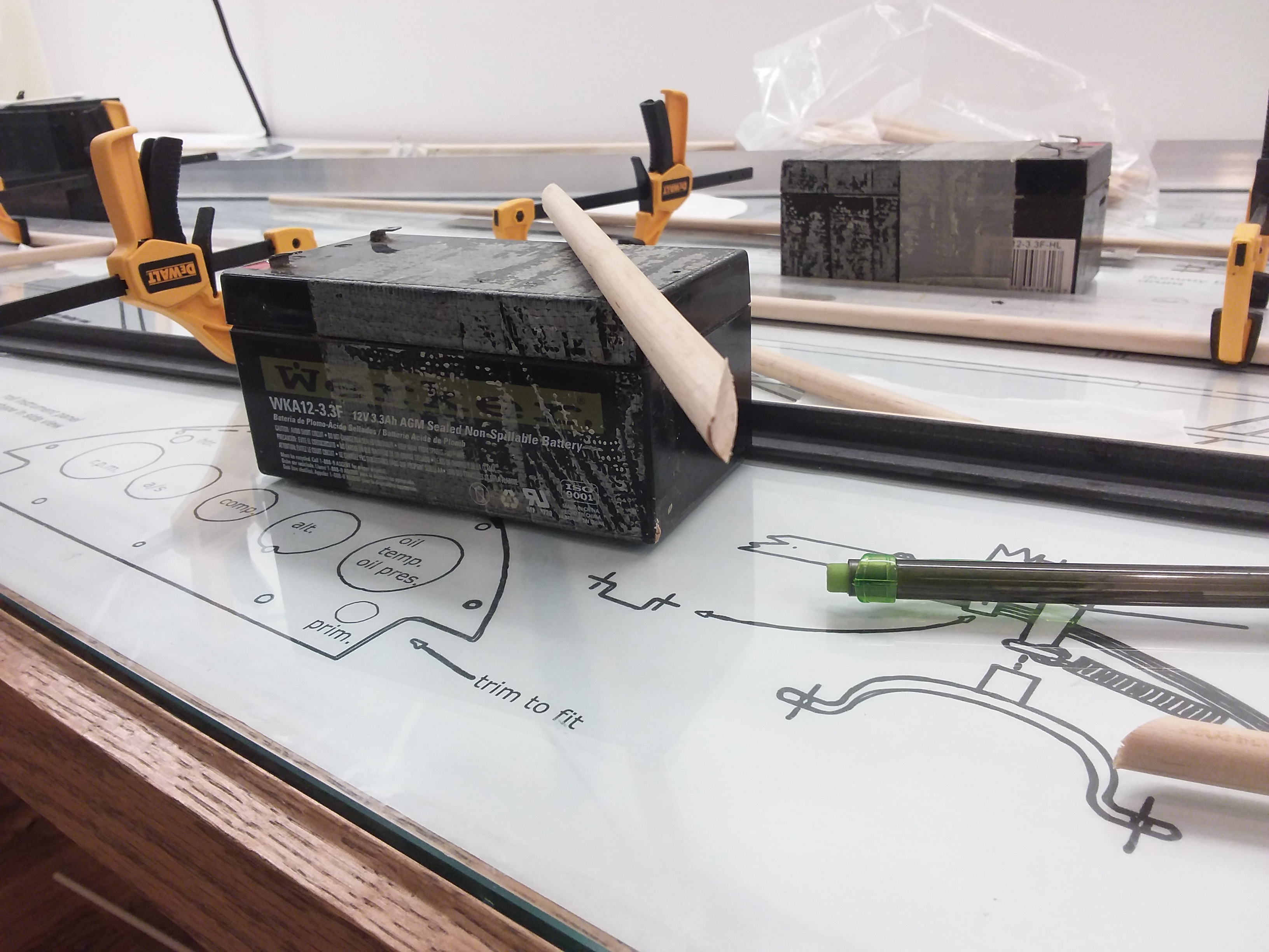

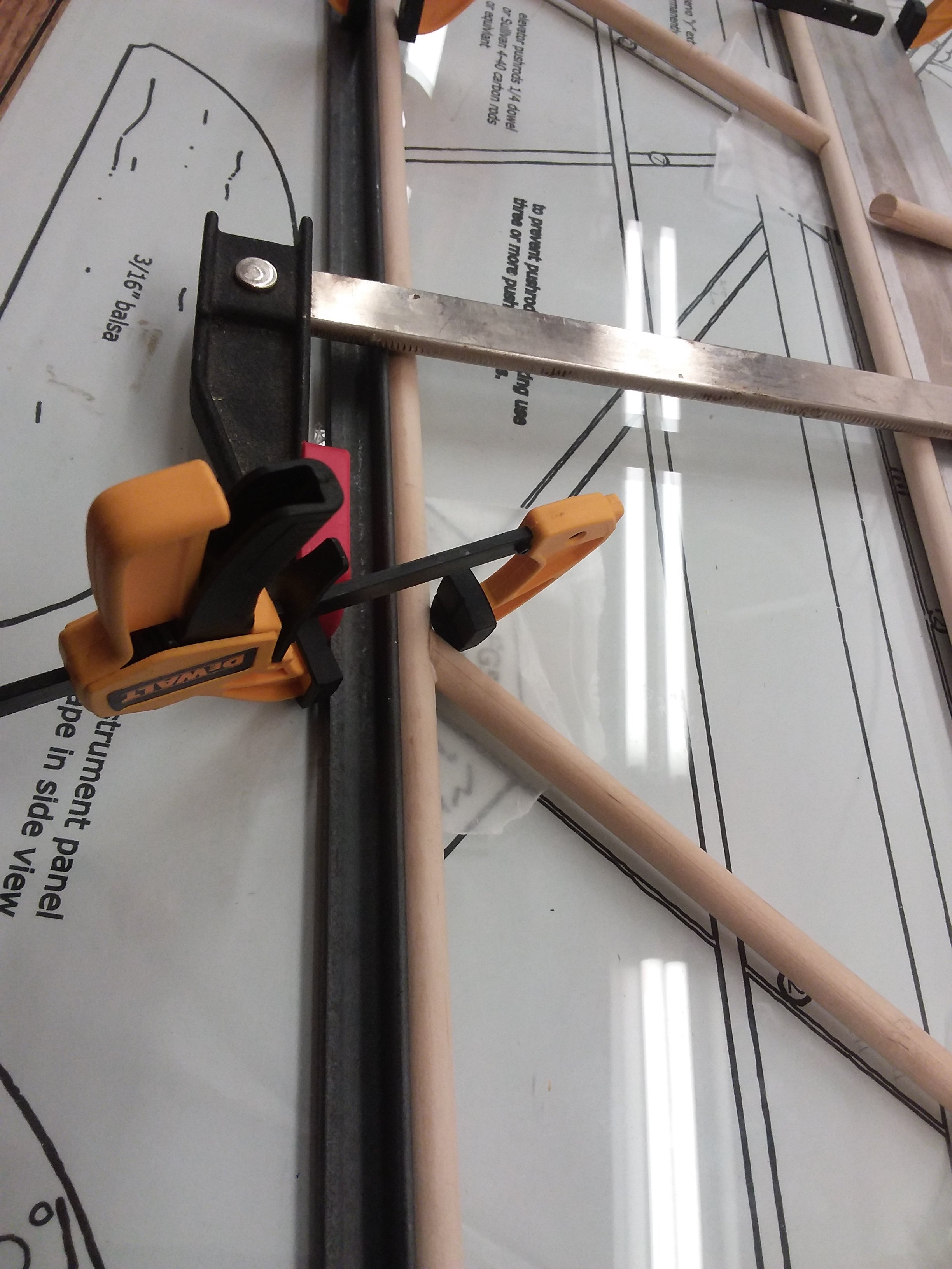

    Bought a bigger rasp, much easier to cope now.
  2. dhal22
    dhal22 GSN Sponsor Tier 1
    More coping.

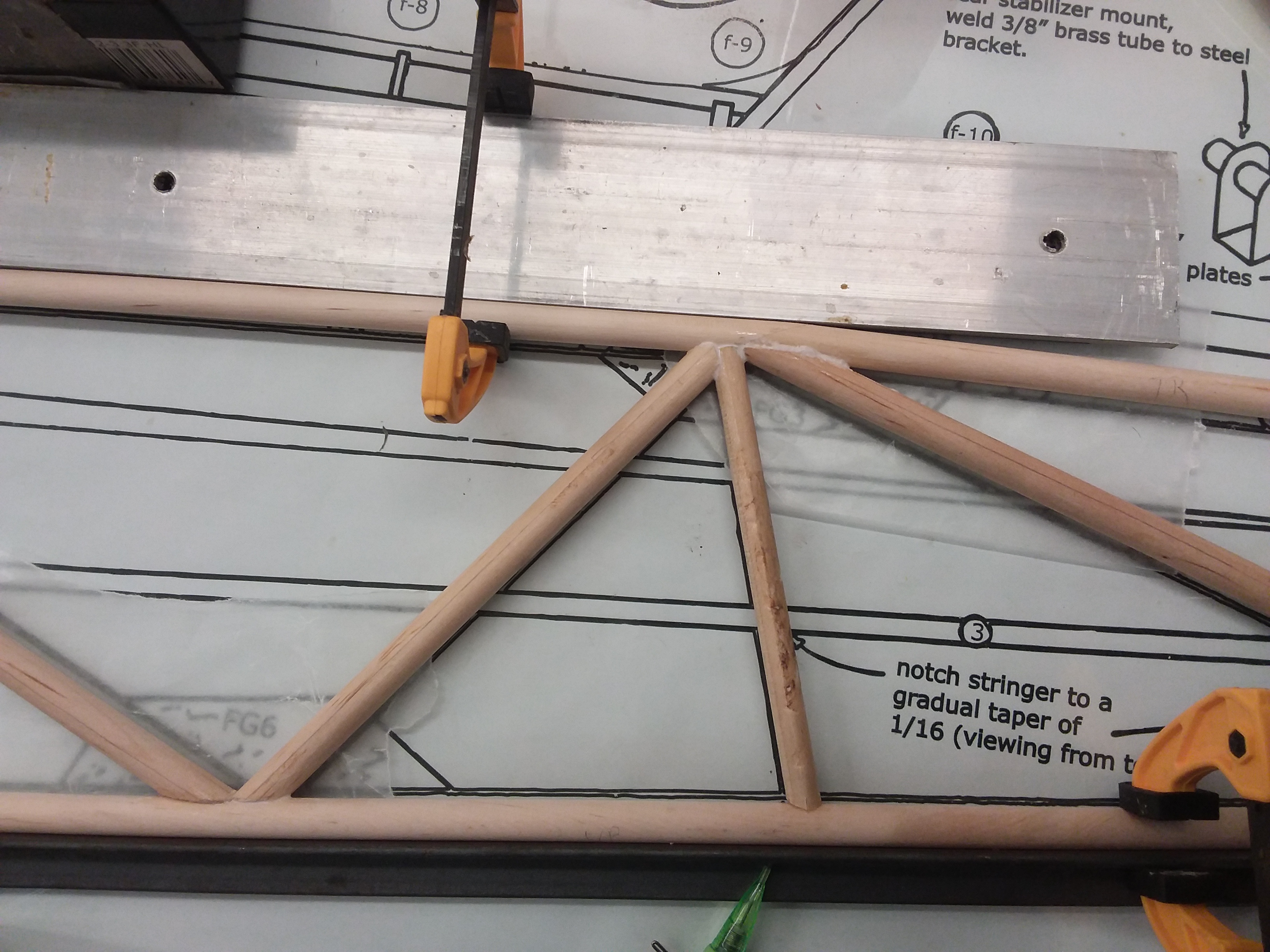

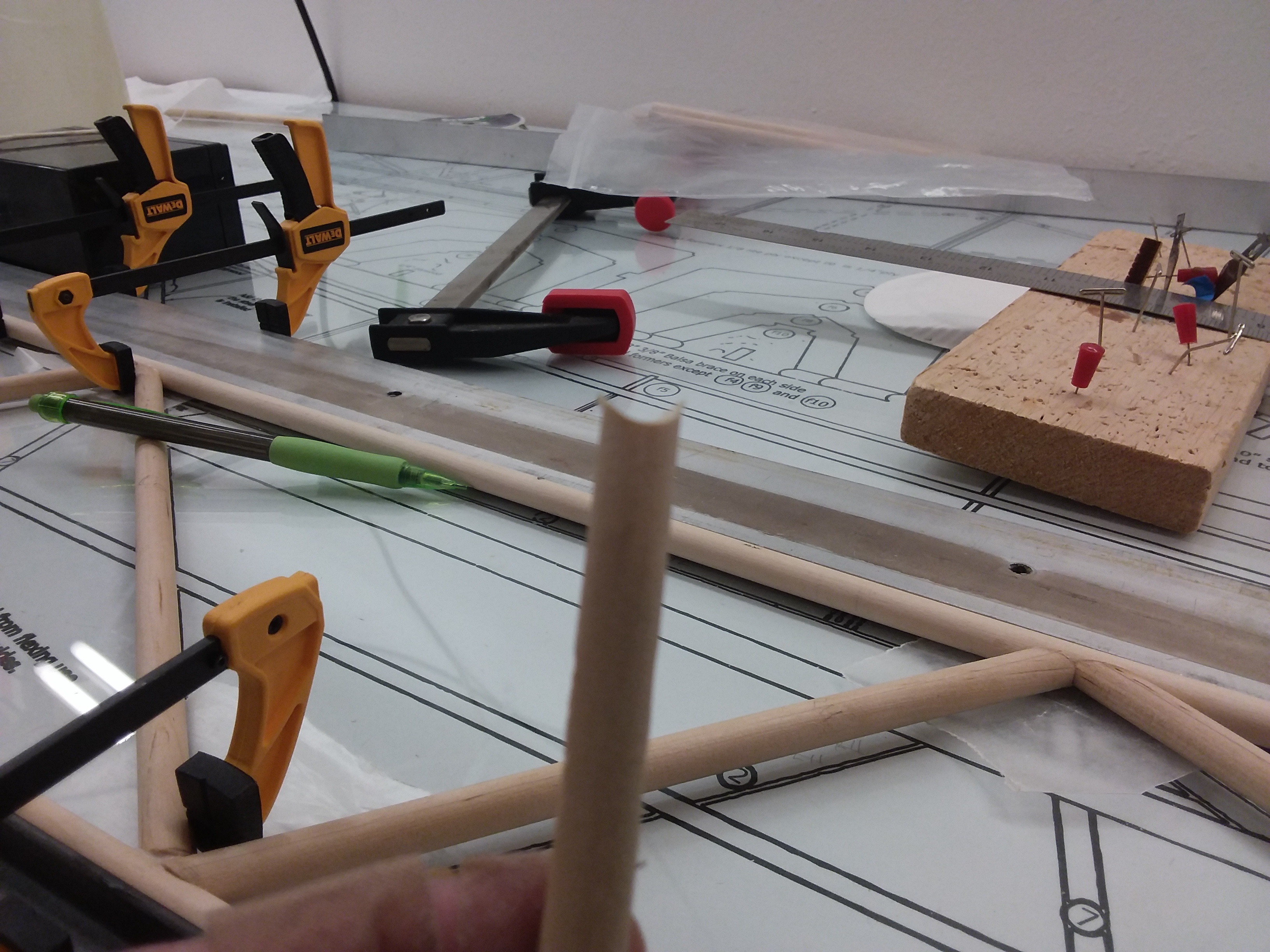

  3. dhal22
    Actually gluing today. Feels great!

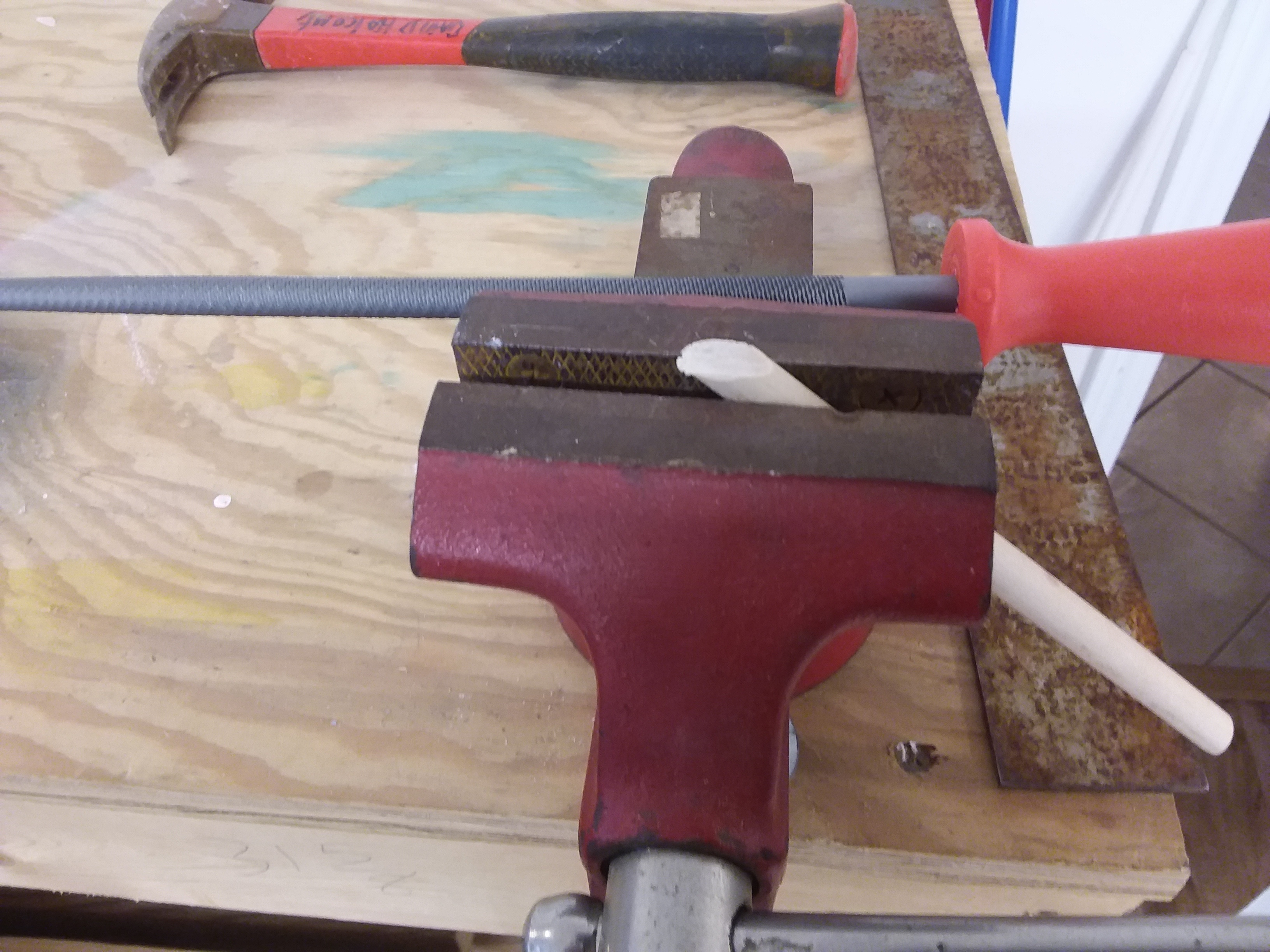

  8. Forgues-Research
    Forgues-Research 150cc
    1,161
    1,528
    for what its worth, I took a round file , broke it so it would not be tapered , put it in the drill press, put the dowel in a table vice and once I had the angle just went at it .
    BalsaDust, dhal22 and Snoopy1 like this.
  9. dhal22
    That's a good idea. A cross slide vice?
  10. Forgues-Research
    1,161
    1,528
    I use a simple floating vise and get it done by hand
