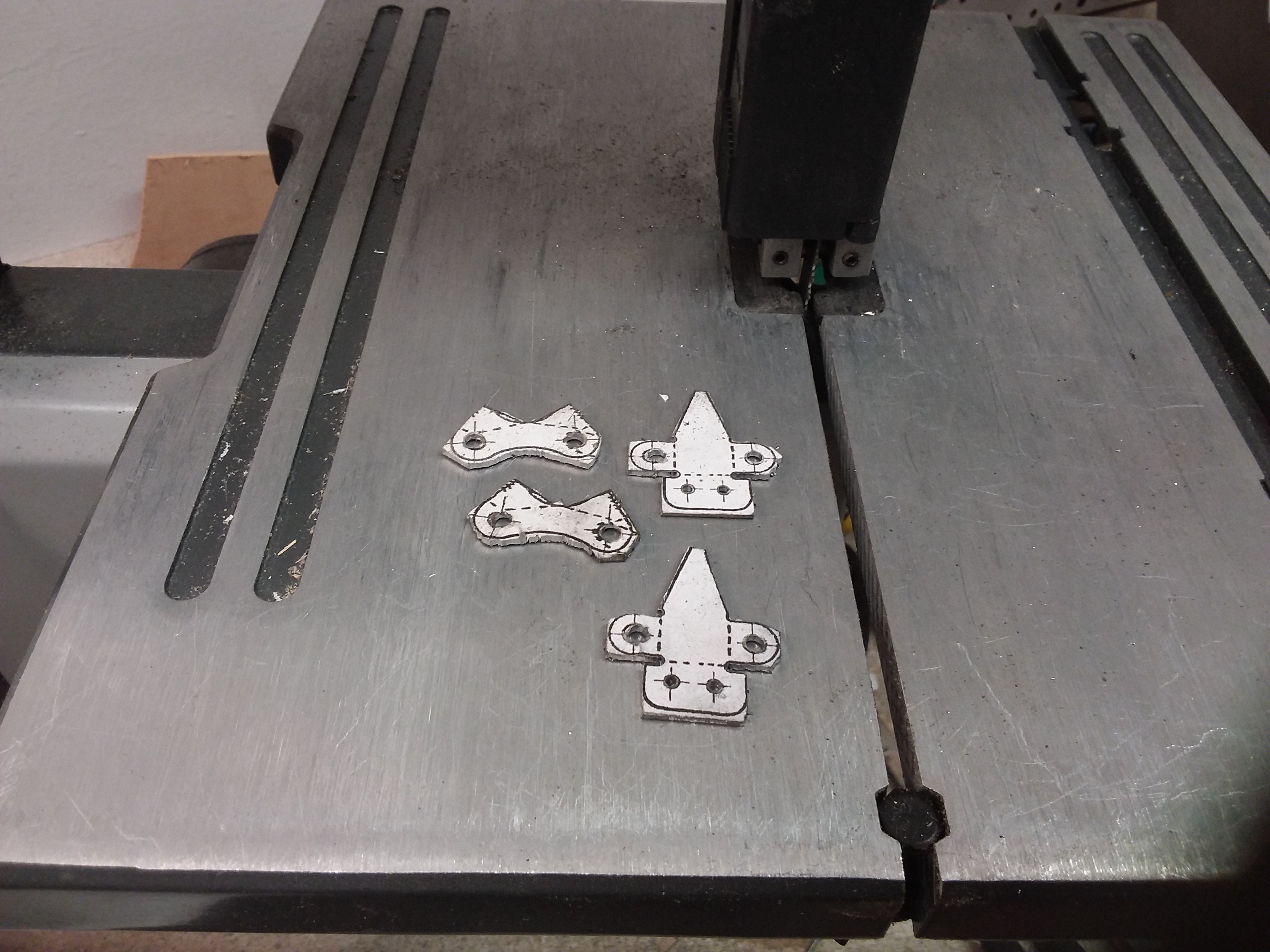

  7. dhal22
    dhal22 GSN Sponsor Tier 1
    More progress, cutting landing gear pieces with my new bandsaw blade.

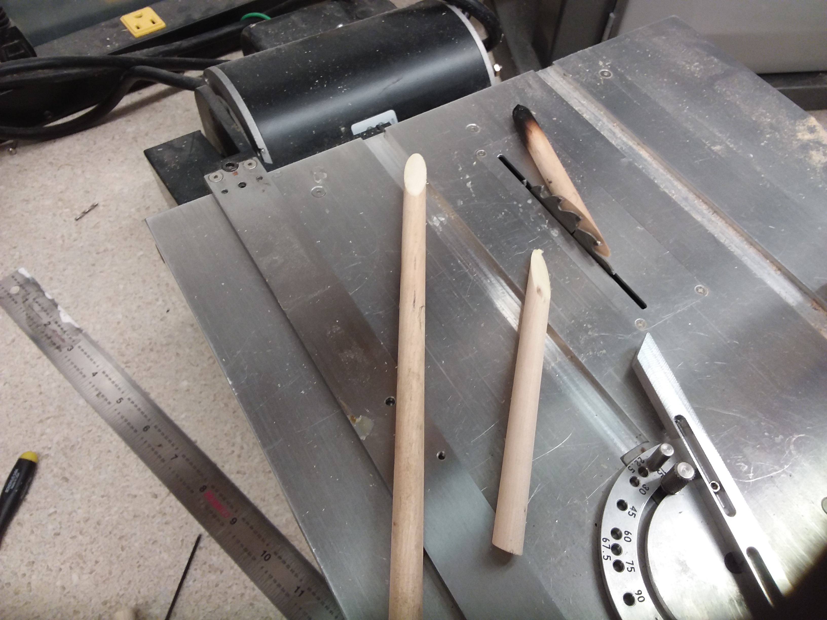

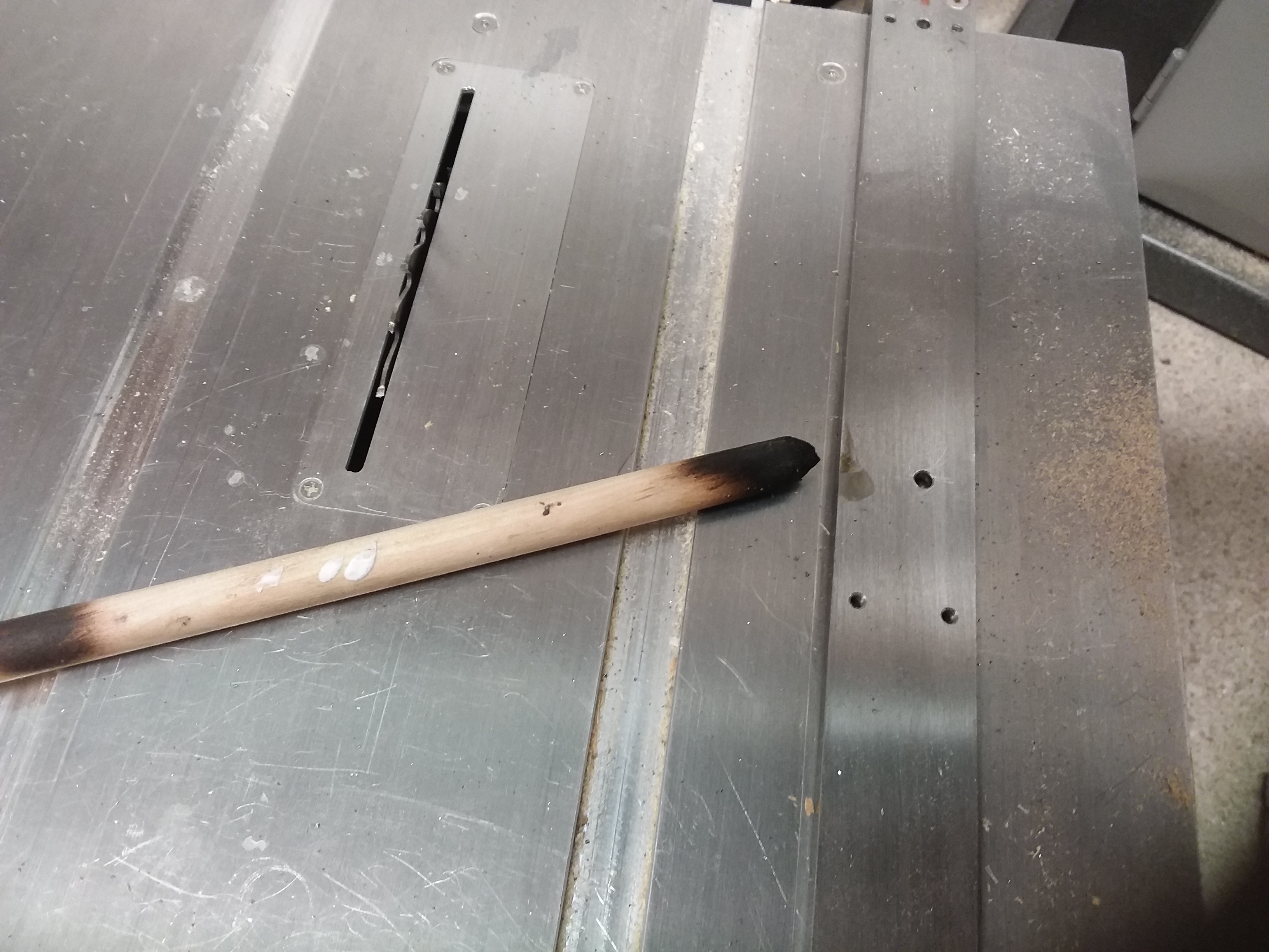

  8. dhal22
    Downside of mixing steel and wooden dowels is the heat. Cutting some burned wood out and replacing.

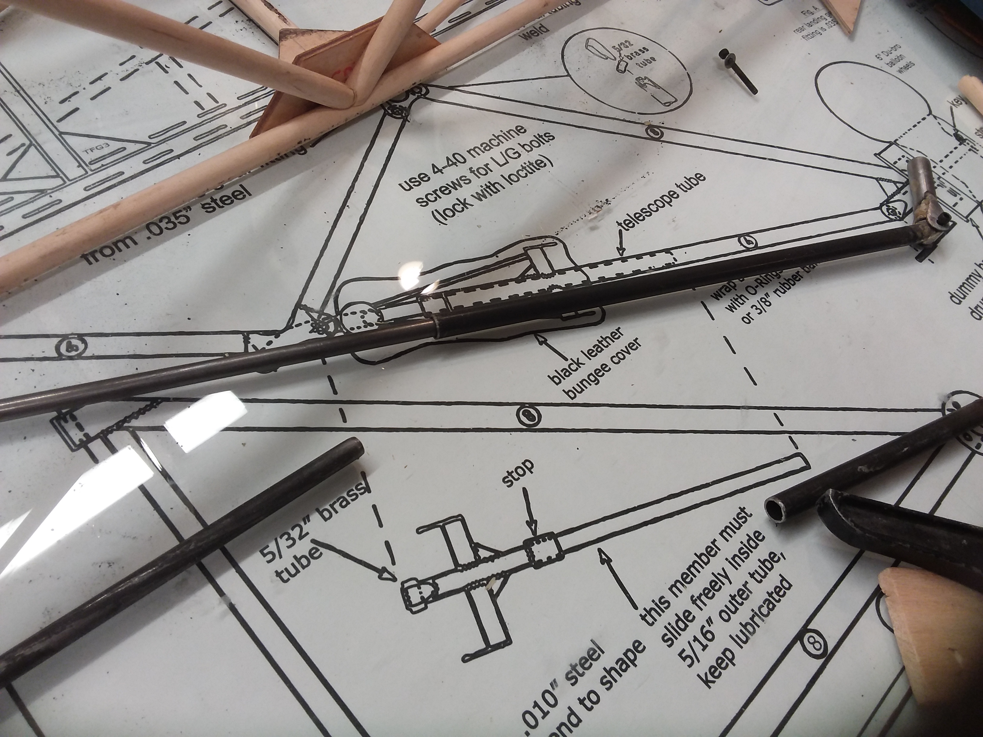

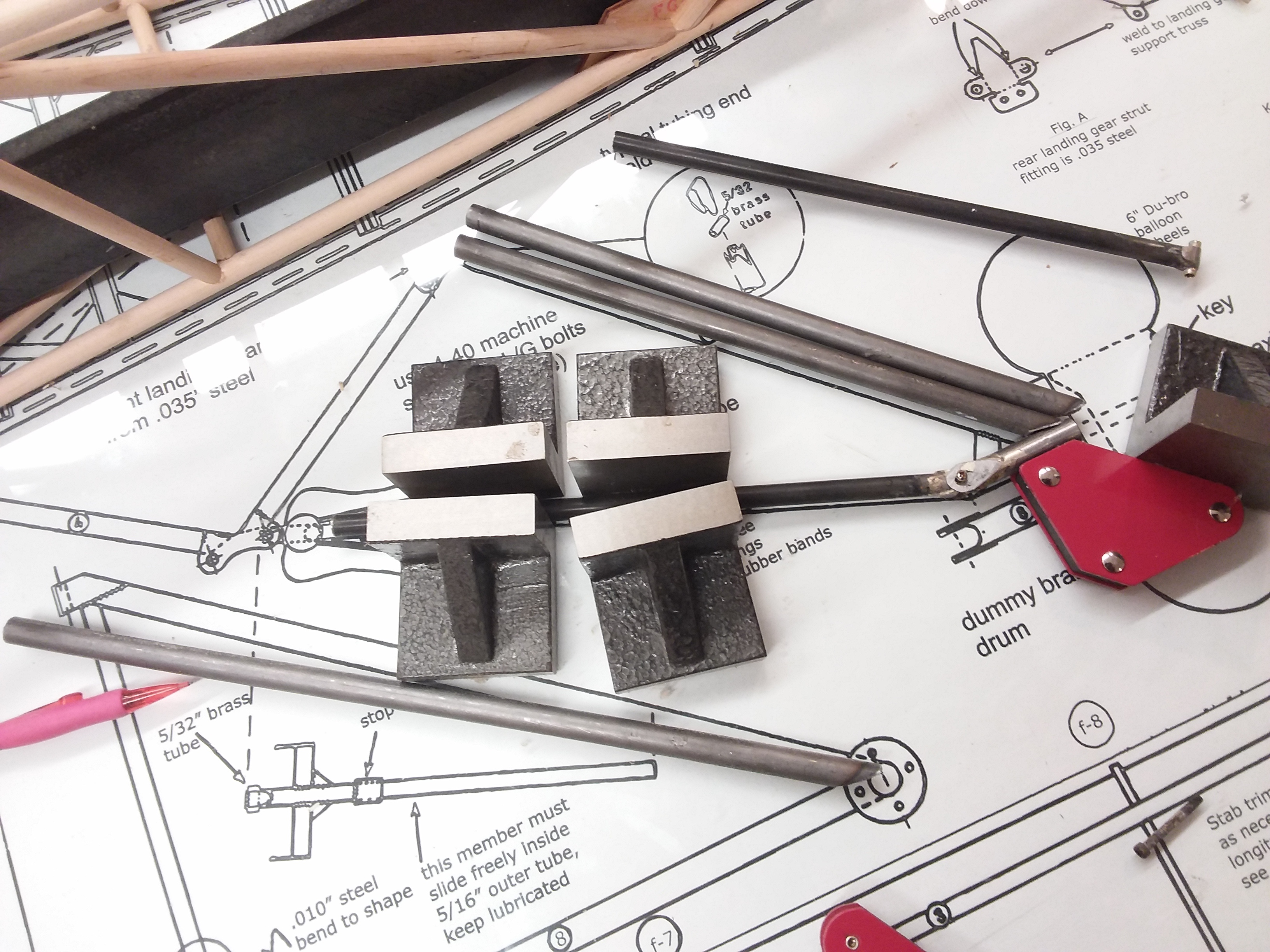

  9. dhal22
    Landing gear work held up by 1/4" steel shaft not sliding into 5/16 tubing like I was told so I ordered 3 and 4mm steel shaft. The 4mm fit perfectly.
