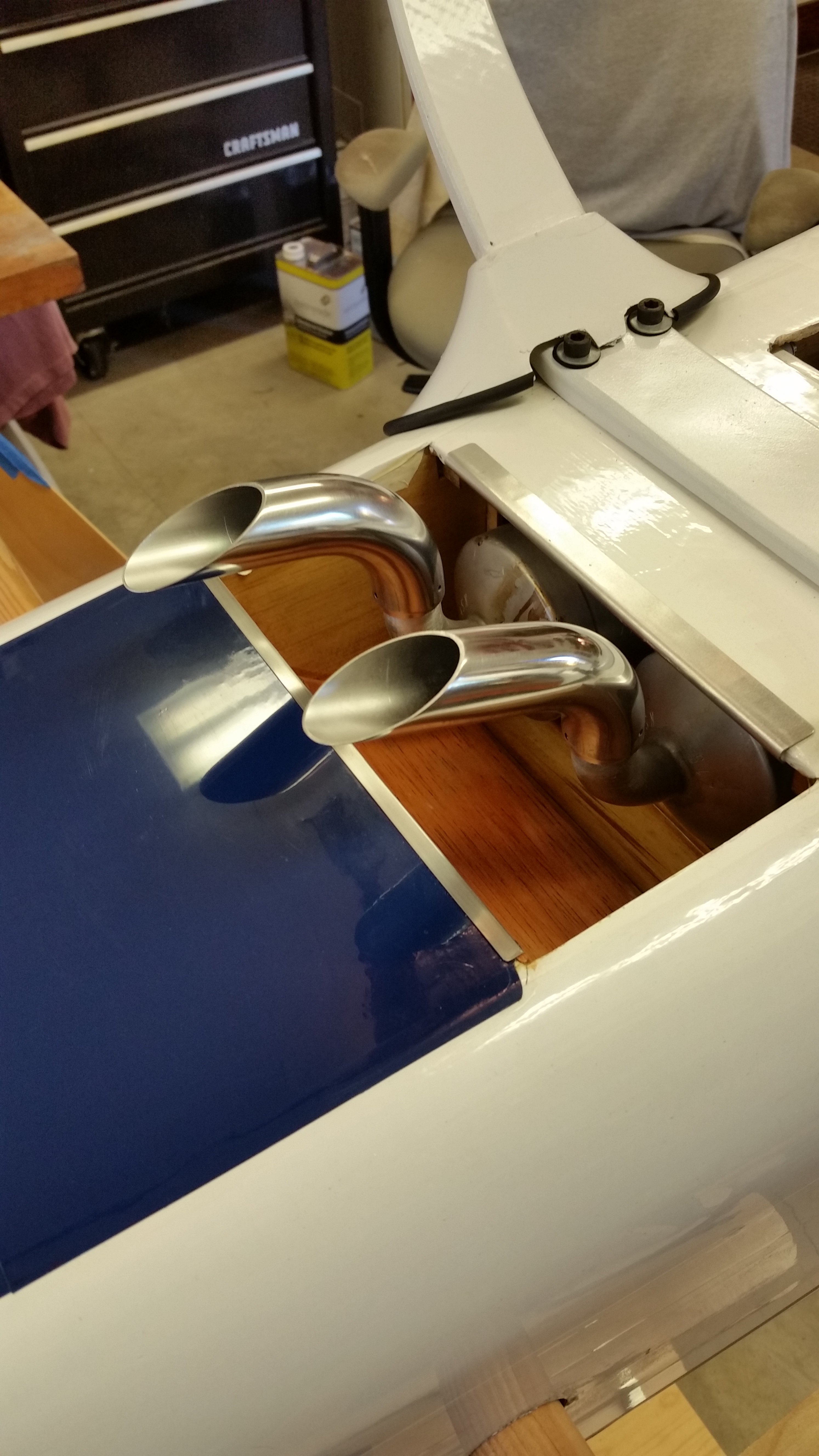

Got the headers and K&S cans mounted. Made up some exhaust extensions from a piece of aluminum tubing found at the hardware store (for a washer discharge hose!). Turned a couple of aluminum bushings, drilled and tapped for some 4-40 screws....and of course a nice baloney cut!!!

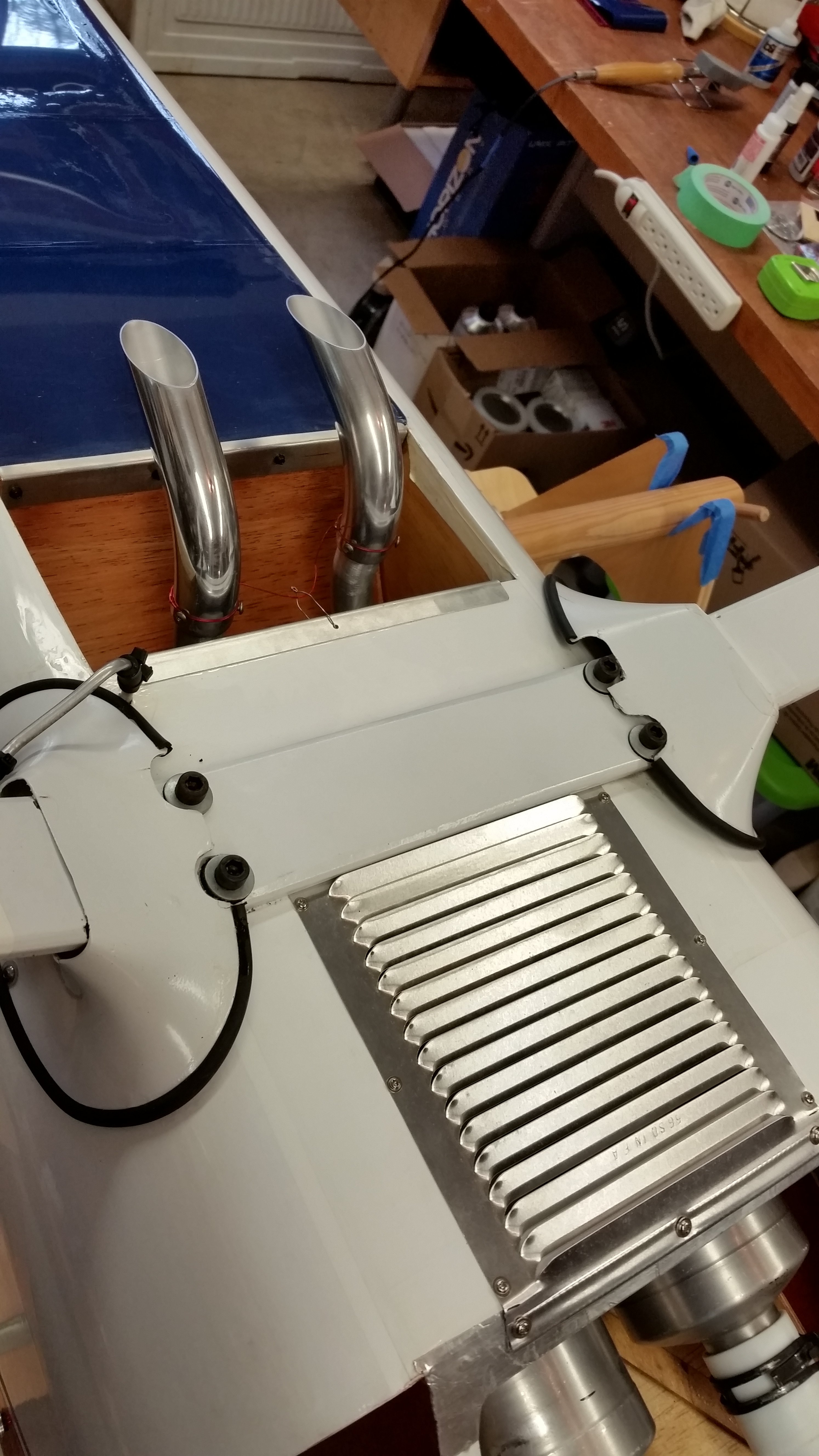

Another hardware store find.....aluminum basement vent covers. Cut out the center section for this louvered cover. Very lightweight as well. You can also see the safety wire keepers on the exhaust tips....just in case one gets loose during flight....hopefully it'll hang on until landing...lol View attachment 106114
