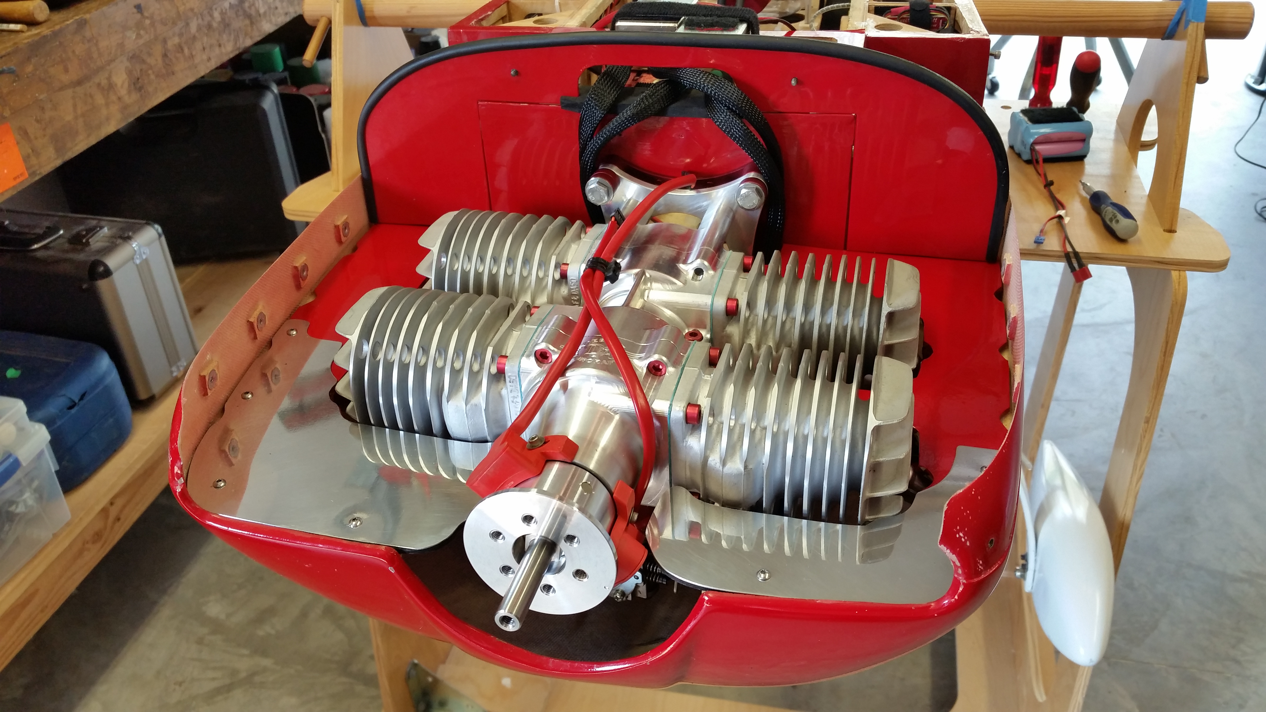

    After having run DA150's and 170's I have finally jumped on the 4-cylinder bandwagon. Got a great deal on an overhauled DA200L while I was at the IMAC Worlds in Sept.
    No excuses now....:confused:

    Man long time no see! Glad you popped in.
    I don't own a DA200, but I've flown one many times and just love the smooth power.

    As a followup to all that machining on the aluminum standoff......I finally had to remove it and replace with a hardwood (walnut) block. With the 170 sympathetic vibrations causes major harmonic vibrations and destroyed (cracked) TWO canopies....UGH! That solved the problem, although I did get tired of building canopies.
    When I showed the aluminum standoff to a machinist friend, his first words were "Where's the webbing?!" Seems I got carried away in the milling :(. Live and learn.
    Ultimately the DA200L will be a MUCH smoother ride!!! :dancing-chicken:
