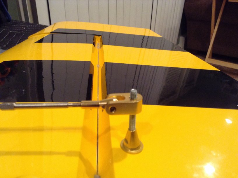

Is anyone else disappointed in the quality of the aluminum control horns on their PAU? I thought they looked awesome until I started installing them. this is my first PAU. I don't know if I just got a bad batch, but there is a ton of slop in them. The bushing that goes in the pivot point is poorly fit causing end play, even where the turnbuckle threads into the ball link fits so poorly that there is end play in the threads. Even with the turnbuckle threaded half way into the ball link you can wiggle it side to side, very sloppy! Surely this isn't the norm!?
I really don't feel good about using them, never have I had so much slop setting up surfaces
I really don't feel good about using them, never have I had so much slop setting up surfacesView attachment 11204
Not impressed. Will leave it at that.
