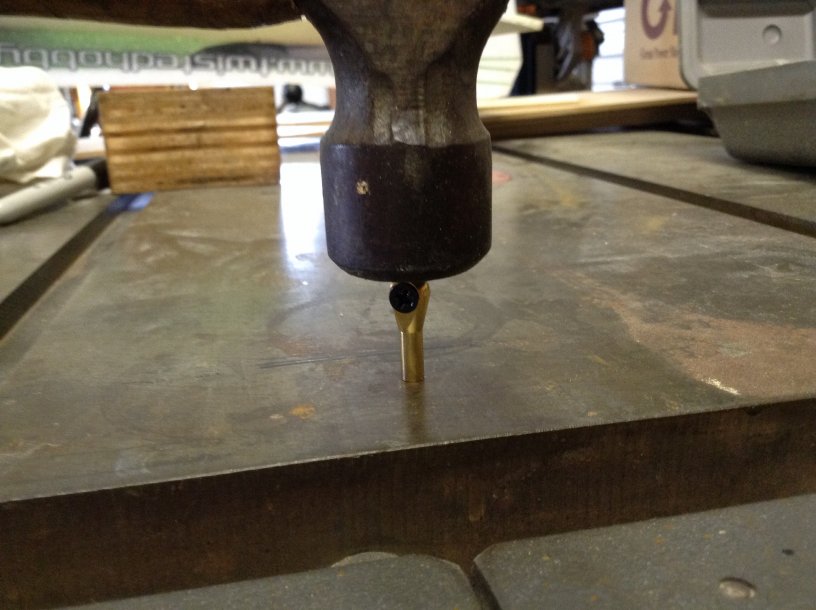

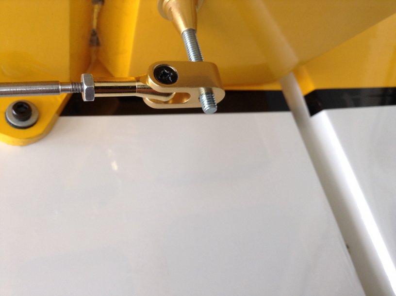

So, after massaging the links with a ball peen hammer ( sounds better than mashing the hell out of them) so that the poorly fit bushing is snug, and a couple drops of thin ca and a jam nut on the pushrods I finally have "rock solid " linkage with no slop.
Herve , please check your current batch of hardware. These really were a very poor fit, sure to cause flutter IMHO
Especially the fit of the bushing.
