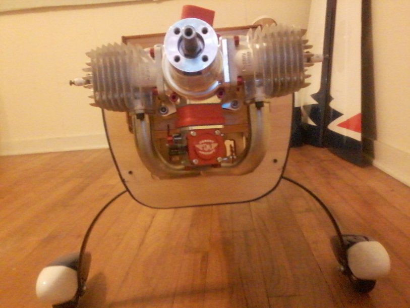

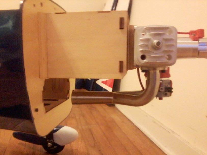

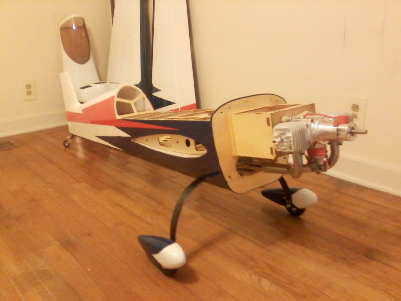

Sorry I've not been on your build thread foe a while Kelly. Looks like it's coming along quite nicely. Looking forward to your maiden flight.Some progress! But......Going to have to over come header drop and off set. The 2n1 header comes in a short or long drop. Short is 50mm and the long is 70mm. Of course I have the short but it is not short enough. I measured and found that a 35mm drop would put it center of the pipe tunnel. Facing the engine, the off set is to the left about 20 degrees which is marginal and can be delt with.

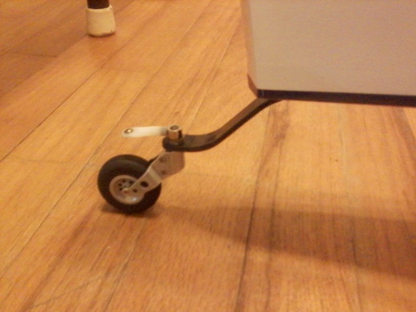

I will probably re-solder the flanges so a 35mm drop can be achieved. Another problem is that a large pro flow can is to large in diameter to fit in the pipe tunnel and air frame modification is out of the question for the bottom of the pipe tunnel is also where the landing gear plate is . I found that a Grieves pipe for 70 to 80 cc cylinders will fit. So I have been communicating with GSN members and may have found a supplier in the classifieds. I robbed the tail wheel from this ARF to put on my Edge but I did find in my clutter of parts the necessary items to fashion one that looks similar to the new ones China is making for SDS, Hobby King etc...
View attachment 43054 View attachment 43055 View attachment 43056 View attachment 43057
