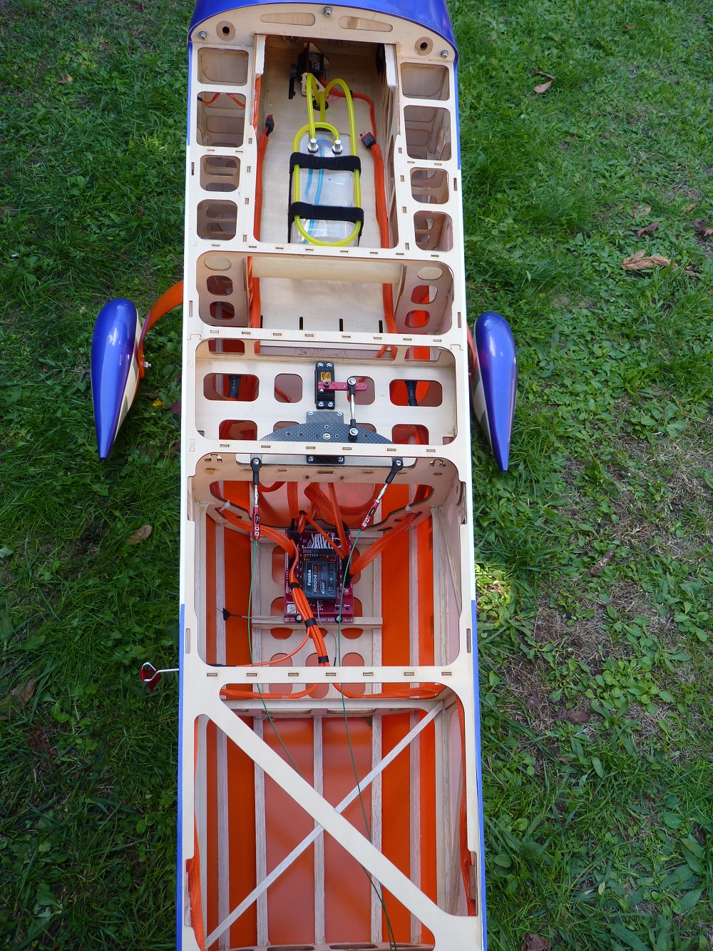

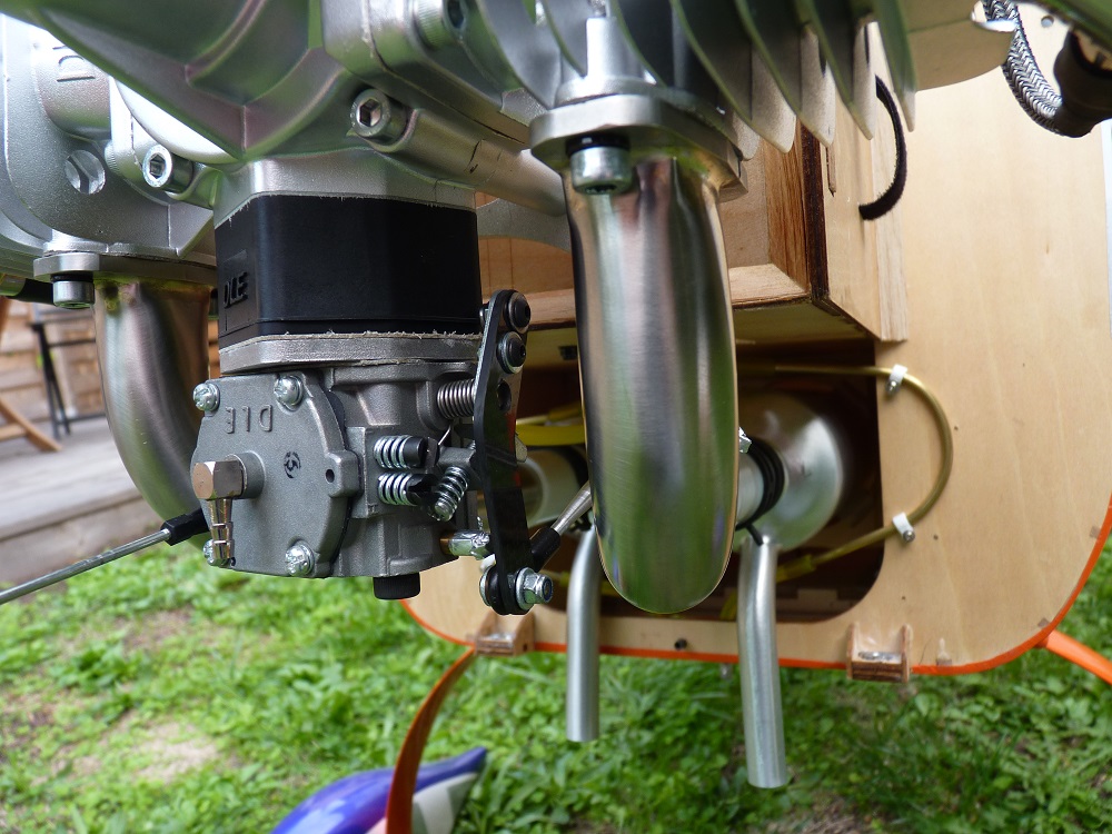

I add some pics below. You will see how I have installed my engine. I had to make a long arm on the carb to use all the servo course.

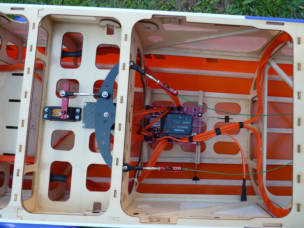

On the rudder I use a big 2230. Do you think it is enough power with such a long rudder arm?

I think you will discover that you will really like setting up individual servo (flight control) channels. It just makes refining your throws so easy and right on a "knats ass" accurate. Doesn't matter if you're running JR, Futaba, Spektrum, Hitec or any other radio brand. As for your rudder setup, at 580 oz. torque @ 7.4, you will probably be good. Maybe not for some really insane 3d, but light 3D it'll probably be ok. I usually run two rudder servos for the extra "ooomph" for the really demanding 3D maneuvers. But this would be a good question for the guys that run Savox servos and guys that have run one rudder servo. As for your rudder arm, usually a 4" arm is a good choice. But again, I usually run two rudder servos on 100cc planes. So I usually set my rudders up push/pull.

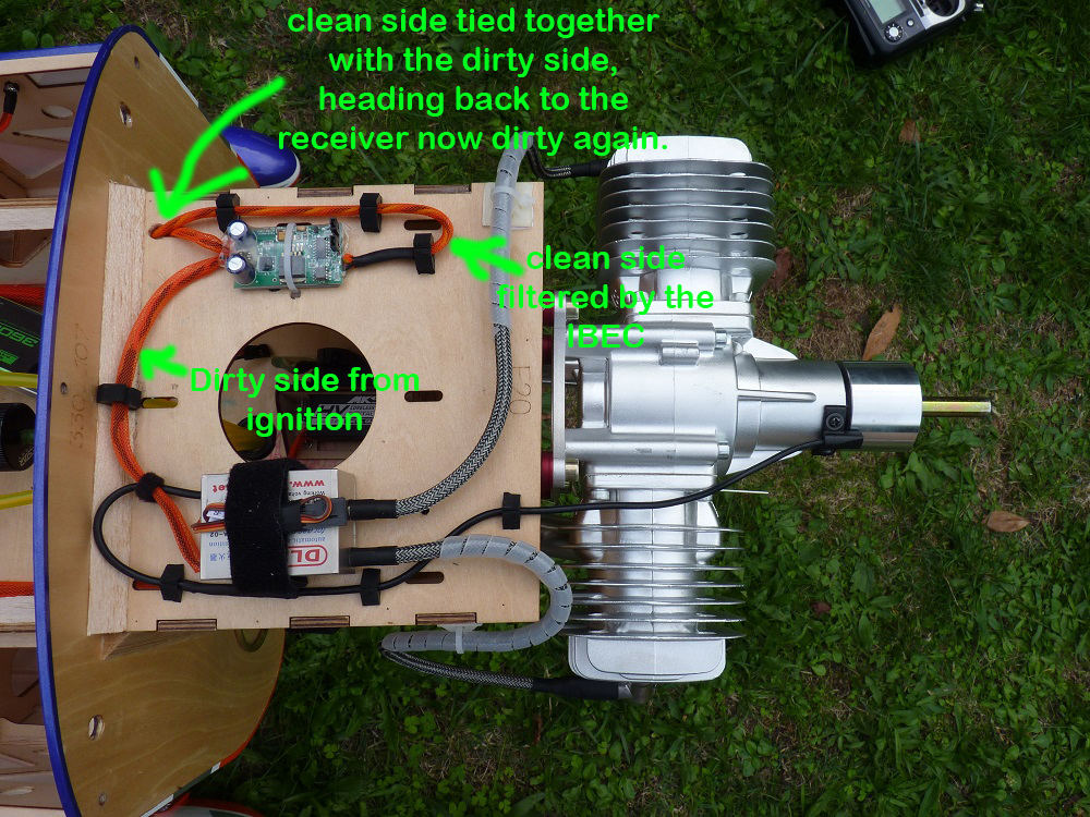

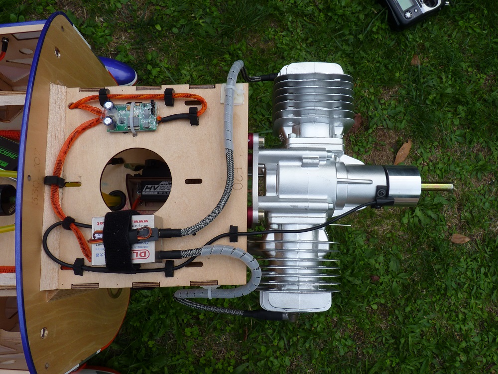

Man you do nice work, Beaublus! :way_to_go:
Your throttle resolution should be awesome with that long arm on the carb! Awesome!
I'm not thrilled with your wiring on the TechAero IBEC, though. There is a "dirty" side and a "clean" side. And, you have the clean side running back over the dirty side with the dirty and clean wires together.

Thanks Joe!! I installed the throttle servo inside the fuse and I had to put a long arm on my throttle servo. That's why I was losing more than half of my resolution. I needed to keep an accurate servo resolution and the long arm was the answer. Besides I had to avoid the pipes! Next time, I will probably install the throttle servo outside the engine box which would be easier.
What do you mean by "clean" and "dirty" side? Which side is clean? The one on the ignition or on the Ibec? I will do my best to make it "cleaner";)

Joe, what do you think about my rudder system? I carried out many tests and the length ( and offset) of my rudder arm was the one to keep tight wires! I completely agree with Stangflyers : one servo will be enough to play around but probably not for extreme 3D. ( which I don't do) However it would be stupid to crash 3000$ airplane because I didn't spend an extra 100$ for a servo!

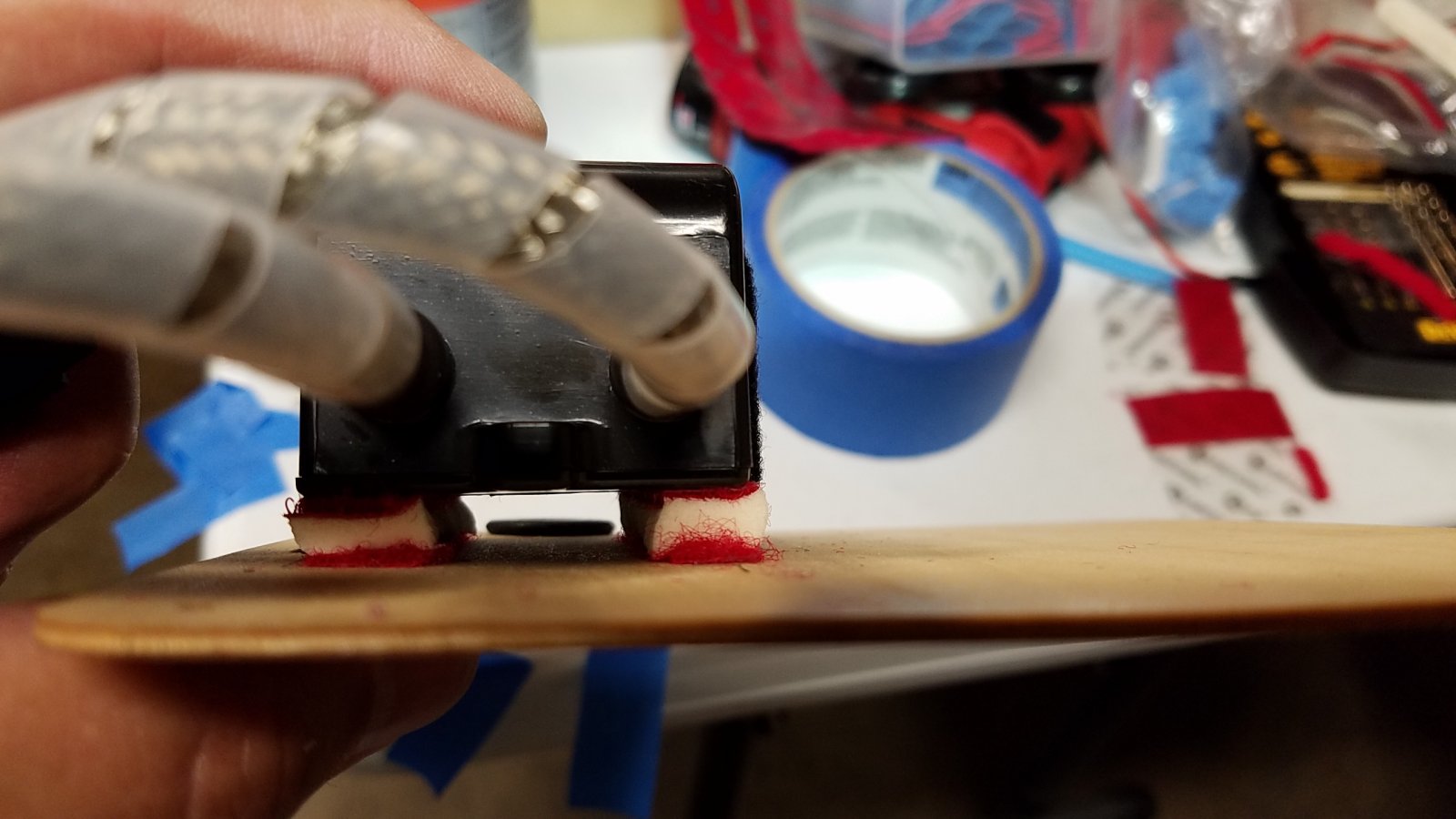

And, do you have some type of vibration absorption (foam or velcro) under the IBEC and also under the ignition? Under the ignition I like to leave an air gap for cooling, as well.
Yeah, most guys don't take the time to make sure their non-pulling cable is not getting loose (and worse is tight). If the control horn pivot point on the rudder is offset from the hinge line of the rudder than you need to use that same offset amount on the rudder arm (if the cables are parallel). On 1/3 scales with pull/pull I need two servos, but with push/pull one feels great (although I think two will last longer).
