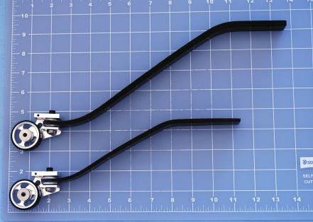

Here is a picture of our two largest tail wheel springs. The largest one lifts the back of the airplane six inches off the ground which is more than adequate for a nuclear harrier :) If you go to our web site you will see "drawing and dimensions" below each of our tail wheels. If you click on this a pdf file will download that has all the necessary dimensions for all our tail wheels, aint the internet great ;)
There you have it! Thanks, Vern!
