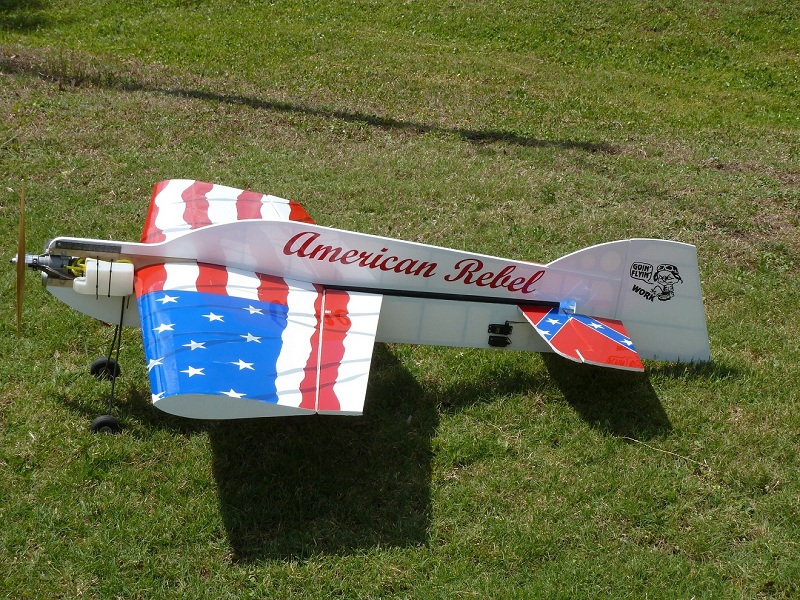

As a profile flyer I can only talk of my experience. And it has been mine that for more pulling out power a larger diameter less pitch pulls better than the opposed. Below is my current fish out of water, a Swany house Primo on 20cc gas, ended up with a large flat prop to yank out easily. Same goes for the Extras, Edges, and the Ultimate.
Right now the Pitts is propped for power with a 34x12 and is slow but come Friday it is getting some speed with a 32x14.
