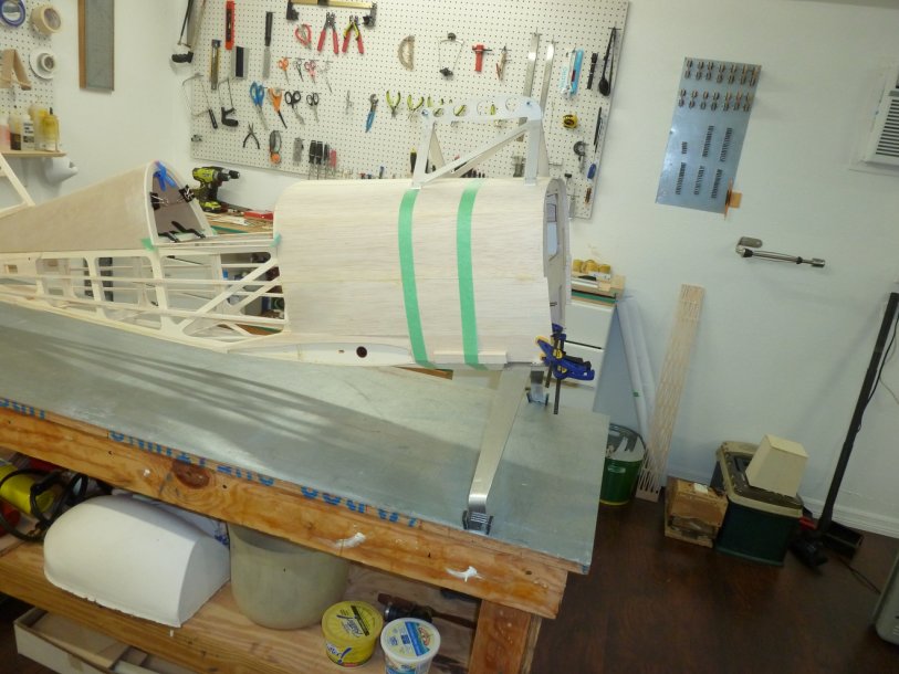

I worked on the base frame for the canopy frame a bit today, my kit was missing it so I am having to make it. What I am going to do is cover the cockpit area with tape and epoxy it together in position clamped to the fuse structure. Later when I want to add the canopy I can re-clamp it in place and glue the canopy to it, should make for a nice fit. The pieces can be seen on the bench under the fuse, in the morning I will take the scroll saw to the base plywood then get it epoxied together. The other pic is the fuse sheeting going on. I also have finished the aileron framing but will wait on the cover sheet until the control horns are installed.

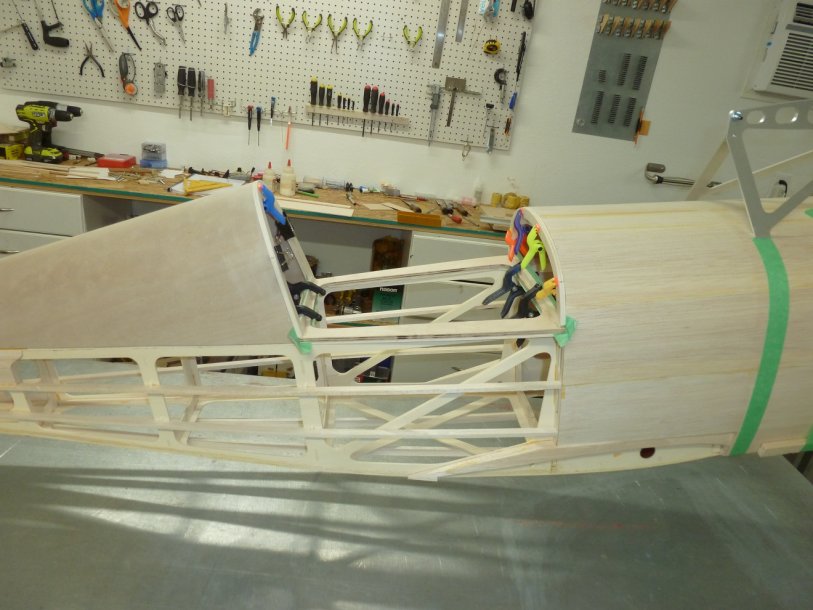

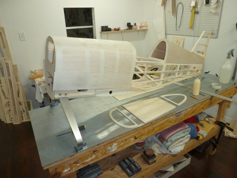

The last piece of nose sheeting has been added. The canopy frame has been epoxies, positioned, and clamped in place.
