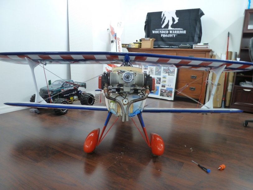

I have switched the exhaust back to dual exits, I did not like the single whether it worked or not. And I have added an exiting air baffle, according to my calculation's it should slow the transfer down about 35% thus elevating the temps. I am attempting to get the temp to at least 240° instead of the 180°. The increased temp should help the engine perform better.

Well, I have confirmed it was me switching the choke instead of the smoke. Also, the exiting baffle does not work as well as an intake baffle, it heated up more at idle but cooled right back down under throttle, so I have removed it. Sometime soon I will work on making proper intake baffle's or I might just not worry about it.

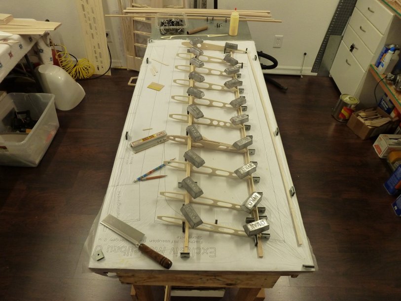

Taking a little time to work on the build, the top right wing is framed up with glue.
