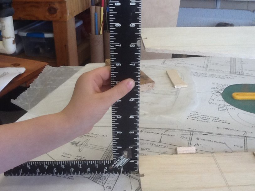

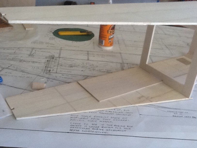

Here's the business end showing the installation of the plywood side-doubler (MS). I've laminated F1 and am waiting for it to dry. The instructions say to have the engine on hand because it's critical that the 2 sides stay absolutely square while bending them around F1 which is round. Right now I'm in pretty good shape.image.jpg
That's my 6 year old grand son holding the square. He said this is the most fun he's had all day!! Papa is so happy!

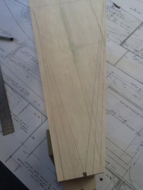

Making a compound curve out of a square piece is a difficult task, and one that if you're not careful, could result in fracturing the sheeting. The plans call for making 1/16 inch deep cuts in the side sheeting to facilitate the bending process. I did this on the tail and it didn't work out too well. I've got a lot of work to do to fix that mess. What I plan to do this time is to make the cuts, but before I try to bend it, I'm going to soak it in an ammonia solution to try to soften it up a bit. That's not going to happen until tomorrow, so if you have another idea, I'd sure love to hear about it.

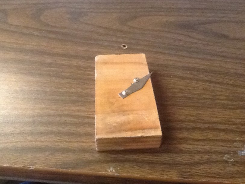

Here's what I use for stripping balsa. It's just a small piece of 1 by, that I dressed on my bench sander and then rounded the edges. That's just a #11 x-acto blade and a couple of servo screws to hold it where I want it. Very simple, very useful.

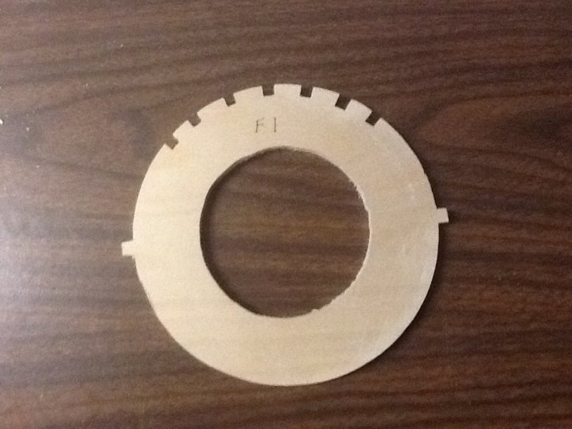

Heres F1, rough cut and ready to finish sanding to get the curve right. That's what the front side pieces have to form to.
