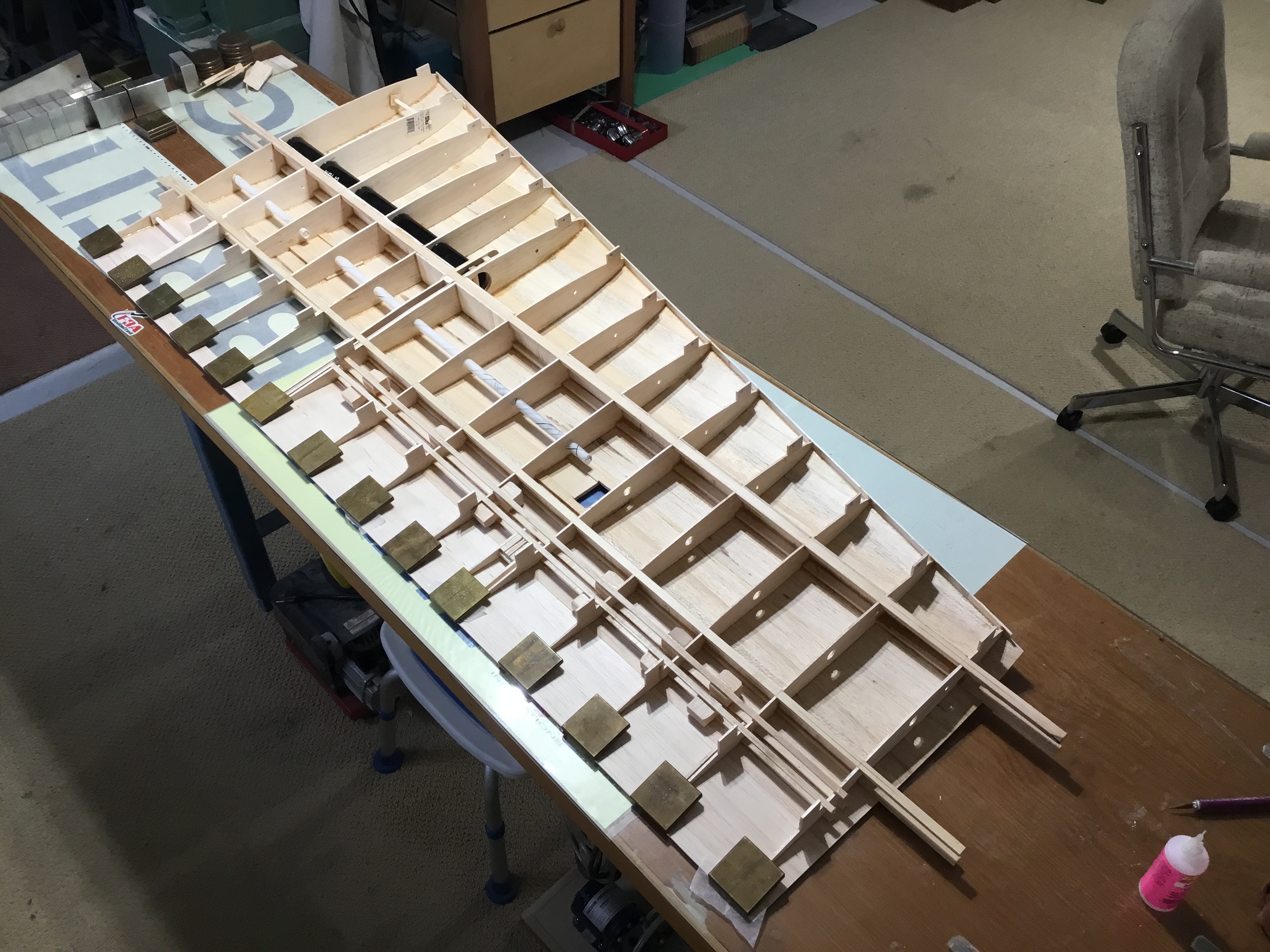

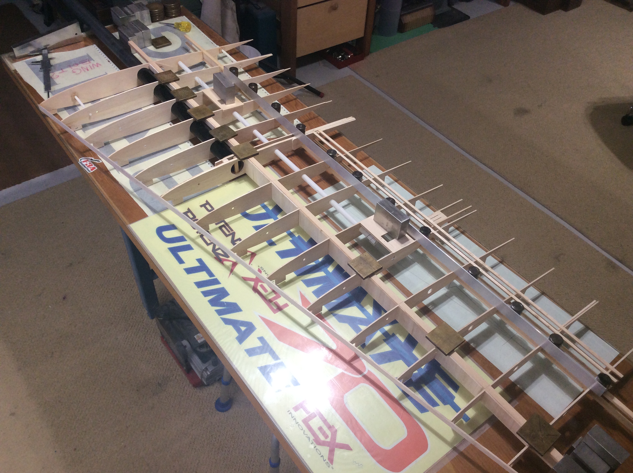

Been buying a lot of stuff for the plane. The servos arrive and on tariff on them and a bunch of parts for the flaps. Right now the flap parts are holding me up so I believe I will start the left wing and get it to same stage of completion.

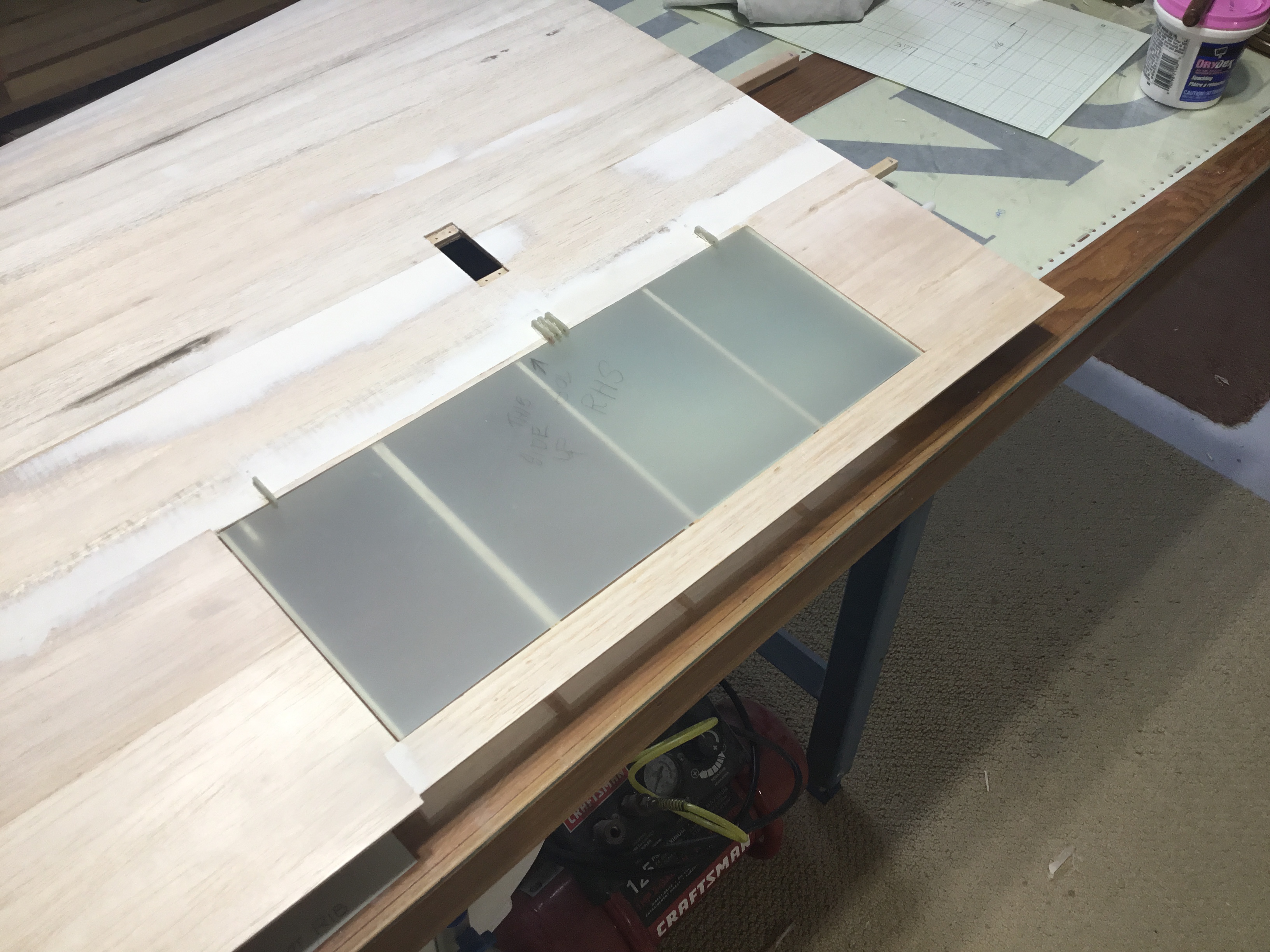

one side of the wing is covered it all went well and the trailing is nice and straight. Just have to fit and make the flap/air brake work. Important part for this plane with a Kolm in the nose. The air brake will be 7 by 14 inches It will need a big powerful servo.

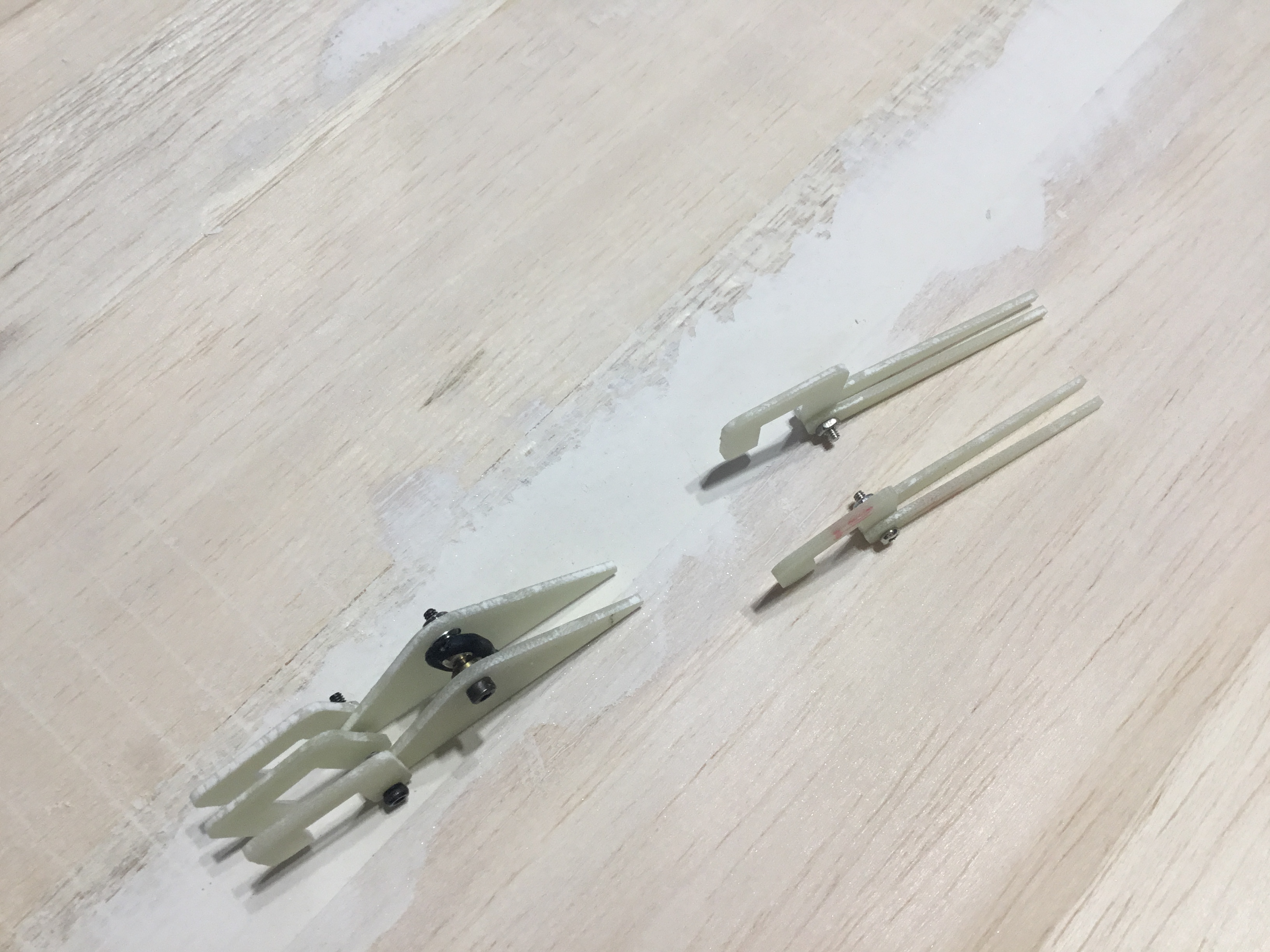

Got all the hinges made for the flap/ air brakes making small things like this difficult to hang onto and cut the part. That took a full day to get it all done. It is all made from 1/16“ G10 plate, difficult to cut and grind and not let it burn.

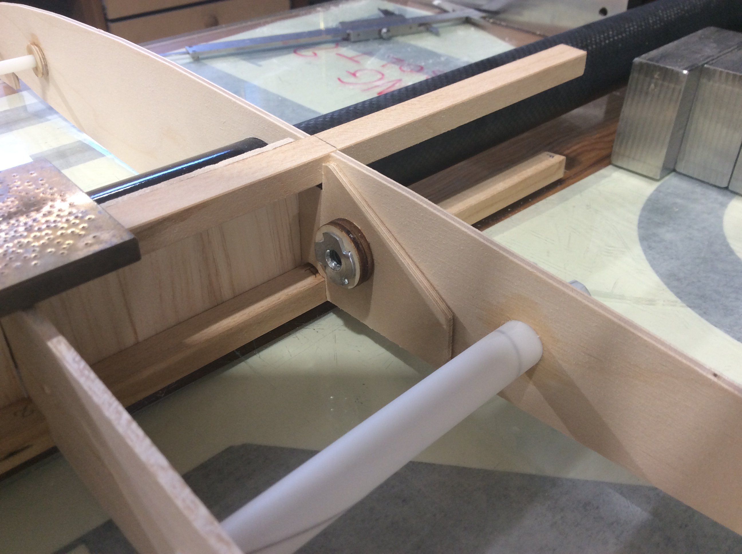

Wow almost made a big mistake just about to close the wing and do all the top sheeting and realized that I forgot the wing bolt. Have make some parts and see how and the location. that would have been difficult to fix afterwards.
Now do I do one or 2 bolts.
