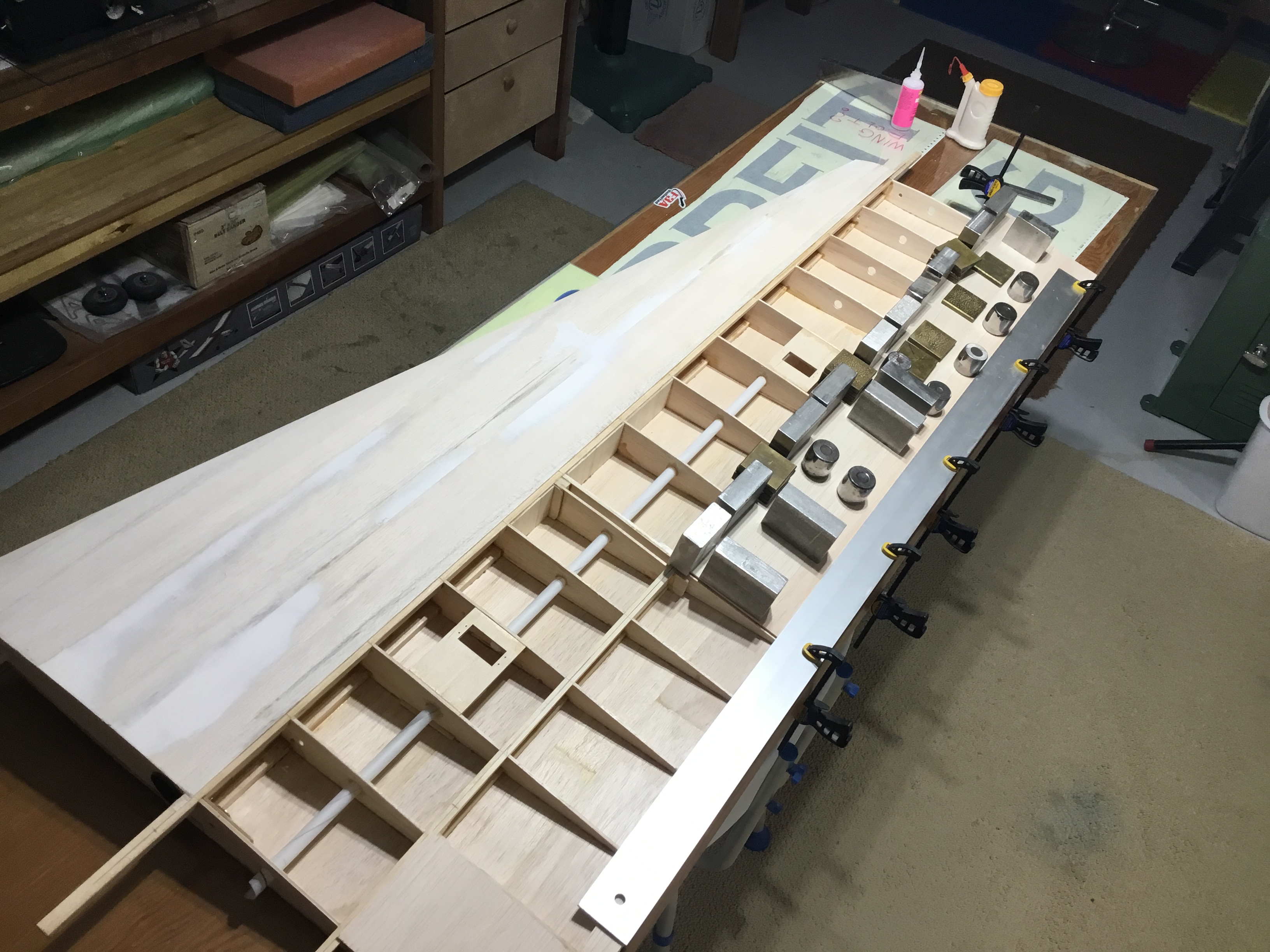

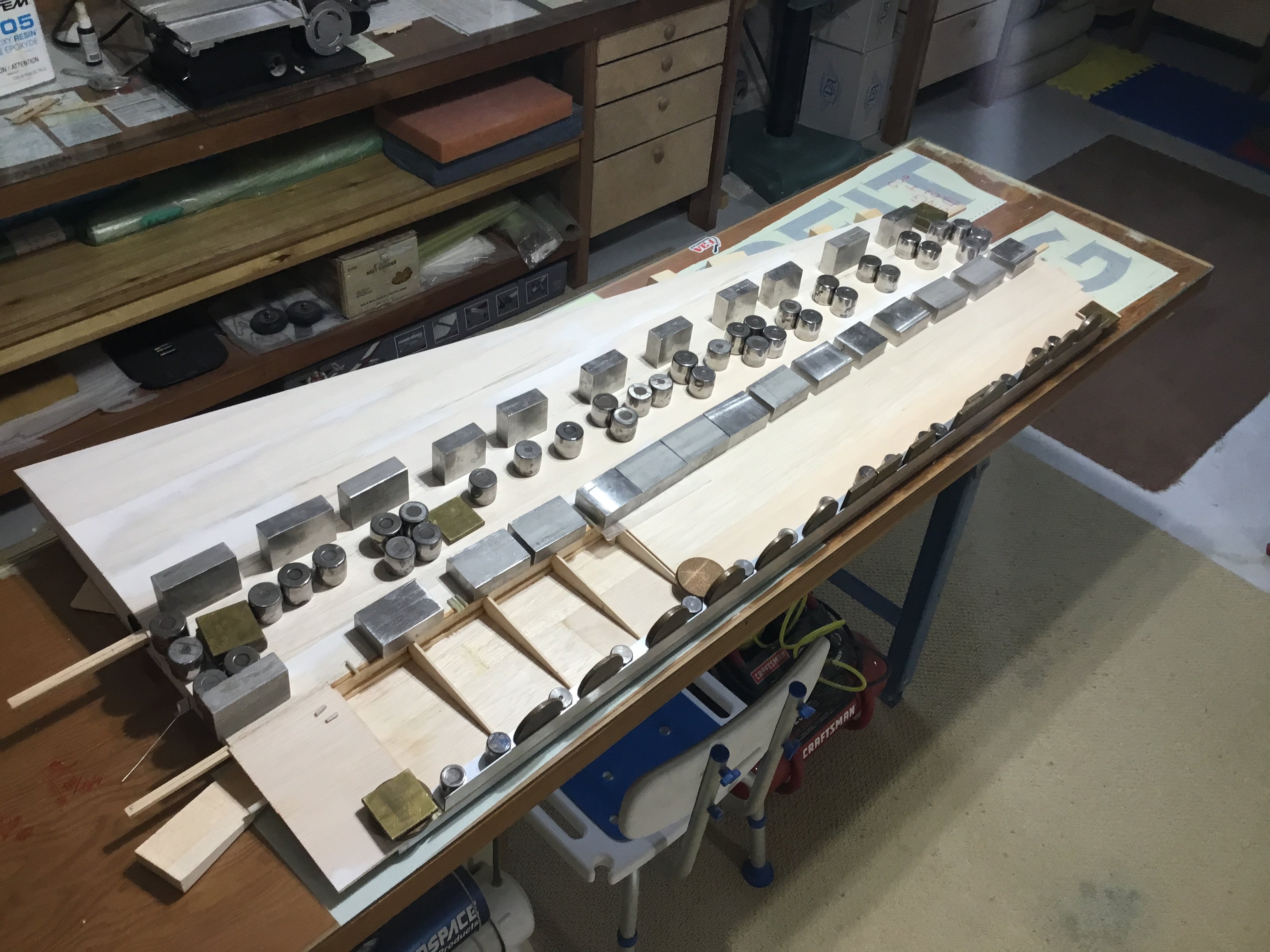

Getting there on the right wing. Just have to add the hinges for the flaps and the centre sheeting. Just have to let aileron sheeting dry. Hopefully I can get the right wing all sheeted and done tomorrow.

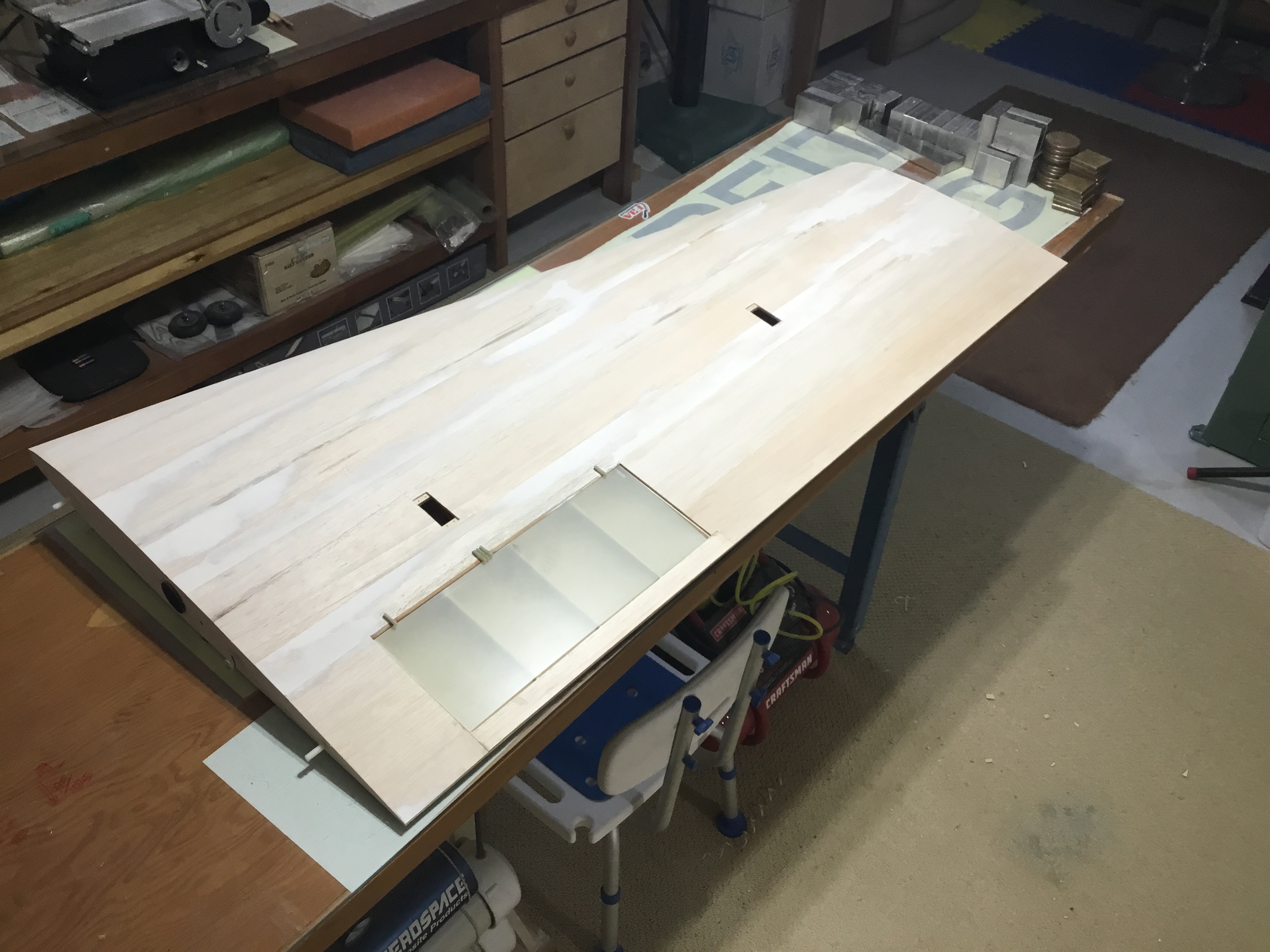

The the Left wing is fully sheeted just have to let the glue cure for a couple of hours and then I can remove the weights and just clean up the joints either by sanding or a little filler. Flap opening is made and all the special hinges installed for the flap.
