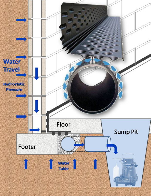

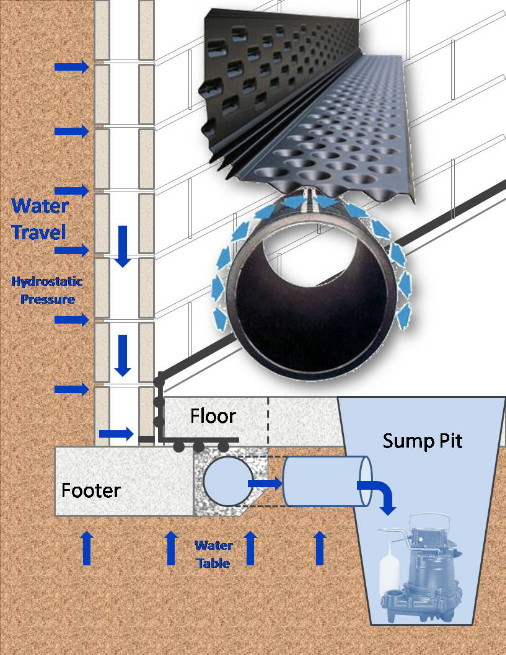

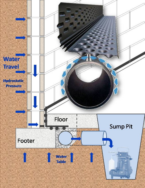

Need to explain how you water proof from the inside. Maybe I am not understanding but if you water proof the basement it is done from the out side. You dig up all around the house and waterproof the walls and install weeping tile.
Basically you dig up around the walls, in my case I plan to cut at 24" from wall, remove concrete and fill, drill weep holes in bottom of block, add drain channel to wall and footer, add gravel and internal drain pipe, add pit and pump. Hopefully the basement is dry!!!
Thanks for that never seen it done like that. When ever I had problems at my old house we fixed it from the outside. Thank learned something again. You have lot of work ahead of you.
This is SOP in metro Atlanta. Very effective.

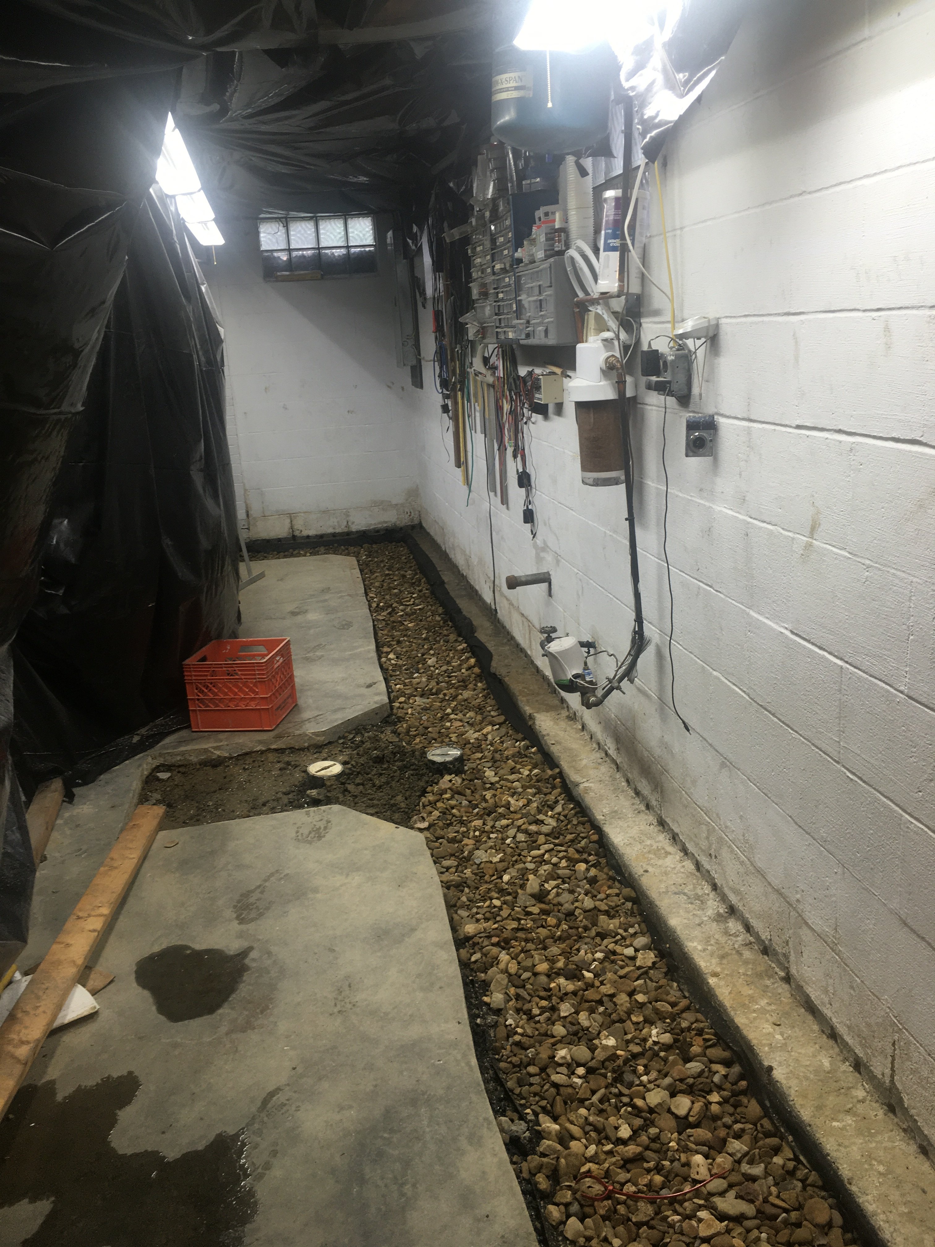

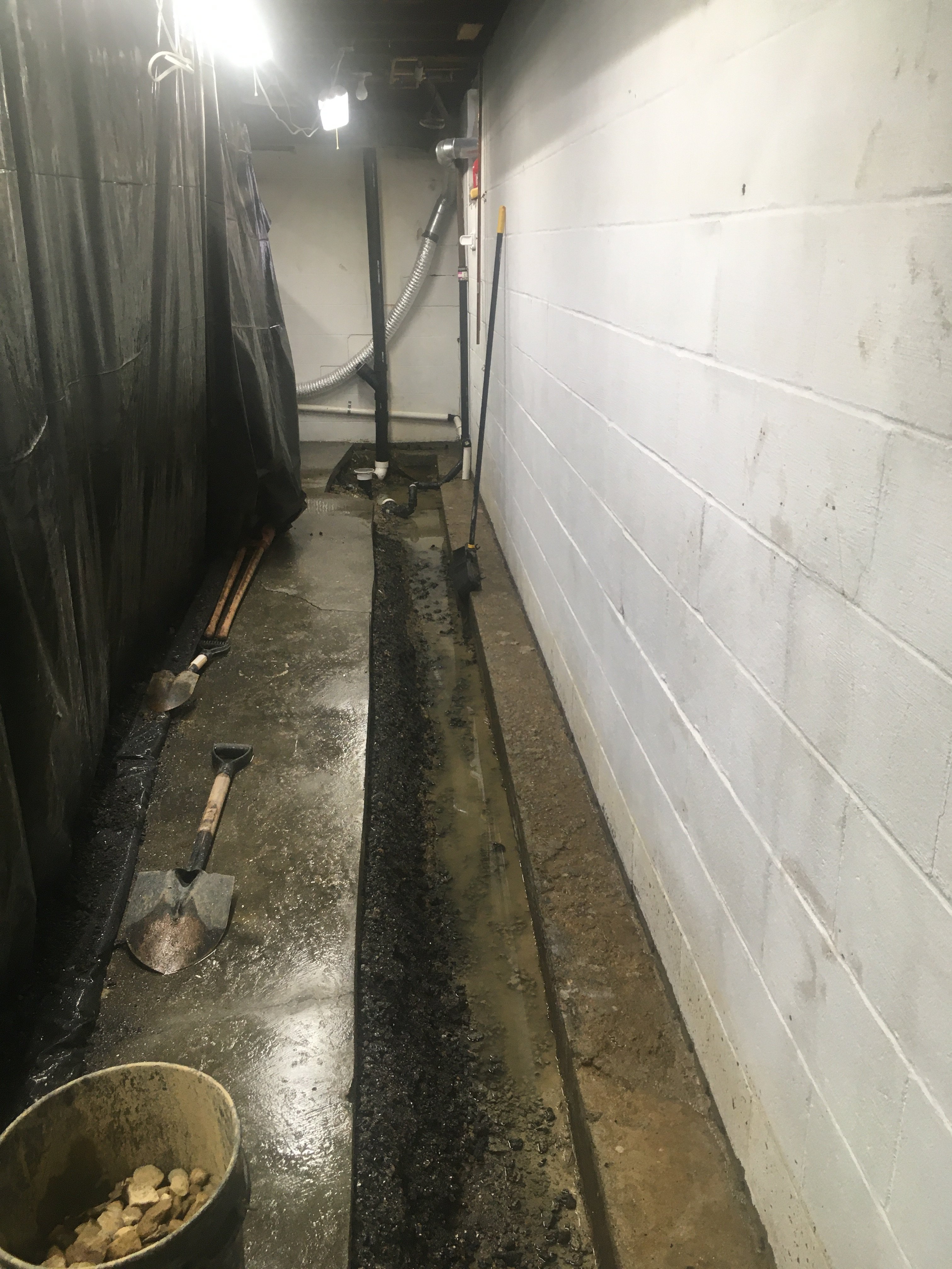

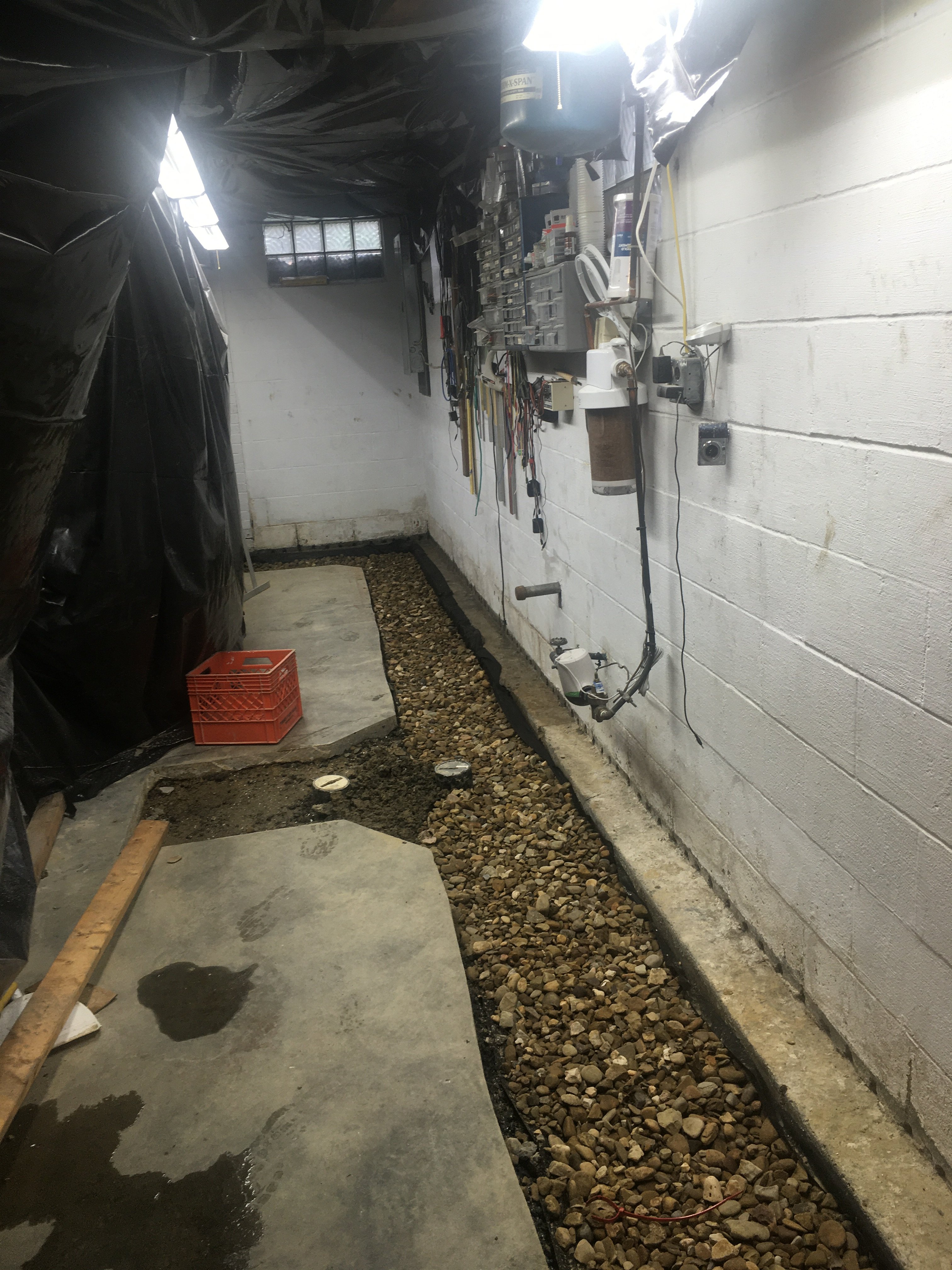

I would love to meet and talk with you however it not a good time for me right now. I have my workshop (Basement) ripped up and installing an internal french drain. Thursday will mark the two week mark of the project, removed 6 tons of concrete and earth, hauled off to the landfill. Now carrying the gravel back down, at least gravity is on my side now. Still have a few details to work out and will hopefully will start mixing concrete next week. I will PM you my phone number and we can chat if you like.
Wow that is a big job looking good it looks like the worst is done now it just putting it all back together.
