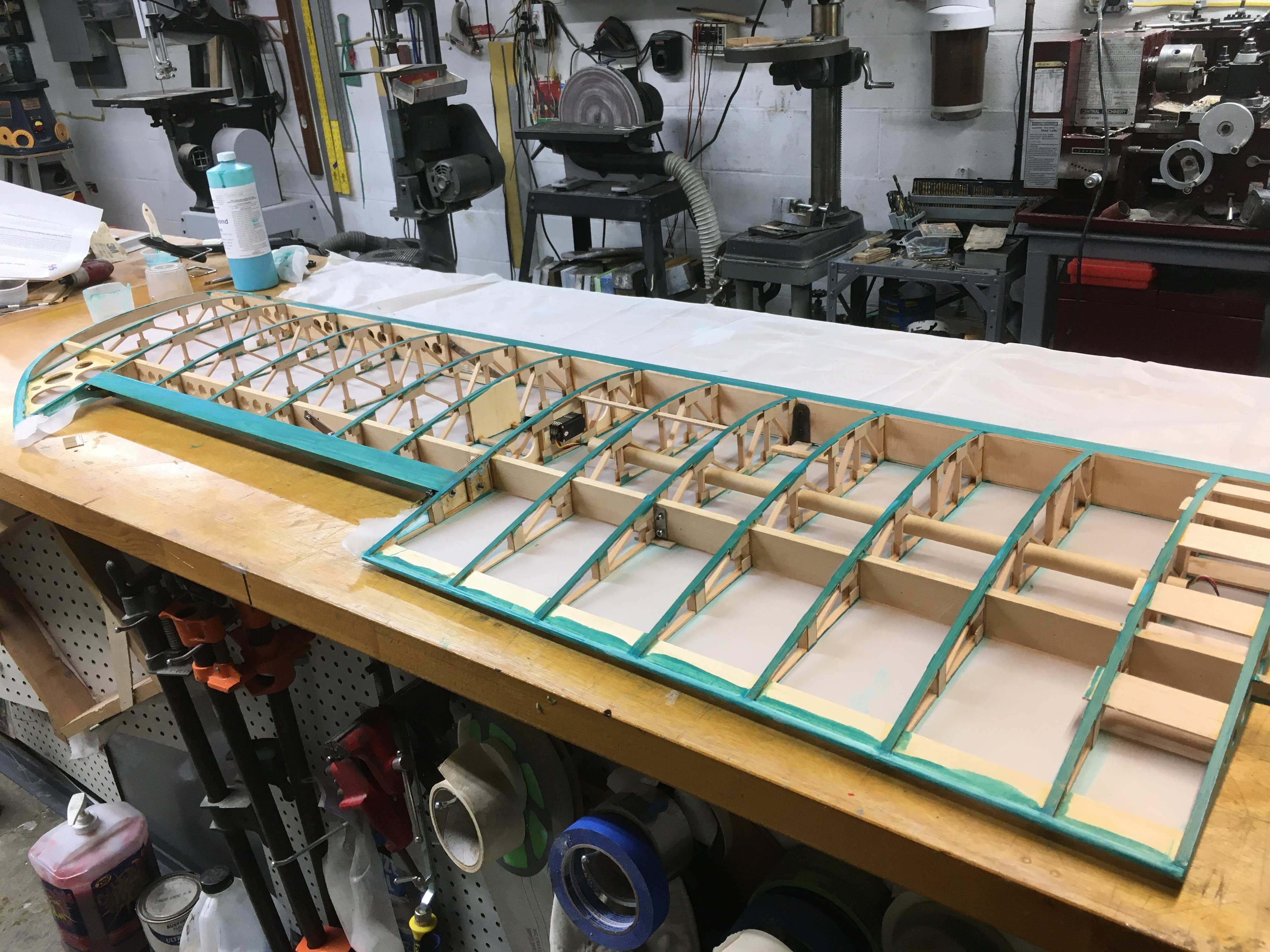

    Back to work!!! I have the wings about ready to cover, servos mounted, linkage complete, etc. I decided to use the original Steward System paint for the project and was even happier when I discovered they have the original colors available. I ordered a quart of yellow and a pint of orange to start. I hope to paint the wings and then determine if I will need more yellow to finish the fuselage. I'm sure the pint of orange will do for the bottom of the fuselage.

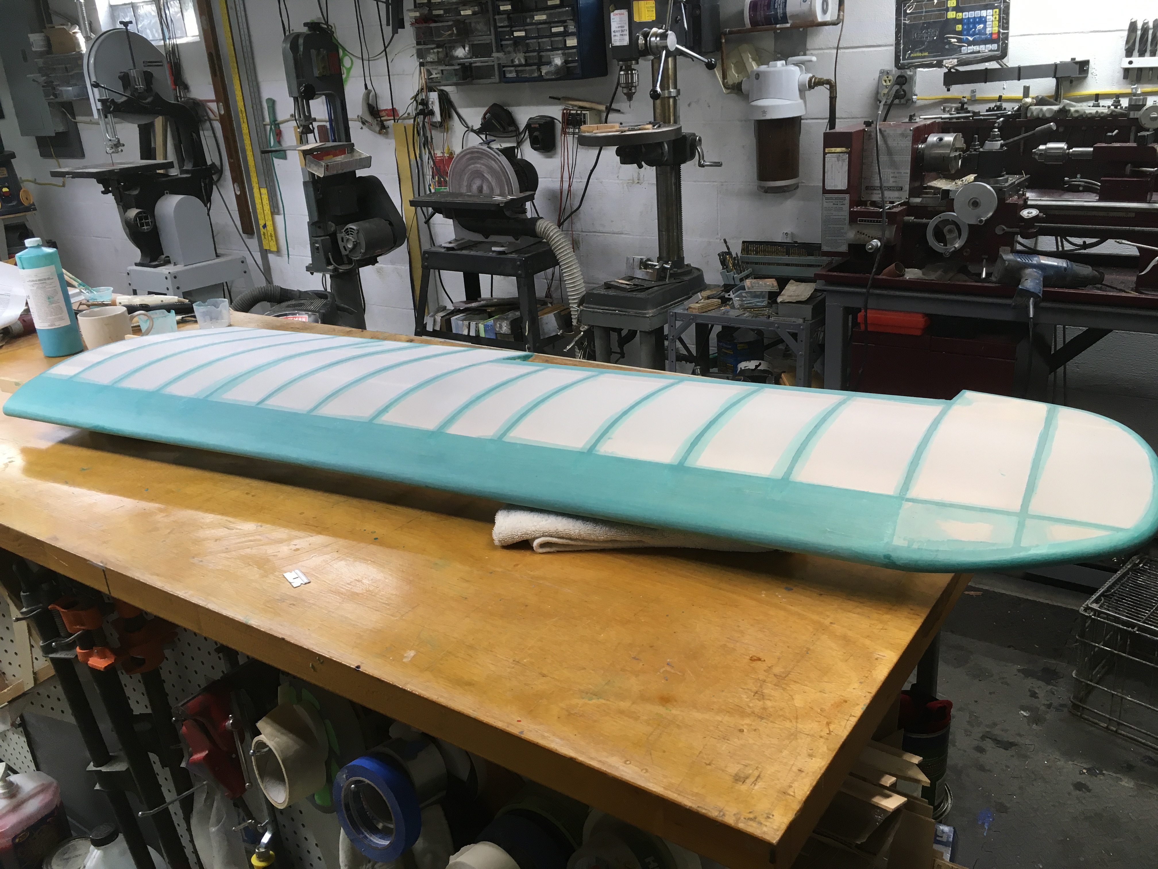

  5. Started putting the fabric down. Using Steward Systems Ecobond to attach the Stits lite fabric. Water based, no odor which is nice. Brush on two coats of Ecobond allowing it dry, then using an iron at 225F, iron the fabric in place. Very much the same as Stits. For the strut fittings I ironed the fabric around the perimeter, did a light shrink, painted the fabric where the fitting where sticking up with Ecobond, allowed it dry, then cut the slits with a double edged razor blade. After all the fabric is attached to the ribs and leading edge, a coat of Ecobond is painted onto the glued areas and immediately wiped off, this finishes the gluing process.
    I did the bottom of one wing last night. The wings are under cambered, the bottom is shrunk to 250F and glued. Appears to be well bonded to the ribs.
    Here's the top of the left wing ready for fabric. I'm wrapping the fabric around the leading edge rather than using the two piece blanket method.

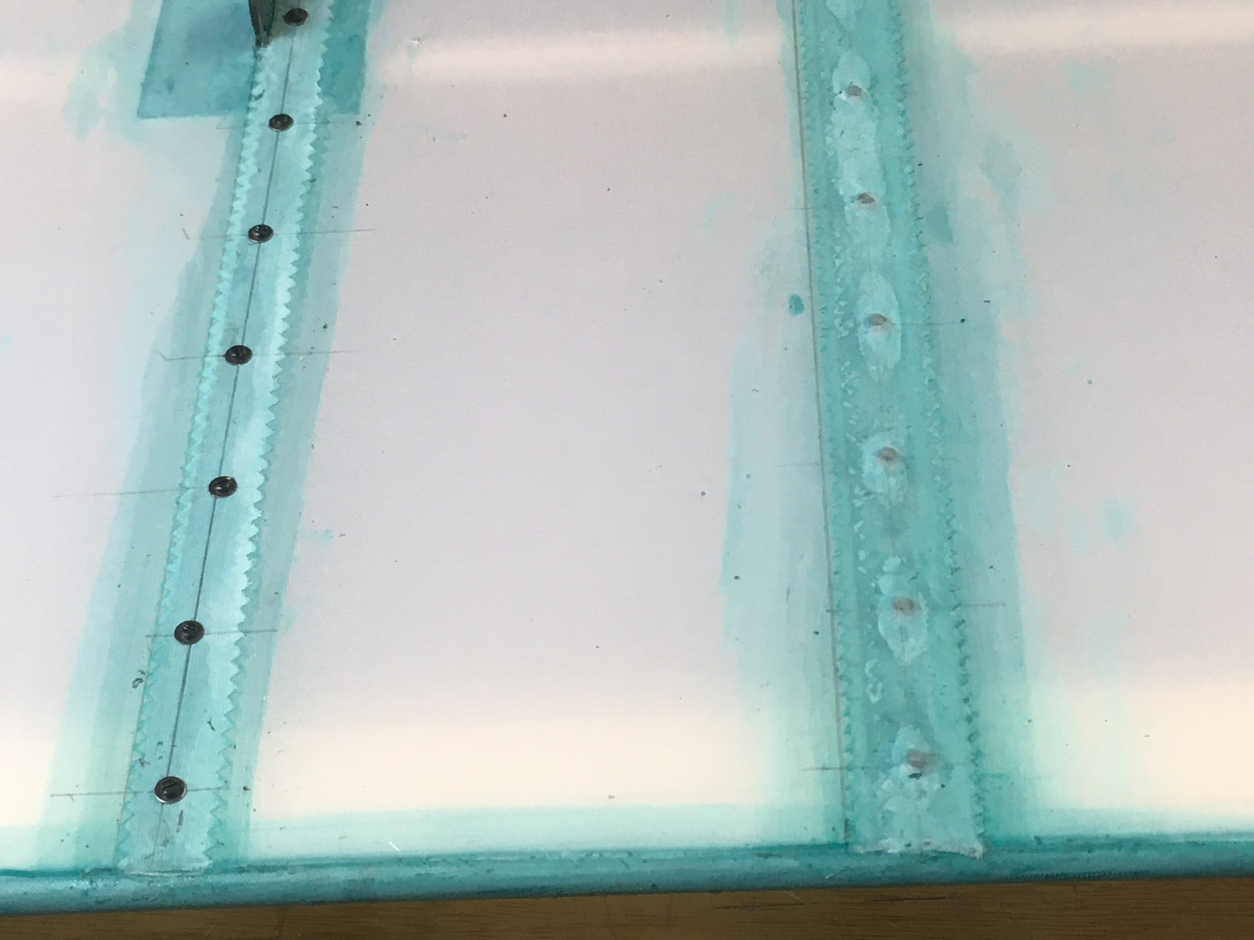

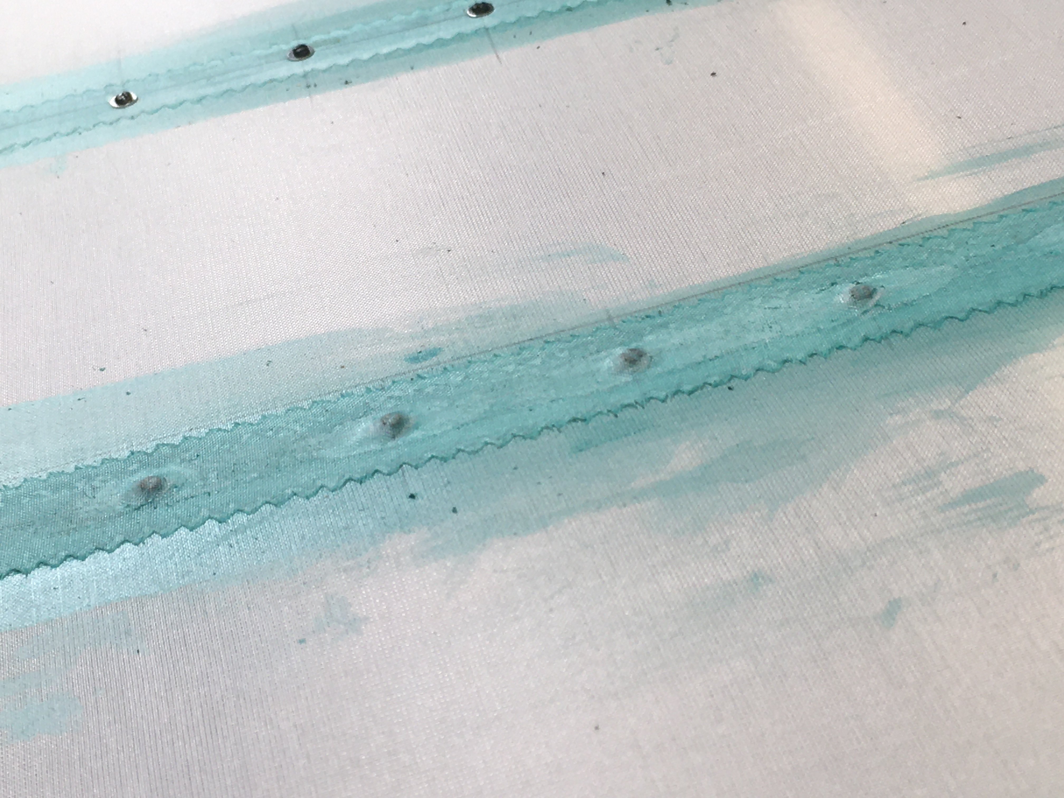

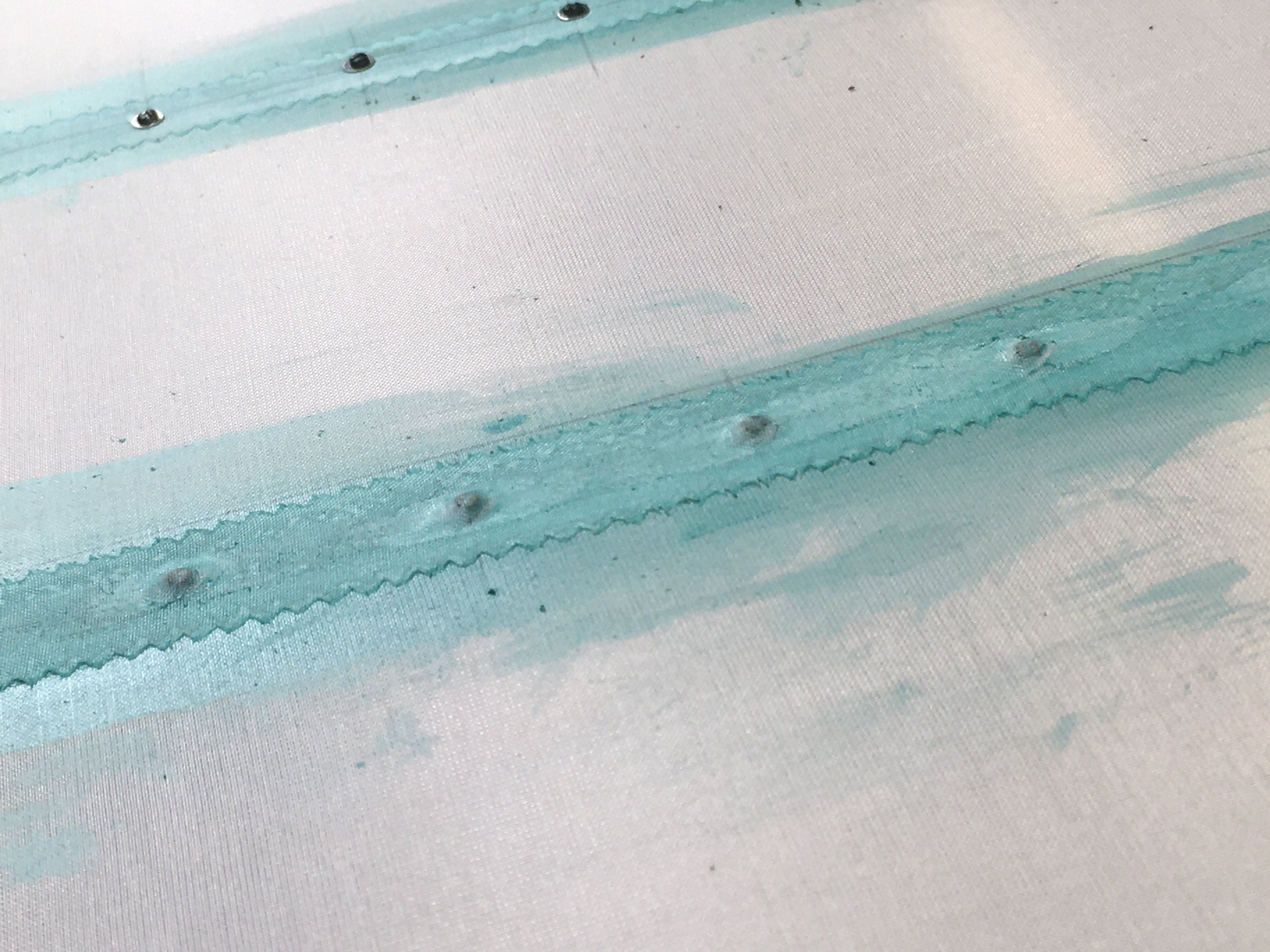

  9. The service manual states a new and simplified method of attaching the covering to the ribs is used on the Champion. 3/4" tape is laid over the fabric and ribs and fastened in place with #4 screws and washers over which 2" tape is laid.
    I used 1/2" tape, #0 pan head screws and washers, and laid 3/4" tape on top. I have about 80 screws in and a long way to go. The spacing is 1 1/8" outside the prop blast area and 7/8" in the prop blast area.
