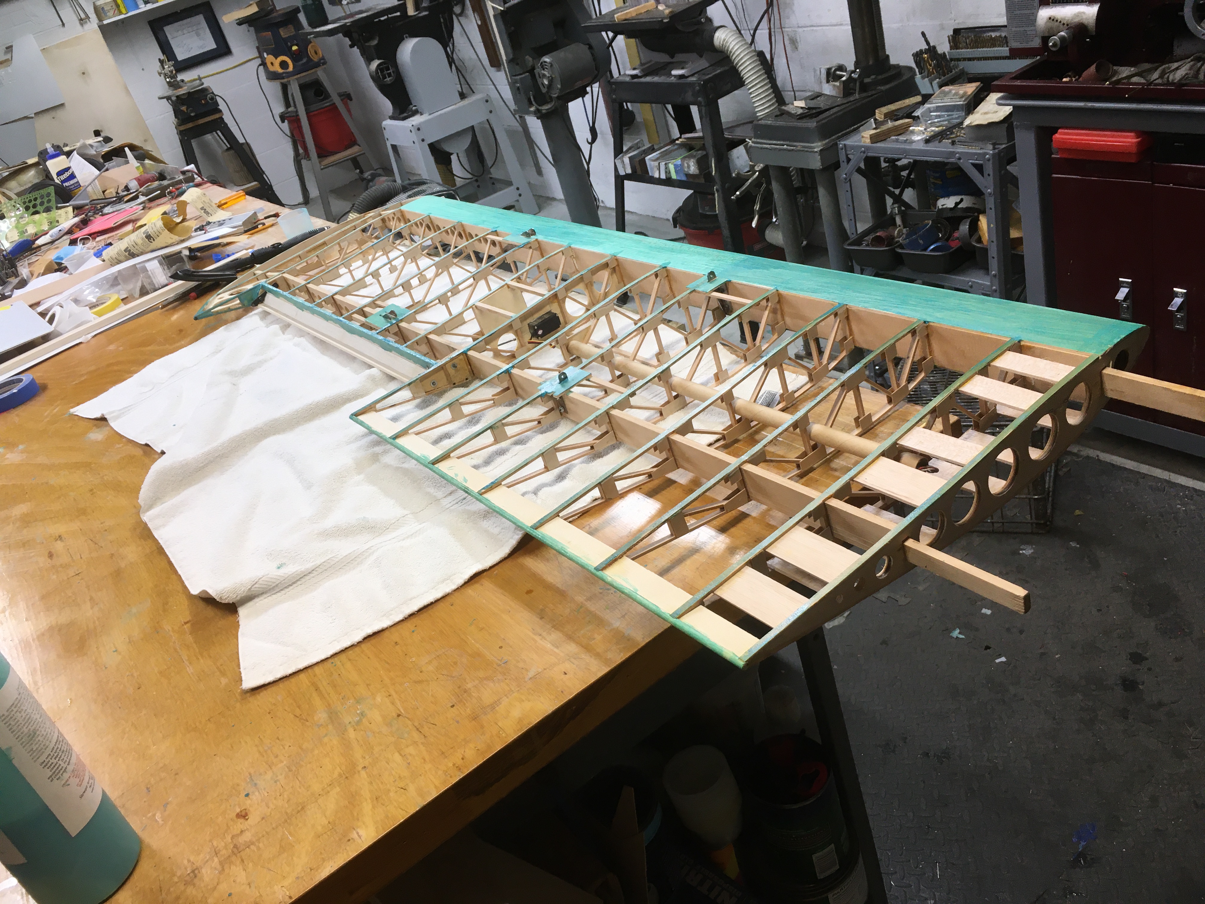

The problem areas are where several layers overlap. Consider the trailing edge, two light coats onto the edge, attach the bottom fabric, another coat of Ecobond, attach the top fabric, another light coat of Ecobond and the perimeter tape.
The Ecobond works much like Stits after the Poly Brush is on, you can use the iron to smooth out the lumps, this when the goobers appear. You know when the iron starts getting sticky and it's to hot to clean with MEK. Working with thin fabric doesn't help matters either.

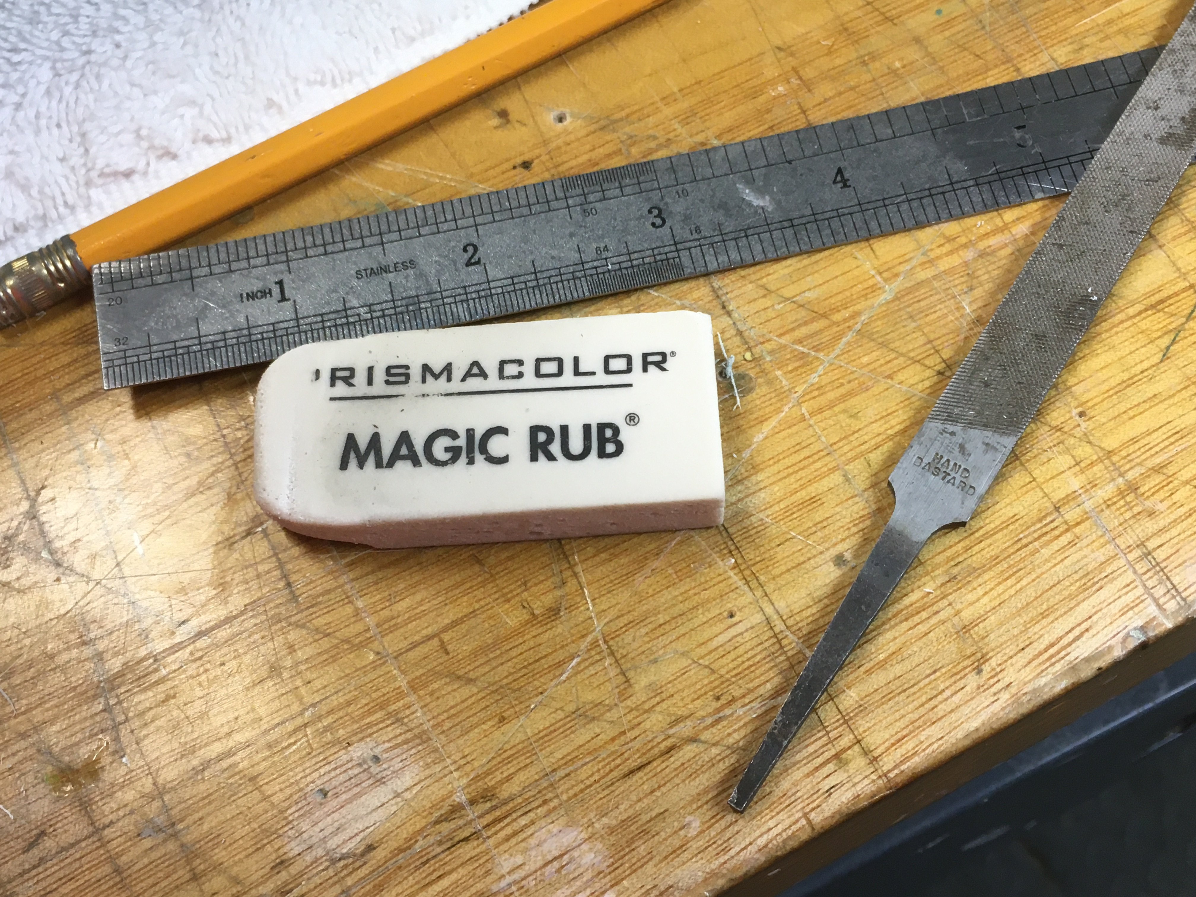

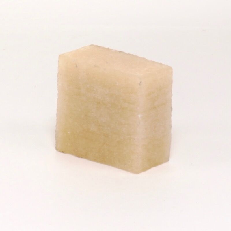

Also while surfing the Steward web site found this eraser for removing unwanted Ekobond glue. I tried the eraser on a pencil and it worked fine, I think i'll look to see what I can find at Staples, I thinking one of those soft white colored eraser will do the trick.

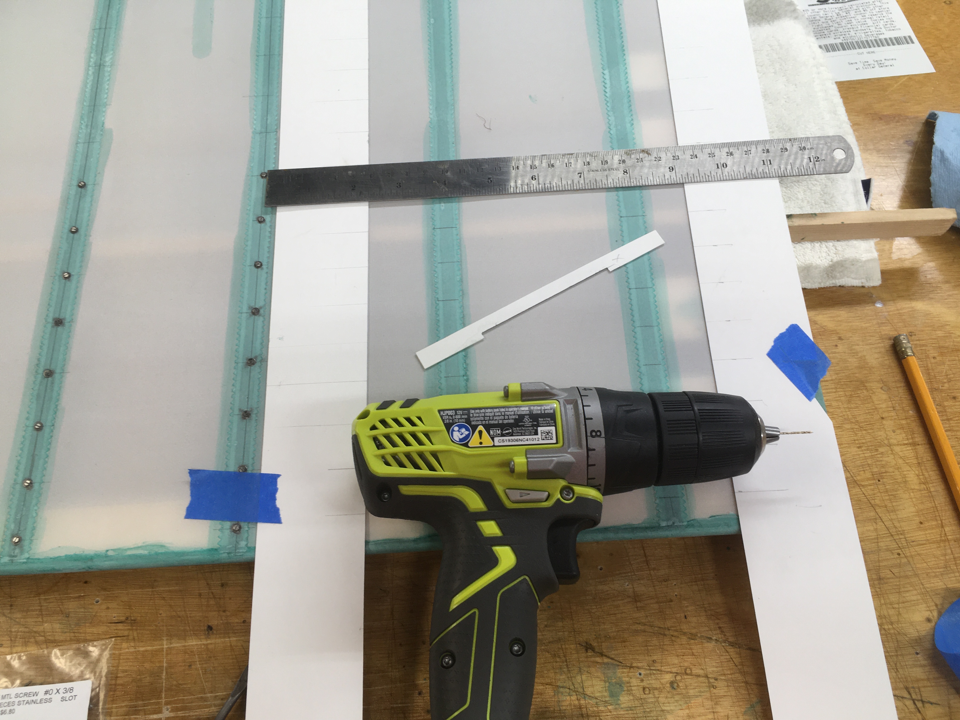

Let the screwing begin!!! Started screwing the bottom of the right wing yesterday morning. worked a few minutes here and there while the grandsons were here, 45 minutes last night and after a hour this morning finished the bottom. Found this drill at the Tanger Outlets in Myrtle Beach two weeks ago for $25.00, 12 volt LIPO battery, bought a second one just to have two batteries. It's a reconditioned but gets the job done. Just the right size for model building, really doesn't take much to drill .050" holes in 1/8'" spruce!. Made up story poles to lay out the screw spacing, one side is the 2 1/2" scale spacing and the other is the 3 1/2" scale spacing.
Did find the soft white erasers at Staples, it does work very well for removing glue goobers without damaging the fabric.

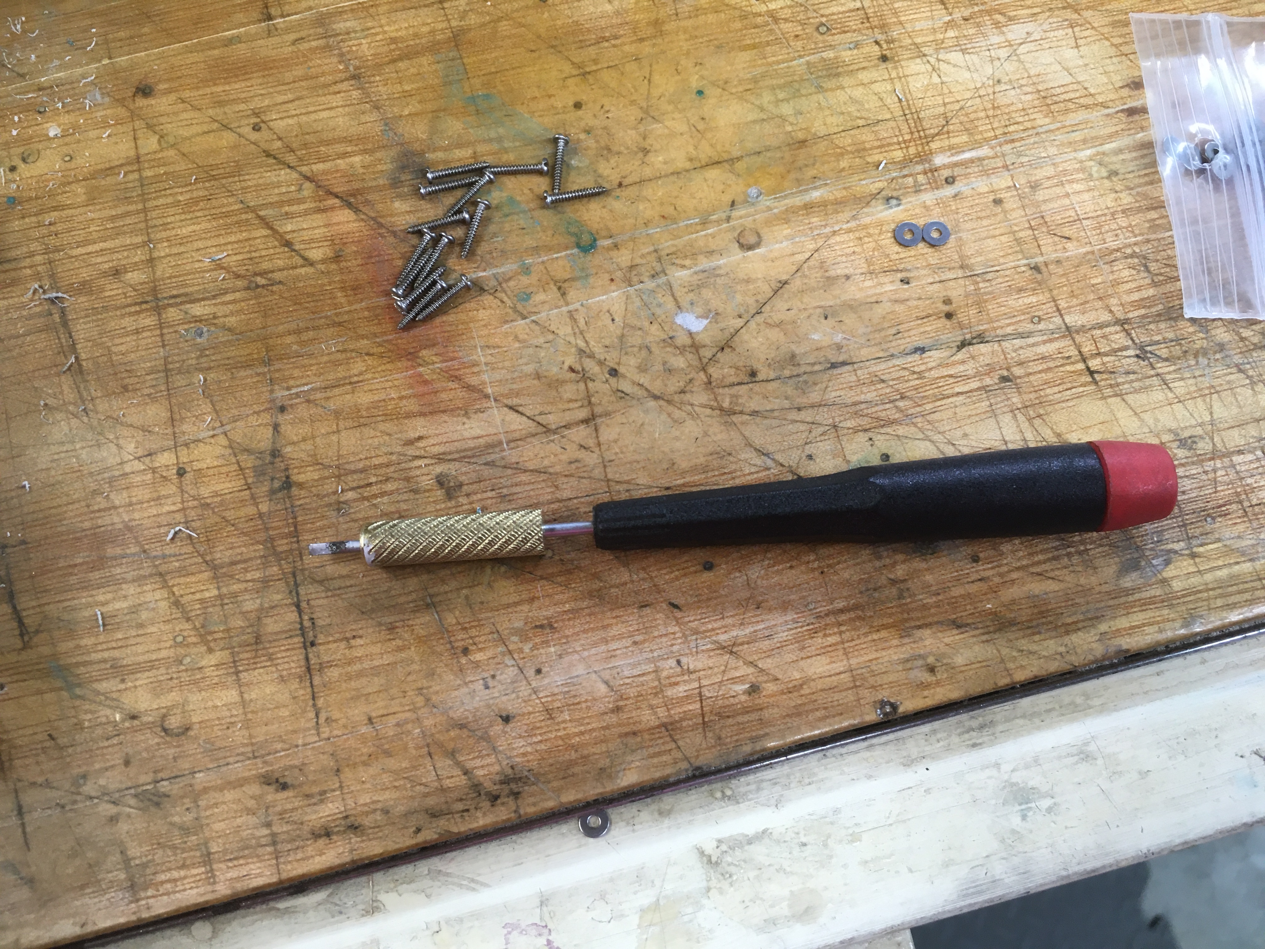

And finally I modified the screwdriver attachment, made it a little longer, made the fits a little tighter, and knurled the body. Works better now, one side to go.

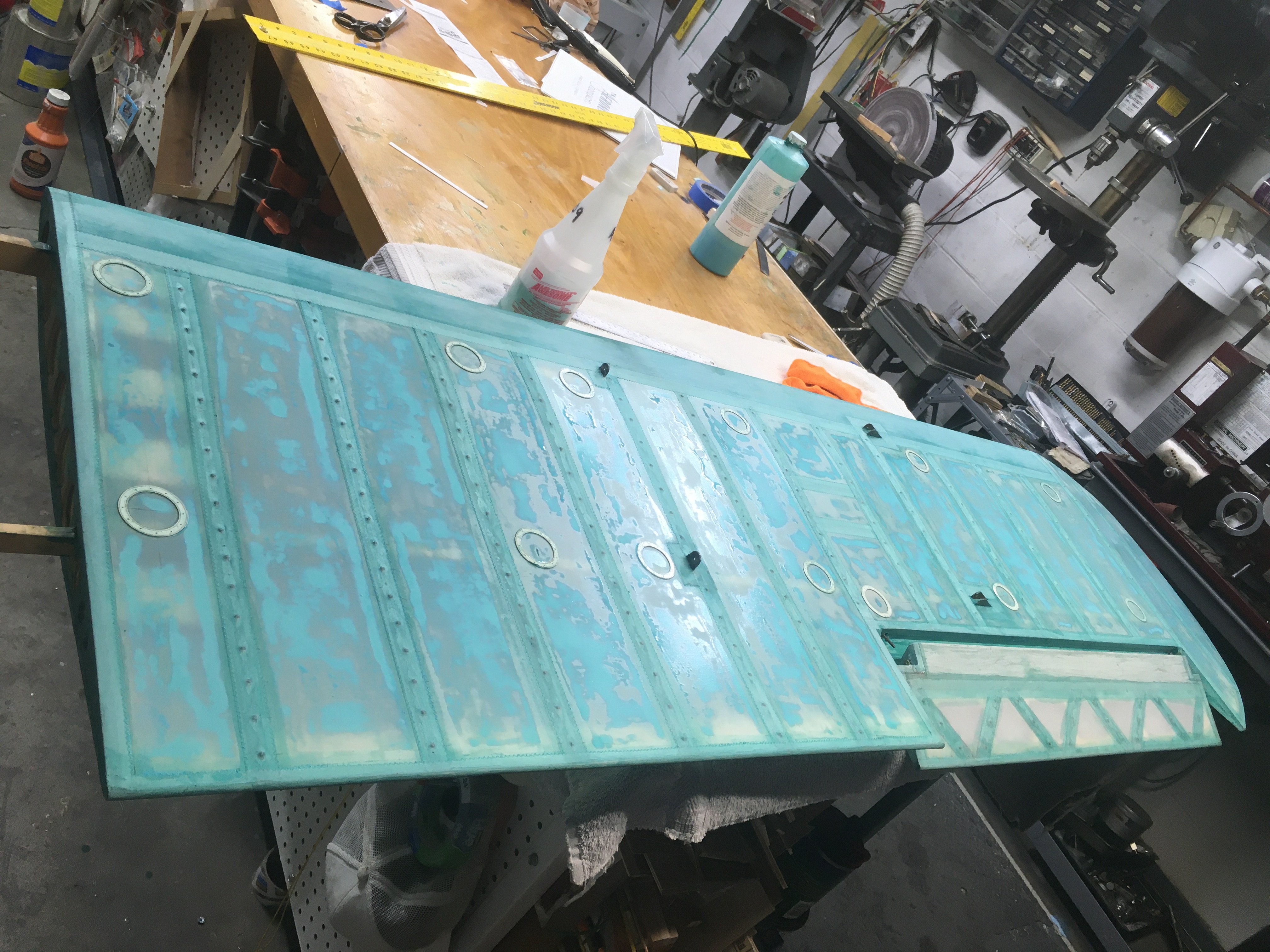

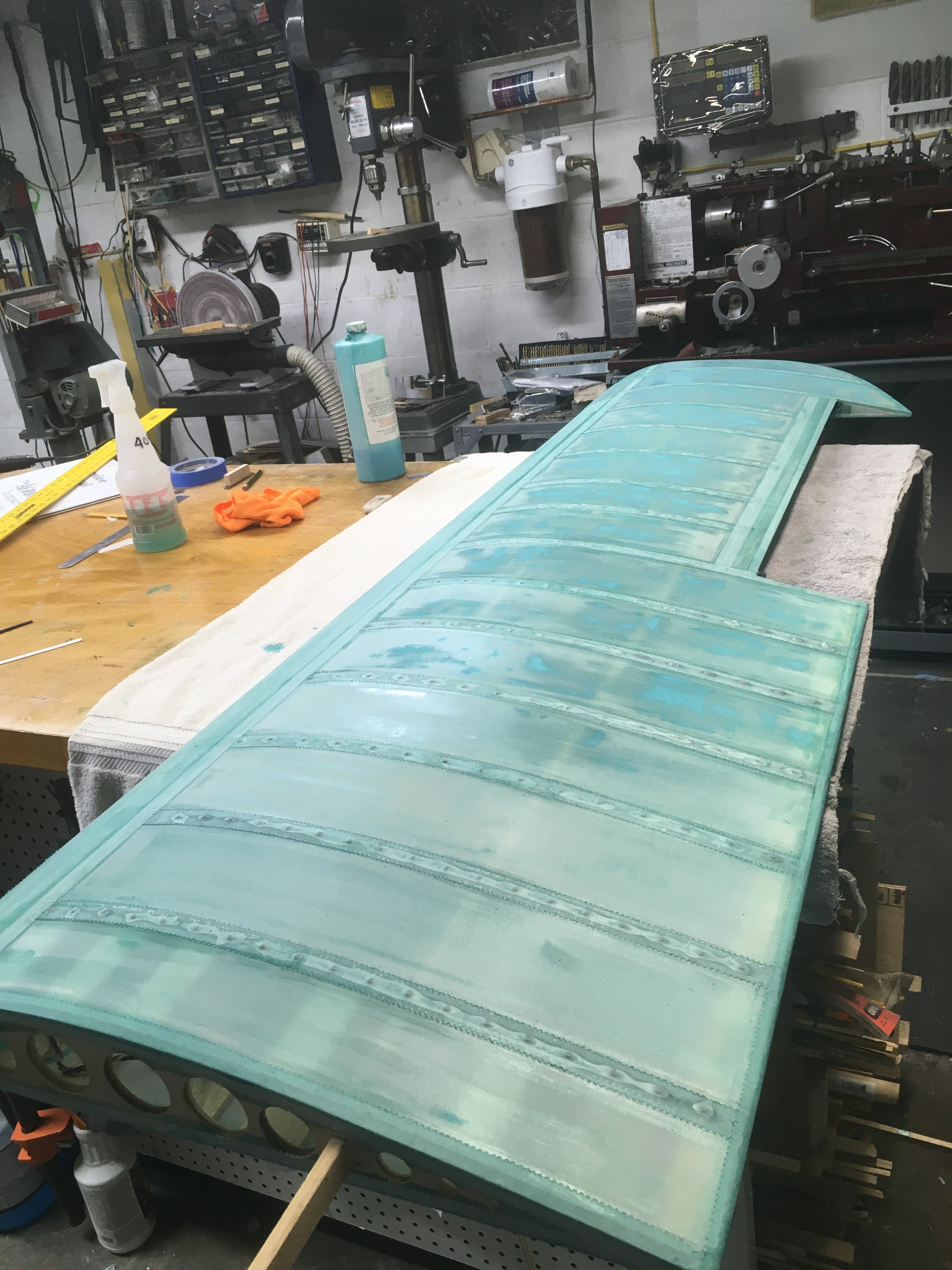

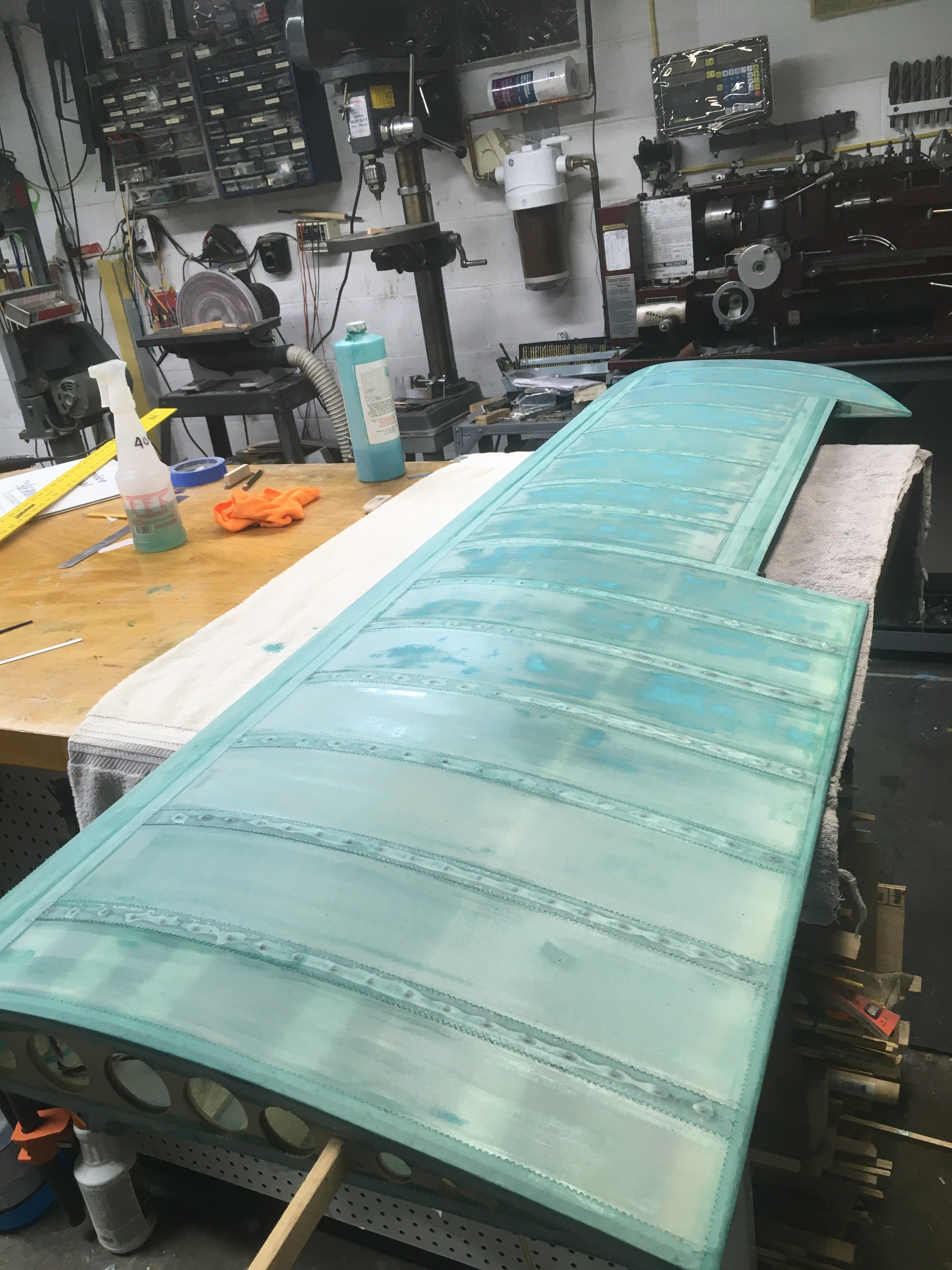

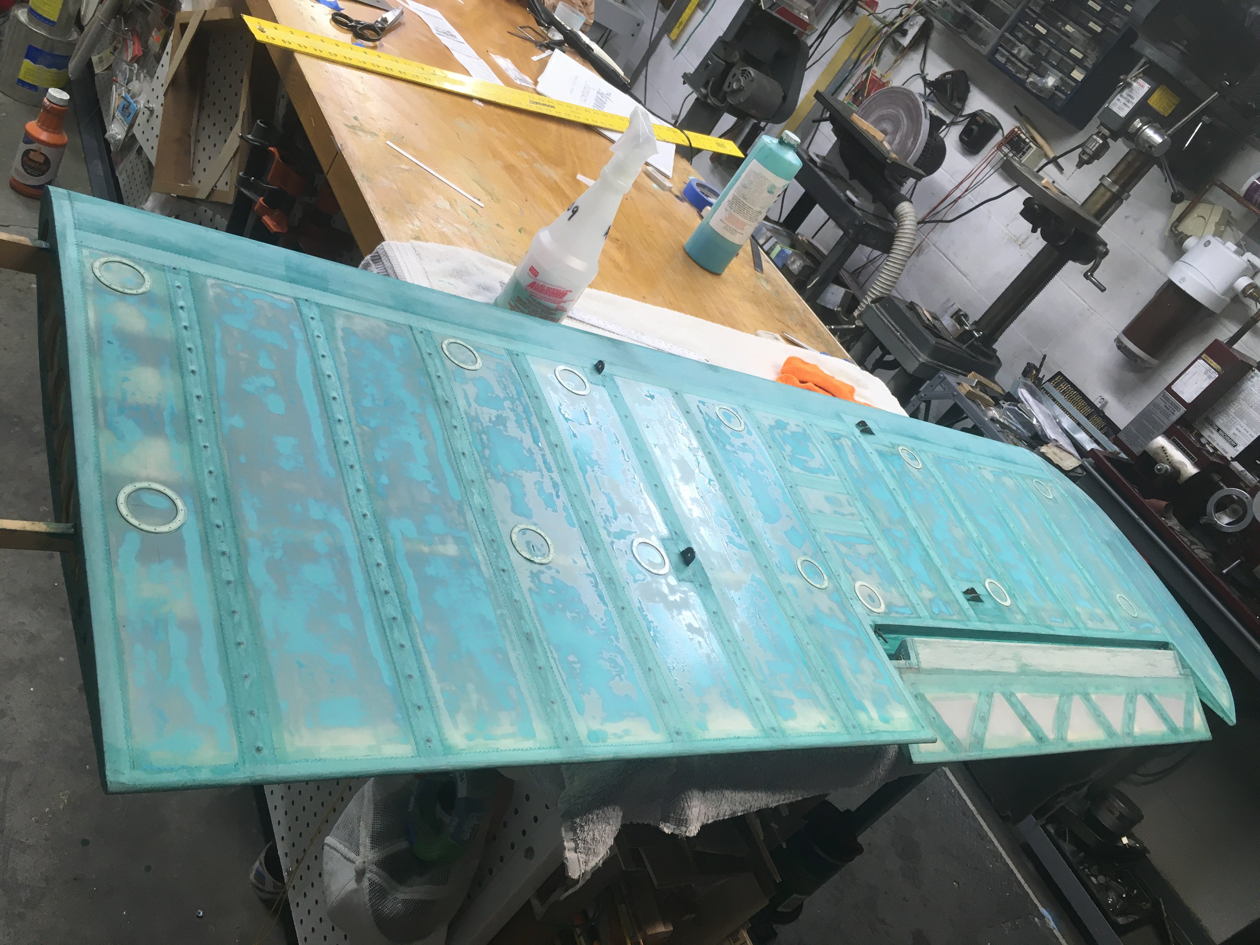

I got the right wing just about complete. The fabric weave get filled with Ecobond thinned with 25% water. After the Ecobond fill coat dries, the fabric sounds much like Monokote over the open bays, kind of a tinny sound. I put 13 inspection ring on each wing. I tried to use photos to locate the rings but there are too many variations. I used the wing drawing in the service manual and located the rings where I thought one would inspect. The rings are glued on with Ecobond. In the bottom photo, the Ecobond is still wet. I might just get the wings painted next week. Will see how the filler primer coat goes.

View attachment 115584 View attachment 115585
Looks great!! Nice work!
