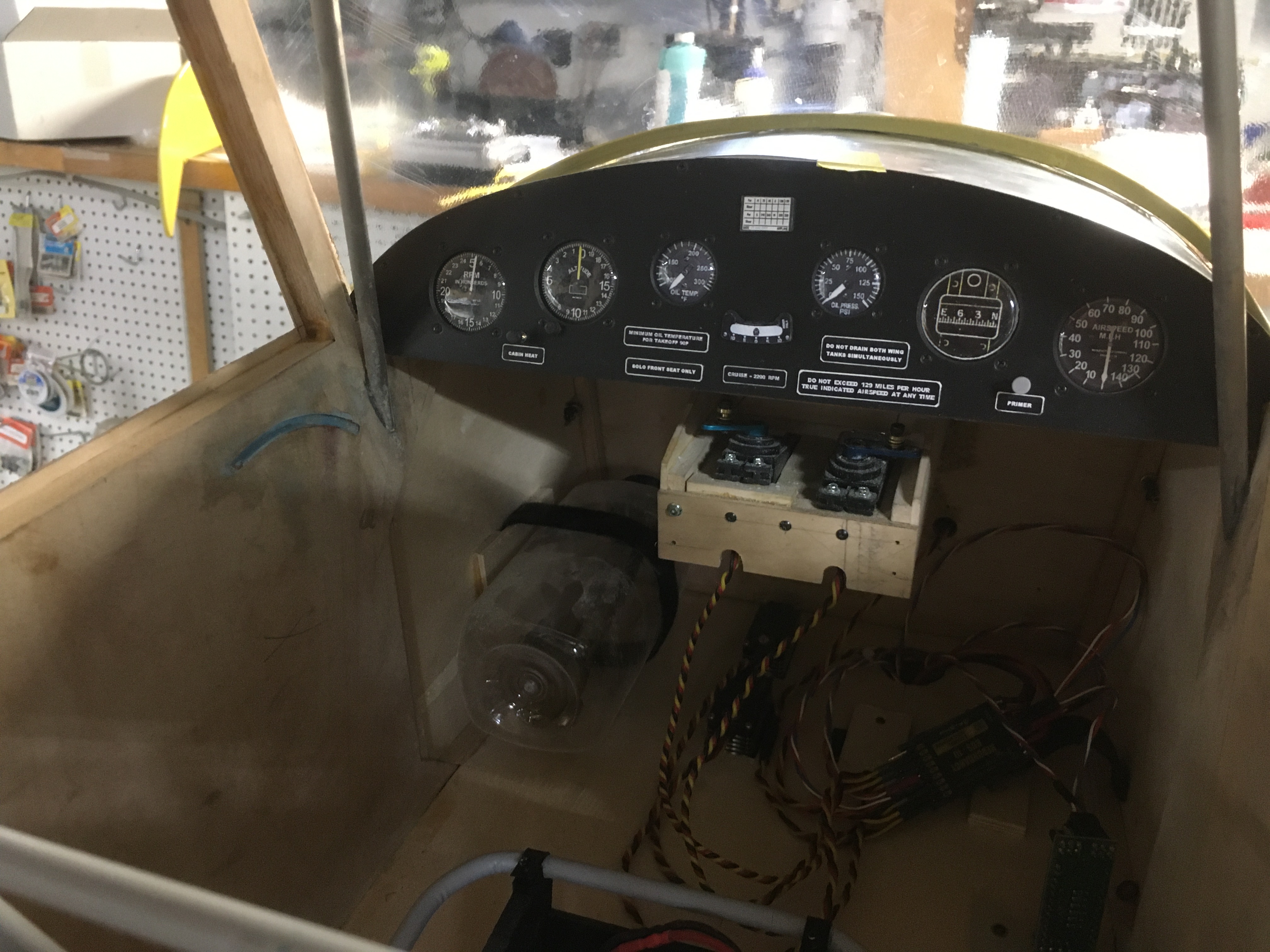

Here is a view from the front seat.

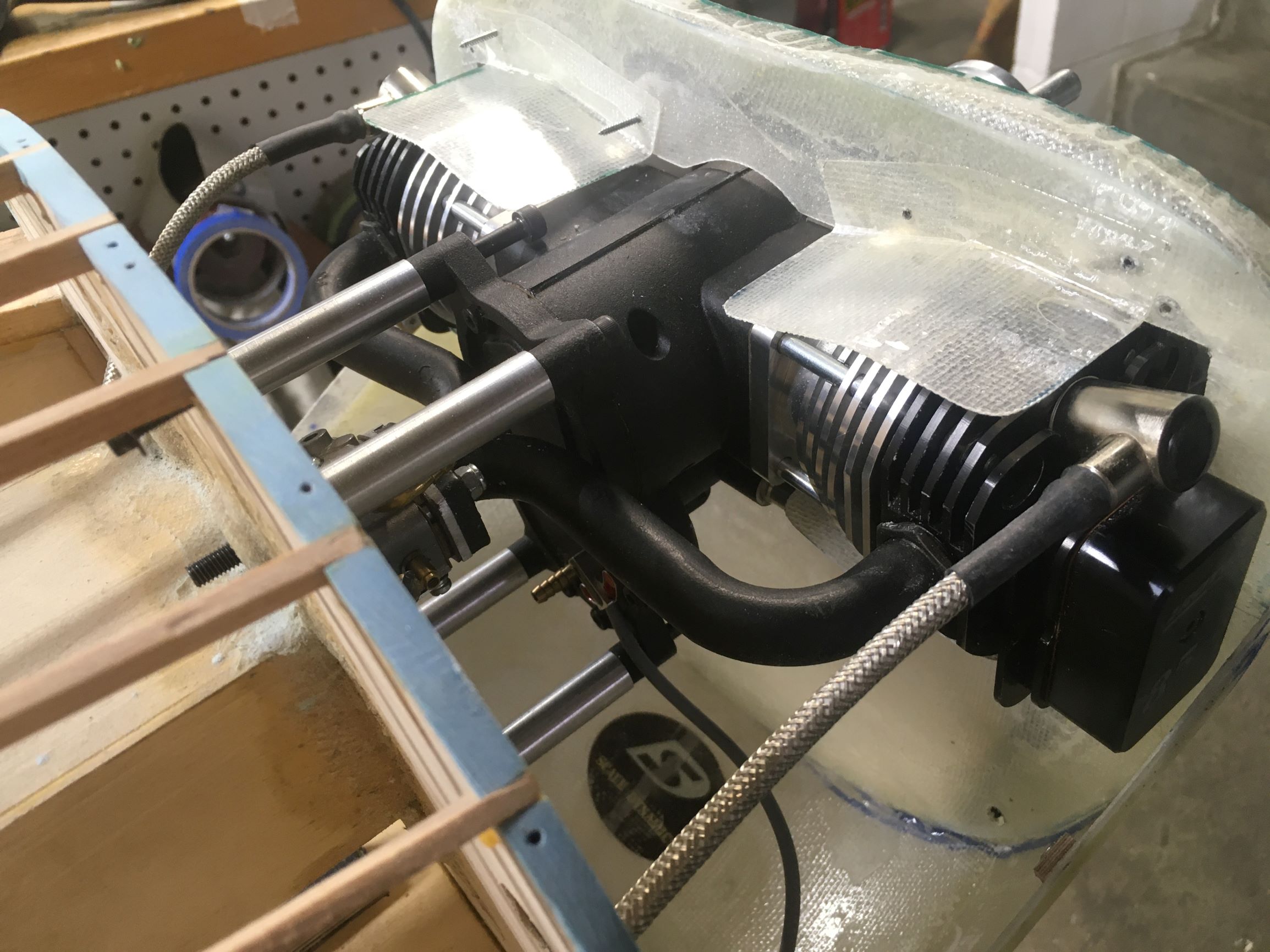

40 lbs that is getting up there if my memory serves me right were you not going to put a Roto 85 in the plane.

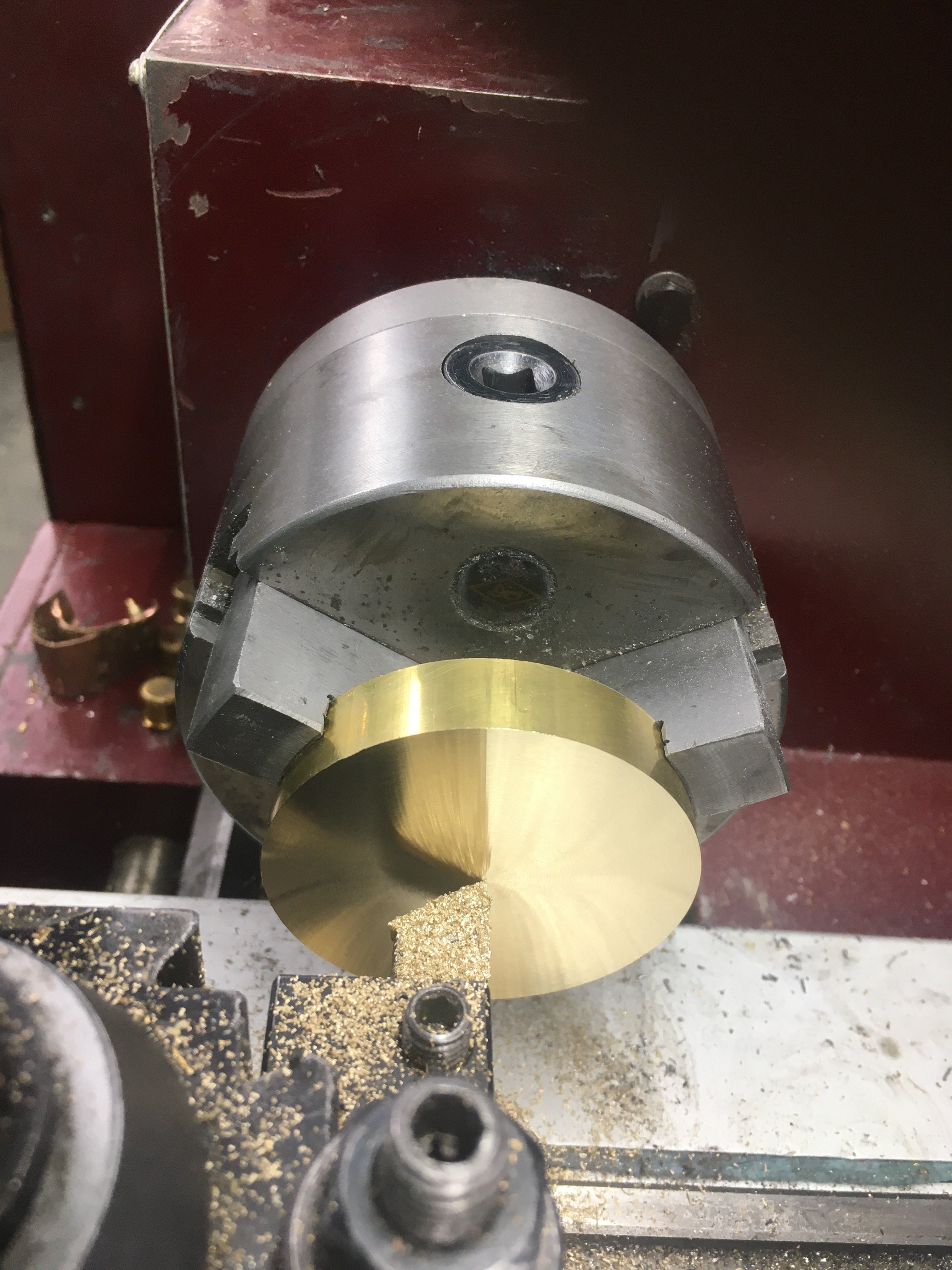

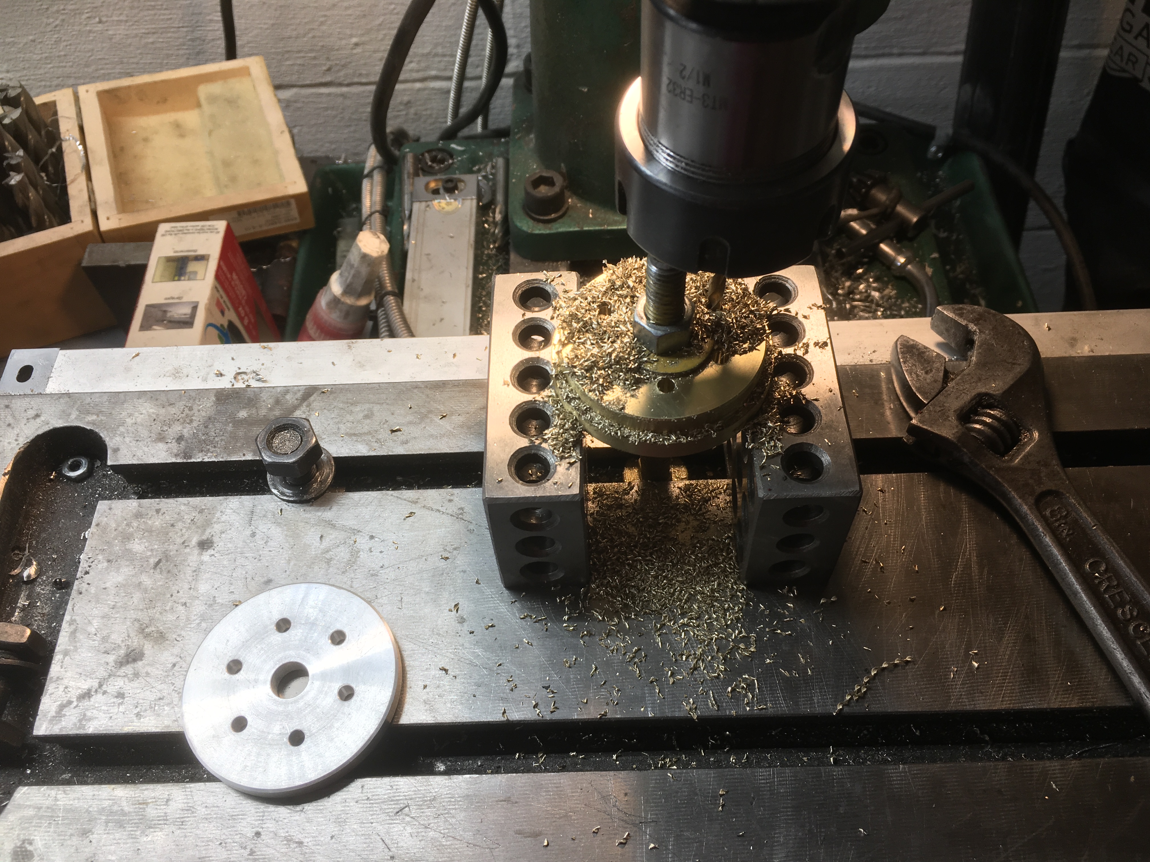

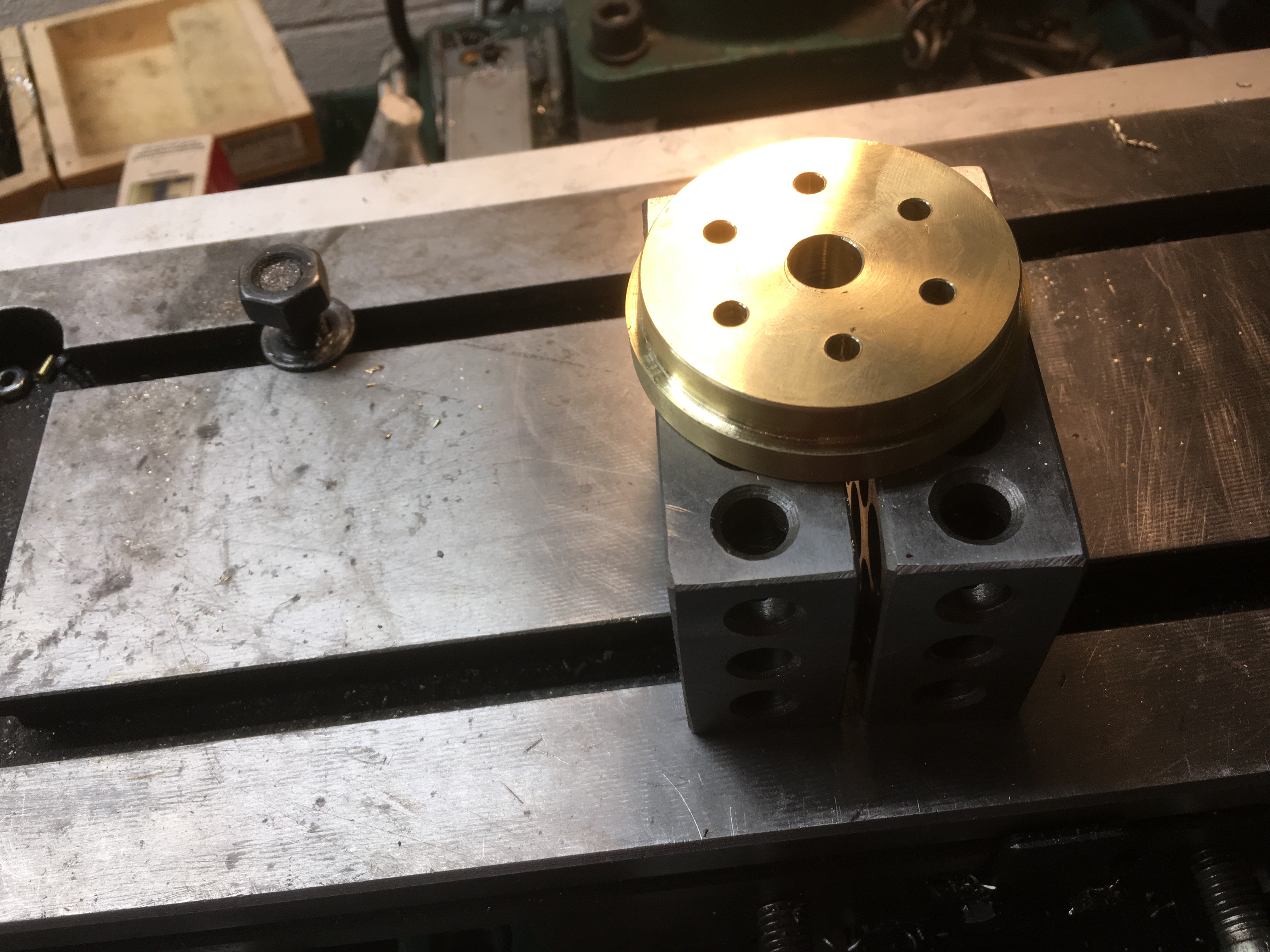

First real project where I appreciate the power crossfeed, mirror finish on the fine feed rate. 0007"/ rev. The other thing I appreciate is McMaster Carr, ordered this 2 1/2" x 1/2" brass disc yesterday afternoon, on my porch this morning. This is replacing the prop washer supplied with the Cub Hub from Tru turn. The 1/4" aluminum weights 1.5 ounces, the brass is 9 ounces right where it does the most good. It's clamped in the milling machine, once it is centered will use the DRO to drill the six holes for the bolts.

TonyHallo

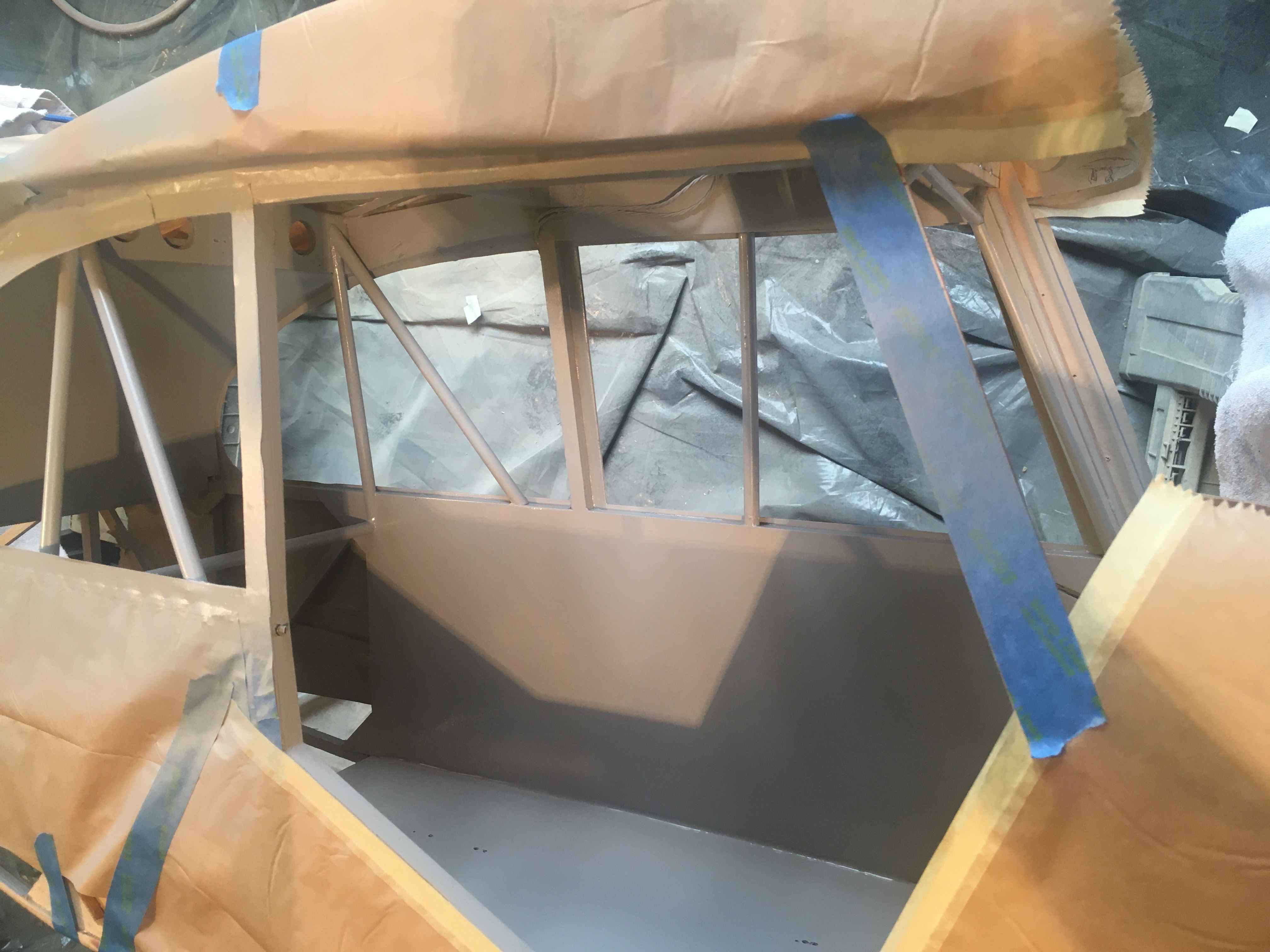

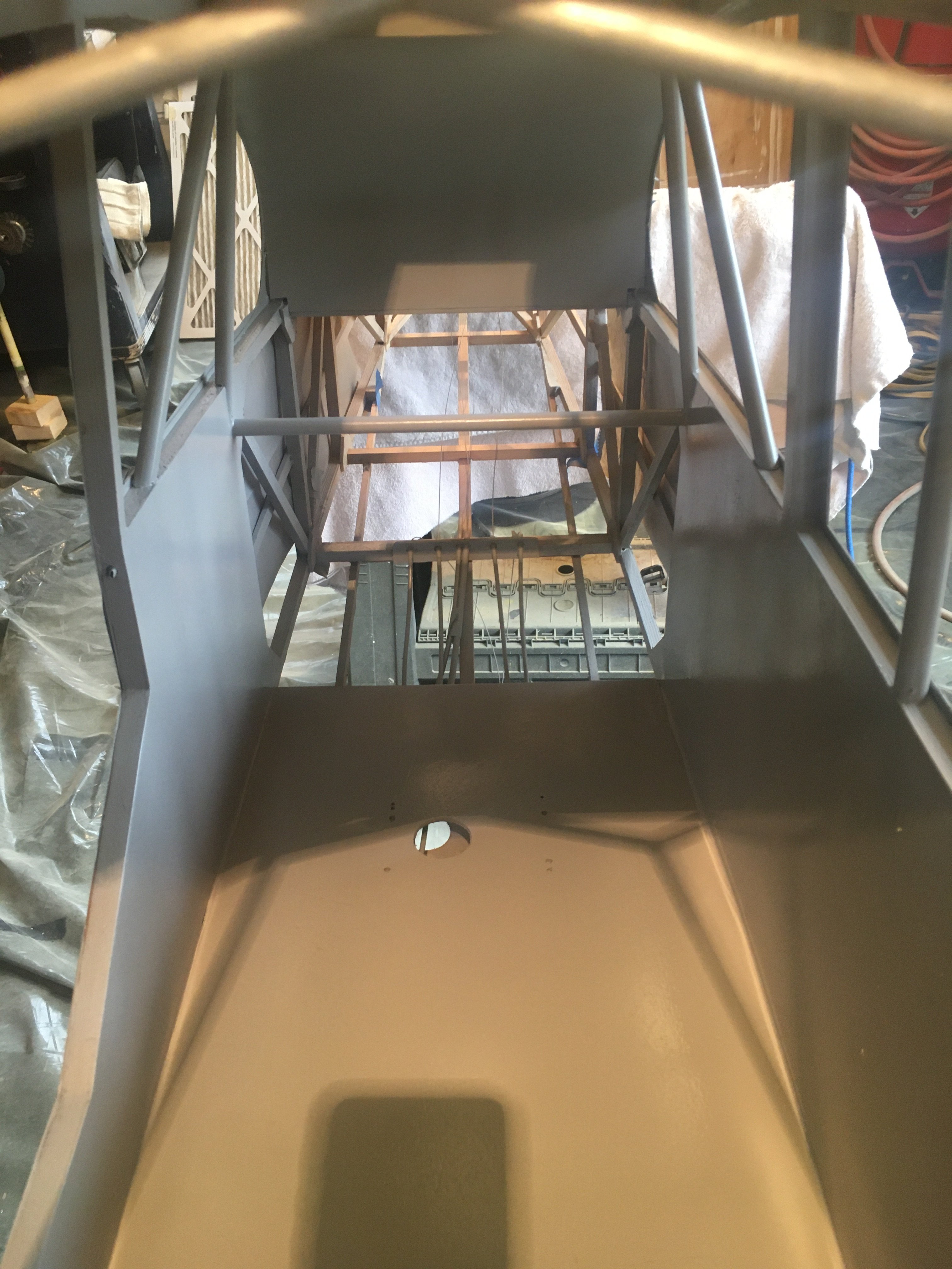

I think I looked at every Champ photo on Airliners.Net and finally decided to paint the interior light gray, I found several examples of this. Started by covering the headliner behind the rear windows with a piece of SeeTemp to finish it off, then sanded and dusted a couple of coats of Rustoleum Stone Gray spray paint. Tomorrow I hope to paint the front posts, a pillars and under the dash flat black.
