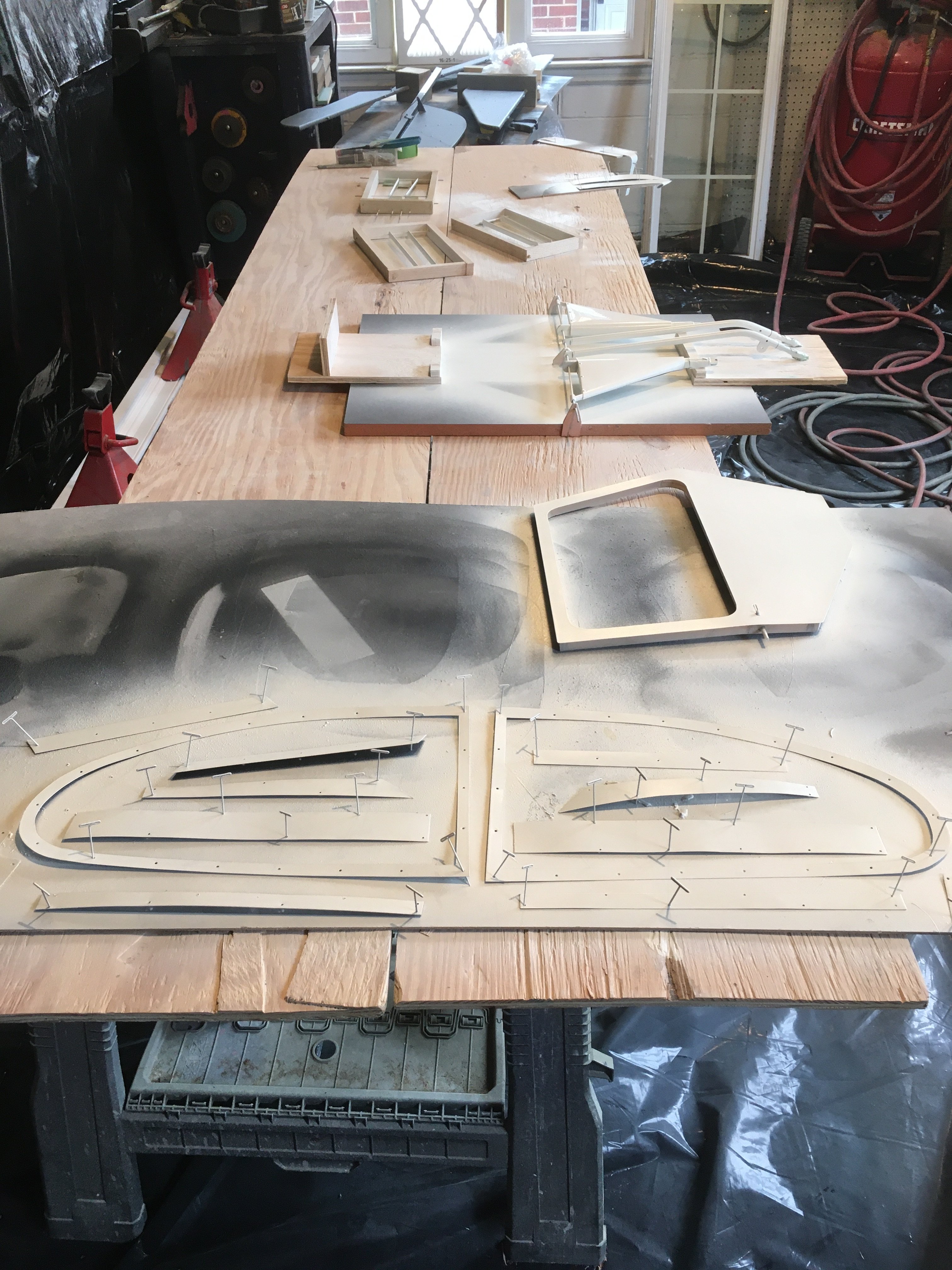

Got the aluminum parts etched and primed today with Ekopoxy, according to the manual I have 5 days to get the color on, a goal to shot for. With any luck tomorrow I will get the cowl, struts and windshield fairing sanded and primed as well as sanding the fabric parts with 320 and priming those. Color on Tuesday possibly. there's a lot of bits an pieces there.

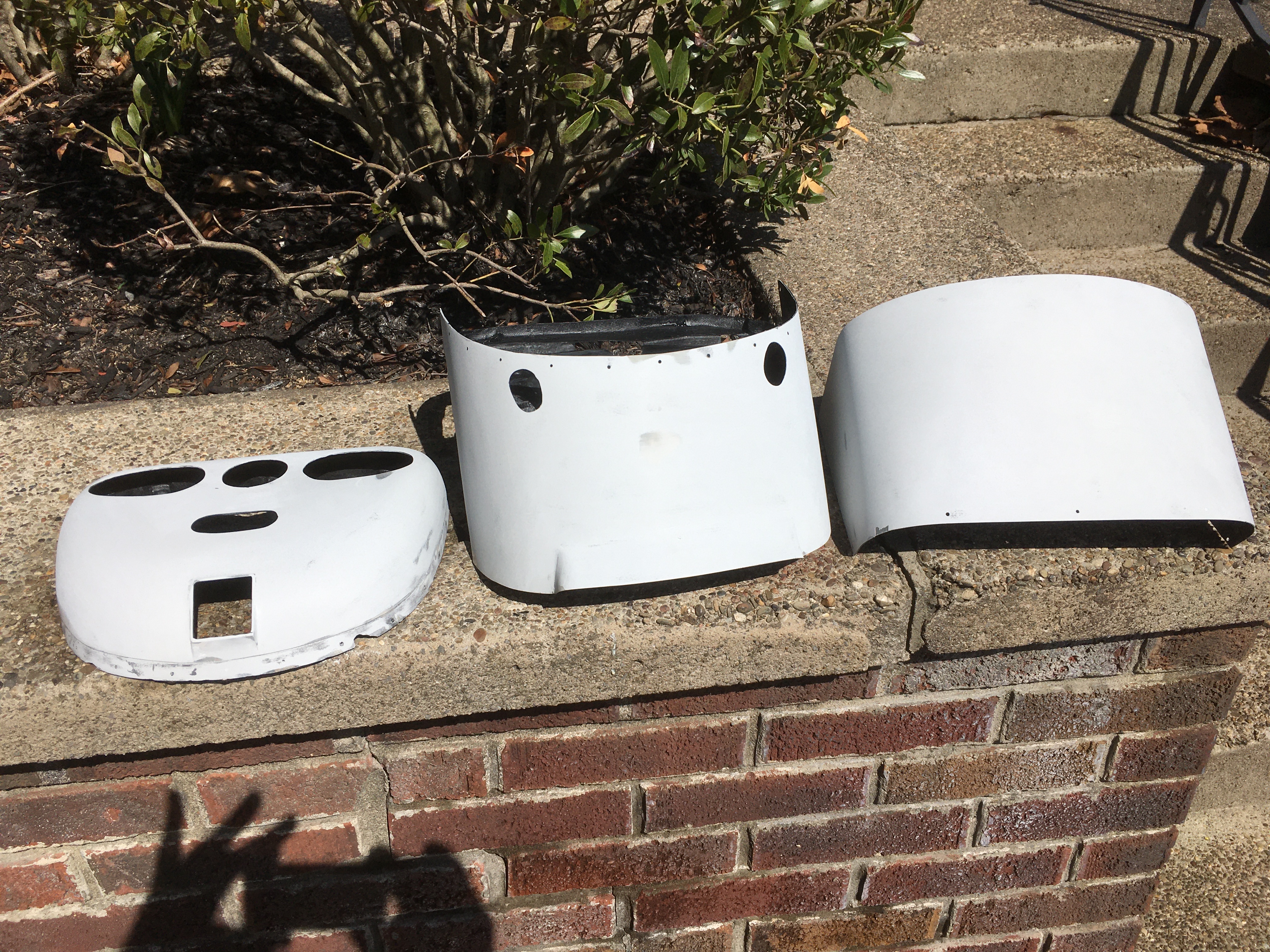

My grandson decided to nap this morning, gave me a chance to block sand the guide coat on the cowl, started with 320 and said to myself this is silly since the cowl will get a coat of white Ekoprime, switched to 220. I'm happy with the result. 45 degrees here today to cold to paint, 72 tomorrow hopefully will get the Ekoprime on the cowl, fabric parts and lift struts. Time permitting I will put the yellow on the aluminum parts too as it looks like the weather forecast for Thursday is too cold.
