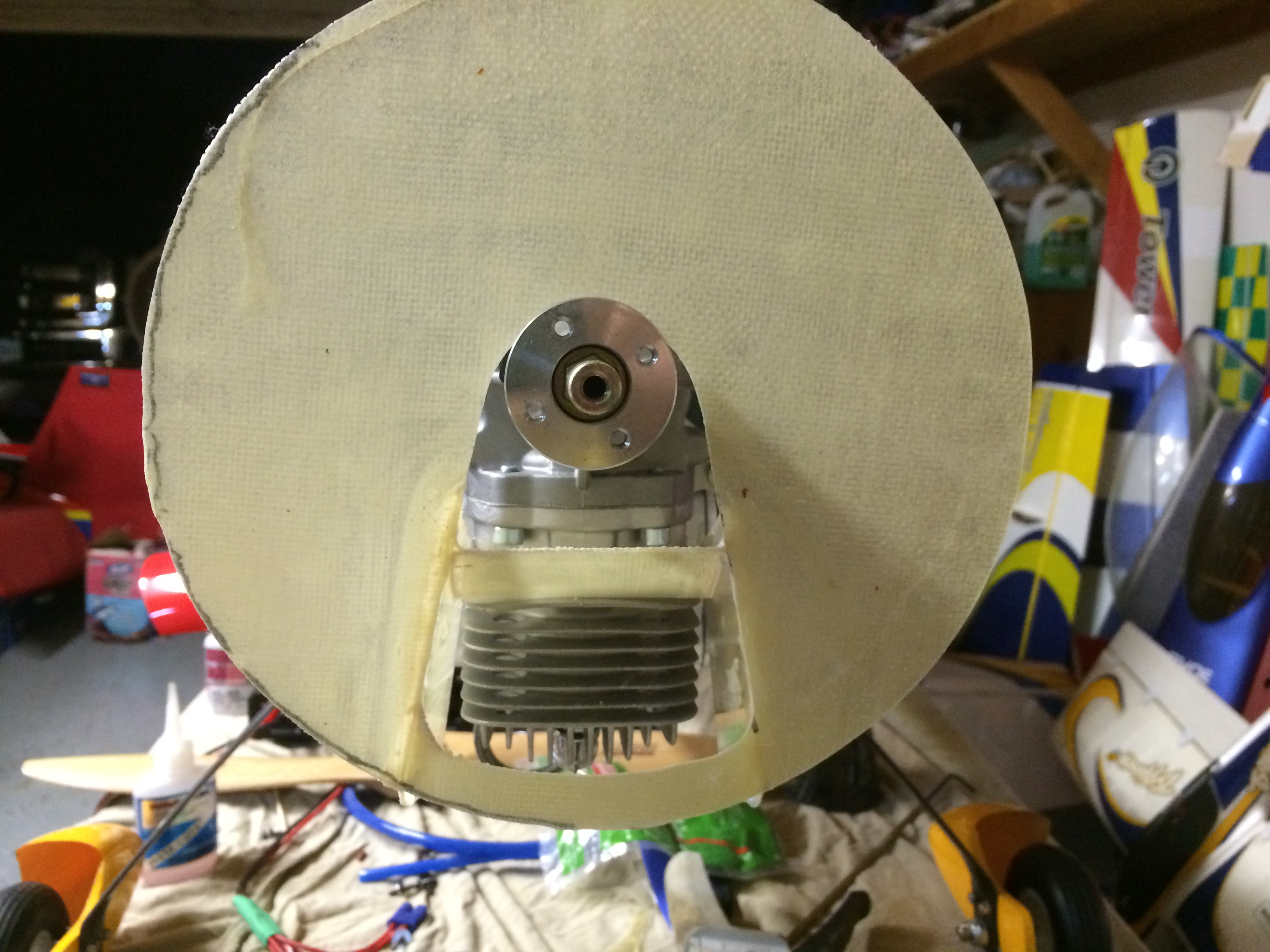

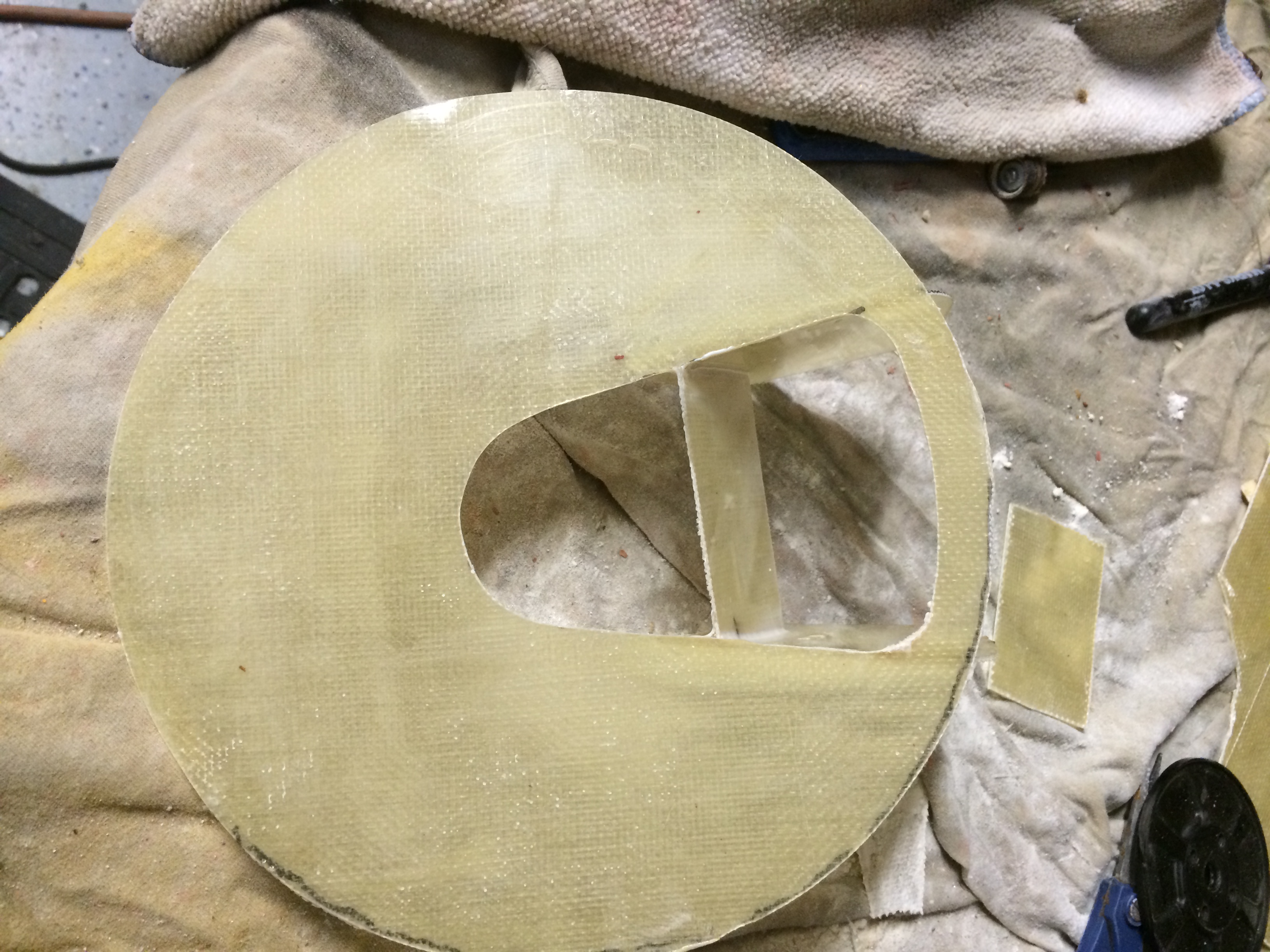

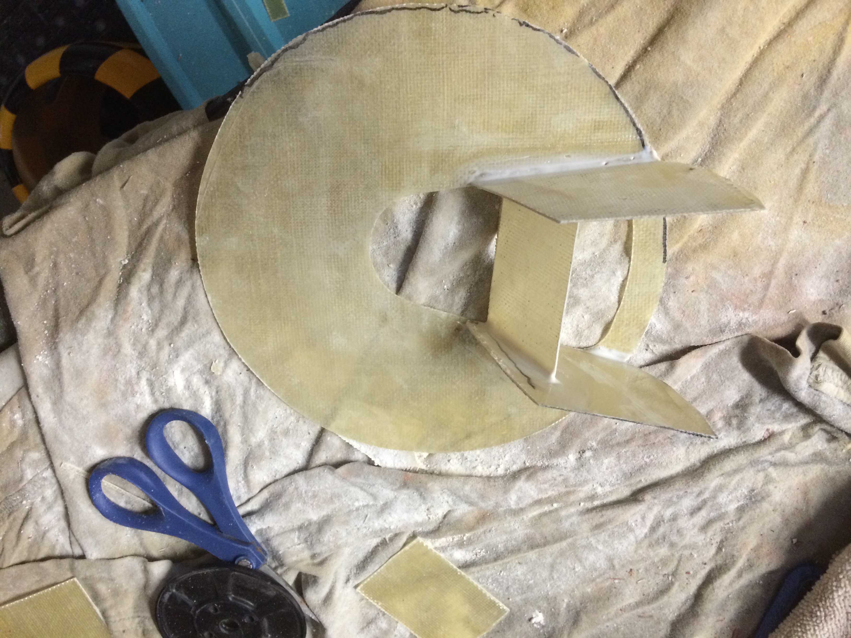

I've been working on the baffling the cowl so I can try some 3D this weekend. While flying last weekend, I never experienced any symptoms of the engine getting hot but I would rather be safe. I laid up some fiberglass on a piece of glass and allowed it to set. By laying it up on the piece of glass I get one side completely smooth which makes it easier to finish. I then cut a circle near the same size as the front opening of the cowl so it would fit against the front edge from the inside. I then tacked it into place with a little CA and marked where the cylinder opening would be. Then I took a dremel and cut the opening for the prop shaft and cylinder. I then built the sides to keep the air directed at the cylinder.
Baffling finished and installed in cowl. I will need to cut an opening for the choke rod and the two bottom cowling screws next.
View attachment 25206View attachment 25207View attachment 25208
Holy "cowl" that's some great work! Doesn't get any better than that.
