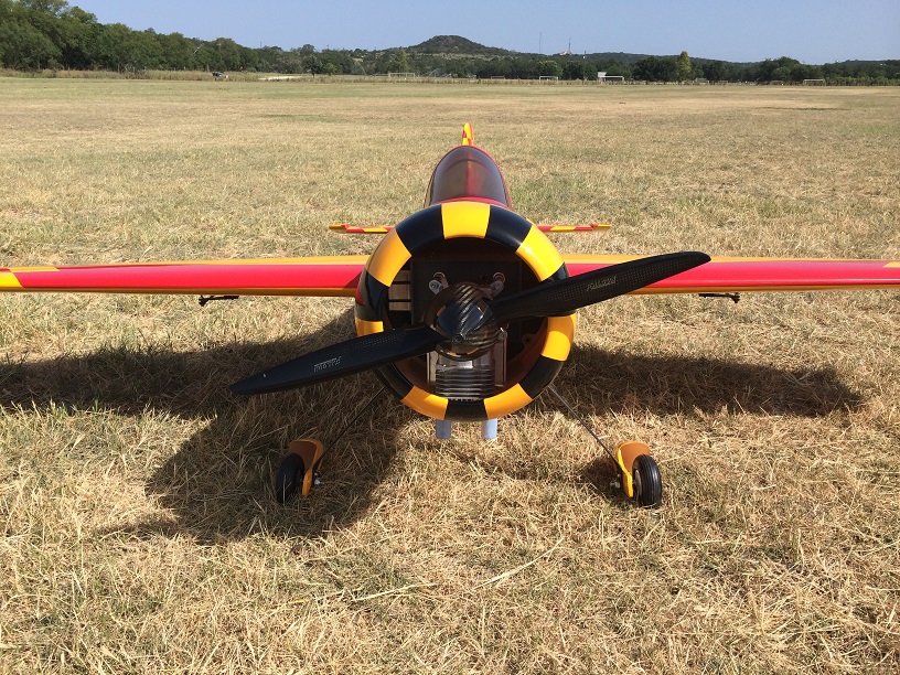

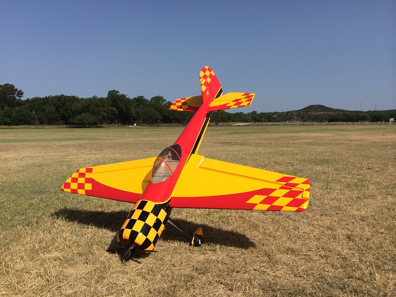

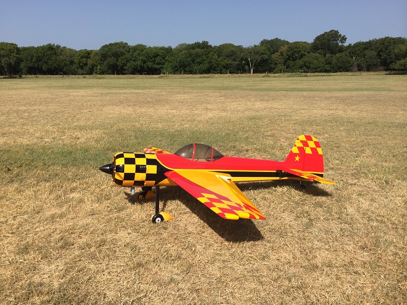

Ok everyone... Here she is
As you can see from the last picture, I did the maiden without baffling the front of the cowl. I will be adding some duct work in the cowl after the initial testing phase.
All I can say is WOW! The initial CG location was 6" from the LE at the root and she flew hands off requiring absolutely zero trim! The DLE 35 was plenty of power and pulled the Redwing Yak 55 skyward like a homesick angel. I did the 45 degree CG test and she tracked straight slowly falling to the canopy. Next was knife edge flight. I completed a pass from right to left and found a slight pull to the landing gear, same was observed when I performed a pass from left to right. I will add a mix to mix this out but it is not bad. I performed some sportsman IMAC maneuvers and found that the yak tracked straight as an arrow. I was really impressed with how well the plane performed these maneuvers. It felt like I was flying a much larger plane and the Yak also presents well in the air. I would definitely recommend the Redwing Yak 55 to someone wanting to get started in IMAC on a budget!
After about a 7 minute flight, I decided to land. No bad habits here as she penetrated nicely, even with the big round cowl, and settled gently into a 3 point stance and touched down gently.
