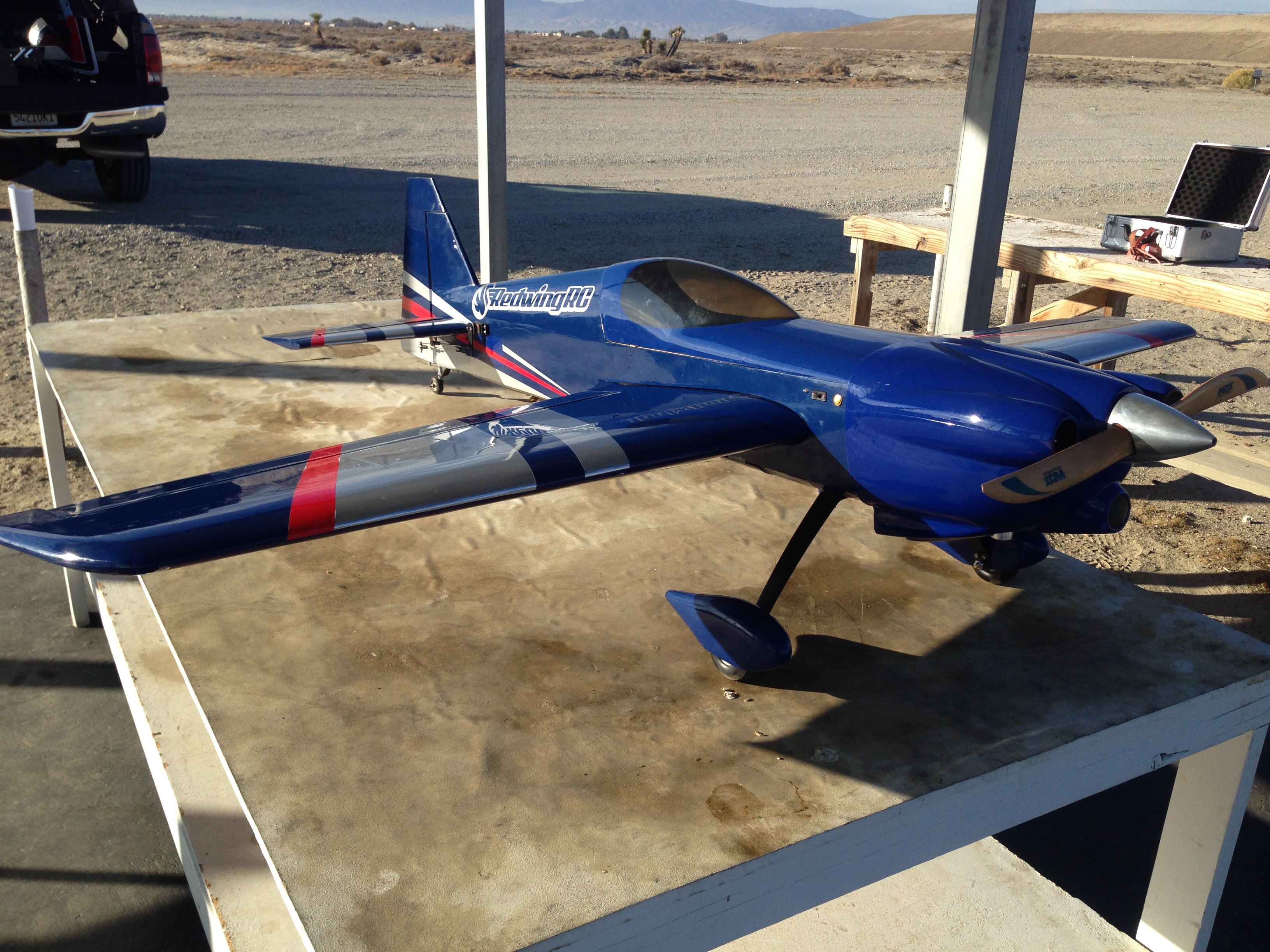

I flew this today. It has a Syassa 30cc and 18X5.5 prop. After flying it, I'm thinking a 16X10 prop will really speed things up a bit. :tongue:

If the sysssa is anywhere close to the DLE in power, throw a 19x8 or 18x10 on there. !6x10 will not be enough load on the engine.
G
With the 18X5.5 I get 8150 RPM. This is an amazing American motor. I was just thinking how fast can I make this plane go?:popcorn: I'm going to talk to Sysaa this week and see what he recommends.

Cool, please let us know what you do. I've seen the Syssa in pics and it looks beautiful.
Hopefully you can try an 18x10, that'll really cook. My DLE 30 with a falcon carbon fiber 19x8 was taching 8000 on the ground today.
cardenflyer
Any flight pics? I'm with Gary on the 16x10. Seems way to small. Even my old G38 turns an 18x8 and they aren't anything like the new 30s. For speed, maybe like a 16x12, 17x10 or 17x12. Landing might be a little tricky on a calm day though!
