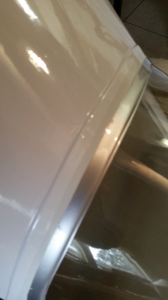

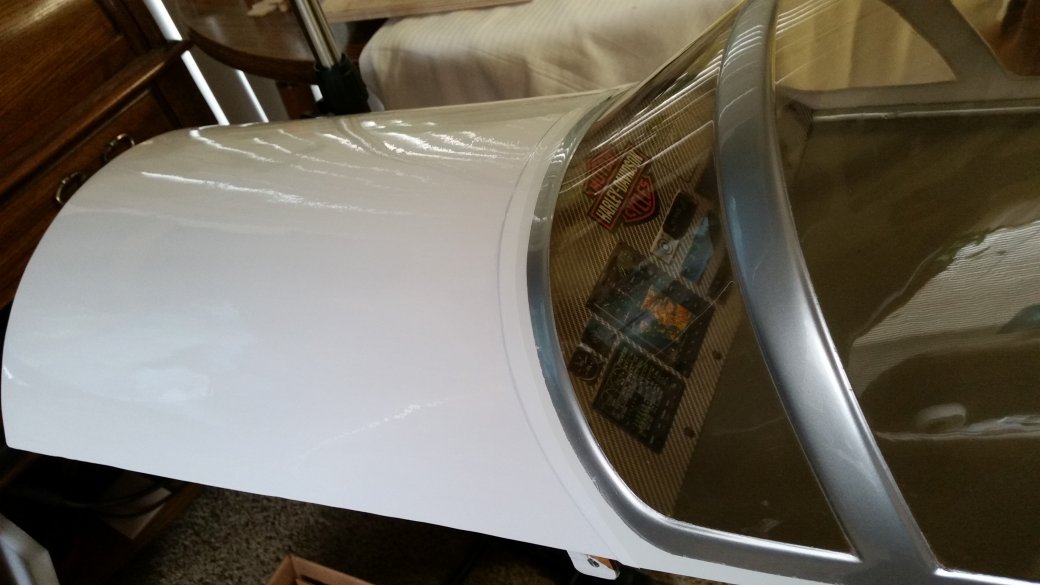

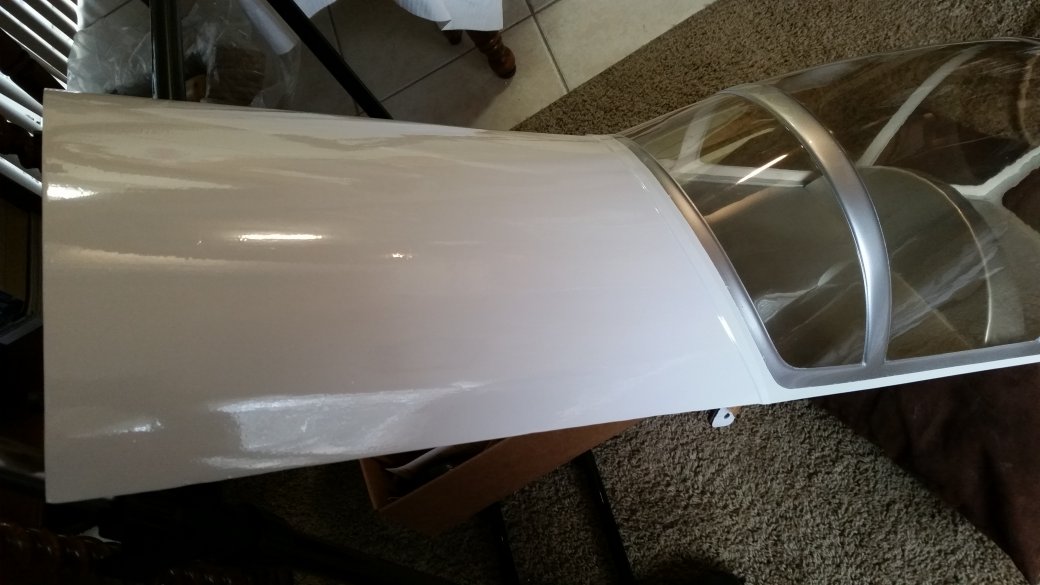

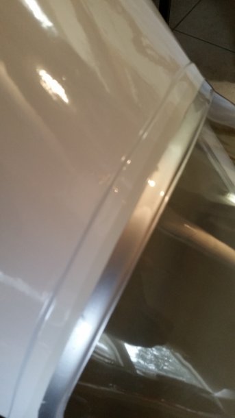

Thanks Kelly. Not terribly difficult. First cut the "arch" that will overlap the canopy, in the same arc as the front lip of the canopy. Next, lay the arch of the covering on top of the lip giving yourself at least an eighth of an inch overlap. Use your "trim" tool on low heat starting in the middle of the canopy lip. Ultracote adheres really quick to painted plastic, so it really doesn't take much to get it in place. Low heat with the trim tool all along the lip. Turn heat to high and gently heat/push the covering into place on the balsa sheeted hatch. Once you have an inch bordering the lip of the canopy, you can now go to your covering iron. I set mine at about medium heat and use my heat gun to lay the rest of the hatch.Rob.....How the hell did you get that canopy line PERFECT!? Most other ARF's dweeb out and paint the whole thing. But you managed to do it even better than Pilot!

Or were you referring to the paint line? I think I misunderstood.Rob.....How the hell did you get that canopy line PERFECT!? Most other ARF's dweeb out and paint the whole thing. But you managed to do it even better than Pilot!

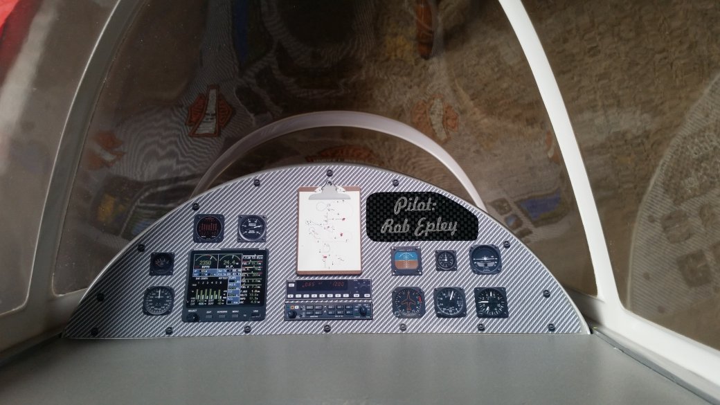

WOW! Just Beautiful!I'm now absolutely positive I want to cover another Pilot canopy / hatch, NEVER! Although it came out good, I now have a massive migraine. Lol.View attachment 48592 View attachment 48593 View attachment 48594I also added a "selfie" bling to the cockpit panel.

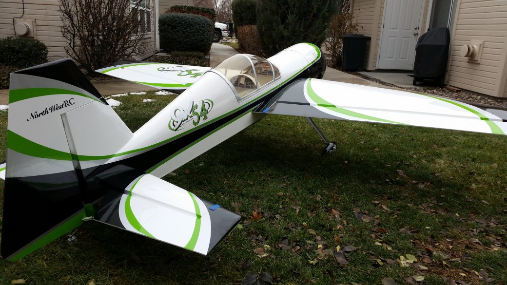

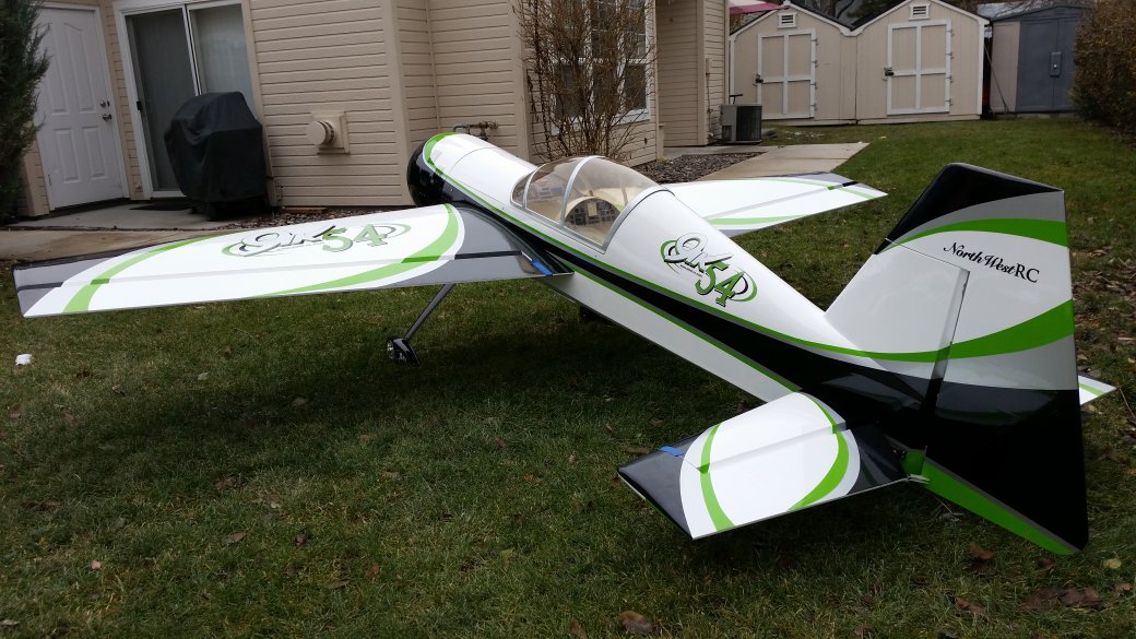

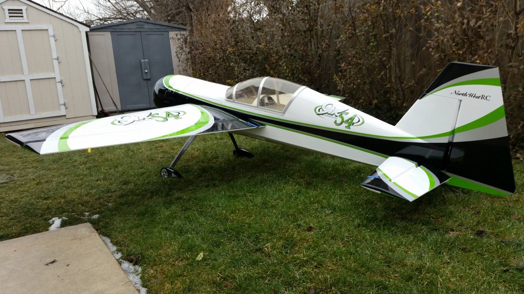

So my friends, I'm just too anxious to wait. How about a couple of teasers?
View attachment 48596 View attachment 48597
From what it was, to this...
All that is left is to freshen up the Red Aero pilot bust. And then...? And then the beautiful multiple red head installation.
