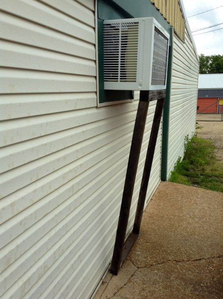

I've been debating this all night and today. I have an alternate idea for how to support the back end of the unit.
I plan to add a lean-to on the back side of this building for my trailer/lawn equipment/atv. It will have doors on each side. so putting a post in the ground or even angled brackets below the unit would create even less space. I'm thinking of placing a plank of iron or wood under the unit and using chain with eye hooks to the beam above the unit. This way nothing is in my way and the unit is supported. I'm not concerned about drilling into the structure....there are already 10000s of screws holding the tin to the wood frame already. I'll caulk up any new holes.
Here's what I did on the A/C at the pawnshop. It works great and is mostly out of the way since it angles back into the wall.

In your picture....is there any boards from the window to the end of unit or did you just attach the 2x4s to the back of the unit with nothing more underneath from window to the end?
Hey...I take offense to that!
No boards under the unit itself. The front half is sitting on the wall. Then I attatched the back of the case to the brace by screwing it down to the brace from inside the case. Then I slid the unit into the case. Does that make sense? Hard to explain.:p
