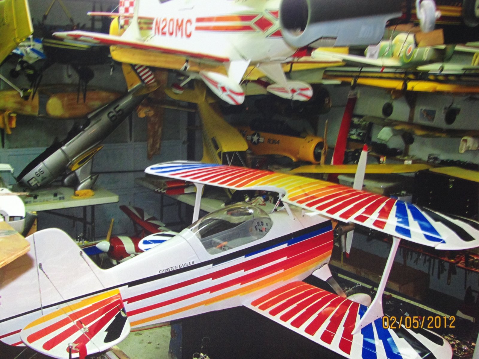

Billy J
Very
How cool would this be...........
Very very cool. I had a 3w 100 in her 3 5200 lithos 8 8411 JR no lead added pure energy !!!!

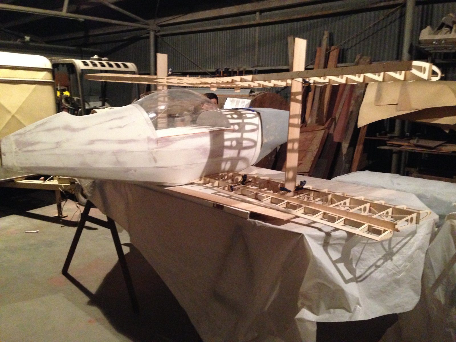

Billy J
Eagle wins always. Please push me to finish up!! 50% plug. Finally get wings near the fuse next is to incident bottom wing pockets and pipe for plug ! It's for from perfect but looking super cool with that 120" challenger Top wing

Now, a question for the Pitts line lovers. Does the Christen Eagle have a standard S2 fuse or is it totally different?
Billy J
