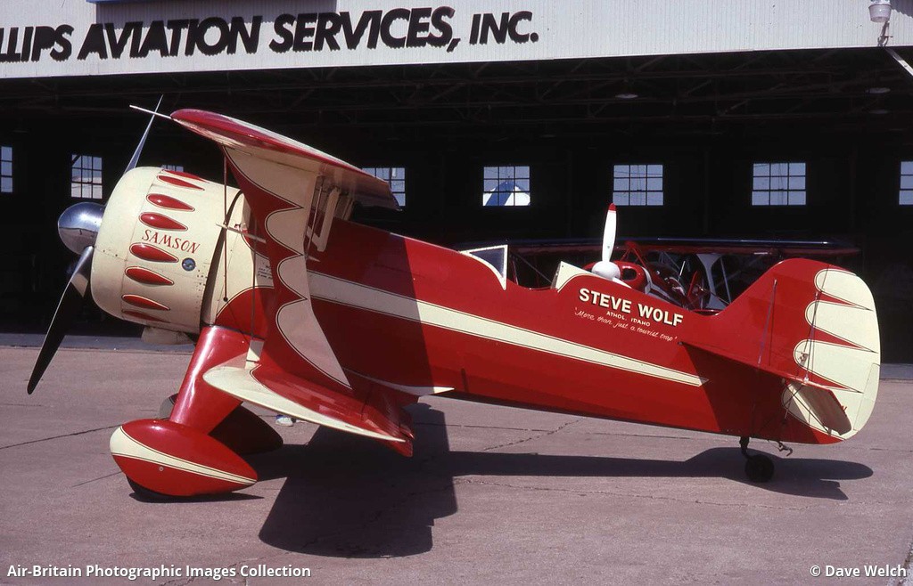

My list of possibilities are one of the Pitts variants like the S1-S, S2-A, S1-11B or the model 12. The Hostetler S1-11b looks like it could be modified for plug in wings without too much trouble because of it's box style construction. There are a few others like the Culp Special, and the Pitts Samson that I really like as well. The Pitts Samson really intrigues me from a construction standpoint. It has widely spaced cabanes that would be awesome for having a nice top hatch, plus you could have a upper center wing section that stays on the airplane, plus it's just plain cool! The problem with the Samson is I can't find much info on it at all other than a few pictures. Is there a three view out there anywhere?

Now to the help I need part. Three view drawings of any of the airplanes I listed above or any other Pitts variants. Any with cross sections would be awesome. I've gotten a ton of info searching Google, but the more the merrier, Plus it would be nice to have some of that info here on the Bipe thread.
If anyone has any info on the Samson please post it, even just some specs would be great. That thing makes me drool.;)

You might try contacting Matt Younkin of Younkin Airshow fame his dad Bobby flew Sampson in a triple airplane act with Jimmy Franklin & Jimmy LeRoy. Original airplane was a Curtis Pitts Design, replica was built by Steve Wolf, builder also of Delmar Benjamins Gee Bee R2.
He ran Wolf aircraft but has retired Type in Wolf Pitts Sampson Biplane.
Bill
Komet163

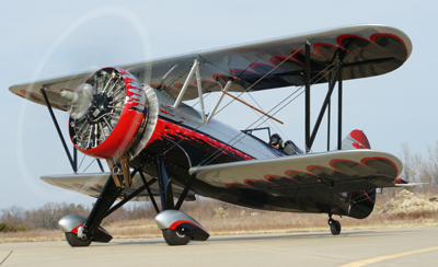

Here is a couple pics to chew on Sampson and Kyle Franklins Draculs which is a 70% UPF7 Waco highly modified.
