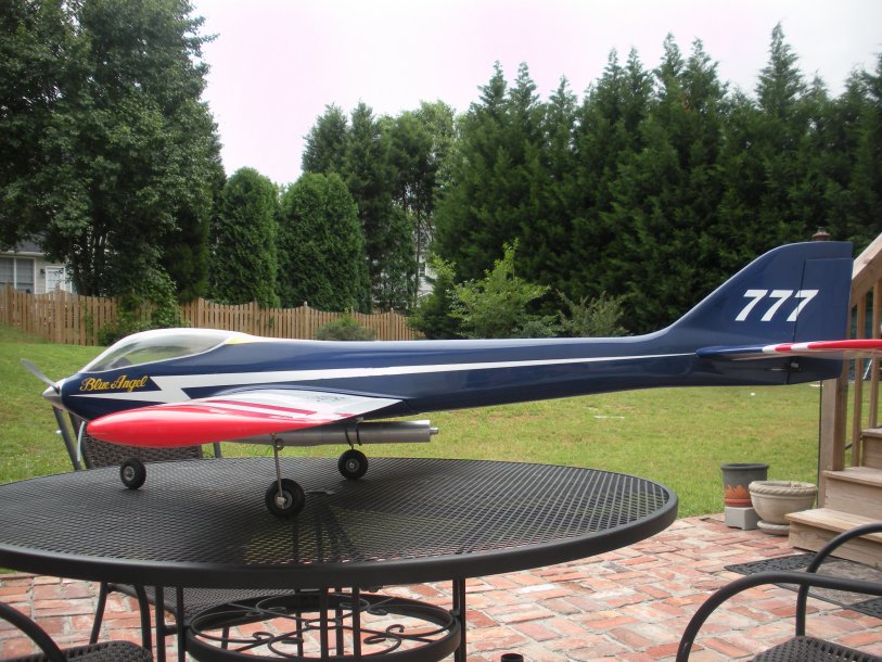

    1/2 oz glass and Minwax water based polyurethane is about as heavy as monocote. Here's my 1st (and only) practice run at glass and Minwax. Scratch built so that kept the weight down but this is 8 lbs even, perfect for pattern planes. Paint is water based but clear coat is automotive grade.

    That's 8 pounds of shear beauty right there. . . . . :yesss:

    Seriously!!! That is freaking amazing. So, about the same as Monokote? I suppose there is no real difference between Mono and Ultracote right? It looks as if I may be going this route then. Thanks bro. for the info.:way_to_go:

    Yep, let the moisture cook off from the water based minwax poly u and water based paint and there's very minimal weight gain. A hard shell of automotive clear coat isn't that much more weight. But calculate your model build time then double it if you decide to paint it.
