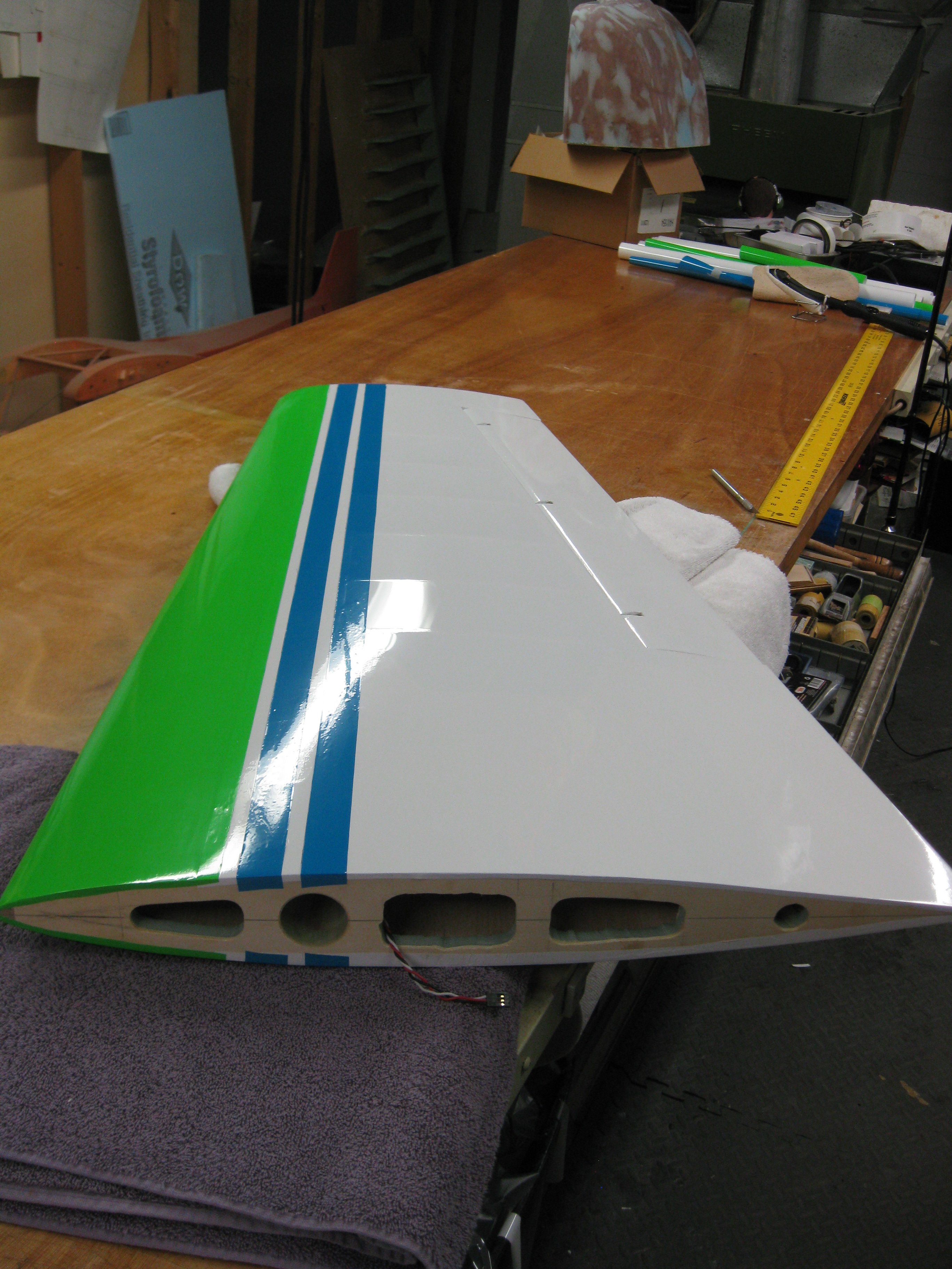

  3. What Mikey said!
    But there is a third option, Hobby King covering film, 5 meters for $13.00, looks like Monokote, goes on like UltraKote and stays tight. I covered these wings in December 2014, still tight today. The only problems I ran into was I could not color match the green covering and when floating trim colors on top you need to let the liquid completely dry before sealing. The autobody store was able to match the white and blue without a problem.
