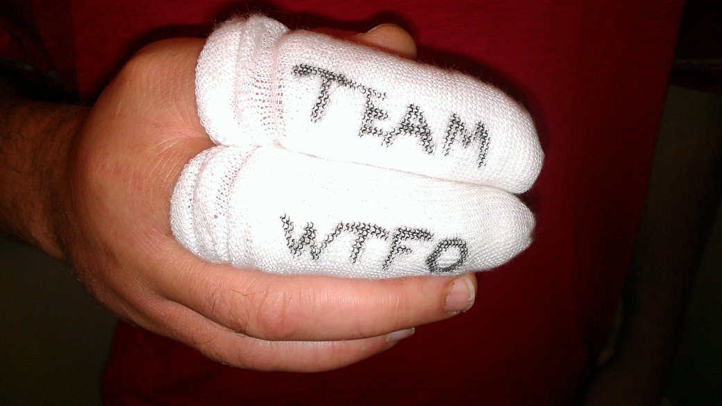

Please be careful!! This is what can happen when flipping a 170cc with your skirt on!!!
