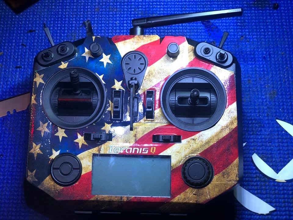

That's what I'm leaning towards. FWIW, the radio is really nice! I'm kind of regretting not just getting the standard Taranis transmitter since it's capable of everything that the other radios can do but it's done so I'm soldiering on. My Hitec Aurora 9 radio and receivers sold so there's no going back! lol
Sick looking Q7 here

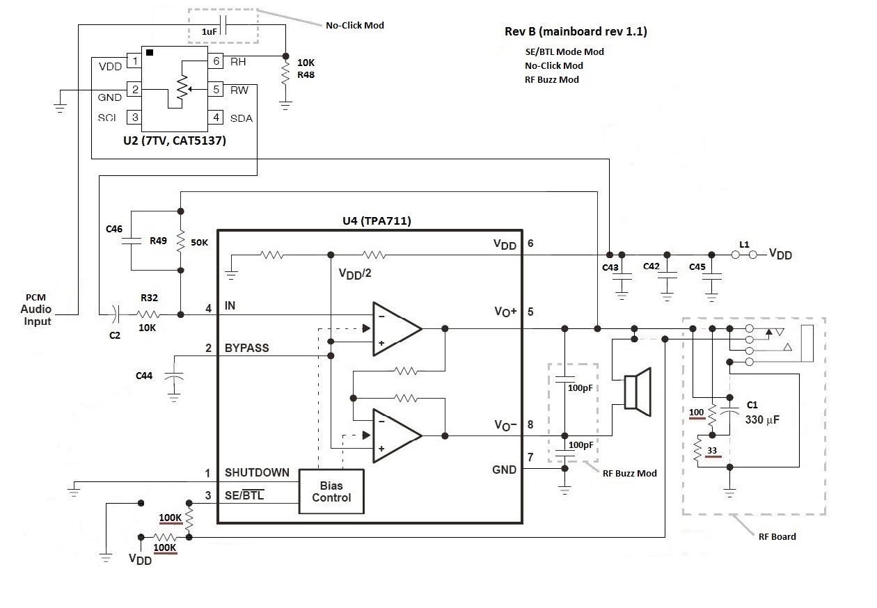

Two mods had I wanted to do were the RF Buzz mod and the no click mod. These upgrades were found at the RC Groups Radio Forum. With the speaker upgraded the buzz and click become more apparent. I was reluctant to do these upgrades since it required soldering small surface mount capacitors. With this spare transmitter in hand I decided to take the plunge.

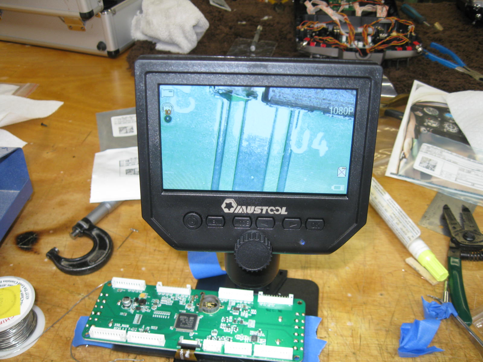

Step one, bought a 10-600 power electronic microscope with 1080 hd display on Banggood, cost about $35 delivered, works great, truly amazing to be honest.
The No Click mod required a 0402 SMD 1uf capacitor, these things are tiny, .040" x .020". I bought 10 of these from Digikey, maybe $.20 each. It took awhile but finally on the 9th capacitor I was able to complete the modification. I got better with each failure. The mod has eliminated the clicking sound while changing the volume setting.
The RF Buzz mod requires 2 0603 SMD 100 pf capacitors, these are soldered across the speaker leads and to ground. I incorrectly ordered 0402 caps for this, way too small. I ended up using 0805 caps and this size worked just fine, much easier to work with, .080" x .050". This mod has eliminated the audio buzz at higher volume settings. The circuit shown below was posted by Barry2020 on the RC Groups Radio forum and was a great help.
I completed both mods and tested the board, everything worked as expected so this board was installed in transmitter I'm currently using, the sliders on newer radio were much smoother than mine so I went ahead and swapped those into my radio as well.
